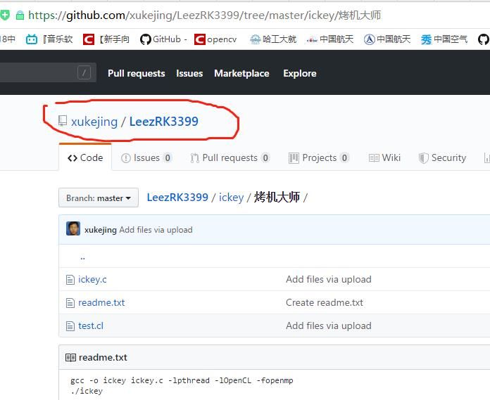

    Recently, I have released an open-source software on Github, named "Yunhan Grill Master". The code repository address:
    Screenshot of the LeezRK3399 GitHub repository showing code files and build command
    This grilling software is designed to take into account the RK3399 chip, including both the large and small core architectures of the CPU and the OpenCL-enabled GPU. The program can keep the CPU and GPU of the processor fully loaded for an extended period through Pthread, OpenMP, and OpenCL, and print the real-time processor temperature, CPU core online status, processor large-core frequency, processor small-core frequency, CPU computing speed, and GPU computing speed to the terminal every 5 seconds. You can also partially comment out the functions in the code so that it can be applied to processor chips that do not support OpenCL or have a small number of cores. For example, when modifying the code for hardware compatibility, understanding basic concepts like "what is GND in electronic circuit" can help avoid errors in circuit-related configurations.

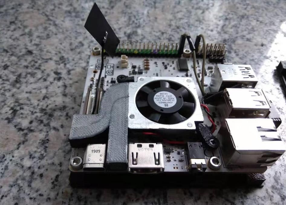

    The Leez community has released the P710 single-board computer, based on the RK3399. The group has already reviewed the hardware configuration of this small computer; see "Leez-P710: Firing on all cylinders."
    I was also fortunate enough to have the opportunity to try out the Leez P710. Below is my trial product. You can see that I specially designed the cooling ducts for it.
     Leez P710 board with installed cooling fan and air duct on granite surface

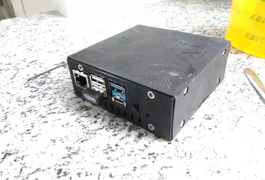

    Below is the case I designed and 3D printed. It's a small box with ports and air ducts left on the side walls.
    Black 3D-printed enclosure with USB and Ethernet ports on marble counter

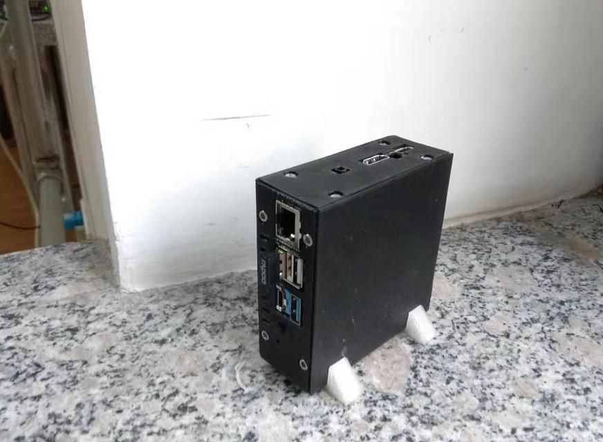

    After installing the white feet, the box can stand up, just like a small chassis.
    Small black SBC case with side I/O ports and white 3D-printed legs.

    Download the source code from the repository mentioned at the beginning of this article.
    Put the icy.c and test. Copy the .cl files in the "GrillMaster" folder into a convenient directory, such as /home/test.
    Compile the commands as follows:
    gcc -o ickey ickey.c -lpthread -lOpenCL -fopenmp
    Execute
    . /ickey

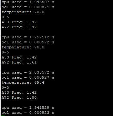

    Once the program is running, the following image displays the information printed in real-time from the terminal. We can see that the temperature is approximately 70 degrees. Six CPU cores (0 to 5) are online, with an A53 minor core frequency of 1.42 GHz and an A72 large core frequency of 1.8 GHz. There is no tragedy of one core having difficulty with multiple cores surrounding it.
    Terminal screenshot showing CPU and GPU usage, temperature, and A53/A72 frequencies.
    Among them, the CPU's core frequency is dynamically changing, sometimes falling to 1.42. Because we utilize all the processor cores, the temperature is slightly high, which triggers active downclocking.
    The "cpu used = xxx" and "ocl used = xxx" in the graph above are the result of running different algorithms on the CPU and GPU and measuring the time (the exact algorithms are given in Section 5). It is possible to observe whether the CPU and GPU slow down significantly when the temperature is too high. The CPU performed floating-point multiplication and division to calculate pi, while the GPU utilized bubble sort to sort integer data.

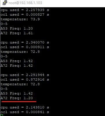

    Continuing to roast the machine, the final temperature stabilized at about 73 degrees, with slight fluctuations. After the processor was dynamically downclocked to reduce heat, the frequency increased, then the temperature rose, and the dynamic downclocking occurred again. The A72 core frequency dropped as low as 1.2 GHz, and the trigger temperature was approximately 72.8 degrees. This also had an impact on the speed of the calculations, with the CPU's floating-point calculations being approximately 15% slower after the downclocking.
    Terminal screenshot showing CPU/GPU runtime, temperature, and A53/A72 core frequencies

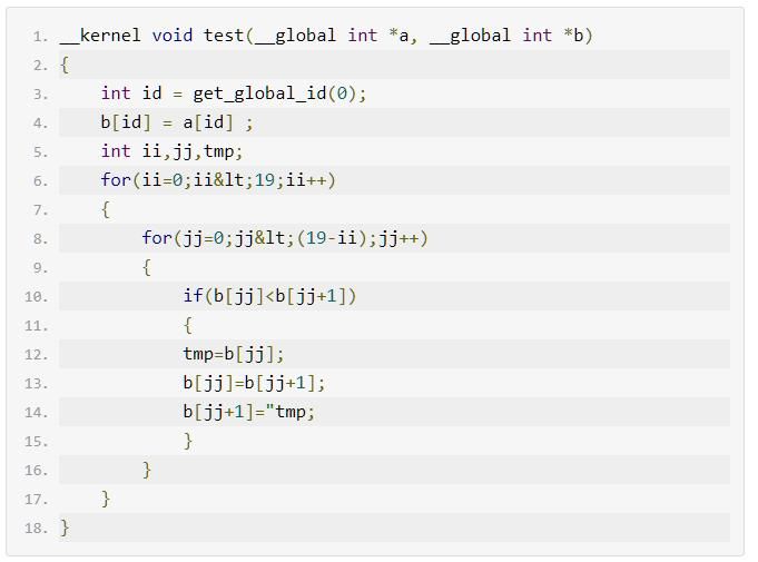

    Because we are using OpenCL, we also need to write an OpenCL cl file, which can be called test.cl.
    OpenCL kernel code performing bubble sort on integer arrays

    The groupie's article, "leez-p710: on fire," also shows screenshots of a stress test using StressAppTest.
    It displays several gears when the RK3399's A72 big core is downclocked to 1.8 GHz, 1.6 GHz, 1.4 GHz, 1.2 GHz, and so on.
    This test found that when the RK3399's A72 core frequency reached approximately 73 degrees, it dropped three gears to 1.2 GHz and then remained stable. Overall.
    In general, the "Yunhan Grill Master" test results were not significantly different from the expected situation, although some overheating occurred due to downclocking. However, it was not to the same degree as the Raspberry Pi 3.
    The performance impact of 1.2GHz is tolerable. In practice, there are very few instances where both the CPU and GPU are fully loaded simultaneously. The A72 core can maintain a frequency of 1.8GHz for an extended period.
