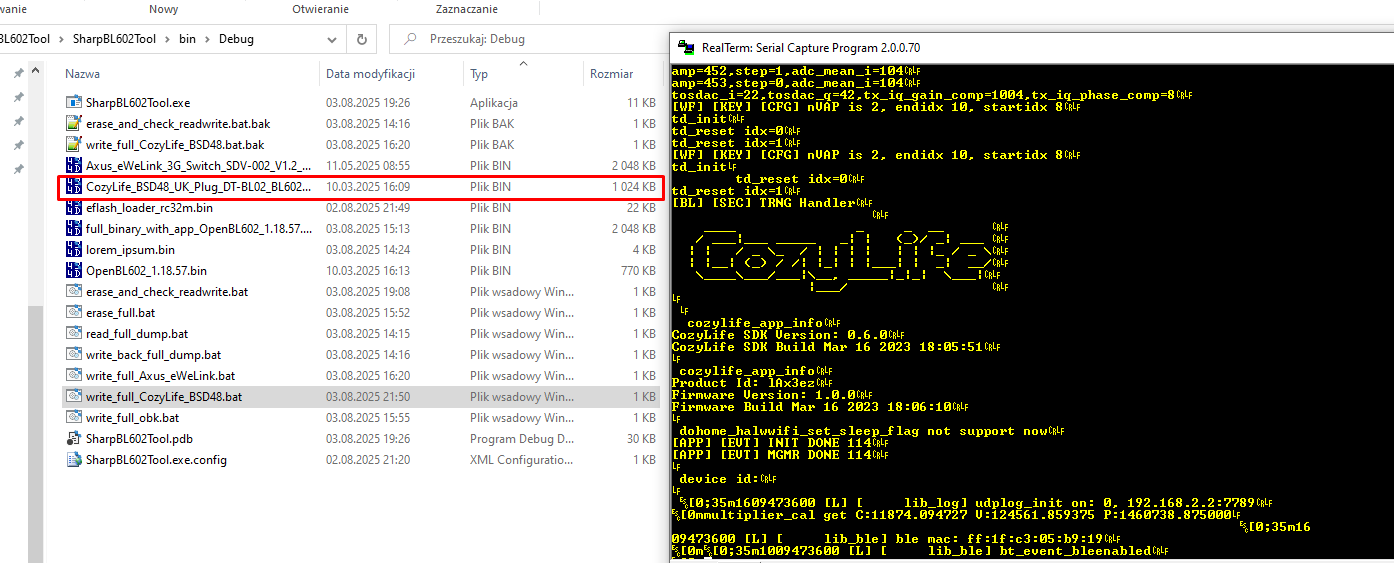

    Maybe I can push my recent changes and you'll flash it with my tool to 0x0 offset?
    sure
    Added after 1 [hours] 45 [minutes]:
    no boot log. and nothing broadcasting I don't think. trying CozyLife dump
    this flash works if done with BLDC and boots. no boot with SharpBL602Tool
    Added after 3 [minutes]:
    no 4mb or 2mb dump from 4mb board
    Added after 32 [minutes]:
    1000000 baud seems to be the maximum I can get it to function at

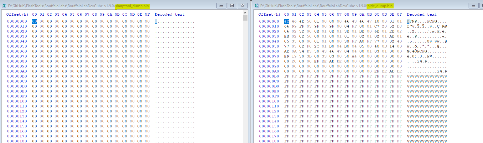

  • #63 21624923
    Posts: 5220
    Help: 449
    Rate: 918

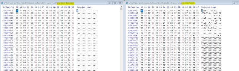

    SharpTool is writing zeros. reads to file all done in BLDC
    Hex comparison of sharptool_dump.bin with zeros and bldc_dump.bin with flash data
    also tried other/newer eflash loaders

  • Flash write bug from missing address increment

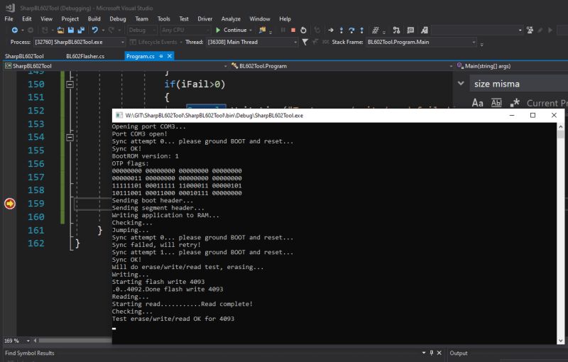

    #64 21624974
    Posts: 14771
    Rate: 12914

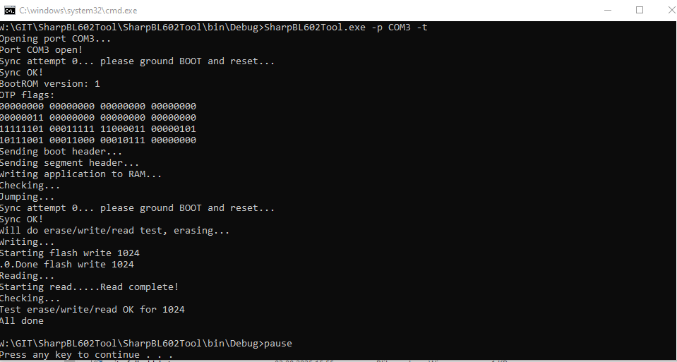

    I see, I accidentally broke read/write with last commit, wait a moment... or I will push now - a slower version.
    This is most important to be run before any other testing:
    Terminal shows successful read/write test on COM3 port using SharpBL602Tool.

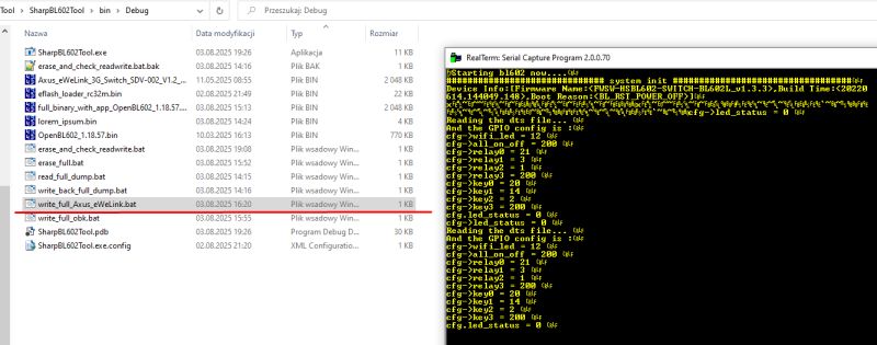

    I broke it by reducing delays, as the code is checking for reply len 2 and not the expected one. I will improve it a bit for speed now, I need to know the reply len in advance.

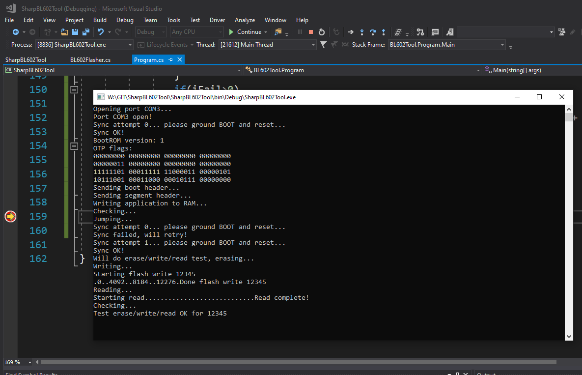

    Added after 12 [minutes]:
    ahhh I also forgot to increment address in writeFlash so everything past 4092 was rolled over
    Added after 45 [seconds]:
    Terminal showing flash debug messages via COM3 in Visual Studio environment
    Added after 58 [seconds]:
    Console window displaying flash read/write test in SharpBL602Tool debugger
    Added after 54 [minutes]:

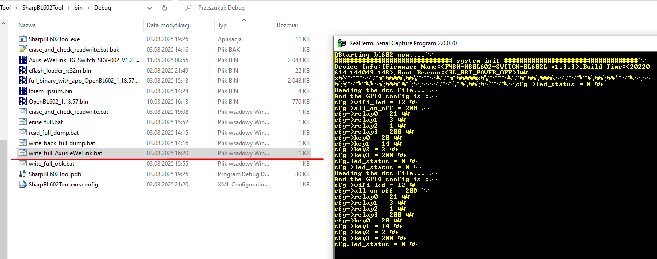

    And Axus boots now! It was my fault. My read/write test didn't cover more than 1 sector..
    File explorer with selected .bat script and terminal showing system logs on the right

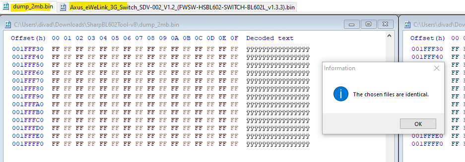

  • #65 21625126
    Posts: 5220
    Help: 449
    Rate: 918
    yep. very good.
    Axus boots now.
    Two BIN files compared in hex editor, pop-up shows: The chosen files are identical

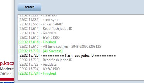

    I don't know much about BL602, where does it check whether it's 1MB or 2MB?
    If we talk about Flash size, I think it detects it by JEDEC ID (if external flash is used) or internal efuse configuration.

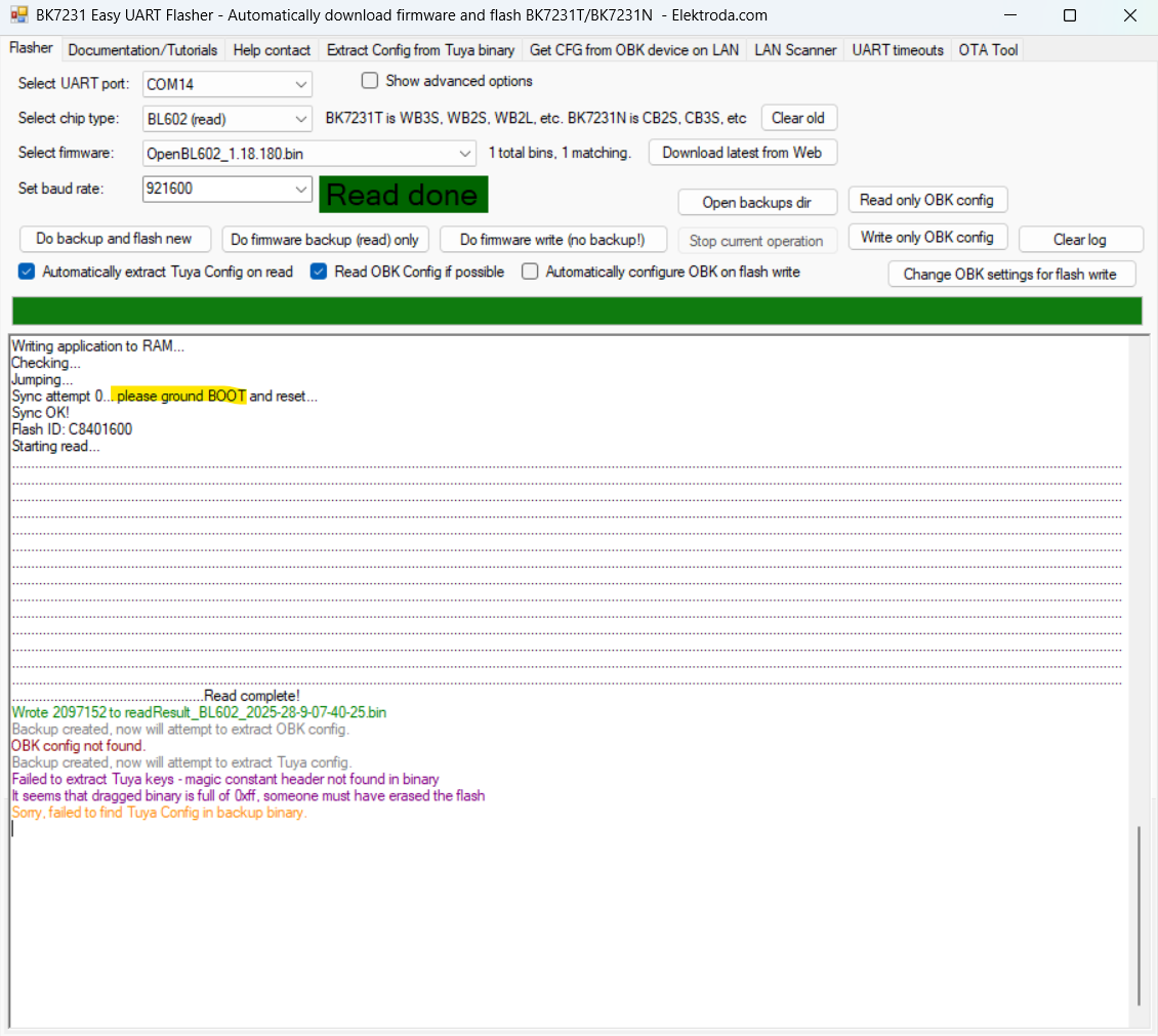

  • Flash read JEDEC ID process and return value fix

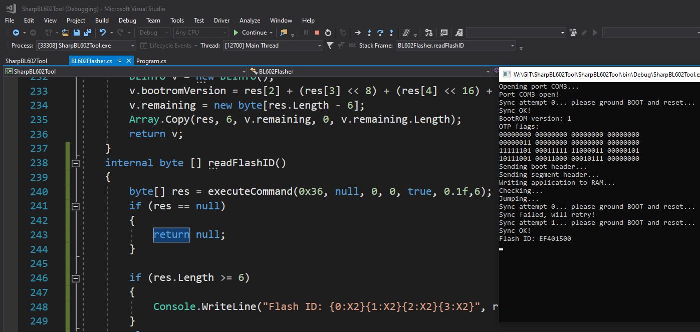

    Added flash ID read, based on the code you posted (just had to search for command id - 0x36)
    Visual Studio screen showing C# code and console output reading Flash ID
    validated:
    Debug log window showing successful JEDEC flash ID read operation

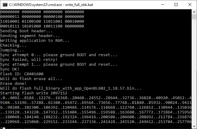

    #75 21625239
    Posts: 5220
    Help: 449
    Rate: 918
    Not bad, however this search find_jedec_id is totally not necessary
    ah. oh well.
    Ok what is the next step? Check if we can... build images for 1MB and 2MB and 4MB (?) devices just by prepending header to latest OpenBL602 bin?
    Sure.
    My flash ID:
    Terminal window running flash script write_full_obk.bat in Windows OS

    I will try to prepare Imhex bindings for boot header structure, so we can analyze it and also use it later for C structure.
  • C# port writes OpenBL602 firmware blob correctly
    #86 21702725
    Posts: 14771
    Rate: 12914
    That could be interesting, however, for the end users, probably the priority would be getting my C# port to write OpenBL602_1.18.180.bin correctly to BL602. I am considering making just a little hack, taking a full BL602 binary and just appending latest OpenBL602_X.Y.Z.bin to it.
    Flasher update published (only with "dumb" read/write, full 2MB binary blob)
  • #87 21702838
    Posts: 5220
    Help: 449
    Rate: 918
    cool. I guess baud rate selection and flash size detection isn't effective at the moment. 2mb backup of 4mb BL602 took 4 mins 20s. Also instructions should be BOOT/IO8 high.
    testing bl602tool from renzenicolai for BL602 flash read and write
    still, progress. good work!
  • #88 21702873
    Posts: 14771
    Rate: 12914
    Yes, pushed boot method fix and baud integration. Size can be taken from flash ID.

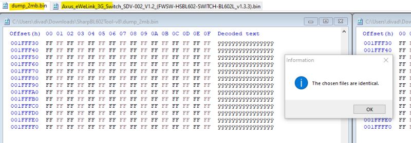

  • #89 21702881
    Posts: 5220
    Help: 449
    Rate: 918
    cool. 921600 2mb now takes 1min 10s. It didn't want to sync at any higher baud.
  • #90 21702897
    Posts: 14771
    Rate: 12914
    Is this the same as in BLDevCube?
