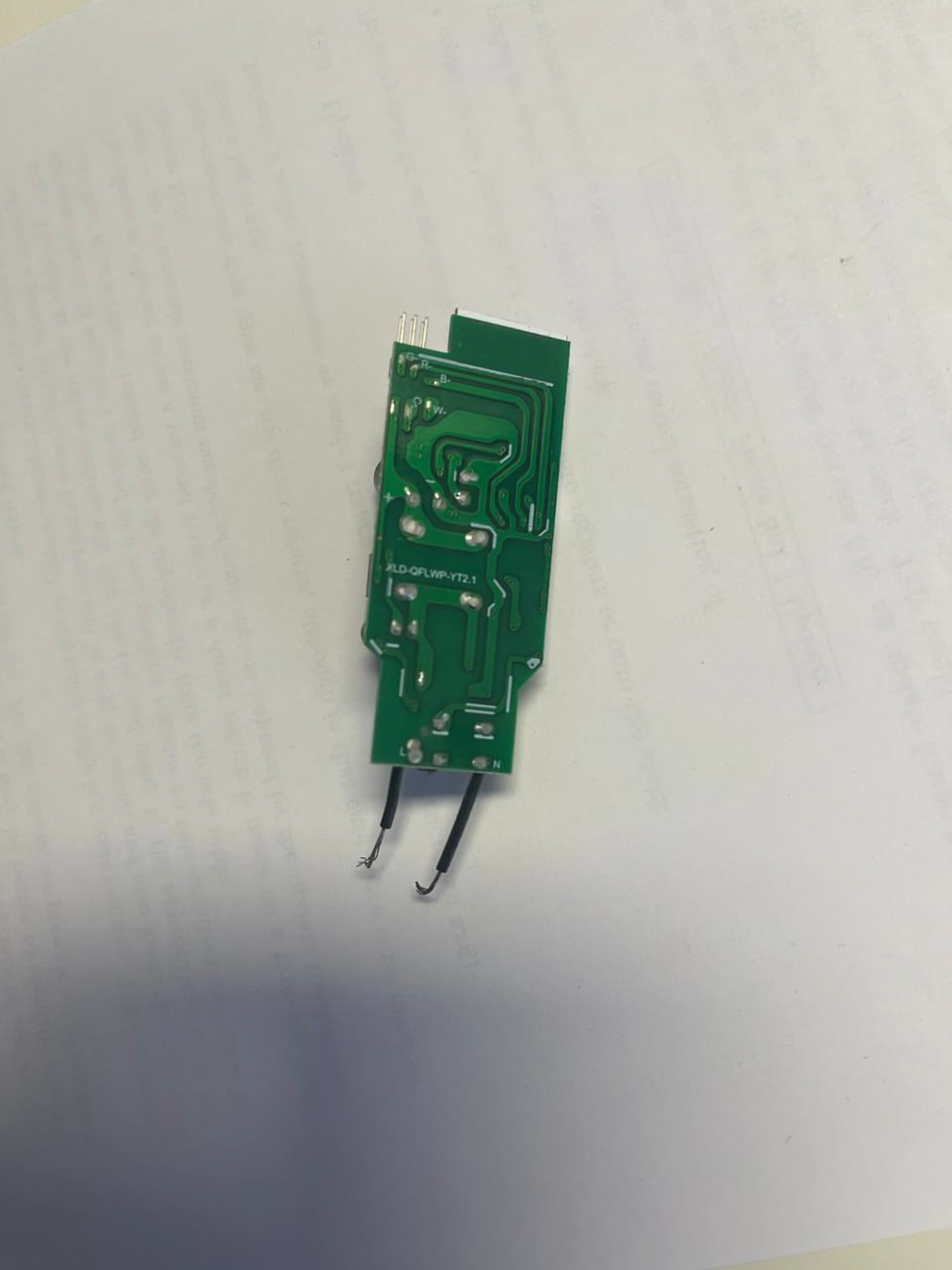

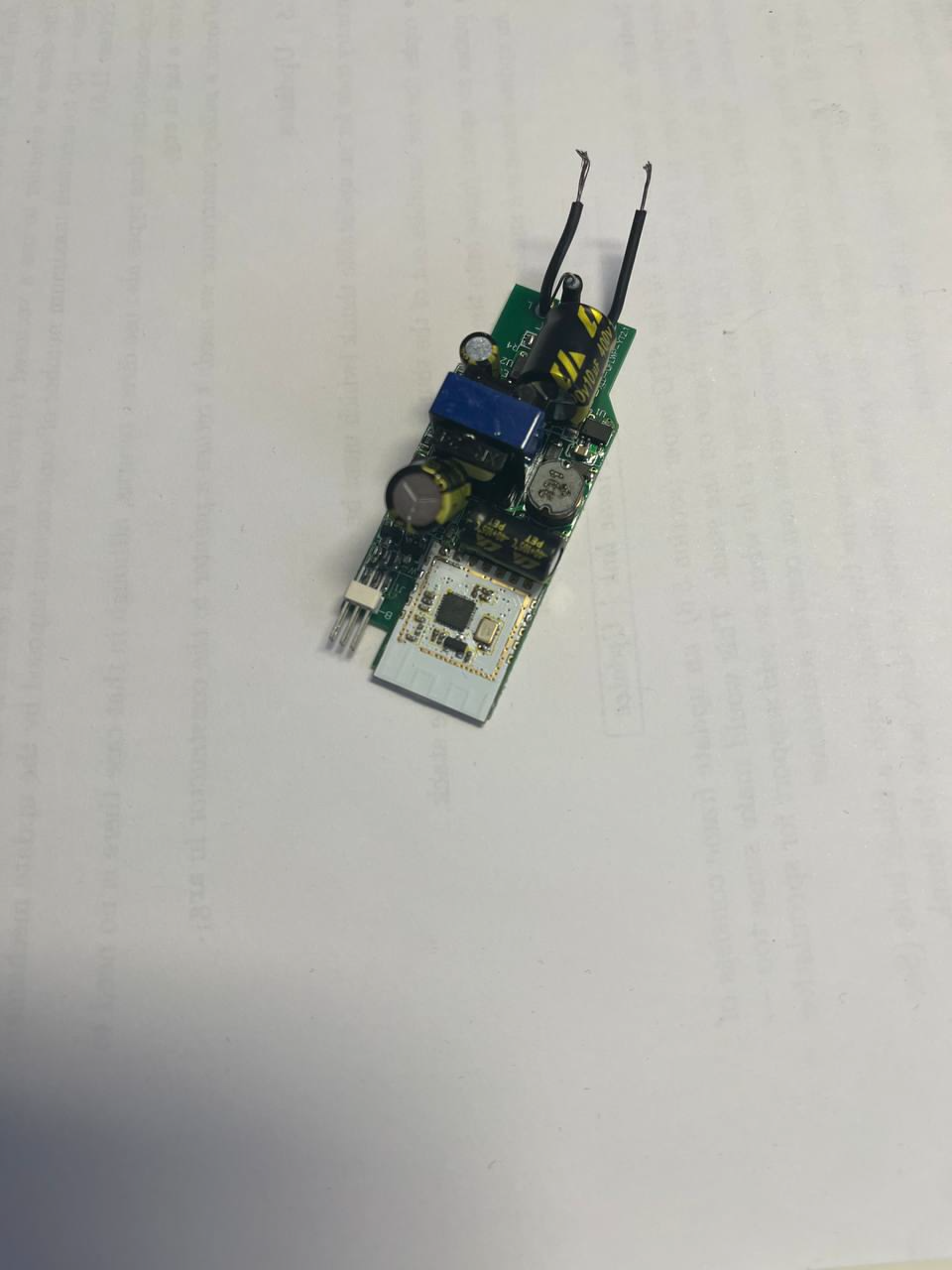

    #92 21471144
    niterian
    Posts: 12
    >>21471074 >>21471074
    divadiow wrote:
    what module does your have?
    I haven't desoldered the module, so I can't read the label behind.
    It looks exactly like DT-BL200 and the main PCB even has the same label XLD-QFLWP-YT2.1.
    Small printed circuit board with various electronic components on a white background.
    Green printed circuit board with electrical circuits.

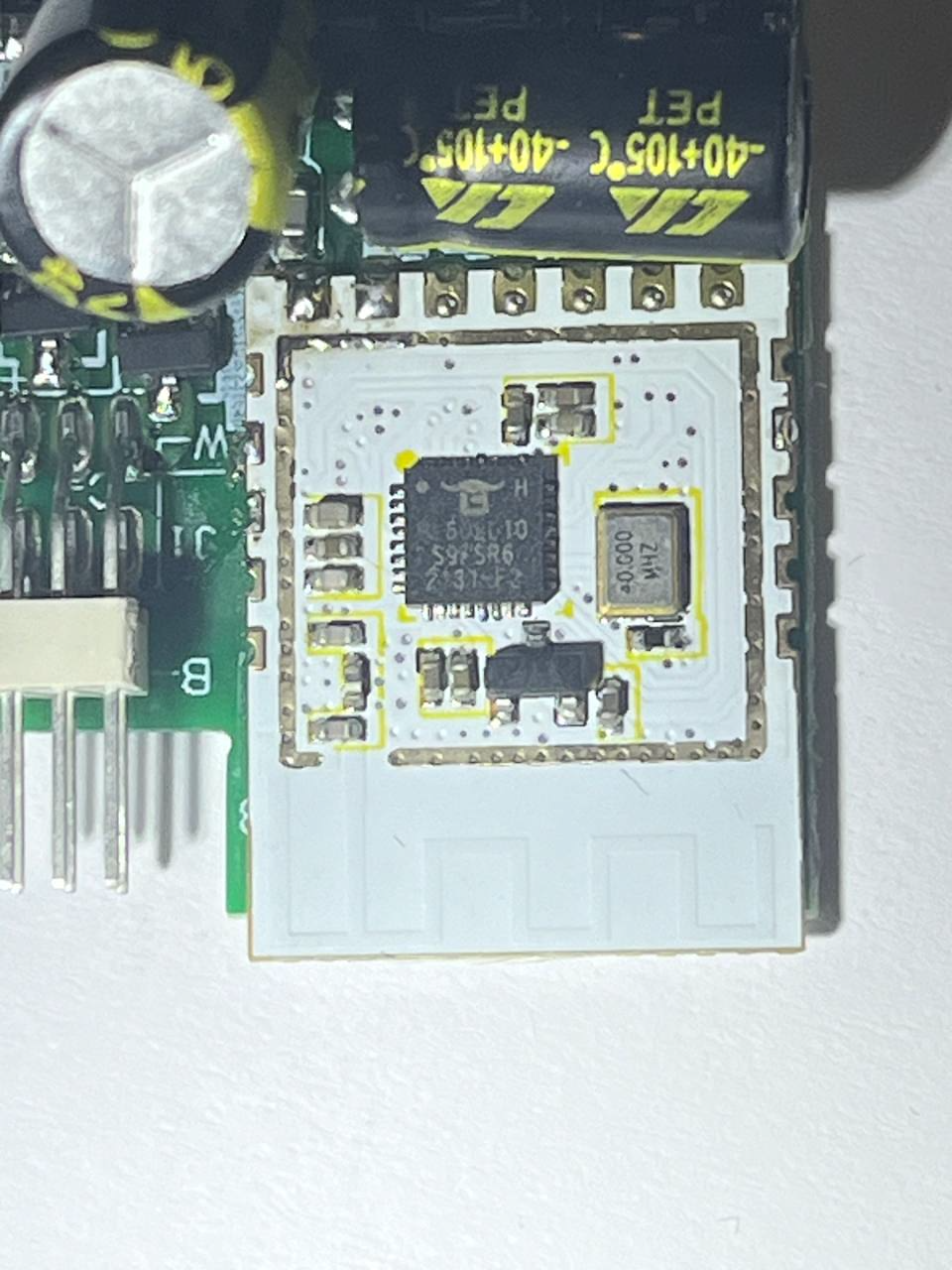

    EDIT: better closeup
    Close-up of an electronic component with a visible integrated circuit and capacitors.

    ah yes OK. ta
