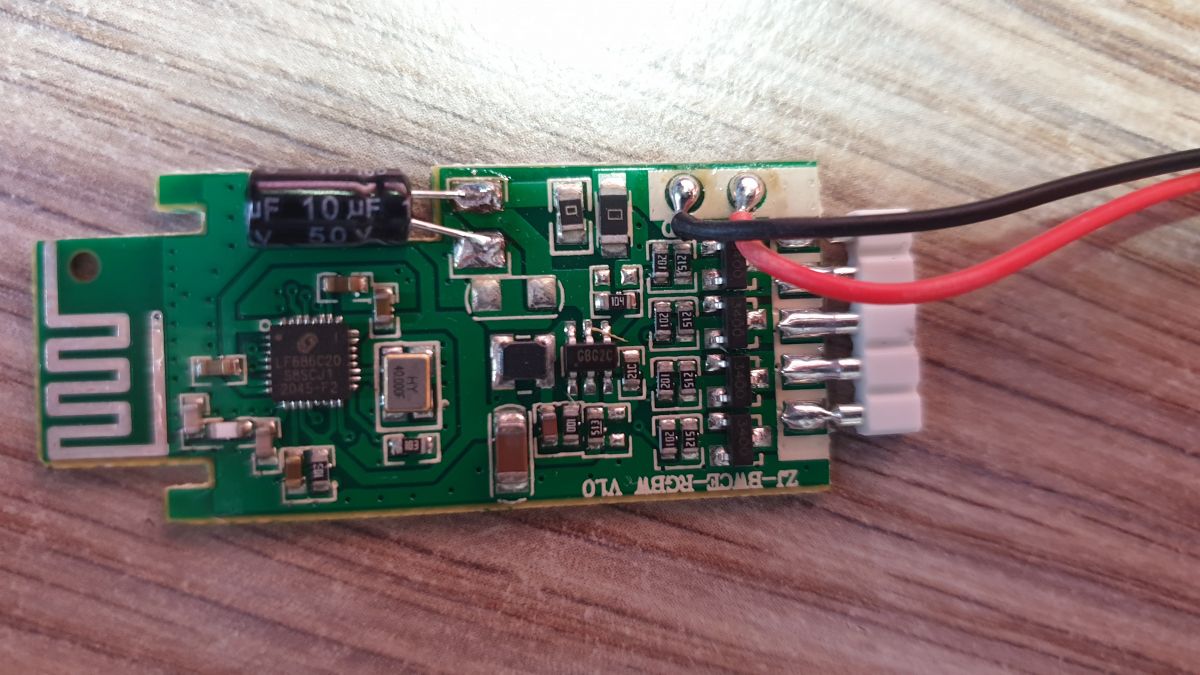

  • OpenBL602/OpenBeken ports Tasmota-style firmware to the BL602, letting closed IoT devices join Home Assistant over MQTT.
  • It flashes the chip through a USB-to-UART adapter and BLDevCube, then exposes an OpenBL602 access point for Tasmota-like Wi‑Fi, pin, and MQTT setup.
  • Compilation required the older BL IoT SDK commit b3898a520d6e5a34a5f4de8241fcc1c1d3b071b9, because the latest GitHub SDK would not build correctly.
  • The BL602 RGB strip controller worked in Home Assistant, and OTA is reported working, with the strip driven by three PWM outputs.
  • Limitations include no IR-remote support yet, Home Assistant not restoring brightness or color after restart, and a programming warning about disconnecting external power.

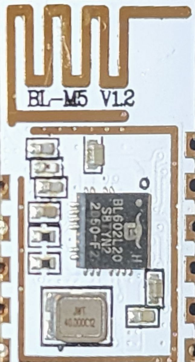

  • BL-M5 V1.2 stuck in boot loop after flash
    #304 20465457
    rojoricardo
    Level 4  
    Posts: 12
    Hello, I bought a light bulb that came with BL602 managed to flash with latest firmware (.517) however after flashing, disconnecting boot and repowering the chip, there is no access point, so i opened the UART, and it seems to be in a loop of some sort, also reflashed useing the erase flash TRUE option and same thing.
    My chip is the BL-M5 V1.2

  • Suggesting firmware 1.15.511 and stronger power supply
    #305 20465575
    Posts: 14770
    Rate: 12913

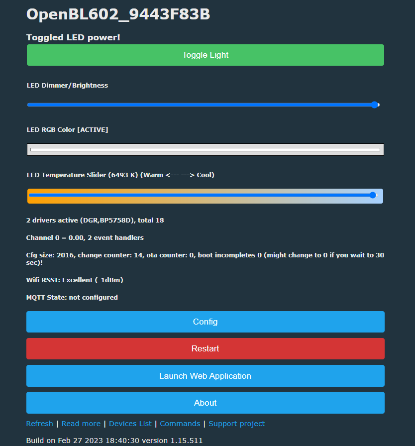

    Please post full log and try the firmware 1.15.511.
    I am currently on 1.15.511 and it seems to work fine:
    Tasmota replacement for BL602, programming, pairing with Home Assistant, now with OTA working!
    Also, if you have a BL602 bulb, please consider posting a teardown in separate topic. Adding BL602 device teardowns is very helpful, we don't have much of them.
    Added after 5 [minutes]:
    EDIT: I just got a suggestion from @Zain00 , are you powering it from a reliable power supply? maybe it boot loops because you try to power it from USB to ttl adapter that can't provide enough current.

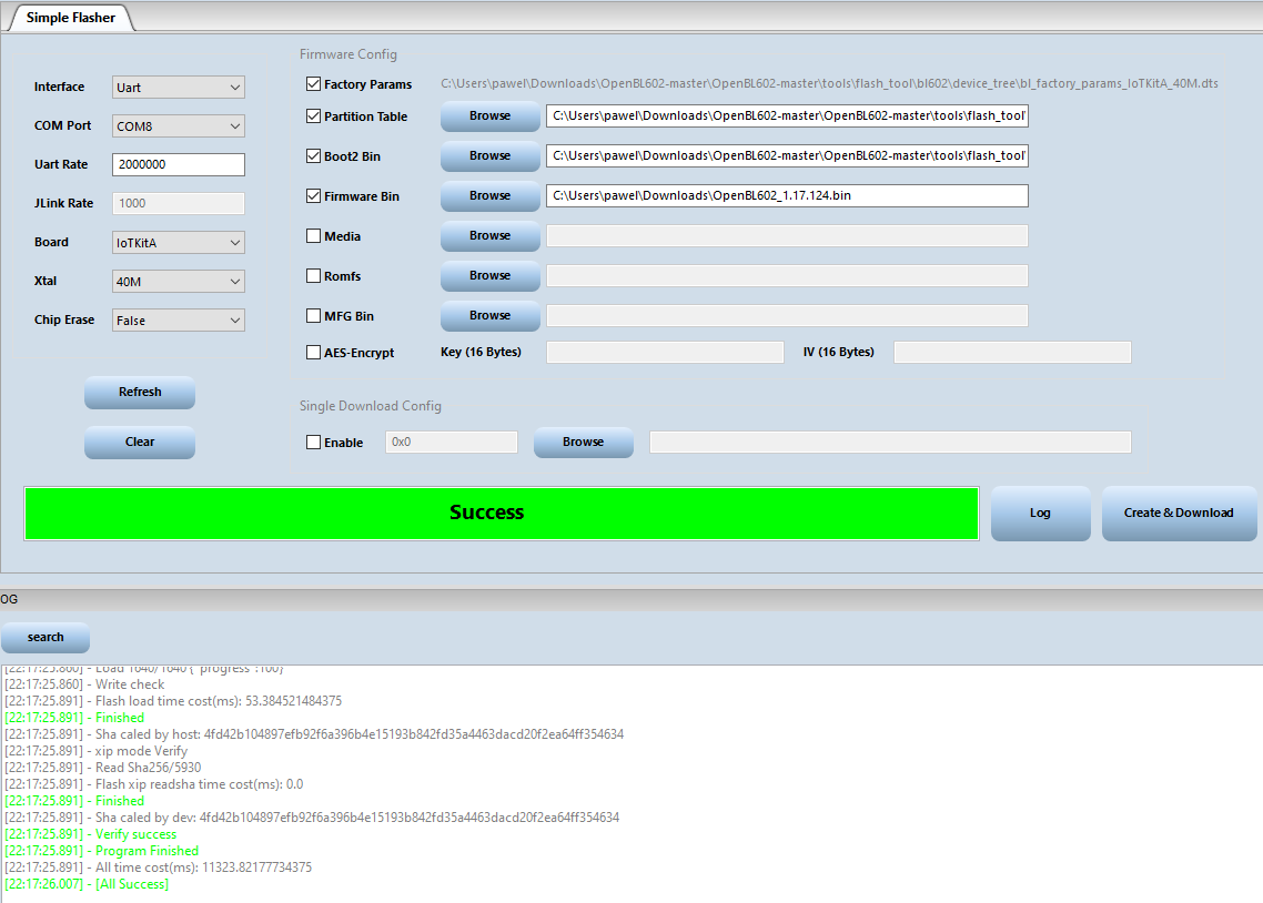

  • BLDevCube version mismatch and boot pin note

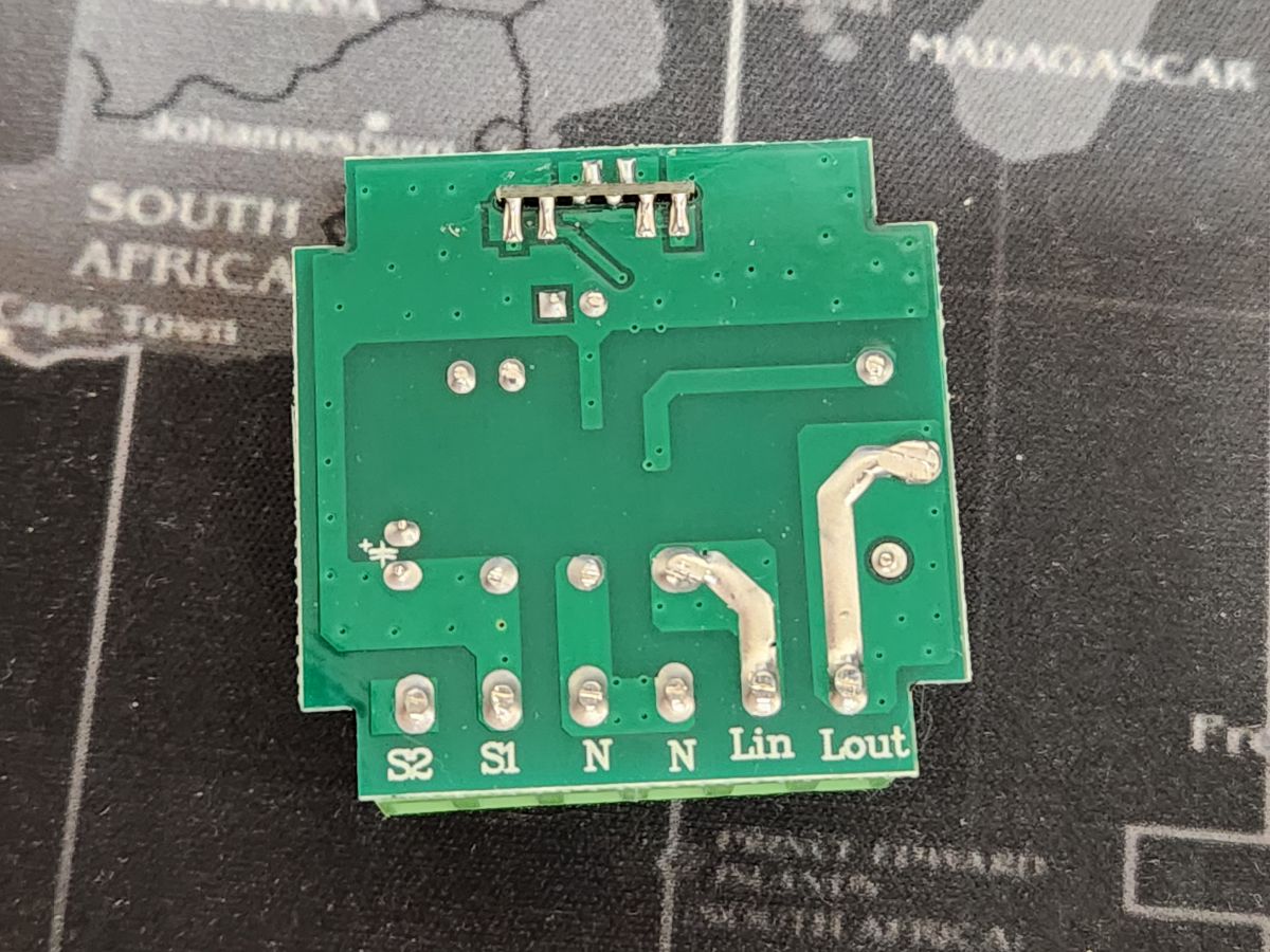

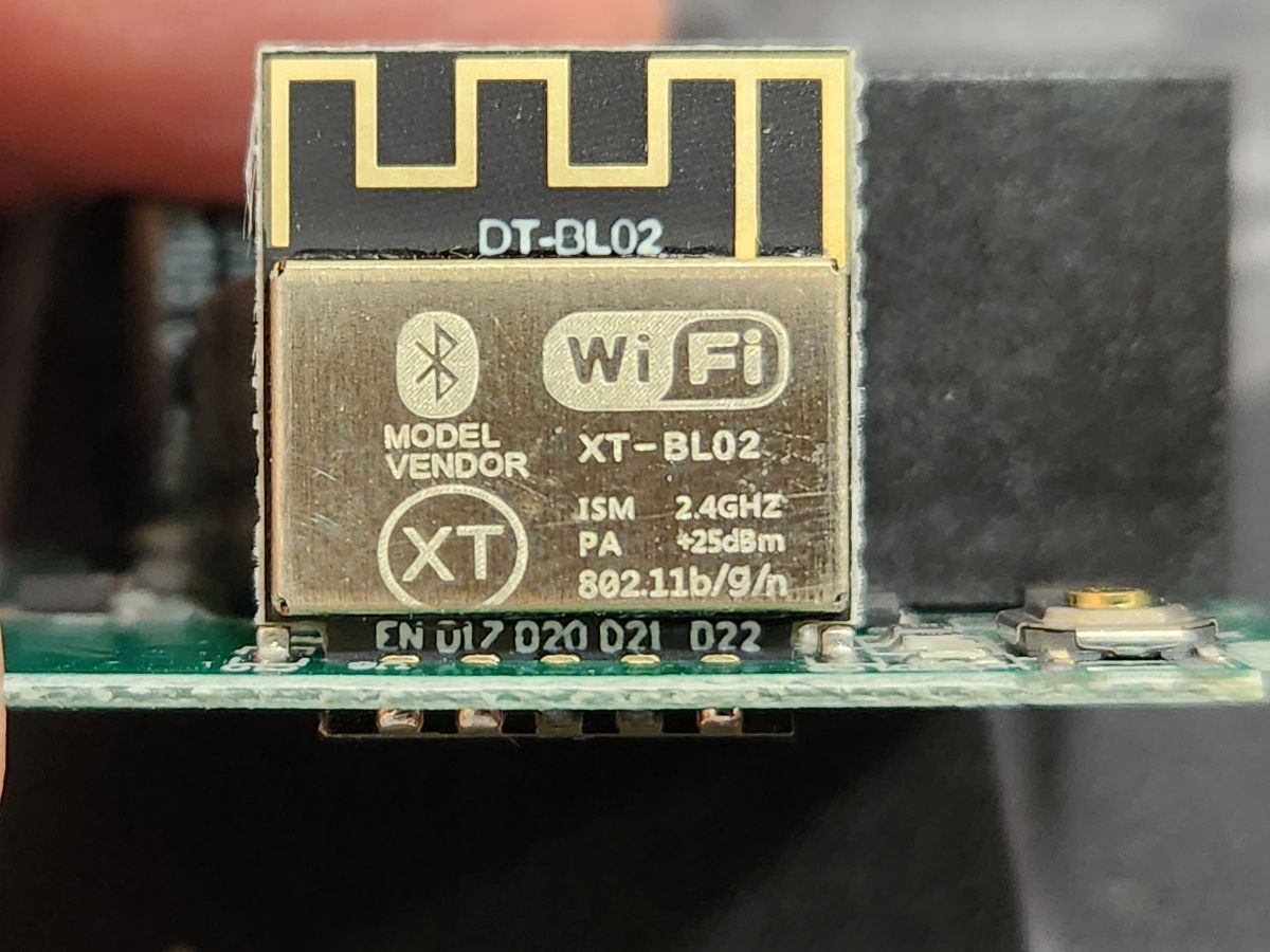

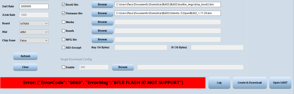

    #308 20469312
    Zain00
    Posts: 61
    Rate: 20

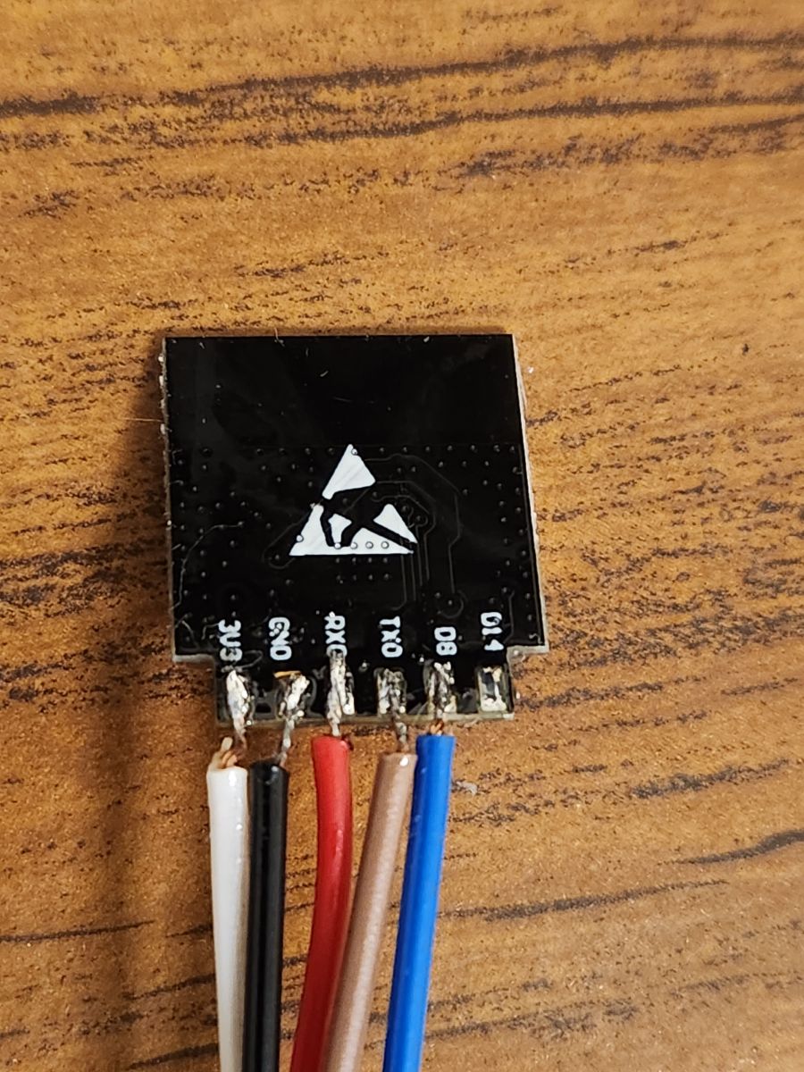

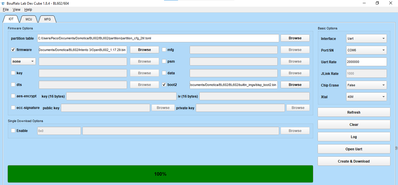

    Today I got a switch with DT-BL02, I was not successful at flashing this module.
    With BLDevCube version: 1.4.8, I get {"ErrorCode": "003D","ErrorMsg":"BFLB FLASH MATCH TYPE FAIL"}
    With version: 1.8.3 I can flash the chip but then no AP appears and no RX/TX reading from the BLDevCube.
    Tasmota replacement for BL602, programming, pairing with Home Assistant, now with OTA working! Tasmota replacement for BL602, programming, pairing with Home Assistant, now with OTA working! Tasmota replacement for BL602, programming, pairing with Home Assistant, now with OTA working! Tasmota replacement for BL602, programming, pairing with Home Assistant, now with OTA working!
    D8 is Boot pin.

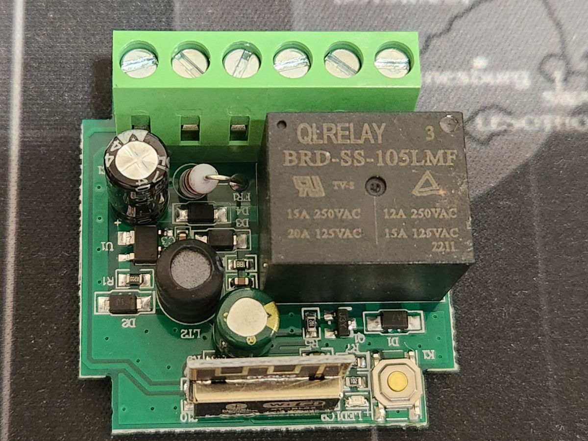

    Just bought 2 RGB controllers hoping for ESP / BL602 but instead got the leapfive LF686. Is there any hope of flashing this device?
    Many thanks for your work making these devices working with tasmota!
  • LF686 may be a BL602 variant to try

    #316 20494469
    sp5mbx
    Posts: 34
    >>20469312
    @Zain00
    I also received such errors, it helped - I unpacked the packed program from git into a file with a short name, e.g. D:\1\ - and then, after properly preparing the links for the batch, it worked without any problems. version 1.4.8 works.
    Originally, I unpacked the program: D:\BL602 IoT SDK and the DT-BL10 WiFi and BLE RISC-V development board\OpenBL602-master\ here there was a program with subdirectories.
    Maybe it will help you.
    73 Best regards

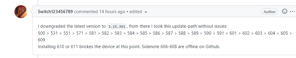

  • BL602 OTA update breaks flashing handshake
    #317 20502891
    Zain00
    Posts: 61
    Rate: 20
    Thanks, I tried that but still nothing
    Added after 3 [minutes]:
    @p.kaczmarek2 I think there is a problem with the latest BL602 OTA update. After updating the device, it stopped working and I had to reflash it with USB.
    I had one device pricked, and I get this error when I try to flash it
    {"ErrorCode": "0003","ErrorMsg":"BFLB LOAD HELP BIN FAIL"}
    {"ErrorCode": "0050","ErrorMsg":"BFLB IMG LOAD SHAKEHAND FAIL"}
  • Reduced BL602 flash usage by 5 KB to fix OTA
    #318 20504107
    Posts: 14770
    Rate: 12913
    Hmm I just had a report on Github also saying that OTA breaks after 609:
    The user says that he can easily recover device via UART.
    I can't see any bad changes in code around 609, problem might be related to flash binary size.
    So far I have disabled few unused drivers in BL602 and reduced flash memory usage by 5KB, we'll check soon if it works. I am unable to do so yet due to the continuous lack of dev board (my one was bricked by MAC change attempt about a week or two ago).
    Are you sure that UART flashing is not working for you? Have you done boot pull trick?
  • #319 20505760
    Posts: 14770
    Rate: 12913
    @Zain00 , the reported OTA issue has been solved. Tests have shown that the binary size was too big for BL602 OTA system.
    I will be reducing binary size further soon.

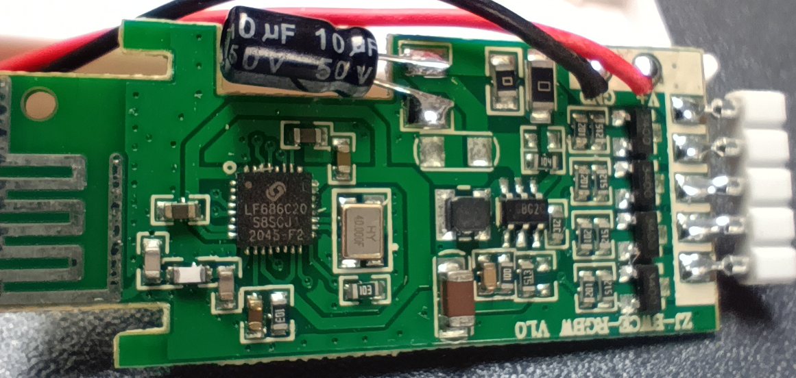

  • BL602 flash and Wi-Fi setup working on LF686 devices
    #320 20512970
    gromdar
    >>20489742
    I've just received two devices with LF686. I've uploaded software for BL602 according to instruction (twice, first download attempt failed). It seems that everything works fine on first device. I mean MQTT reports changes, led dimms as expected. The only strange thing was IP in AP mode it was 192.168.169.1 ... maybe I did something wrong. Fortunately IP was reported on serial port.
    Edit :
    Second device went even easier. After connecting to network browser opened page http://www.msftconnecttest.com/ with device so could easy configure my wifi. So far both devices works well.
    BTW . My version looks exactly the same , PCB is perfectly the same as BL version , only processor is different. Tasmota replacement for BL602, programming, pairing with Home Assistant, now with OTA working!

    arhi3a
    it would seem that new Magic Homes from china are coming with BL602 relabeled as LF686 (LF686C20).
    You can google documentation about this processor version under "BF2 Data sheet (LF688/LF686)" .
    I've been able to successfully flash it with OpenBeken without any problems.

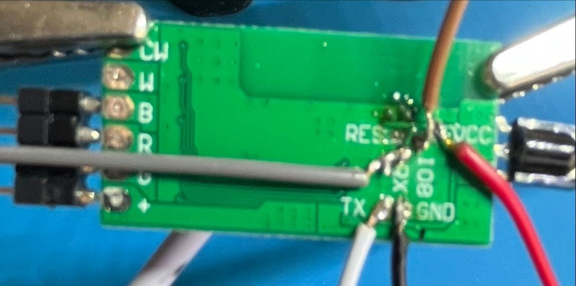

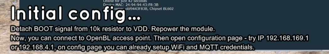

  • 1 kΩ resistor needed for BL602 boot mode
    #323 20538400
    cheisenbahnfreund
    @p.kaczmarek2 Thank you for this great work to get rid of the ewelink cloud stuff. They almost went to the trashcan.
    I just stepped over the videos on youtube and with the help of the forum I was able to flash all of my fake-sonoff SWITCH-WF.
    The only thing I experienced was that the resistor (3,3V-LOG pad) used to get it into boot mode. It worked only on the first device, all other did not enter boot mode. Measuring the voltage at the pin showed that it was in an undefined logical area when using 10k and had to be smaller, 1k did the job. The configuration for this device 1-LED, 5-BTN, 22-REL.
    Works like a charm!!

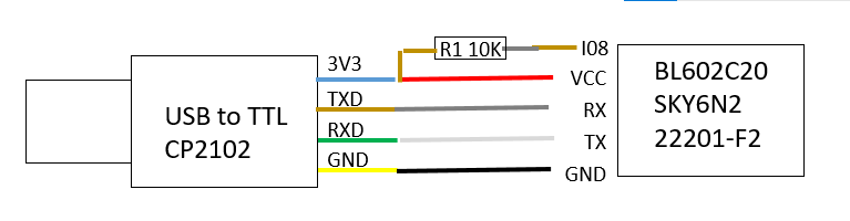

  • BL602 flashing steps and boot pin wiring

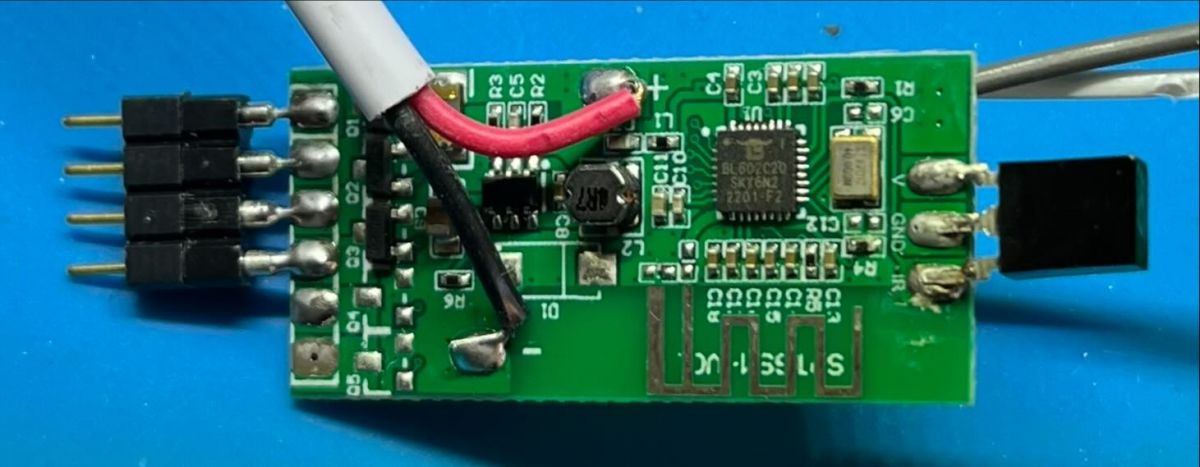

    #324 20552790
    pechevef
    Hello, my name is Paco, I'm from Spain and this is my first message in this forum
    This project and this topic is very interesting for me.
    I bought a RGB LED strip with IR remote control and WiFi like this in AliExpress ( Link )
    I expected it to be compatible with Magic Home, to be able to integrate it into Home Assistant, but the suggested app to handle it was TechLife Pro, which cannot be integrated into Home Assistant
    II thought about flashing Tasmota for it, but it's not compatible either
    I disassembled the controller and found that it has BL602C20 chip

    I finally found this thread, which has the instructions to get it able to flash and integrate it into Home Assistant locally
    I have read the whole thread, but I haven't quite found the specific instructions to be able to flash the device, but on the OpenBK7231T_App github page there is a lot of information to get started
    My first step was to follow the instructions in the Russian guide BL602 RGB (Link)
    My device is not exactly the same, but it is very similar, and I followed the proposed steps:
    1.- Solder wires to the exposed pins (VCC I08 RX TX GND) There is another pin labeled RES, which must be to RESET the board. I have not used it. I have assumed that the I08 pin corresponds to the Boot PIN, since I have read that the GPI08 must be activated to put the chip in flashing mode
    2.- Connect the device to a USB-TTL adapter with a resistor to activate the flashing mode. I have followed this scheme:
    3.- I downloaded the components suggested in that guide (BL602.zip, which includes the flashing program BLDevCube.exe) and the firmware OpenBL602_1.15-406.bin
    4.- Connect the TTL to my Windows PC and run the BLDevCube.exe utility, replacing the files with those corresponding to the locations on my hard drive and select the COM6 port that appeared to connect the USB-TTL
    5.- When clicking Create and Download, the following error message appears ERROR : {"ErrorCode":"0069","ErrorMsg":"BFLB FLASH ID NOS SUPPORT"}
    I tried again with the last firmware OpenBL602_1.17.29.bin with the same result
    The Log File is:

    [20:39:14.951] - [param]
    interface_type = "Uart"
    comport_uart = "COM6"
    speed_uart = "2000000"
    speed_jlink = "1000"
    bl60x_brd = "IoTKitA"
    bl60x_xtal = "40M"
    aes_key = ""
    aes_iv = ""
    addr = "0x0"
    [check_box]
    partition_download = true
    boot2_download = true
    bin_download = true
    media_download = false
    use_romfs = false
    mfg_download = false
    ro_params_download = true
    ckb_erase_all = "False"
    encrypt = false
    download_single = false
    [input_path]
    pt_bin_input = "C:\\...\\partition\\partition_cfg_2M.toml"
    boot2_bin_input = "C:\\...\builtin_imgs\\blsp_boot2.bin"
    cfg2_bin_input = "C:\\...\\OpenBL602_1.17.29.bin"
    meida_bin_input = ""
    romfs_dir_input = ""
    mfg_bin_input = ""
    img_bin_input = ""
    [20:39:14.957] - ========= Interface is Uart =========
    [20:39:14.969] - eflash loader bin is eflash_loader_40m.bin
    [20:39:14.972] - ========= chip flash id: ef4015 =========
    [20:39:14.974] - flash_id:ef4015 do not support
    [20:39:14.976] - ========= chip flash id: ef4015 =========
    [20:39:14.977] - flash_id:ef4015 do not support
    [20:39:14.978] - Please check your partition table file
    I think the problem could be that the chip is BL602C20, and that it is not exactly the same as the BL602L20 chips in other devices. The partition table file
    I have also studied Youtube tutorials "Magic Home BL602 RGB LED Strip programming with OpenBeken - new Tasmota/Esphome port style firmware" and "How to flash new Sonoff BL602 bulb B05-BL-A60 - 100% free from cloud guide and BP5758 configuration" , but I have not found a solution or that I have done something wrong
    Does anyone have any clue what could happen?
    If I manage to solve it, I will document it and write a teardown. Thanks in advance

  • #325 20553122
    Posts: 14770
    Rate: 12913
    Hello, I haven't checked myself, but I've seen comments in this thread saying that it can be flashed with a newer version of BLDevCube.exe . I am not sure yet. Maybe someone like @Zain00 can know more about it.
    Btw you can also do a firmware read (backup) first with BLDevCube.exe as well. Just in case that something goes wrong.
  • #326 20560067
    pechevef
    Thank you very much for your answer
    I have I have found a new version of BLDevCube.exe at https://dev.bouffalolab.com/download
    I have tried flashing the chip with this new version and the same files as suggested in the Russian guide, except OpenBL602_1.17.29.bin and it seems to have worked, no errors

    Issue with flashing resolved. Tasmota replacement for BL602, programming, pairing with Home Assistant, now with OTA working!
    Does anyone know why i got weird ip. Not 192.168.4.1?

    Hello, how did you resolve flash issue?
    It seems that BL602 is still using non-standard IP, just like it's mentioned earlier in this topic and on our YT videos:
    https://www.youtube.com/watch?v=L6d42IMGhHw
