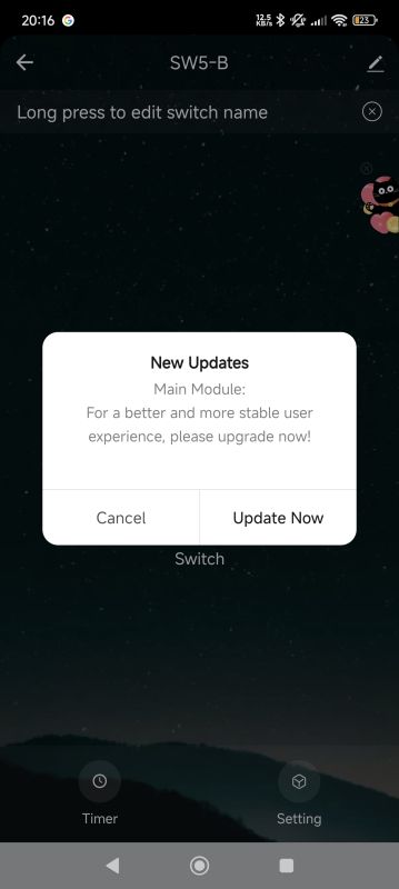

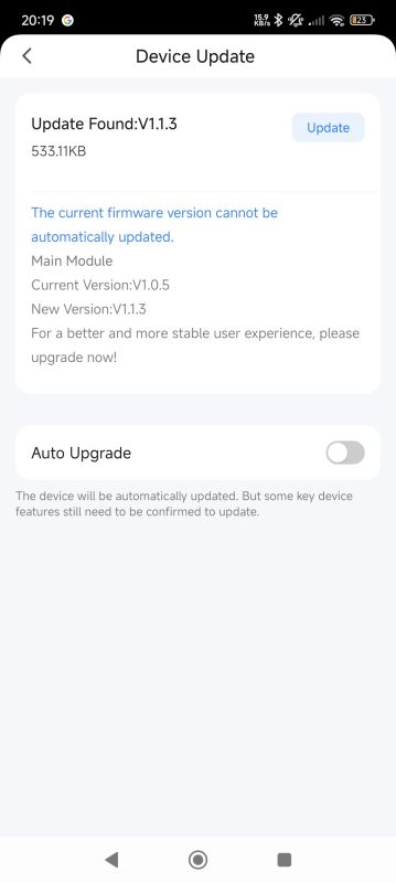

    But perhaps the most interesting bit is that this is the first LN882H firmware we have that offers an OTA upgrade
    The Tuya dev API Explorer gives us this info with device paired
    showing the OTA bin is to be downloaded from https://images.tuyaeu.com/smart/firmware/upgr...ay1605149472695Vxa2/1742027683b313abb8468.bin
    data model
    Main module update prompt in a smart switch app for device SW5-B Device update screen showing firmware version V1.1.3 available
    post-upgrade v1.1.3 boot log to pairing mode
    https://github.com/openshwprojects/FlashDumps/pull/39/files
