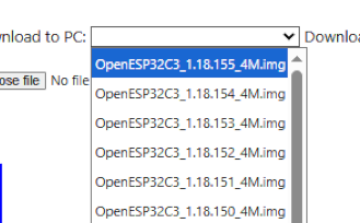

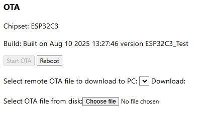

    consistently getting this with OTA on C3. OTA successful though
    Reboot reason: 4 - ESP_RST_PANIC
  • #184 21637891
    Posts: 14797
    Rate: 12954
    Any way to check at runtime which version we have? Then we could filter to show only matching.
  • #185 21638169
    Posts: 5236
    Help: 450
    Rate: 920
    ah, no change
    ESP32C3 OTA interface with file selection and Reboot button
    I guess the post fixes would need to be _2M.img/_4M.img but then how to catch both?
    Firmware file list for OpenESP32C3 with version numbers and 4M suffix shown in dropdown
    I don't see any evidence the 2 and 4mb builds identify themselves as such.

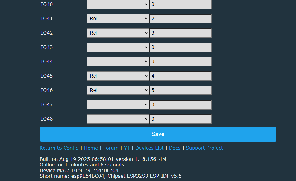

    #192 21639704
    Posts: 14797
    Rate: 12954
    I am testing OpenESP32 S3 on ESP32-S3-Relay-6CH. So far good, but I got reboot after saving pins.
    ESP32S3 pin configuration interface with relay roles assigned
    ESP_RST_PANIC
    Hm I can reproduce it by saving pins.
    Info:MAIN:Time 46, idle 0/s, free 212992, MQTT 0(3), bWifi 1, secondsWithNoPing -1, socks 0/0
    Info:MAIN:Time 47, idle 0/s, free 212992, MQTT 0(3), bWifi 1, secondsWithNoPing -1, socks 0/0
    Guru Meditation Error: Core  0 panic'ed (LoadProhibited). Exception was unhandled.
    Core  0 register dump:
    PC      : 0x4003b6d2  PS      : 0x00060830  A0      : 0x82083acc  A1      : 0x3fcb3ec0
    A2      : 0x3fcef358  A3      : 0x3fcbe5a8  A4      : 0x00000064  A5      : 0x00000017
    A6      : 0x00000030  A7      : 0x3fcef264  A8      : 0x3fcab8dc  A9      : 0xfa0f830a
    A10     : 0x00000002  A11     : 0x3fcbe5a8  A12     : 0x0001f000  A13     : 0x02000000
    A14     : 0x6003427c  A15     : 0x0000cdcd  SAR     : 0x0000000a  EXCCAUSE: 0x0000001c
    EXCVADDR: 0xfa0f830c  LBEG    : 0x40056f5c  LEND    : 0x40056f72  LCOUNT  : 0xffffffff
    Backtrace: 0x4003b6cf:0x3fcb3ec0 0x42083ac9:0x3fcb3ee0 0x420a25c6:0x3fcb3f00 0x40387856:0x3fcb3f30 0x4038739f:0x3fcb3f70 0x403874b5:0x3fcb3f90
    ELF file SHA256: 87ea6781a
    Rebooting...

    Added after 31 [minutes]:
      "vendor": "Tuya",
      "bDetailed": "0",
      "chip": "ESP32S3",
      "board": "TODO",
      "flags": "1028",
      "keywords": [
        "TODO",
        "TODO",
        "TODO"
      "pins": {
        "1": "Rel;0",
        "2": "Rel;1",
        "41": "Rel;2",
        "42": "Rel;3",
        "45": "Rel;4",
        "46": "Rel;5"
      "command": "",

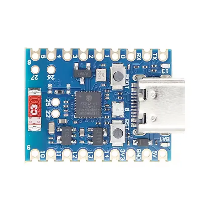

    insmod wrote:
    ESP32-H2
    got a Super Mini H2 for the collection
    Super Mini H2 board with ESP32-H2 chip and USB-C connector

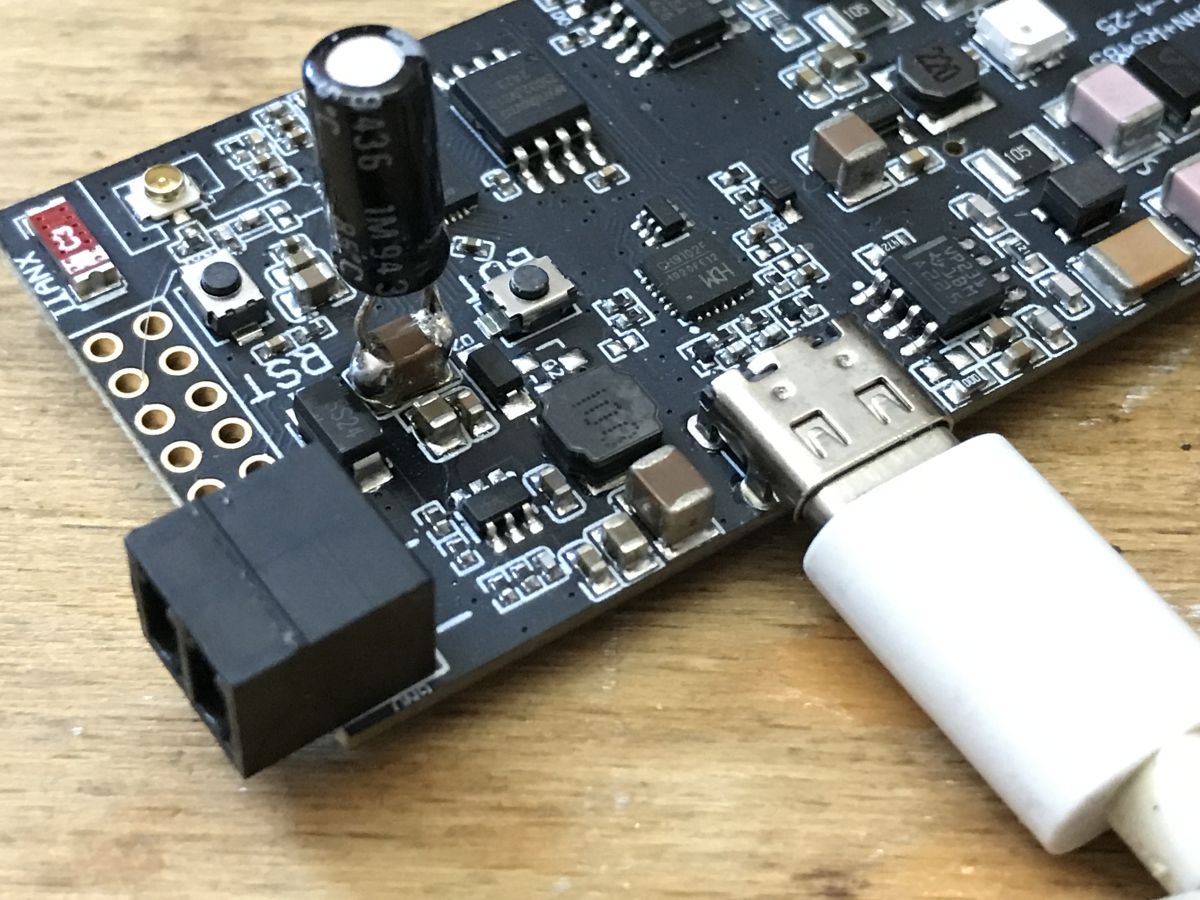

  • Extra 3.3V capacitor may fix brownouts
    #204 21648392
    Posts: 14797
    Rate: 12954
    I might have had somewhat similar issue with LilyGo T-Can485. Random brownouts on start and not stable WiFi. It was reproducible with multiple firmwares and on another site. The solution was to solder extra capacitor on the 3.3V rail.
    Close-up of LilyGO board with soldered capacitor and USB cable
    Can you try something similar? Just avoid too large capacitance as well... so you won't overload USB port. How your board looks like, which board model do you have?

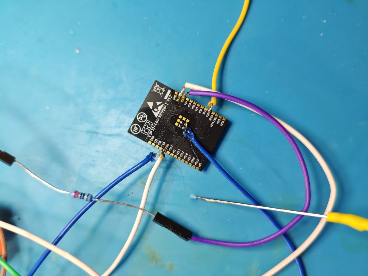

    >>21643657
    from factory boot loops with
    I assume it's blank
    download mode = EN high, IO8 high, IO9 low
    ESP32-C6 module connected to colored jumper wires on a blue work mat.
    flash is blank

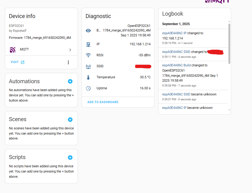

    Cool. Just saw https://developer.espressif.com/pages/chip-support-status/esp32c61/

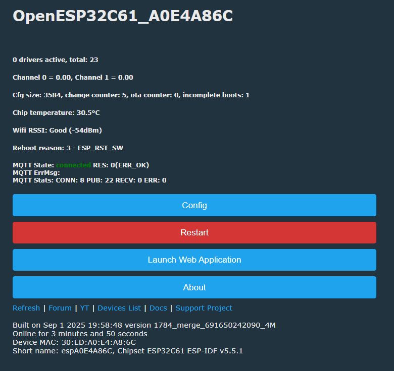

    Added after 2 [hours] 30 [minutes]:
    first boot
    User interface showing ESP32C61 device status with hardware, MQTT information, and configuration options.
    User interface of the ESP32C61 monitoring system showing diagnostics and event log.
    ota
    doesn't see 5Ghz AC-only AP and won't blindly join it either
