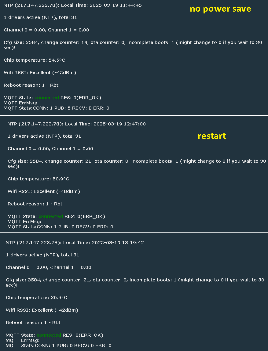

    Powersave activate.
    The temperature drops quite compared to when it was working without powersave, I will confirm automatisms operation on HA
    Screenshot displaying diagnostic data of a device, including temperature, WiFi signal, and MQTT connection status.
    Thanks again for the information.

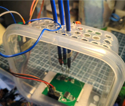

    Thought of sharing my new setup for flashing here as well so that others also can get some inspiration.
    Some time back I ordered these probles/needles from Aliexpress.
    https://www.aliexpress.com/item/1005007471008008.html
    Those are essentially some metal rods with pogo pins at one end and a female jumper wire headers at the other end.
    So I created a small setup like this:
    PCB under pogo pins mounted through holes in a plastic container lid
    I was hoping to get a nice stand made with acrylic sheets later but for the time being this works.
    The vertical probes rest on the solder pads/pins using their weight and the pogo needle points.
    Close-up of four pogo pins touching pads on a printed circuit board with a microcontroller.
    It takes some skill in accurately positioning the needle points of the pogo pins.
    For Power I used a 1.27mm female pin header to directly connect to the pin header on the PCB so that no soldering is required.
    I managed to flash a bunch of T34 devices quickly today using this setup (one device has some issue though).

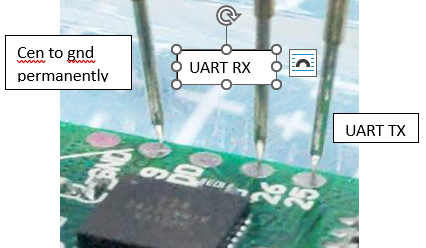

    >>21619518 Hello, i have same board as you I'm not able to even read flash. how did you connect? just connect cen to ground, or did something else? I have separate 3,3v power supply I have tried also https://github.com/libretiny-eu/ltchiptool/releases did you tried?
    Thanks
    Actually the CEN trick did not work.
    What worked for me was to lift the TX Probe on and off the pad few times in my setup above and the communication got triggered.
    I still have not been able to recover the dead unit but others are ok.

    >>21636218 so you had setup like
    Probe connected to UART RX, UART TX, and CEN pins on a PCB.
    and you played with tx uart probe? I have 2 of these boards but no luck:( any idea?
    Yes, it was not intentional but accidentally discovered that the make/break connection established the communication. To this date I haven't gone back to check what really happened as I had few units to be flashed and got them flashed in one go.

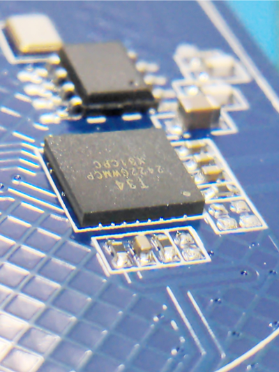

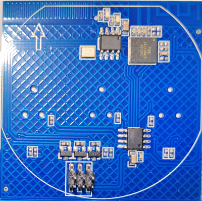

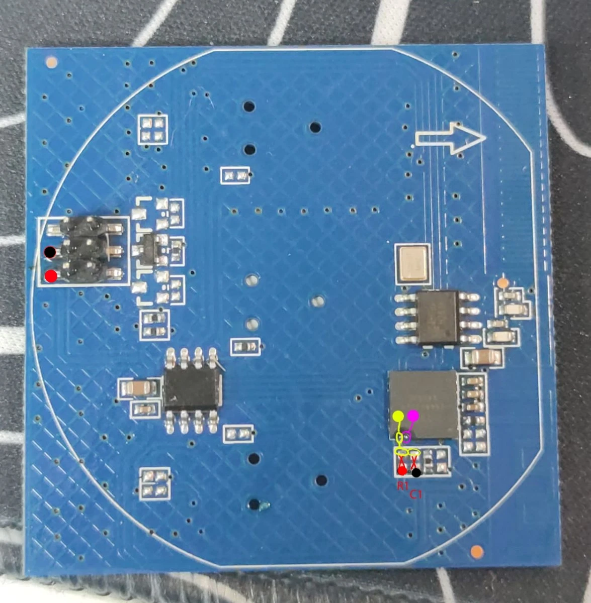

  • Question about flashing BK7231N via exposed traces
    #107 21689976
    jbolanosg

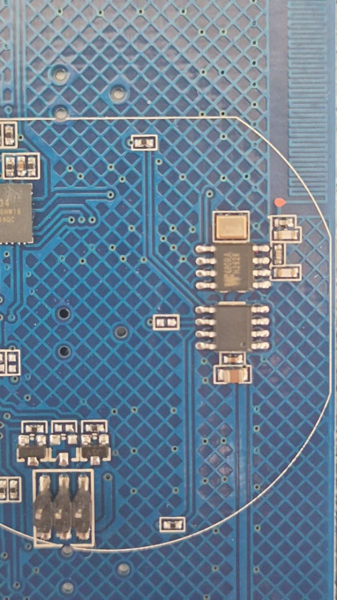

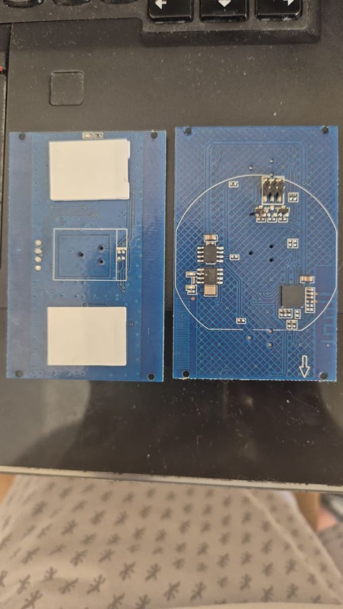

    >>21117203 I just bought 3 similar switches from the green box, but the board is a little different. I’m attaching images… Does anyone know if there’s a way to change the firmware without removing the chip? The chip is way too small to do it with needles… Would it be possible to find pins 25 and 26 on the traces and connect to them?
    Two blue PCB modules with electronic components and contact pads
    Close-up of a blue circuit board with microchip and conductive traces
    Close-up of a blue PCB with integrated circuit, SMD parts, and conductive traces
    Close-up of a blue PCB with ICs, soldered components, and circuitry traces

    jkwim
    Posts: 186
    Rate: 25

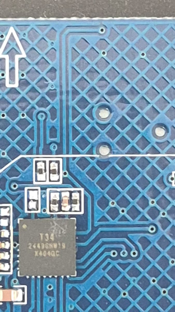

    >>21689976 I also have a recently purchased 3-Gang unit which has a T34 soldered like this. Haven't done anything with it yet.
    Blue PCB with surface-mounted components and a white circular outline
    Close-up of a microchip and components on a blue PCB circuit board
    Wonder whether this will help:
    https://www.elektroda.com/rtvforum/topic4036975-30.html#21049093
    And this one of course
    https://www.elektroda.com/rtvforum/topic4036975-60.html#21117203

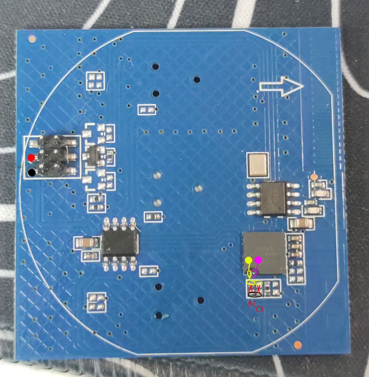

  • #109 21694097
    Posts: 5217
    Help: 448
    Rate: 917
    are 26/27 routed out anywhere from the chip?
    Diagram of BK7231N chip orientation and pinout with a photo of the chip.

    >>21694097 in my case, only P26 routed outside. But it possible reach P20-P23 if remove RF MCU. If it possible flash via P20-P23?
    Thanks!

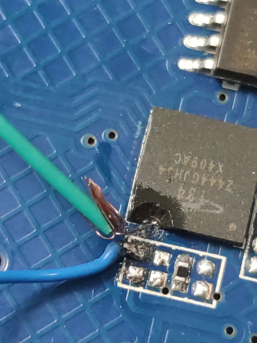

    Sllaci01

    >>21656671
    I have successfully updated three of these switches.

    #116 21825374
    arthur_koba
    I thought this might be useful to someone. I bought a smart touch switch, but couldn't find any wiring examples, so I'm sharing my method. The idea of ​​desoldering the processor and reflashing it isn't exactly appealing to me. It's too complicated and tedious. But drilling down to the contacts with a Dremel is quite a good idea, so that's what I ended up using.
    By the way, I borrowed this meI thought this might be useful to someone. I bought a smart touch switch, but couldn't find any wiring examples, so I'm sharing my method. The idea of ​​desoldering the processor and reflashing it isn't exactly appealing to me. It's too complicated and tedious. But drilling down to the contacts with a Dremel is quite a good idea, so that's what I ended up using.
    By the way, I borrowed this method from >>21741840 and modified it a little by soldering one wire core. Now for the basic board information: I've marked VCC (3.3v) and GND on the connector. I've also marked the processor's RX and TX pins in yellow and purple, respectively. However, it is important to note that the board originally had a resistor R1 and a capacitor C1 (together an RC circuit), which distorted the signal from my USB TTL converter. It took me a long time to figure out why the processor wasn't flashing, but when I connected the oscilloscope, everything became clear to me. I soldered them out and the firmware started to flash. As I understand it, they were specially added to distort the signal and they can not be returned after flashing. And yes, for the RX firmware, the wire can be soldered to the upper solder contacts of the resistor and capacitor. The lower one can be used as GND. But the TX line is not connected to anything, you either need to get to the contact with a needle or a thin wire, or, like me, just take off part of the processor case with a nap, seal the contact and solder. Good luck with the firmware.
    Close-up of blue PCB with green and blue wires soldered onto it
    [BK7231N / T34 ] Teardown Tuya Generic Wifi Wall Light Switch 3 Gang
    Update. If you have a squeak on a board with relays and AC/DC and it is critical for you, it is solved by adding a capacious capacitor (I used 200uF+) between GND and 3.3V (I soldered the capacitor to the terminals of the connector connecting the two boards). Also, AC/DC can also emit a squeak at low load due to sleep mode, I solved this by connecting a quenching resistor (330 ohms) between GND and 12V, as well as reducing the capacitor capacity of this line from 1000uF to 200uF. Now the whole system works almost silently... I can only hear the treble beep when I bring the switch to my ear, from 50 cm I can no longer hear it even if I listen.
    • readResult_BK7231N_QIO_touch-light-switch_2026-31-1-19-42-05.bin (2 MB) You must be logged in to download this attachment.
  • #117 21923087
    Blisk
    Posts: 50
    I just can't flash anything anymore, I have T34 chip which I flashed 7 of them before, but now not possible anymore, I checked connection and all is ok, any idea? I laso changed USB TTY and it is the same.
  • #118 21923095
    Posts: 14768
    Rate: 12909
    Is your USB to UART converter broken? Have you tried another one? If by "changed USB TTY" you mean you have tried another one, then maybe something on PC side?
  • #119 21923122
    Blisk
    Posts: 50
    >>21923095 yes I have 3 more and tested all of them and flashing doesnt work. I tried on my PC and laptop and it is the same, just doesn't work.
  • #120 21923353
    Tilator
    Posts: 139
    Rate: 13
    >>21923122
    Are they exactly similar to those you flashed before?
    Or is it possible, the connections are different on the motherboard. It only takes for example one more capacitor connected to TX or RX line and flashing is prevented.
    Chinese manufacturers change them all the time.
