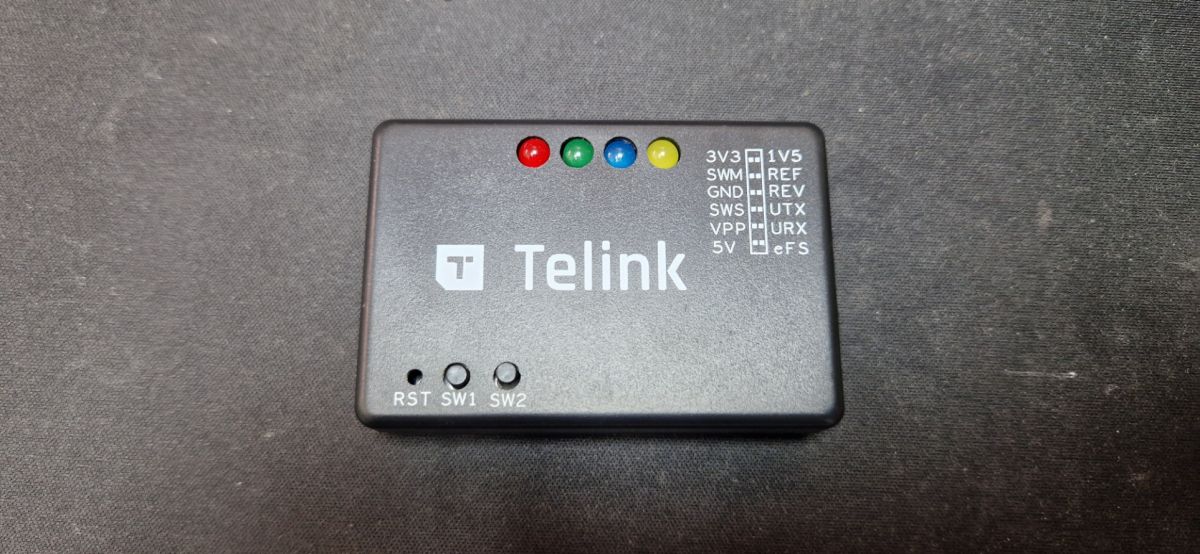

  • #12 21736518
    DeDaMrAz
    Posts: 620
    Help: 34
    Rate: 130
    This arrived today
    Black Telink programmer with LED indicators and labeled pinouts
    windows version - https://doc.telink-semi.cn/tools/telink_iot_studio/TelinkIoTStudio_V2025.2.zip
    linux version - https://doc.telink-semi.cn/tools/telink_iot_studio/Telink_IoT_Studio_2025.2_Installer.run
    So let's see what we can do with this, but still waiting for the dev boards to arrive.

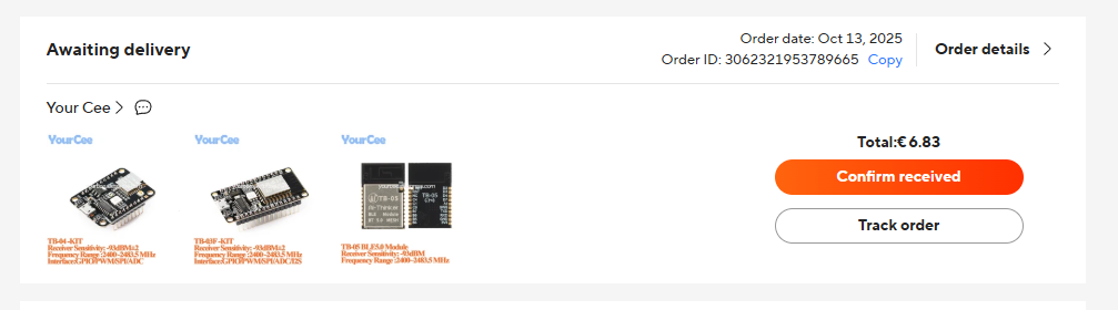

  • #13 21773456
    DeDaMrAz
    Posts: 620
    Help: 34
    Rate: 130
    Order awaiting delivery with three YourCee electronic modules displayed
    Still waiting for these dev boards to arrive.... but I think I'll order some new ones
