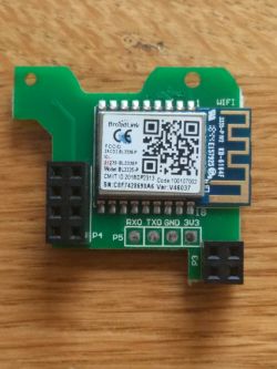

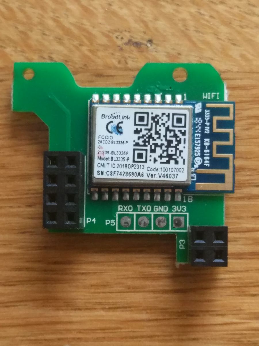

RDA 5981AM/Broadlink BL3335-P - Generic/nobrand 15W RGBW B22 Bulb - basic teardown

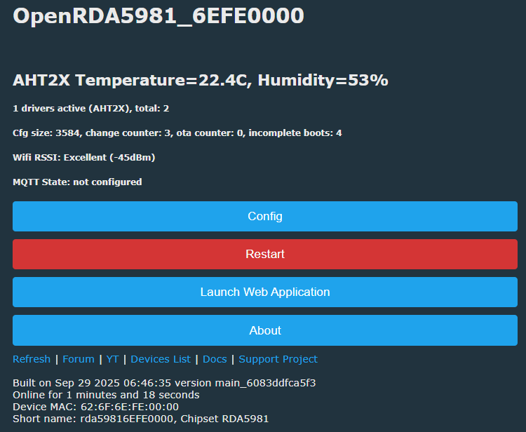

    insmod wrote:
    Does AHT2X print anything now?
    OpenRDA5981 system interface showing temperature and humidity data

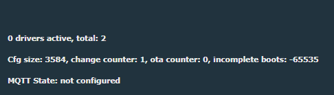

  • Incomplete boots increment on every reboot
    #161 21703961
    Posts: 5214
    Help: 448
    Rate: 916
    insmod wrote:
    Why is there 4 incomplete boots though?
    unsure of my exact steps, but every reboot adds +1 incomplete reboot until safe mode. then it'll always go into safe mode again on reboot even if you exit safe mode first.
    this is after running aht2x driver (ad-hoc - not in startup command), I'll wipe and see if incomplete count changes with no driver ever being run
    Added after 4 [minutes]:
    first boot after flash
    second
    etc
    so actually, nothing to do with driver running

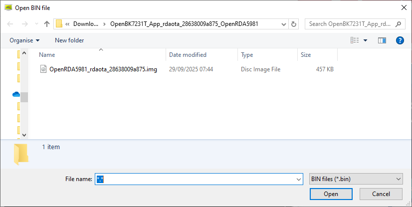

    insmod wrote:
    first boot
    second and all after = incomplete boots: 1
    OTA with same build =
    Added after 9 [minutes]:
    a small side-effect of changing build file extension to .img is that the RDA tool only allows *.bin so requires manual *.* reveal first. just a point of note
