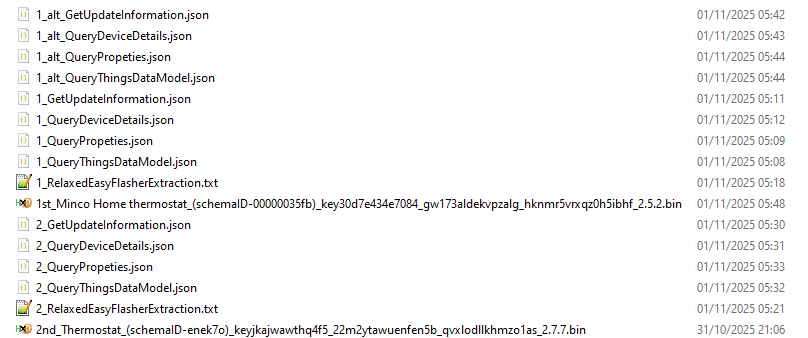

    Added after 3 [minutes]:
    And this is the config from the newer unit along with its firmware backup
    Info:CMD:[WebApp Cmd 'tuyaMcu_sendQueryState' Result] OK

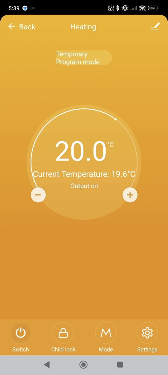

    • readResult_RTL87X0C_2025-30-10-21-53-24.bin (2 MB) You must be logged in to download this attachment.

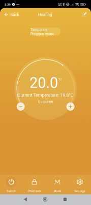

  • Requesting a working OpenBeken thermostat config base
    #32 21737264
    gandi69
    Posts: 99
    Does anyone have a config I can use a base from another thermostat maybe?
    mine is currently like this yet it doesnt really behave itself:

    I don't know if this'll help but here something new:
    I've started again with each backup, pairing with the product key the MCU sends for each device. On initial pairing of the backup you sent me, the motif was grey again, but I noticed in the Get Update Information return from Tuya that a different firmware key (not product key - firmware key always starts with "key") was listed - key30d7e434e7084 instead of keyjkajwawthq4f5. keyjkajwawthq4f5 is seen in the boot log of your 1st device.
    Upon second pairing (in this session - probably 4th/5th total) the motif is now yellow in the app. I can't explain why.
    App screen for heating control showing 20.0°C set temperature
    BUT the schema remains the same. So seemingly nothing else to go on with that.
    I made a gandi69 pack of each firmware dump (1st one is new reset dump) alongside the raw responses from Tuya for each. 1_alt named json files are the yellow motif session responses.
    Ultimately might not help where you're at now, but it's at least a bunch of resources.
    List of JSON and BIN files related to thermostats and device data
    backup file naming logic is xxxx_<firmwarekey>_<productkey>_<factory_pin>.xxx.bin
    • gandi69_thermostats.zip (1.9 MB) You must be logged in to download this attachment.
