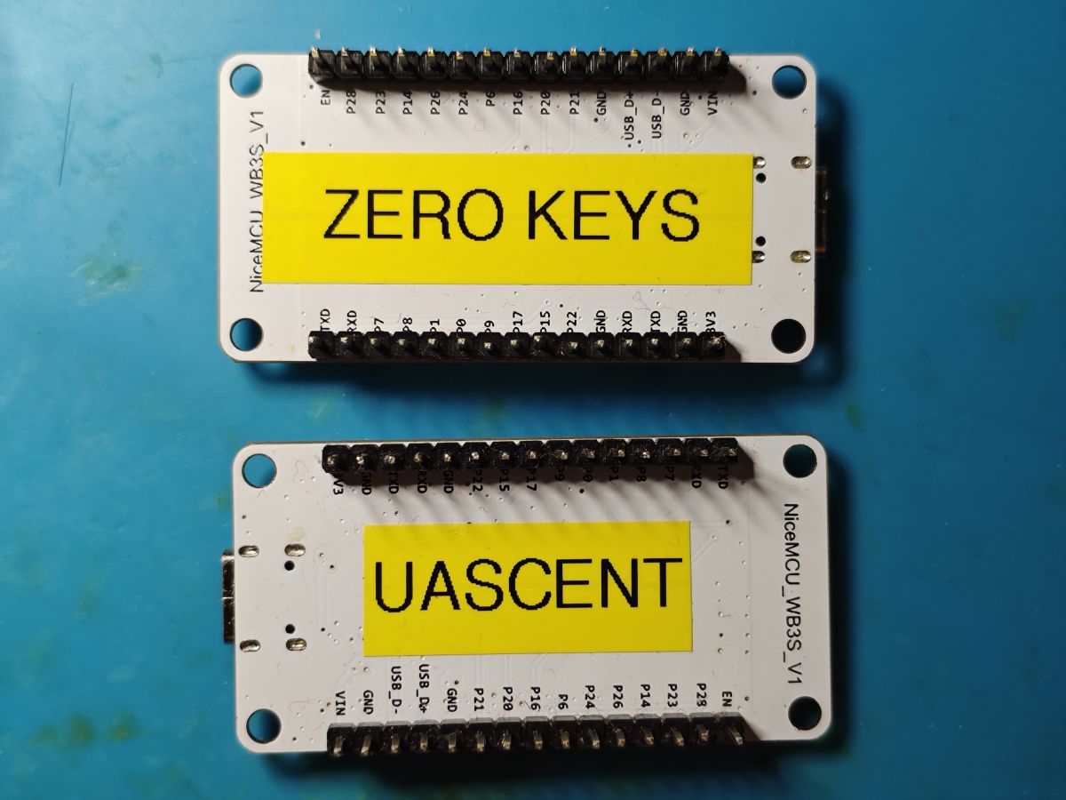

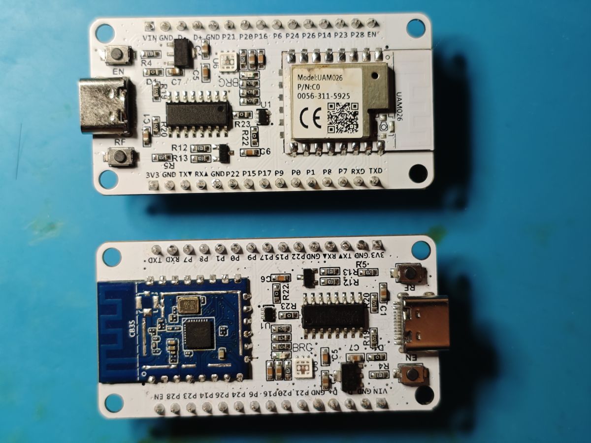

    M_ALT does boot on zero-keys BK7231N module. OTA does work
    OpenBK7231M_ALT_QIO_1.18.206.bin -> OpenBK7231N_1.18.204.rbl
    old-SDK M QIO does not boot still because of this: https://www.elektroda.com/rtvforum/topic4107851.html#21725511
    PR not submitted for change yet
    These are test devices btw
    Uascent key = blue CB3S from Matter mini switch
    Zero key = white UAM026 from Uascent bulb (yes a Uascent with zero keys)
    Two NiceMCU WB3S_V1 modules on a blue background with yellow labels. Two microcontroller boards on a blue surface, with USB-C ports and wireless modules
    Added after 4 [minutes]:
    >>21737614
    this does not boot on M
    UAM026 = BL2028N https://www.elektroda.com/rtvforum/topic4111089.html#21477454

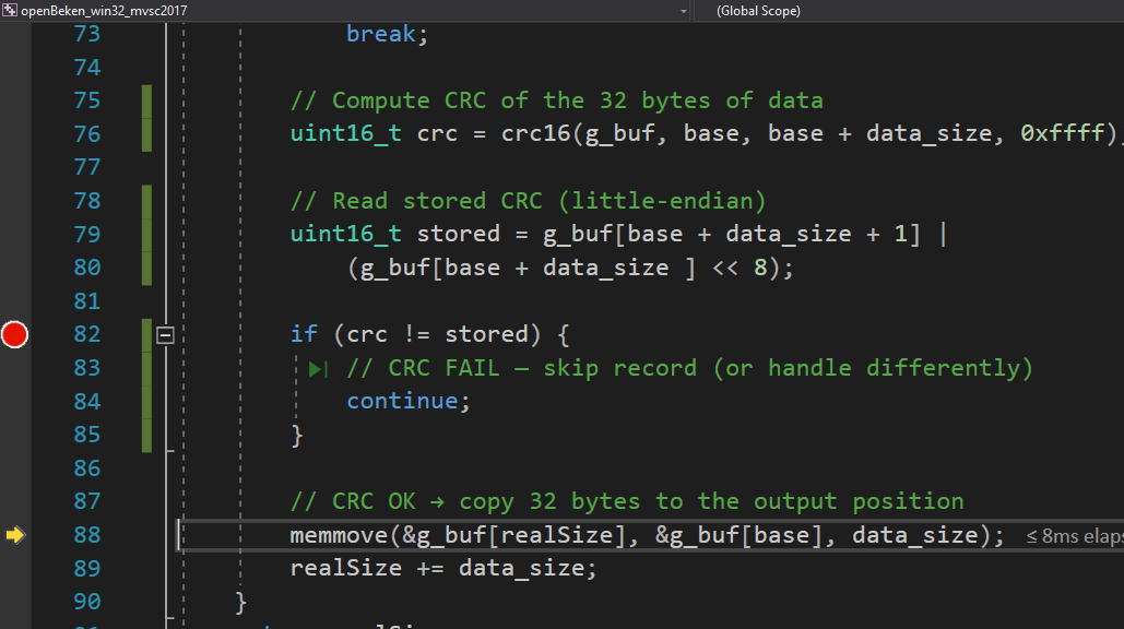

  • #44 21737851
    Posts: 14622
    Help: 655
    Rate: 12641
    I think I can add it to Easy Flasher as well. Still, first I want to verify the CRC - do you have a correct CRC16 implementation for that at hand?
  • #45 21737853
    Posts: 5068
    Help: 438
    Rate: 894
    well, the uncrc.py I've been using to date appears to have worked without issues on the many dumps I've played with this past week. Does that provide enough info/confirmation of what you require?
    Code: Python
  • #46 21737854
    Posts: 14622
    Help: 655
    Rate: 12641
    nevermind, i got it
    C code verifying CRC and copying data, with memmove() line highlighted.
    Your uncrc does not actually check the CRC. So you can run it with any data and it will work blindly.
    You should rather code:
    Code: C / C++

    Also ,it seems that not all data is CRCed. For me this check begins to fail at 57528 offset.
