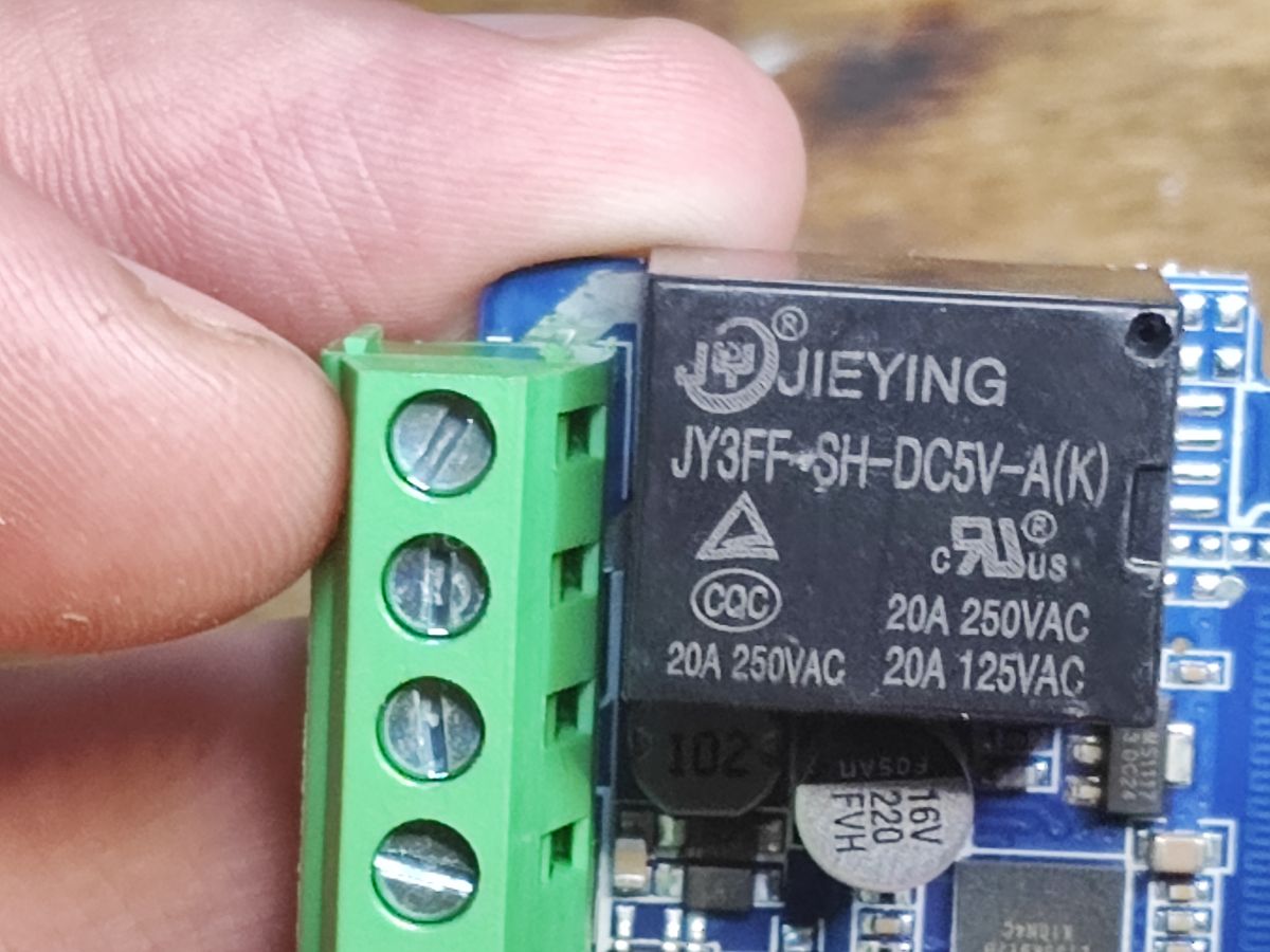

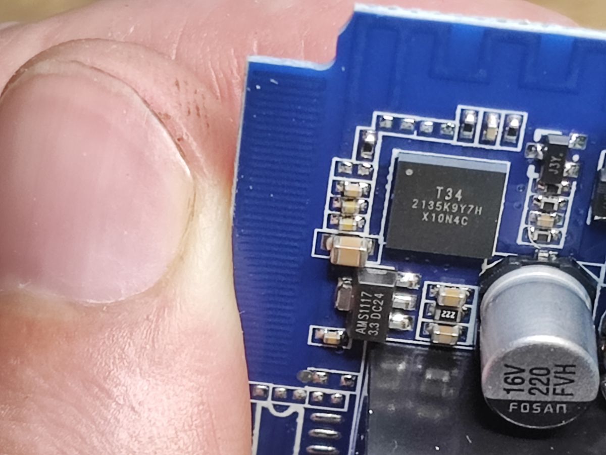

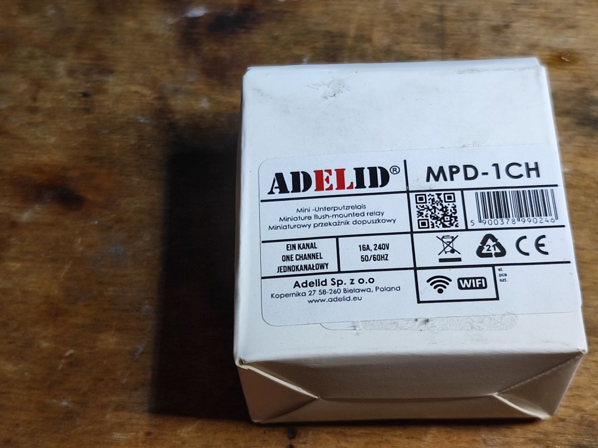

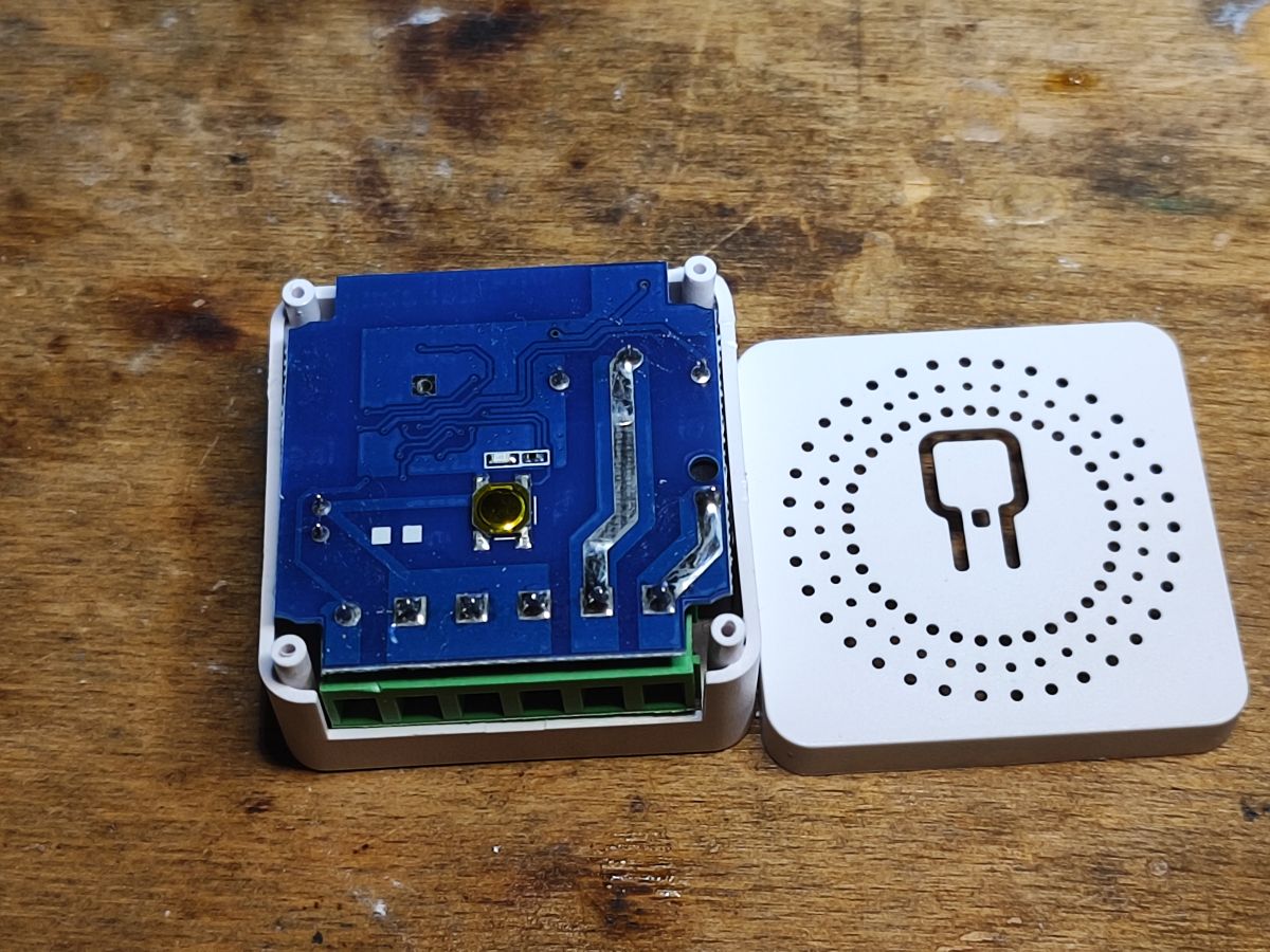

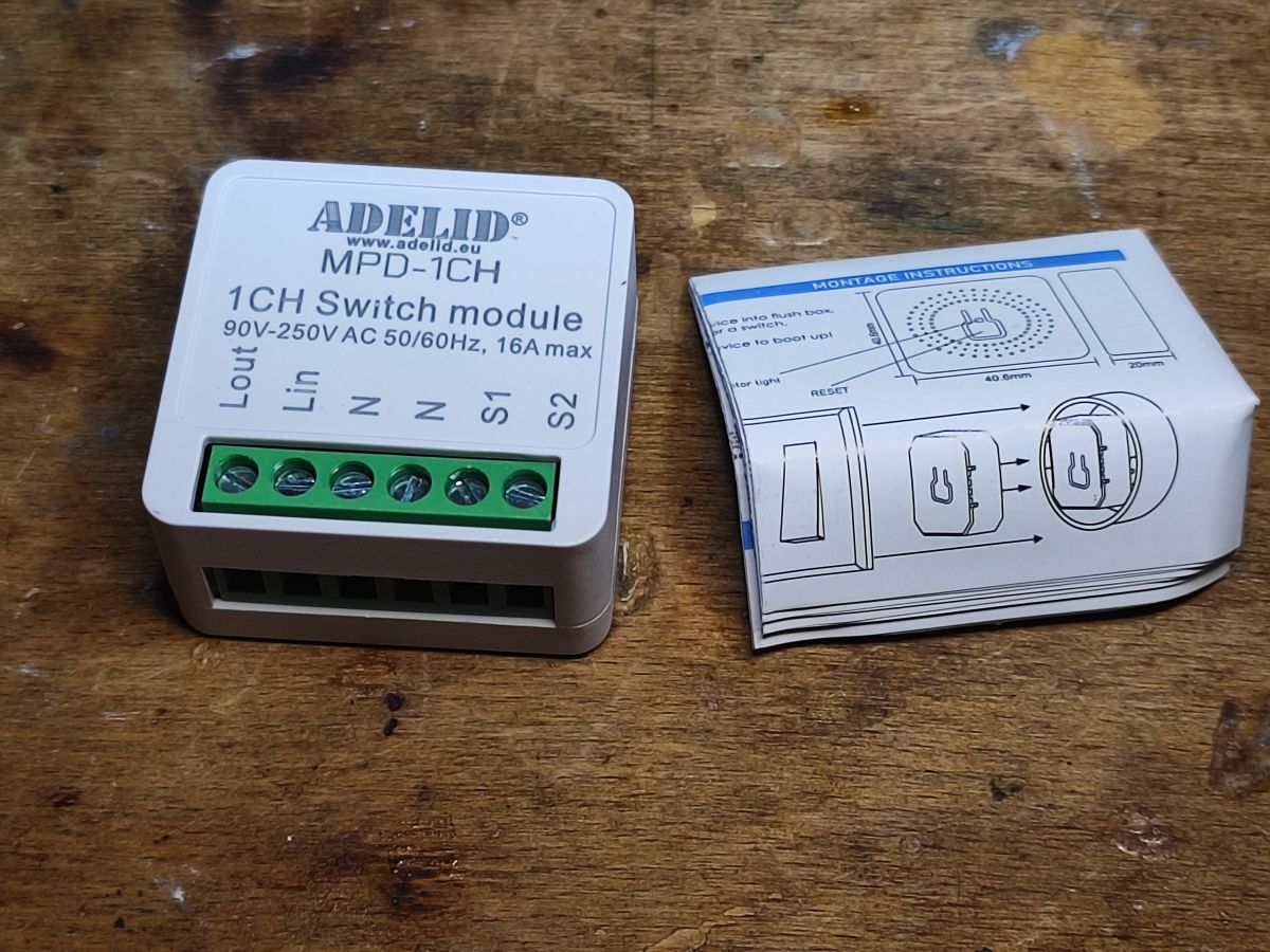

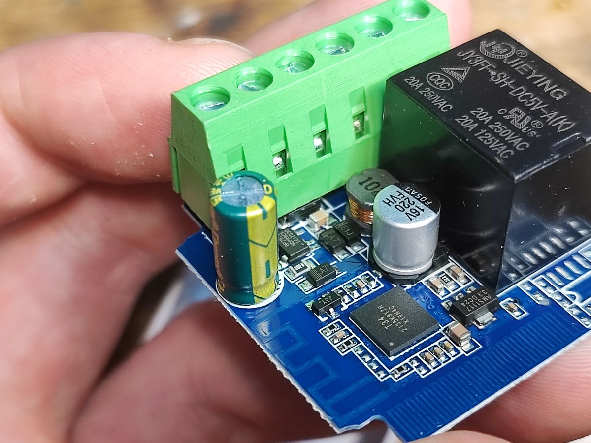

    Another T34, I don't think I've shown this one before, this time from a Polish importer - Adelid, model MPD-1CH (clone!):
    Adelid MPD-1CH relay box on wooden surface, product label clearly visible Adelid MPD-1CH switch module with wiring diagram insert on a wooden surface
    Close-up of JIEYING JY3FF-SH-DC5V-A(K) relay on blue PCB Close-up of T34 chip on blue PCB with 16V 220µF capacitor and SMD components MPD-1CH electronic module with open case on wooden surface Close-up of MPD-1CH PCB with relay and green screw terminal block
    WiFi module switch Adelid MPD-1CH with Tuya app shown on a smartphone

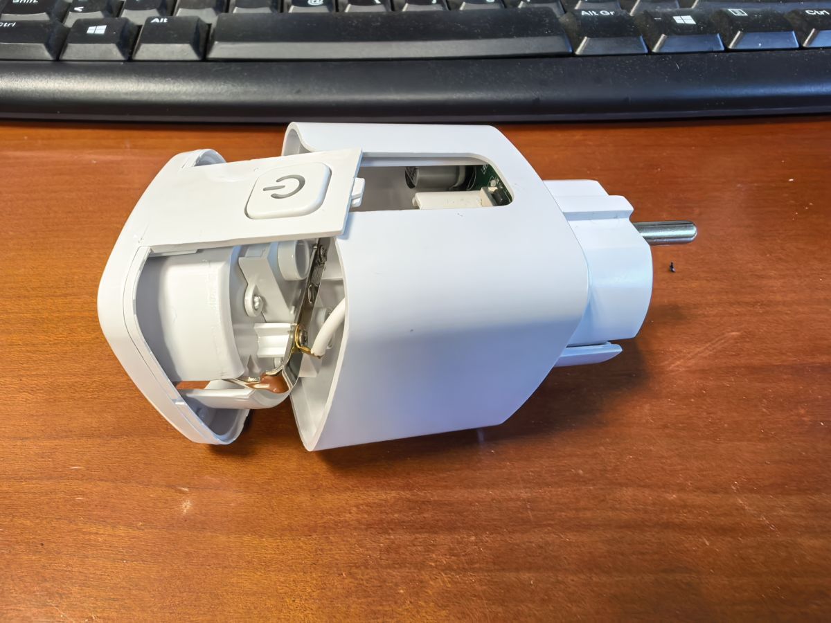

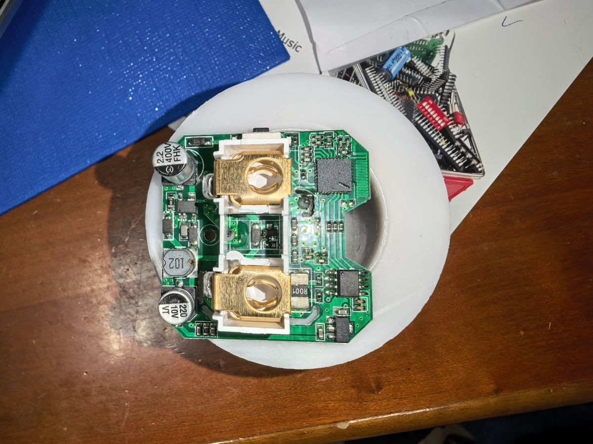

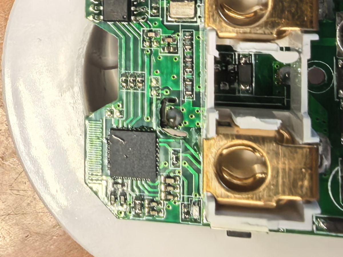

    Now I have intent to flash openbeke on my smart power plug. Connect directly wires and flash it, I need to find 3.3V on board, any idea, and I think those 2 pins are RX and TX at the top of the chip, also need measure it. Have anyone advice what should I be carefull and how to do it? Do I need to connect 5 times power on and off to flash it or put GPIO0 on ground?Changing firmware increasingly difficult? Smart Switch on T34 and QFN soldering Changing firmware increasingly difficult? Smart Switch on T34 and QFN solderingChanging firmware increasingly difficult? Smart Switch on T34 and QFN soldering
