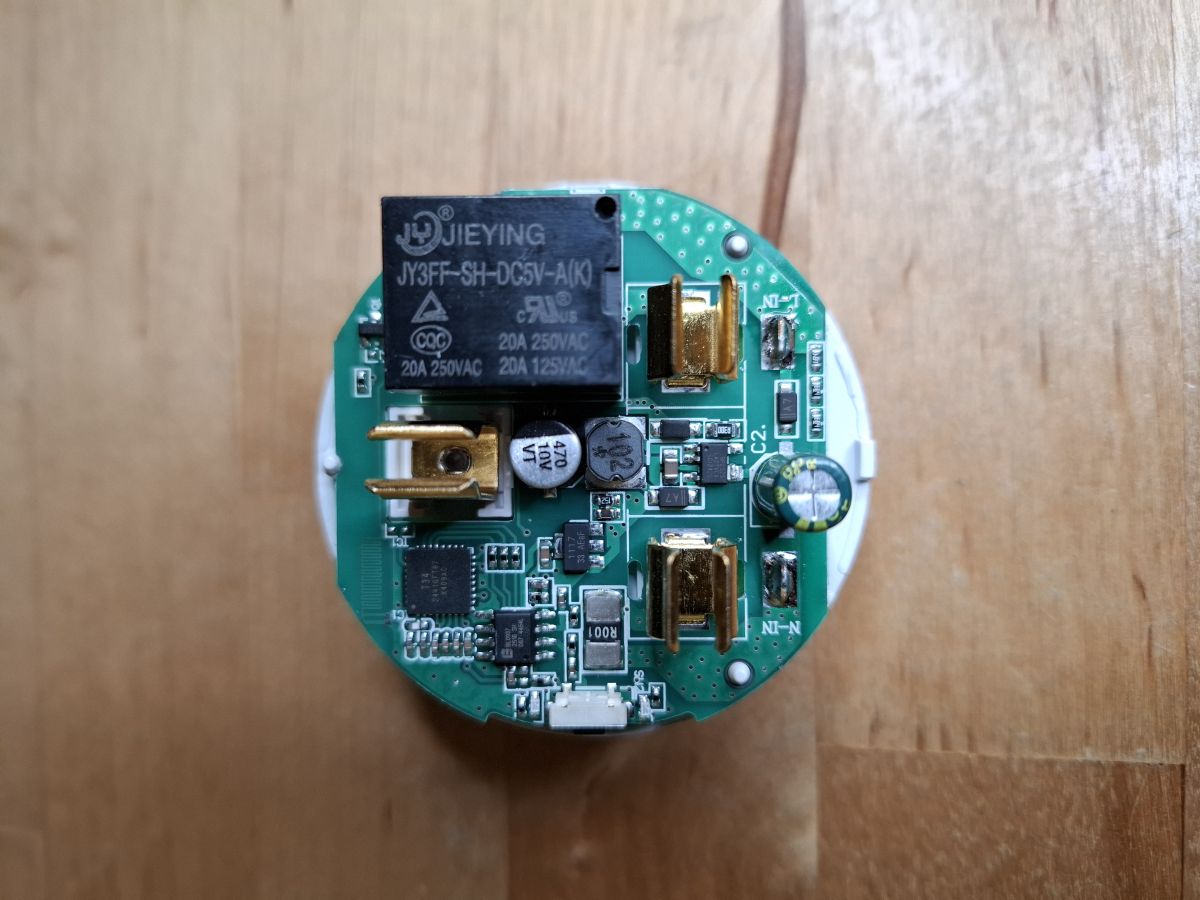

    I bought a new one to play with and it came with a different chip to the others I have. Turns out this one is a single chip T34 based plug.
    After opening the case with the gentle use of a vice to crack the casing joint, this is what it looks like inside...
    Internal view of smart plug with exposed electronics and JIEYING relay

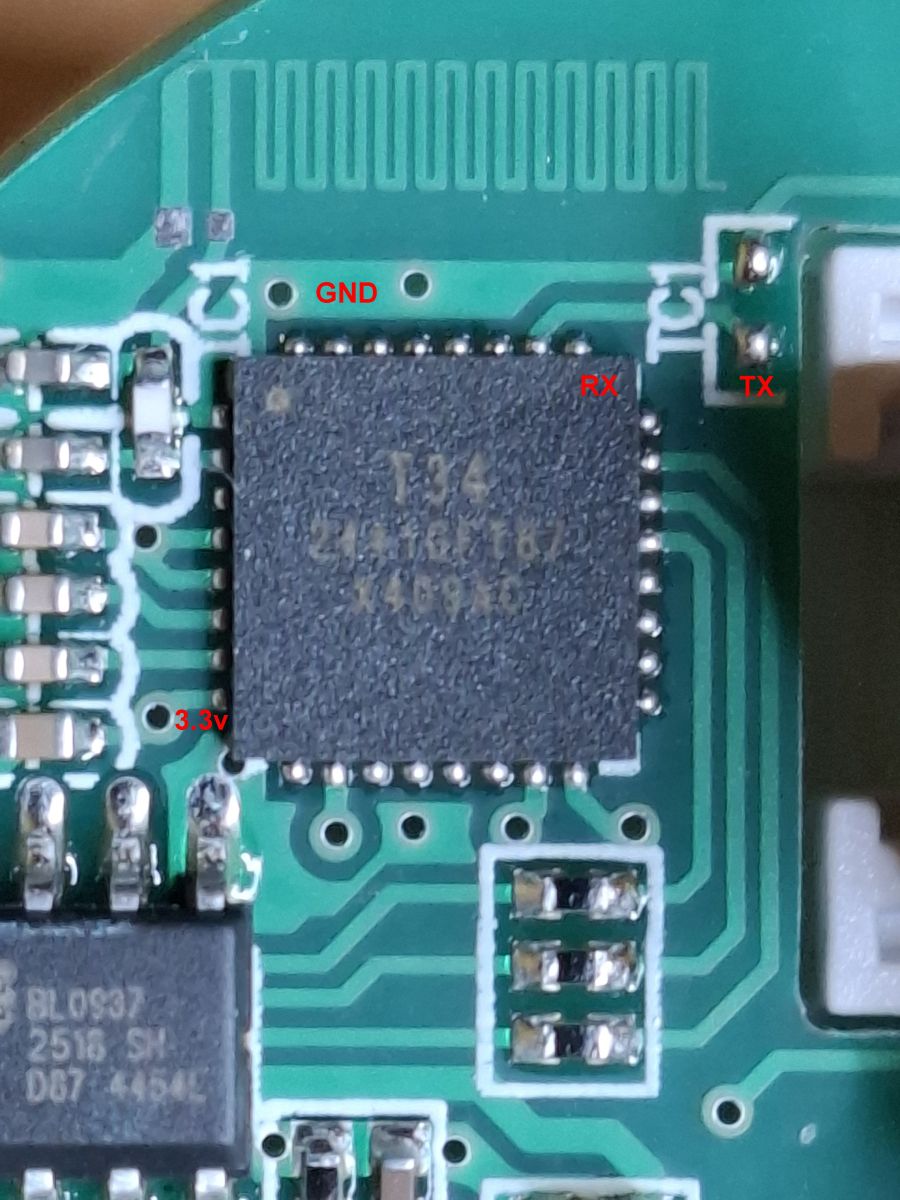

    Looking at the chip datasheet I picked these 4 points to talk to the chip...
    Close-up of T34 chip on PCB with labeled GND, RX, TX, and 3.3V pins in red

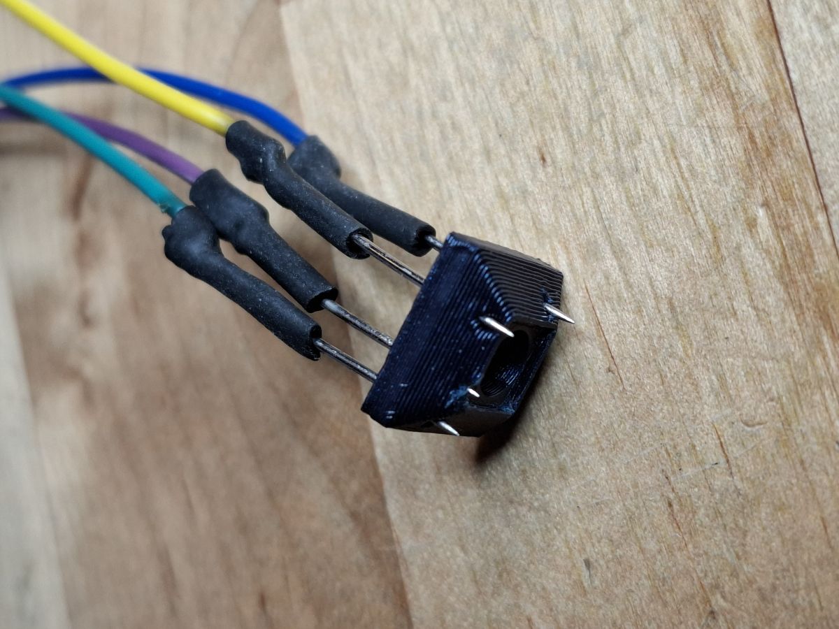

    Not wanting to solder onto something quite so small, I opted for a 3D printed socket to fit over the chip and hold pins in the right place...
    3D printed socket with four wired pins resting on a wooden surface
    This is then held in place by hand while the chip is read/programmed...
    Worked really well!

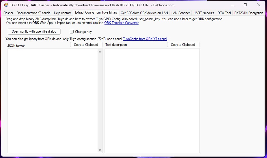

    Interestingly the flasher reported it as a BK7231N but the web app reports it as a BK7321T ?

    In the BK7231 Flasher program the following tab had a web page "OBK Template Converter"...
    BK7231 Easy UART Flasher window with tabs and empty JSON/text fields
    That reported it...

  • #4 21796069
    Posts: 14755
    Rate: 12881
    Oh I see, thank you for reporting the issue! I added a fix:
    https://github.com/OpenBekenIOT/webapp/commit/25318408a37b700ce77117860b2120b1340a8b4e
    Let me know if it works now for you ok.
