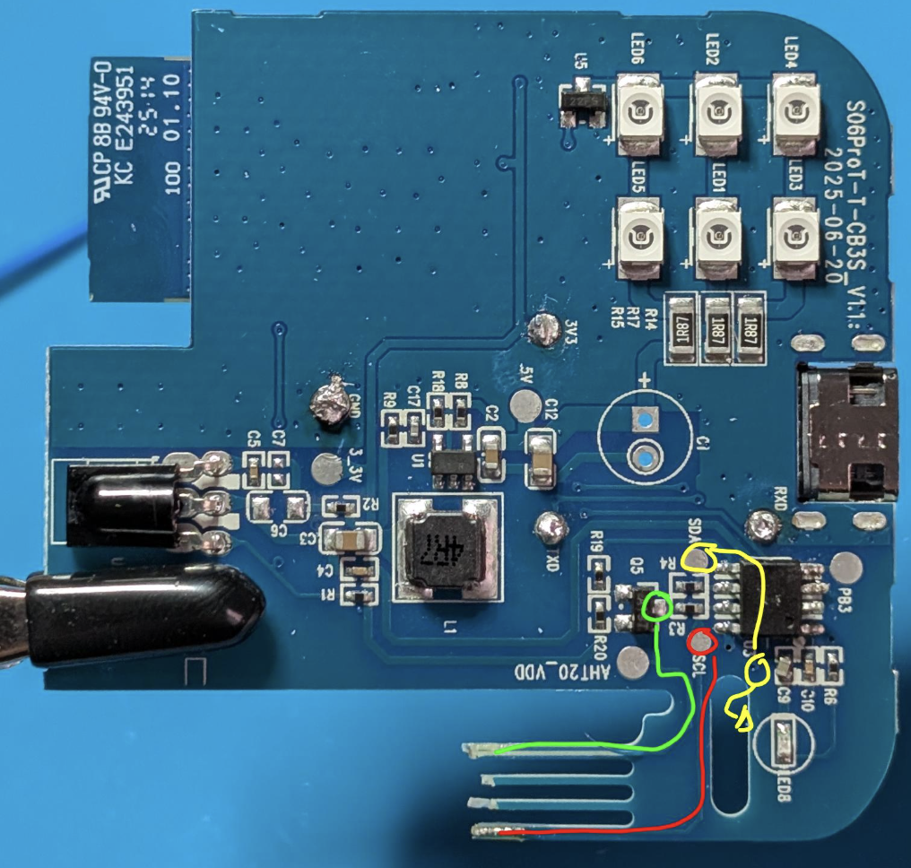

    I tried to use `tuya-cloudcutter` but none of the Tuya Generic IR devices worked. I decided to open the case.
    It contains a CB3S, _not_ a WB3S like in this post: https://www.elektroda.com/rtvforum/topic3926882.html#21344074 The pins can be seen here: https://docs.libretiny.eu/boards/cb3s/ The board is labelled `S06ProT-T-CB3S_V1.1: 2025-06-20`

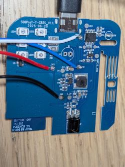

    I tried to use the front soldier pads. I soldered GND, 3V3, TXD and RXD, which I connected to a USB-to-TTL.
    S06ProT-T-CB3S PCB with connected wires and USB-C port on wooden surface
    I tried to read the firmware by running `ltchiptool --timed --verbose flash info beken-7231n --timeout 10`. The command fails to connect though. Here are the logs:

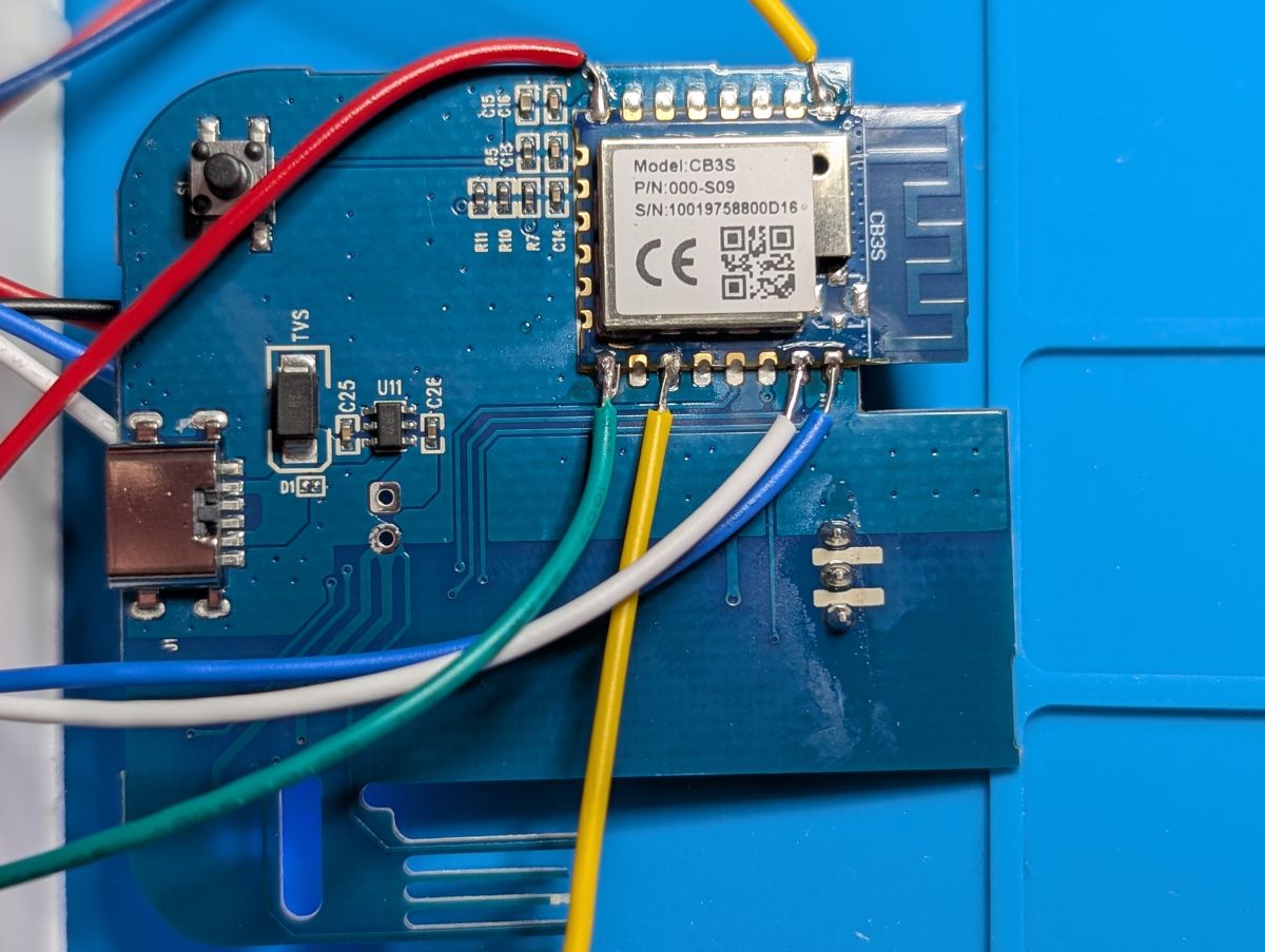

    I tried to short the CEN pin on the CB3S with the ground while the tool `ltchiptool` was showing the line `In order to do that, you need to bridge CEN pin to GND with a wire.`, but it didn't change anything.

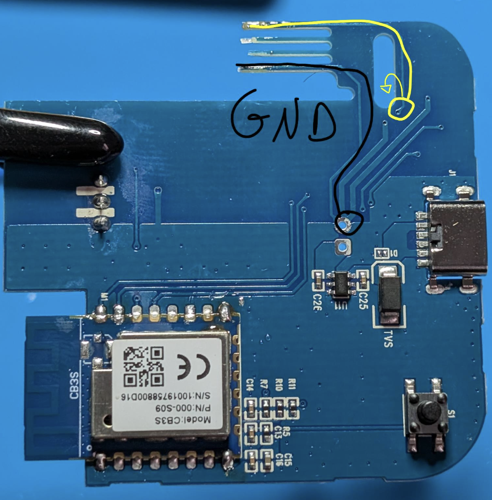

    I then decided to try to solder directly on the CB3S module instead:
    Electronic module with CB3S chip on blue PCB with USB-C connector
    CB3S Bluetooth module on blue PCB with connected colored wires
    I ran the same `ltchiptool` command as above, even trying to short CEN-GND, but I got the exact same result: The tool cannot connect to the CB3S module.
    Am I doing something wrong? I'm out of ideas to try...

  • Desolder two TuyaMCU pins to access TX/RX pads
    #2 21748777
    coherence_trio

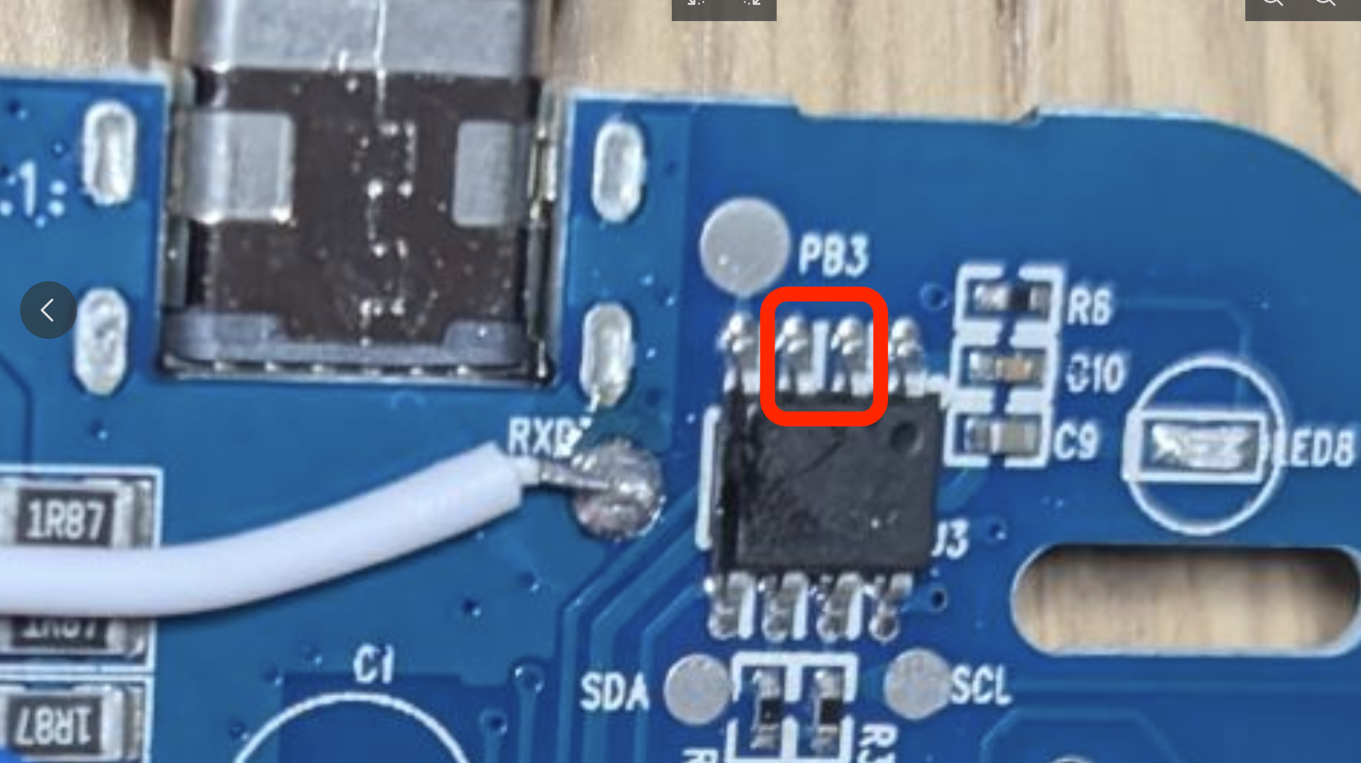

    >>21739353 I was able to read and write. I had to desolder two pins from the TuyaMCU. I used a multimeter to check continuity between the TX/RX pads (white and blue cable in the picture) and the TuyaMCU pins. The two pins were the two middle ones from the side near the USB-C connection.
    Close-up of an IC and PB3 label on a blue PCB with USB port and soldered wire
    Once the two pins were desoldered, running `ltchiptool` worked fine. Once it reached the message "In order to do that, you need to bridge CEN pin to GND with a wire", I shorted the CEN pin with GND as requested (see the pinouts here: https://docs.libretiny.eu/boards/cb3s/) and `ltchiptool` was able to pursue!

    The firmware I flashed was ESPHome, inspired by the docs for a S06: https://devices.esphome.io/devices/avatto-s06-ir-remote-no-temp-no-humidity-new-version/
    Notes:
    * Once I shorted CEN and GND, `ltchiptool` was able to read info, firmware and write firmware without having to re-short the pins.
    * I don't have a full ESPHome firmware yet. I'll be playing with the YAML but at least I can now flash it via wifi

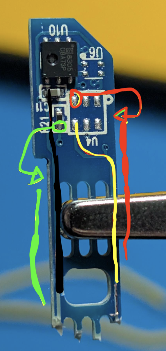

    * I tried to solder back the broken arm where I believe the temperature and humidity sensors are located. I had to use a multimeter in continuity mode to track the four copper lanes from the sensors back to the main board. The first picture shows the side of the PCB opposite the C3BS. The green and red annotations track the copper lanes of that side. The second picture shows the side of the PCB with the C3BS. The black line is GND and the yellow line ends up going to the other side of the PCB. It ends up at the SDA pad on the other side; the first picture shows the continuation of the yellow line on that side. The last picture shows the broken arm, with the annotations of the colours.
    * I wasn't able to solder back the green and black (ground) cables on the broken arm as the target is too small. The red and yellow cables were fine.

    PCB with CB3S module, annotated GND trace, components and edge connector
    Optical sensor module with color-marked signal paths on a small blue PCB
