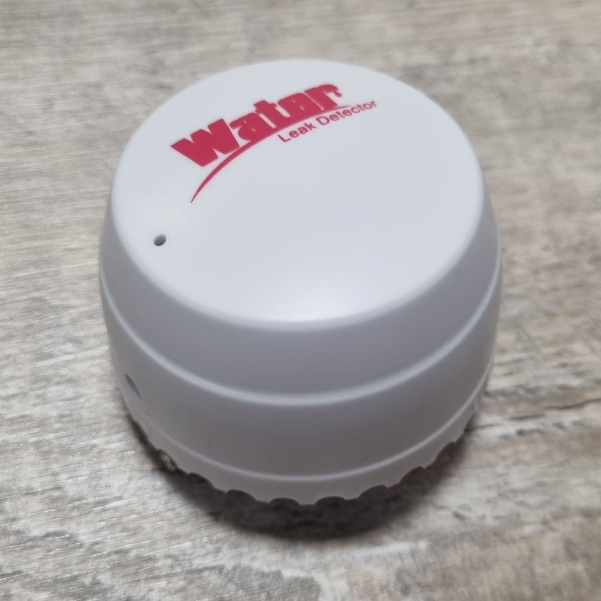

    I bought water leakage sensor DYGSM DY-SQ400B from Aliexpress for 1$. I wanted to connect it directly to my HA instance (bypass Internet connection requirement, which could be a bottleneck during critical situation). I flashed it with great OpenBeken (great thanks for authors :D)

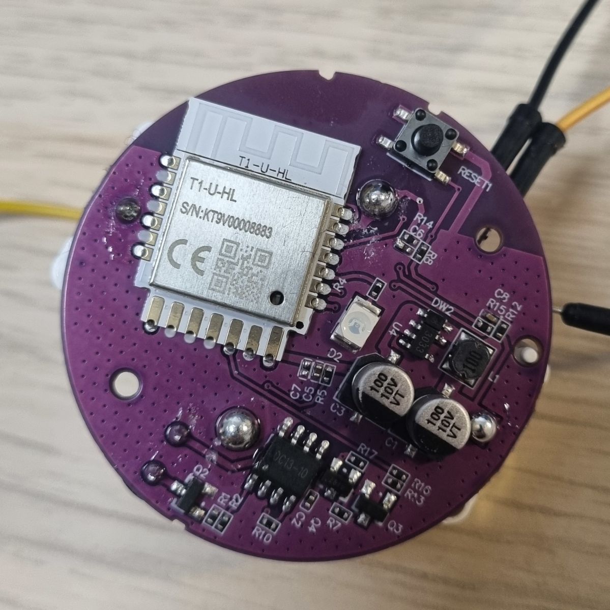

    My device has T1-U-HL Module (BK7238) and I didn't found ready configuration on this forum neither on this website

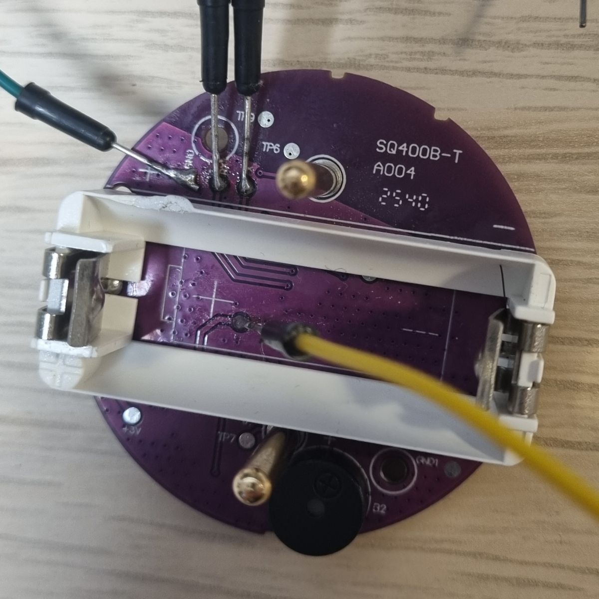

    Teardown
    So I performed reverse engineering. Below is my teardown.
    Teardown and OpenBeken Configuration for DYGSM DY-SQ400B Water Leak Sensor with T1-U-HL ModuleTeardown and OpenBeken Configuration for DYGSM DY-SQ400B Water Leak Sensor with T1-U-HL ModuleT1-U-HL (BK7238) module on purple PCB with visible RESET button and capacitorsSQ400B-T sensor PCB with soldered wires and visible test points and component labels
    Pins configuration:

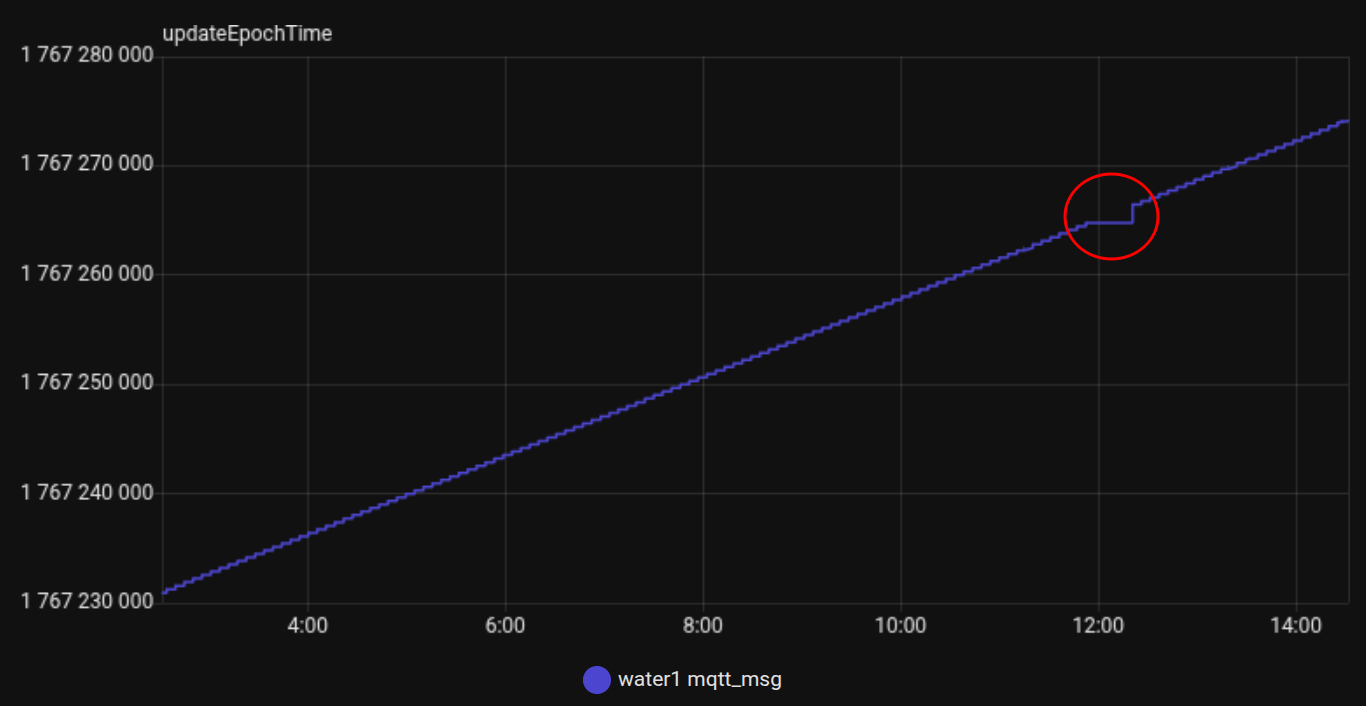

    I connected this sensor to my local Home Assistant instance by MQTT protocol by default OpenBeken configuration. Additionally, I created template for sensor heartbeat monitoring:
    Thank to this, I can easily monitor water leakage sensor connectivity:
    updateEpochTime chart with a communication drop marked by a red circle
    The red circle shows the moment of disconnection
