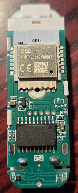

    Bought a genereic Tuya/Smartlife temperature and humidity sensor from here: Aliexpress
    Identified as TH06 in Smartlife app
    It is marked CBU/BK7231N but is BK7238 based with a TuyaMCU handling the sensor and controlling power-on/VDD of CBU. RX1/TX1 are directly connected to TuyaMCU prohibiting BK7231 Easy Flasher from doing it's job.
    PCB with CBU communication module and integrated circuits visible
    I lifted pin 5, TX1 from the TuyaMCU and connected to CBU TX1/RX1. Got the following warning in the log WARNING! Non-standard encryption key!
    Skipping Key check, and got following log:
    Then I tried to program with "OpenBK7231N_Q10_1.18.229.bin but it continously reboots....

    #2 21795783
    Posts: 5220
    Help: 449
    Rate: 918
    CBU labelled modules also now seem to be BK7238 as well as BK7231N. Flash to OpenBK7238.

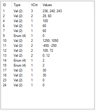

    I did a backup of the original FW; it does not work with "Extract Config from Tuya binary"
    TuyaMCU analyzer shows the following:
    Table with columns ID, Type, VCnt, and Values showing various numerical values
    Looks close to a "normal" TH01.
    Battery level (4) is 100%.
    High temperature alarm (10) level before low temp. (11)
    Humidity high (12) before low (13).
    Trying the following setup:

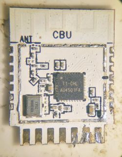

    I can confirm that the module is T1-based.
    Electronic module with CBU, ANT labels and T1 CHL AU4501FA microchip
