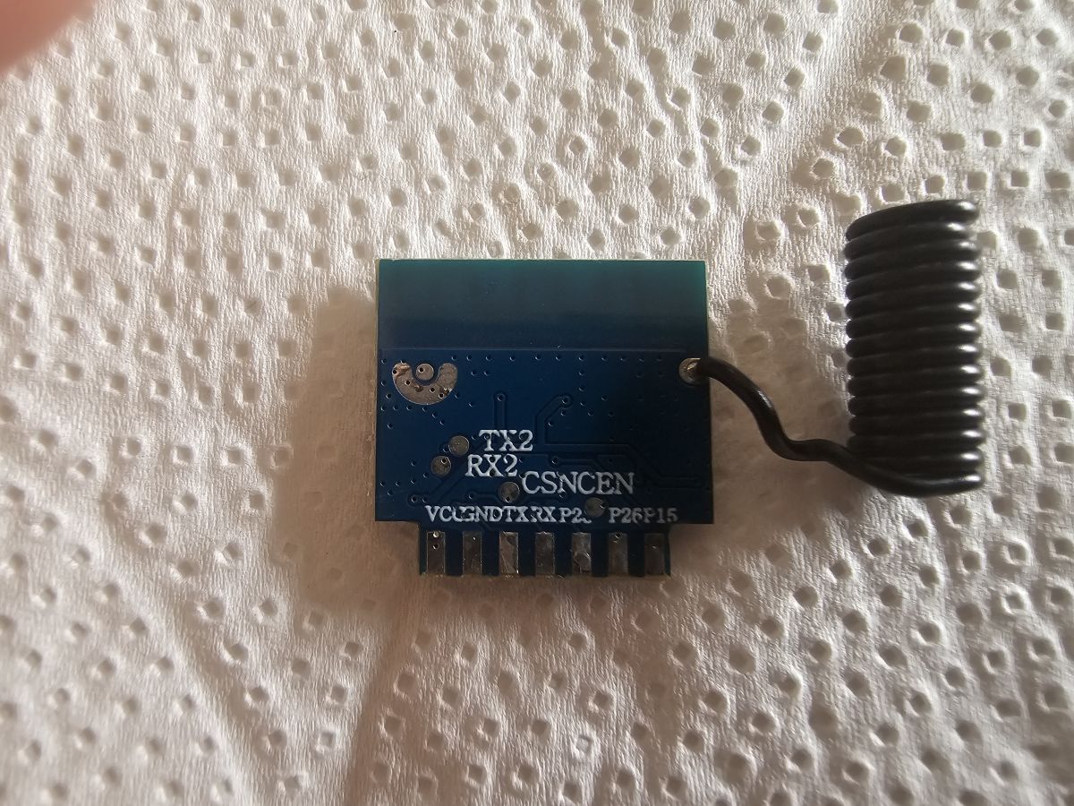

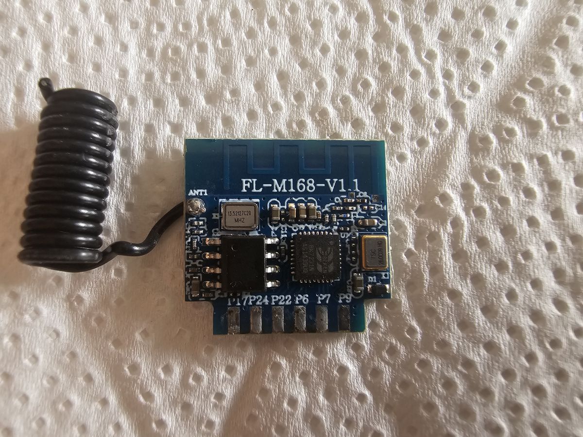

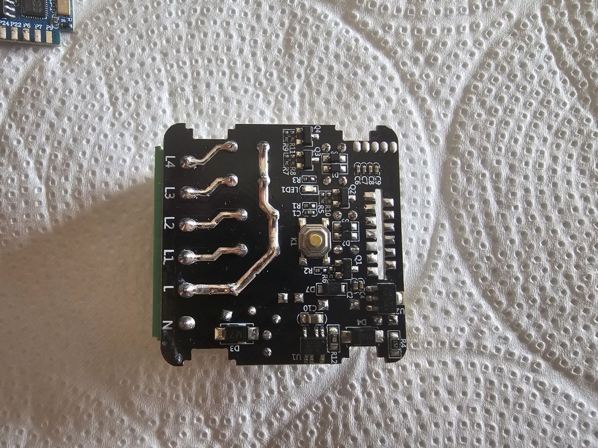

    xchwarze

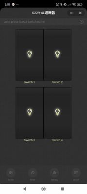

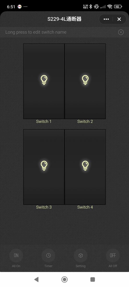

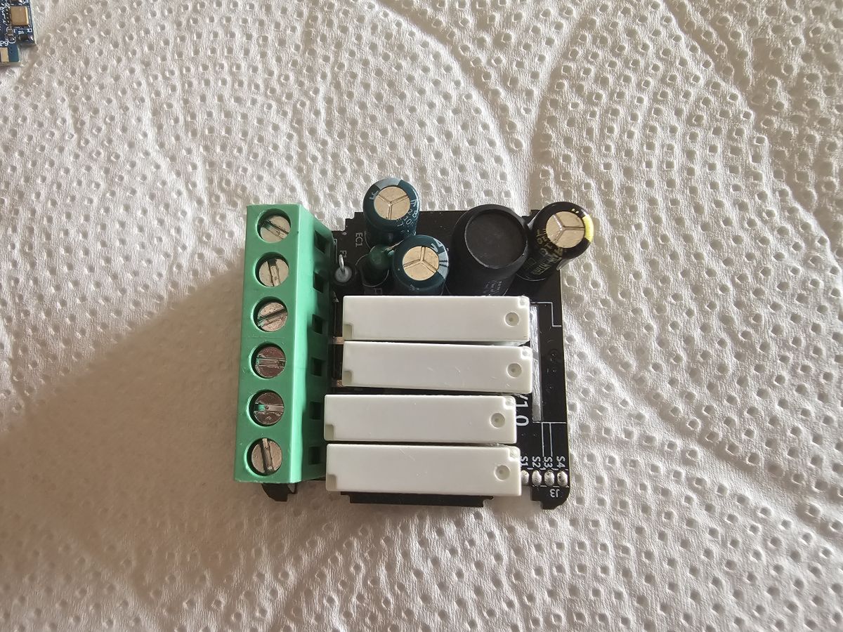

    DEMASLED DOMO-18 4 Gang
    DEMASLED DOMO-18 smart home controller with labeled wire terminals.
    I think it's from a company that manufactures for third parties (white label).
    It is listed as Wifi+rf or Wifi+bt+rf. The manufacturer sells a 4-button remote control that transmits at 433 MHz.
    FL-M168-V1.1 radio module with coil antenna and integrated circuit chips  Electronic module with button and labeled pins on a black PCB Relay module with capacitors and screw terminals Electronic module with spiral antenna on paper towel background

    Resume:
    - Pair/Toggle All Button on P10
    - TglChannelToggle (channel 4) on P6
    - TglChannelToggle (channel 1) on P17
    - TglChannelToggle (channel 2) on P24
    - TglChannelToggle (channel 3) on P22
    - Relay (channel 2) on P23
    - Relay (channel 1) on P9
    - Relay (channel 3) on P26
    - Relay (channel 4) on P15
    - WiFi LED on P11

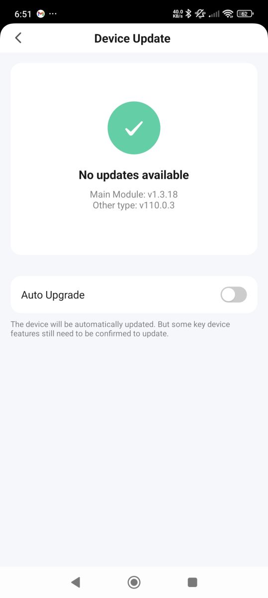

    Device seems to be using CBU module, which is using BK7231N.

       "jv":"110.0.3",

    Very interesting, so FL-M168-V1.1 module has both Wi-Fi (like usual CB2S or WB2S) and RF? Nice, it's a shame we can't order it separetely. It would be very useful for converting many devices to Wi-Fi + RF.
