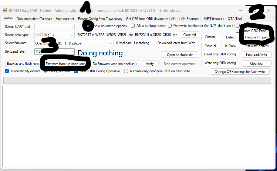

    PS: If you have more than one to flash, you might be annoyed with the same mac adress.
    So in the UART Flasher go to: show advanced options and hit the restore RF part. this should assign an differetn mac adress that can be read by hitting the firmware backup (read) only, at the end it will show the new mac adress

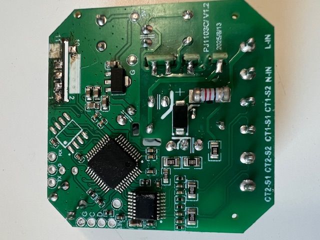

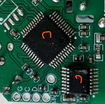

  • New PJ-1103C units use HLW8112 and N32G430
    #3 21783824
    frath
    >>21783661

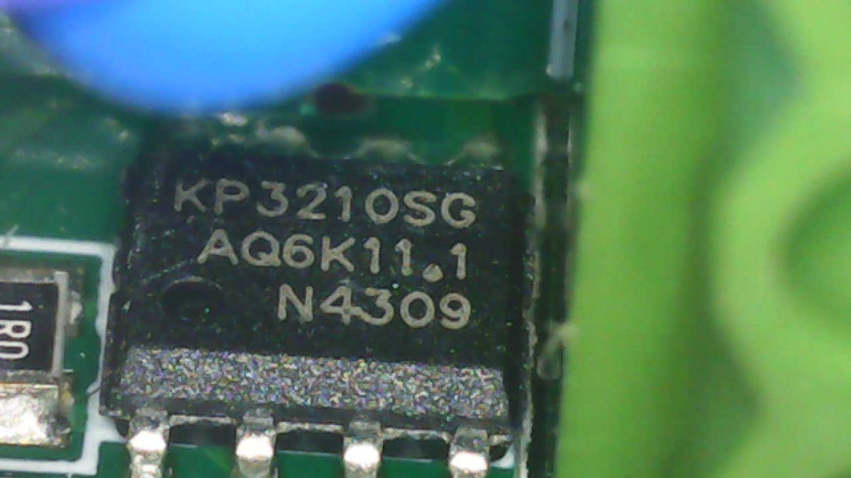

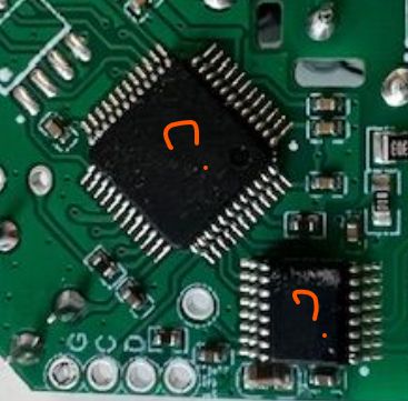

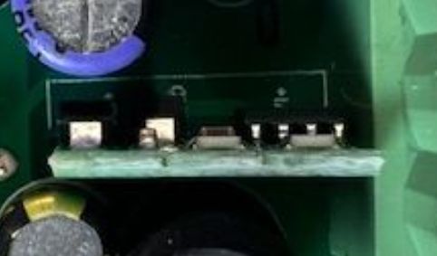

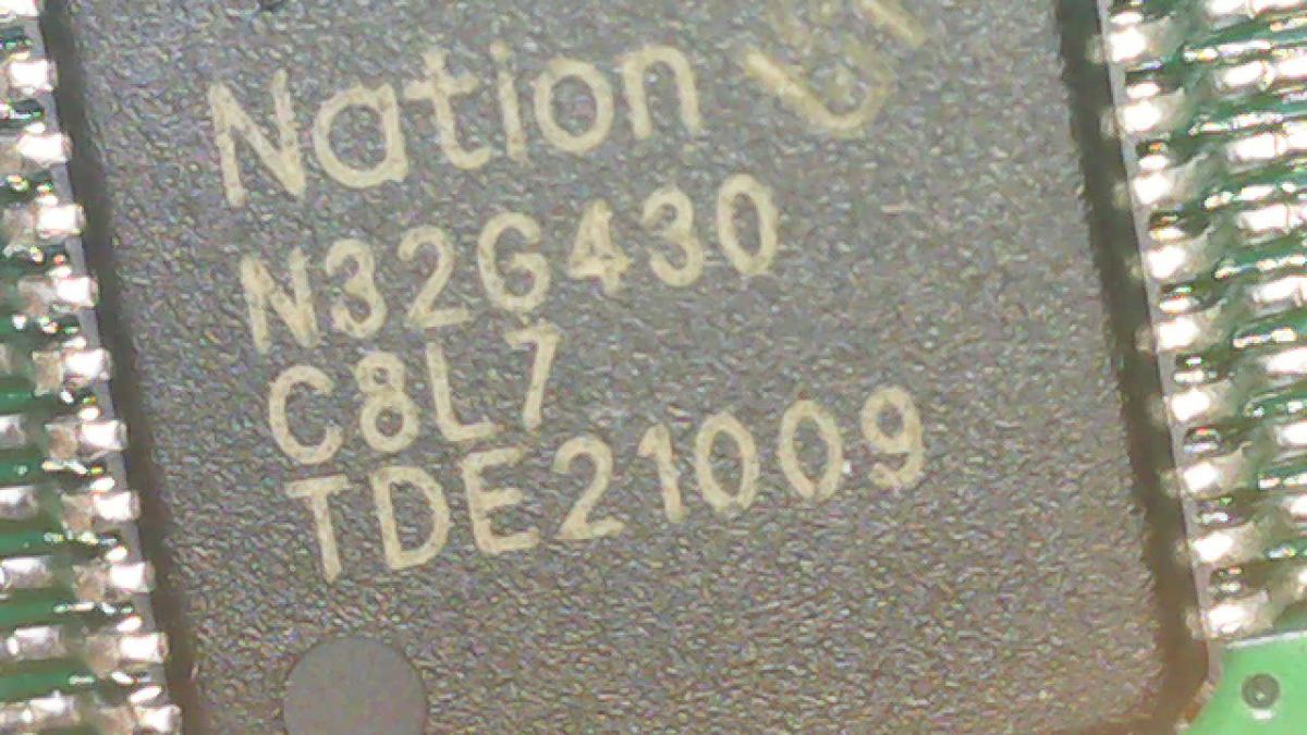

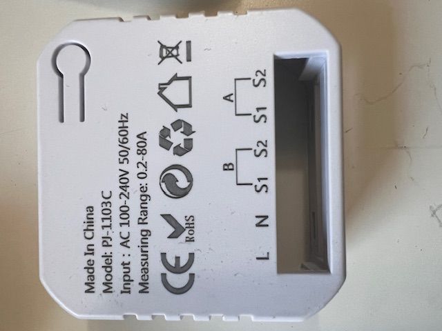

    Yes I bought them few days ago, firmware from 2025/8/13.
    those ones have PJ-1103C not A but come with the HLW8112 and the N32G430. I put the pic for the power switch.
    Hope it'll help. If more pics needed, ask me.
    Close-up of KP3210SG integrated circuit on a green PCB.
    Close-up of HLW8112 integrated circuit with 2502K1D marking on a PCB
    Close-up of N32G430 chip with visible markings and soldered pins on PCB

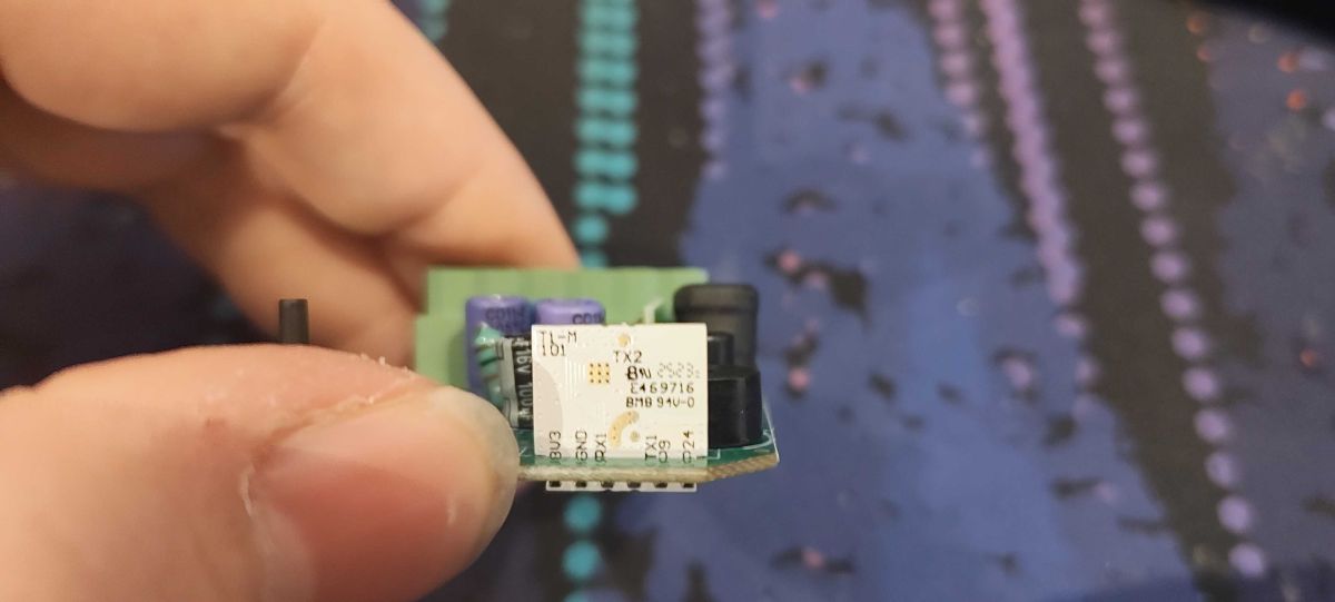

    BK7238 flashed with ESP8266 and external power supply
    #7 21855896
    TomPointExe

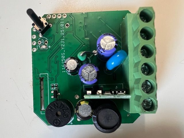

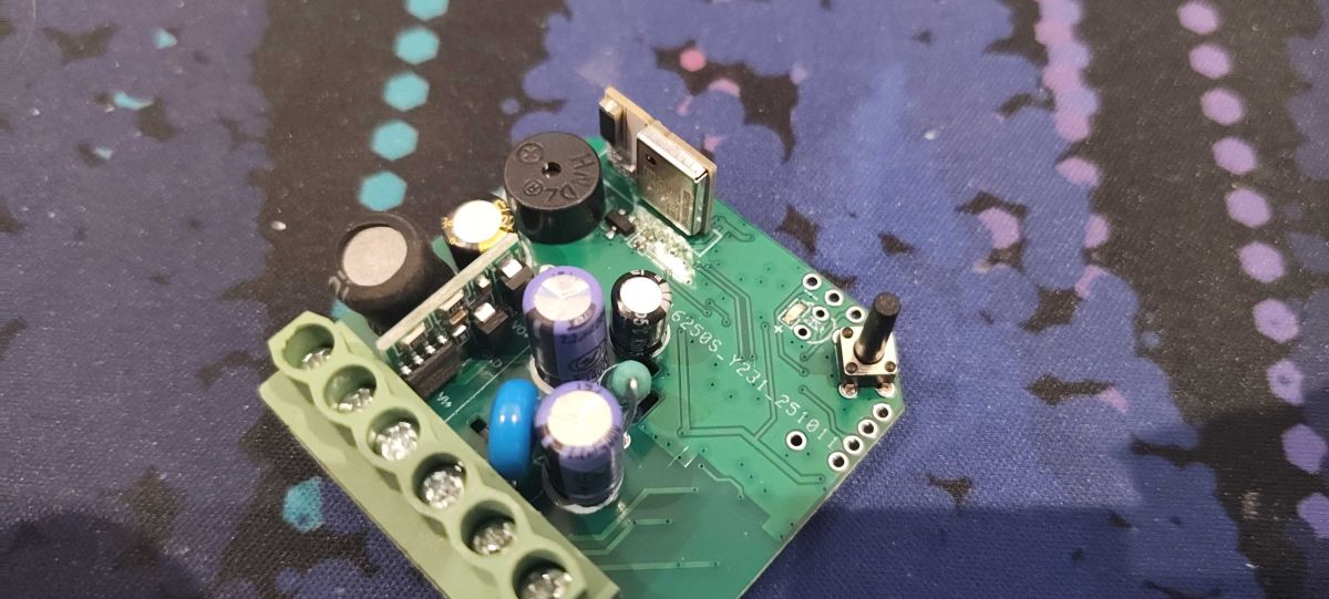

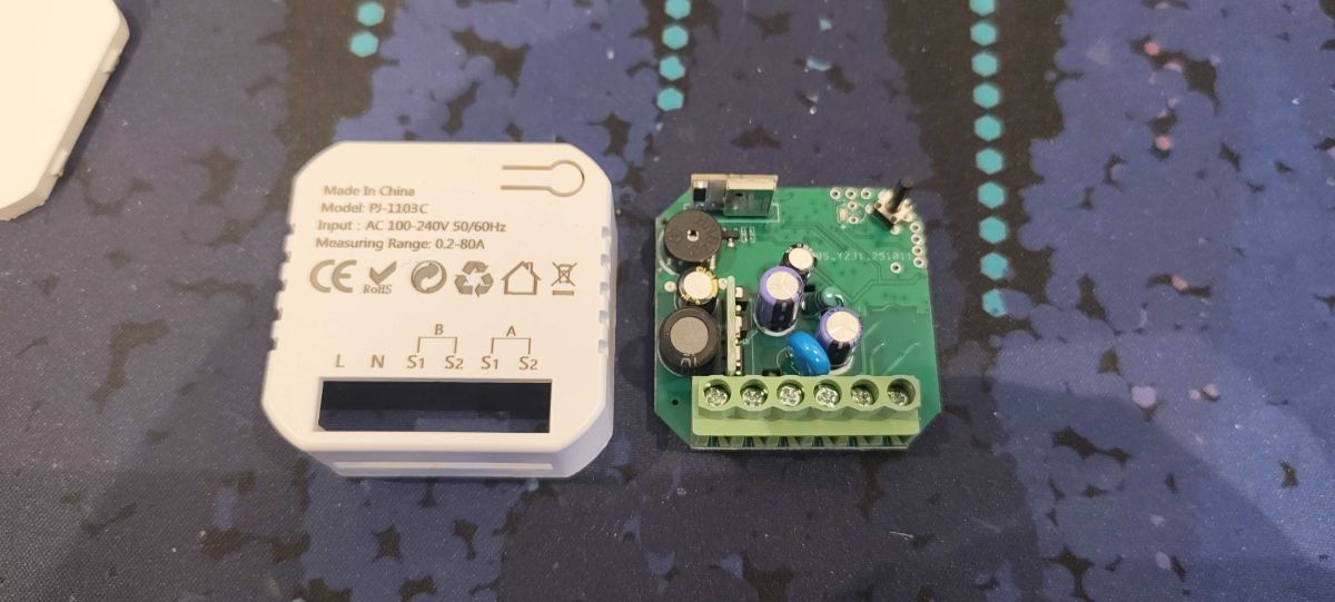

    Hello everyone, I've bought an equivalent sold as a 1103A, but it was in fact a 1103C
    Here are some more pics
    Small cardboard box with a white label and barcode on a colorful dotted surface
    Cardboard box with a “Safety Installation” label on a dark dotted multicolor background.
    Two electronic parts: a white labeled module and a green PCB with a screw terminal block
    Close-up of a PCB with a screw terminal block, capacitors, a buzzer, and a USB connector
    Hand holding a small PCB module with capacitors, a connector, and a printed label

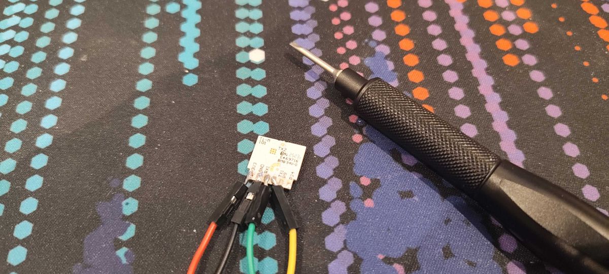

    Flashed the BK with an ESP8266 board, with ground and reset bridged, using an external power supply
    Small PCB with attached wires and a black precision screwdriver on a patterned mat
    Configured it using all the info in this thread, and it worked!
    Installed it into my distrib board, connected it to Hass, and ... all done :)
