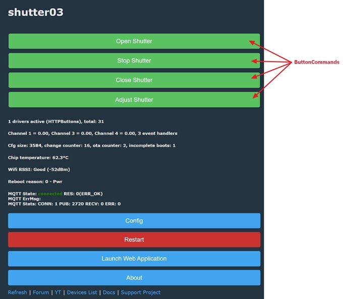

    OK, I try to explain what I intend ;-)
    This is my autoexec.bat:
    // Set up Aliases

    So I have buttons on the web UI that I can click to execute functions:
    Control panel shutter03 with green and blue buttons for operating a shutter system.

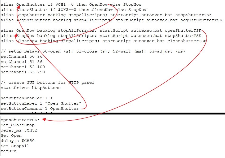

    This is the workflow of the functions:
    Script code fragment for shutter control with comments and red arrows.

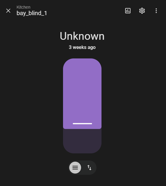

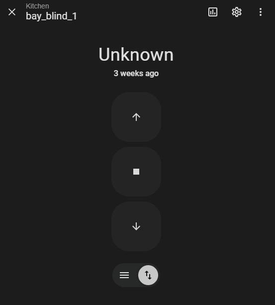

    You then get a suitable control in Home Assistant that represents the blind in a number of ways.
    You get a pull up/down representation of the cover you can set to a position between 0 and 100%.
    This updates in "near" real-time (depending on how often you send MQTT updates from your firmware).
    Control interface for kitchen blind with unknown state
    You also get a set of buttons for up/down/stop etc.
    Control screen for bay_blind_1 with three large buttons in a dark interface
    Hope this makes sense.
