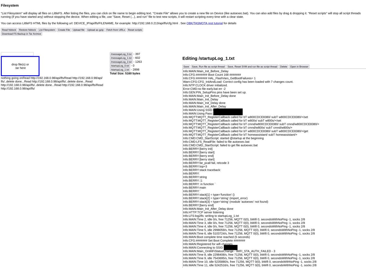

    #64 21878054
    max4elektroda
    Posts: 758
    Help: 49
    Rate: 189
    I finally managed to implement some feature to allow logging to LFS: PR #2076.
    Wasn't a easy as I thought on the first look, because writing to lfs is slooow and would crash with an IRQ watchdog if writing more than a few lines.
    So now it will use an own thread for flushing the message buffer to lfs.
    It allows for "startup logging" with command
    logStartup2lfs [seconds- default 10]
    Will logg all further starts for the givven number of seconds to lfs (as long as there's free space in lfs).
    So if done, disable with
    logStartup2lfs 0
    During operation you can use
    log2lfs [seconds - default 10]
    to write messages to LFS for this number of seconds.
    Might be stopped earlier by calling
    log2lfs 0
    Screenshot of a web “Filesystem” page editing /messageLog_2.txt, with file list and log text on the right.
    Screenshot of LittleFS Filesystem page listing files and editing /startupLog_1.txt log
    Feel free to test or propose changes - I only checked with W800 and Linux simulator for now.

  • Startup-only logging feature for WiFi client debugging
    #66 21878160
    max4elektroda
    Posts: 758
    Help: 49
    Rate: 189
    I would see this as a debugging feature only, not as a regular one.
    Idea came back after issue 2064 where the user couldn't see the logs easily and he assumed a startup error when in WiFi client mode. With this feature he could have setup logging to lfs, insert his WiFi credentials and after a start in regular mode switching to safe mode again see the logs.
    For all other cases we have TCP logging which can be easily saved, so we could agree it only makes sense for startup, not during operation.

  • Log2LFS testing and config padding fix
    #77 21891908
    max4elektroda
    Posts: 758
    Help: 49
    Rate: 189
    @max4elektroda make log2lfs byte and disable it by default and I think it's ready to be merged
    Actual try at
    https://github.com/MaxineMuster/OpenBK7231T_App/actions/runs/24894132784
    Maybe @divadiow could give these artifacts a try on RTL platforms?
    I added some comments to mainConfig_t adresses.
    For both ESPIDF and RTL there was one "implicit" padding for alignment to 4 byte types - I added a short for both.
    So just to make sure, a configured device won't lose it's config I'd like some tests.
    I already tried on ESP32 and C3, so ESPIDF should be save, but only have one RTL device...
    You can use WIFI password2 (for SSID2) which is "beyond" this place for both platforms.
    Hint: don't use SSID2 itself since you can't delete it w/o resetting to OpenAP and then device will be in "second SSID-mode" until that - another thing to fix in the future.... ;-)
    Testing logging to lfs (if you want to give it a try) with this command:
    logStartup2LFS <seconds up to 30 - default 10s> <optional repeats - default only once>
    so log next startup to LFS for the default 10 seconds:
    logStartup2LFS
    or log next 3 startups for 15 seconds :
    logStartup2LFS 15 3
    Thanks!

  • Startup log shows autoexec.bat is required for LFS readiness
    #79 21894241
    Posts: 5153
    Help: 442
    Rate: 906
    cool. so I did
    logStartup2LFS 15 3
    and this was the content of the file saved (had to create autoexec.bat first for LFS to be ready)
    logStart2LFS_f9d408fb2054 - RTL87X0C
    vs uart log out
    all 3 wrote a log. it did stop after 3.
    the single was fine too. stopwatch shows time logging is accurate within ~1s (human inaccuracy stopping/starting)
  • #80 21894356

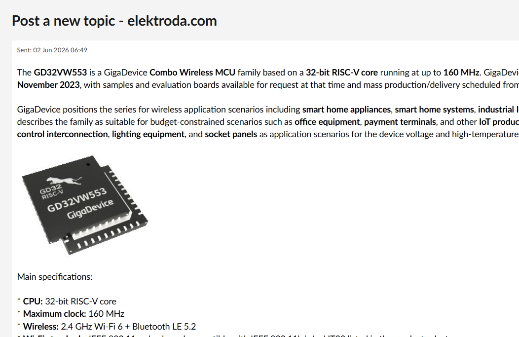

    I also see another great addition by @insmod :
    https://github.com/openshwprojects/OpenBK7231T_App/pull/2116
    Can you guys brief me shortly, what's this GD32VW553 and where it can be found?
  • #84 21914076
    Posts: 14699
    Help: 656
    Rate: 12743
    Interesting, so, the current port runs? How can it be flashed? Can you share some more information that I can use to put up some docs/guide for that?

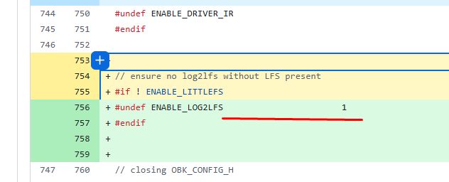

    @max4elektroda I merged it, however, I think this "1" is not needed for #undef :
    Screenshot of a code diff showing #if/#undef directives and a comment about log2lfs without LFS.
    There should be no argument for #undef
    @divadiow great, so will you post it? I can help if needed.
    You're absolutely right, that's not intended but a mistake.
