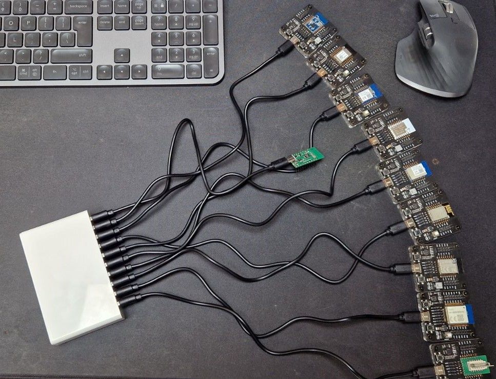

  • Set of Wi-Fi development boards connected via USB, ready for programming
    For several years, Elektroda has been developing universal, open-source software for various types of Wi-Fi-controlled building automation devices, such as relays, LED lamp and LED strip controllers (including WS2812), thermostats, energy meters, or there temperature, humidity, motion sensors. Along with the firmware, a list of supported devices and extensive documentation of their internals is created. Here I will show the status of this project as of 2025.12.31.

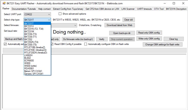

    The batch is uploaded via UART, a USB to UART converter is needed. We have our own flasher for this:
    BK7231 Easy UART Flasher interface with expanded chip type selector
    Once uploaded, we connect the device to our Wi-Fi and configure the GPIO. Our Flasher often knows how to auto-detect the GPIO - you don't have to guess, you don't have the problem you have with Tasmota.
    And even if you did have to guess - we still have a tool that makes it easy:
    GPIODoctor in OpenBeken - a convenient way to learn about GPIO roles in an IoT device [EN]

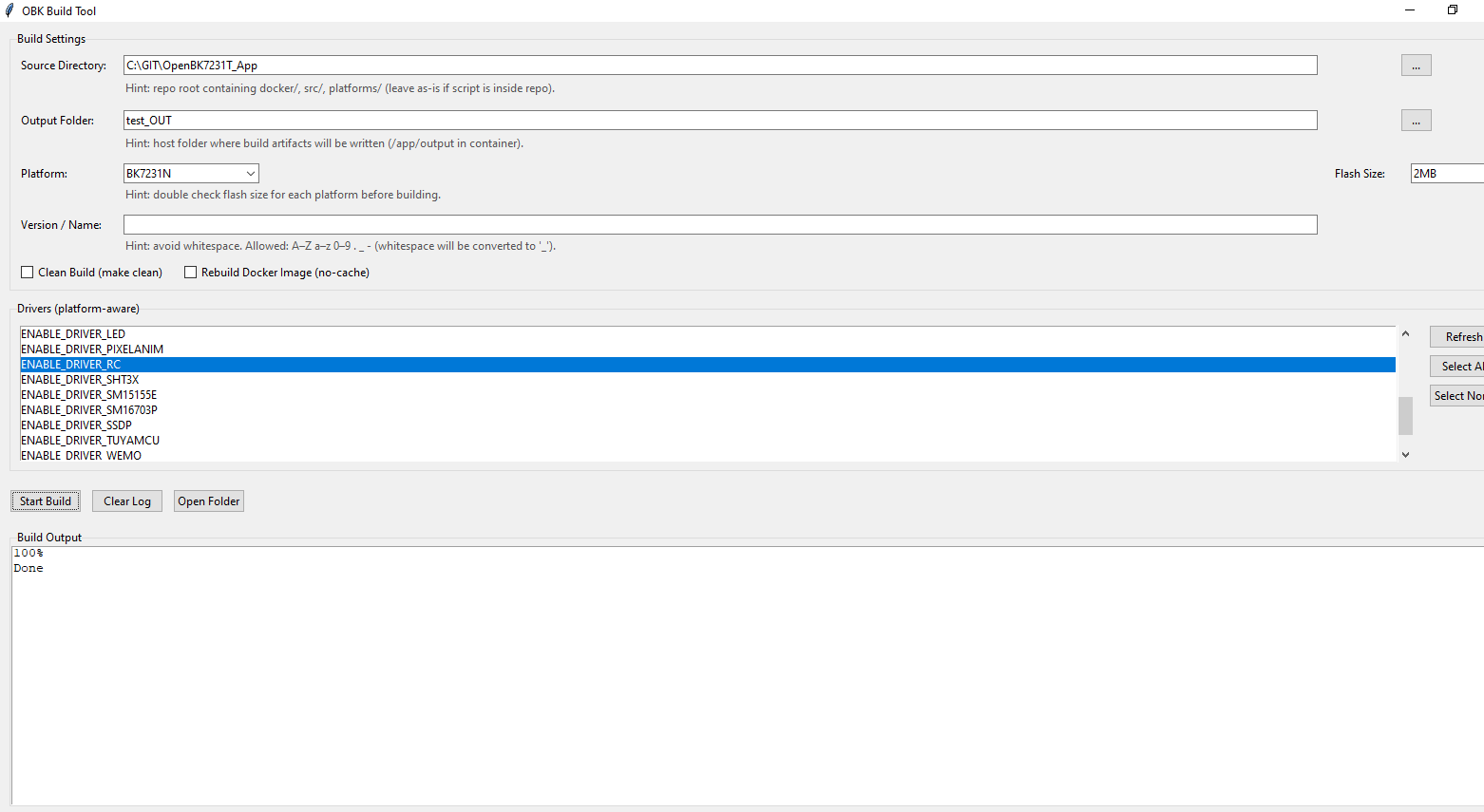

    Online and automatic OTA compilation
    The project can be compiled fully online. This is used even in normal firmware development. Toolchain on the local computer is unnecessary.
    More information:
    System online builds OpenBeken - firmware compilation for all platforms on Github [EN]
    In addition, we have a tool that with each compilation downloads and updates the firmware itself on the target devices:
    How to programmatically access pull requests, commits and download artifacts from Github[EN] How to programmatically access pull requests, commits and download artifacts from Github?
    How to programmatically access pull requests, commits and retrieve artifacts from Github? [EN]
    https://github.com/openshwprojects/OBKotaTool

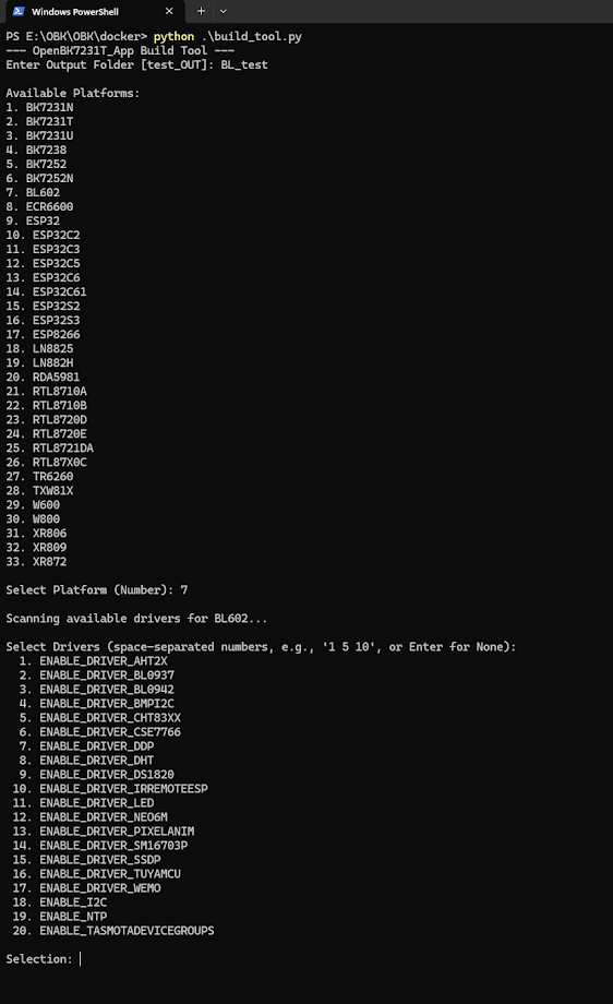

    Nice feature. With this custom build system in Docker, anyone will be able to create OBK build for any platform with any driver enabled (via obk_config.h).
    “OBK Build Tool” window with build settings, BK7231N selected, and a drivers list.

    Excellent work! I'll probably switch from WSL1 to that.
    Would it build TXW? It must execute some .exe to finish build. (i once saw python replacement to them on gh, don't remember where though)

    insmod wrote:
    Would it build TXW?
    Love it, thank you, I haven't tested all the platforms atm but TWX will not build yet, I'll fix that now.

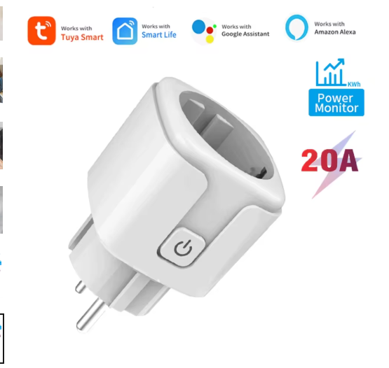

    Great stuff and I think I'll be dismantling all my sockets for reprogramming. I have a dozen of them.
    With the software mentioned, is it possible to configure the devices myself so that, for example, the consumption of a few selected sockets is summed up, as in the picture?
    Software such as eWelink or Tuya shows the energy consumption, but lacks a simple function to add up the consumption of selected devices. Well, unless I haven't noticed such functionality.
    White smart plug with power button, plus Tuya, Google Assistant, and Amazon Alexa compatibility icons

    @PRL where do you want to add up these values? The firmware shown is for individual devices, it's not Home Assistant. We don't have a control panel here, or at least at the moment.... because I might think about giving support for one of the devices to have this role....
    Do you want to aggregate this data on the Home Assistant panel?
    Anywhere. I have part eWelink and part Tuya and unfortunately nowhere have I found the ability to add up the consumption from all/selected outlets. It's a bit tiresome to click on each socket in each app and read the energy/amount consumed.

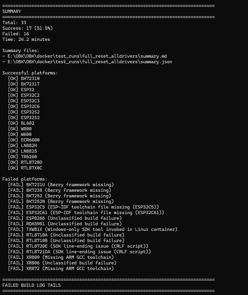

    I decided to create a test_all script for all platforms and all available drivers and save logs from the builds so I can fix it all, here is the first log out form it:
    Terminal screenshot showing test summary: 33 total, 17 successes and 16 failures, with OK and FAIL platform lists.

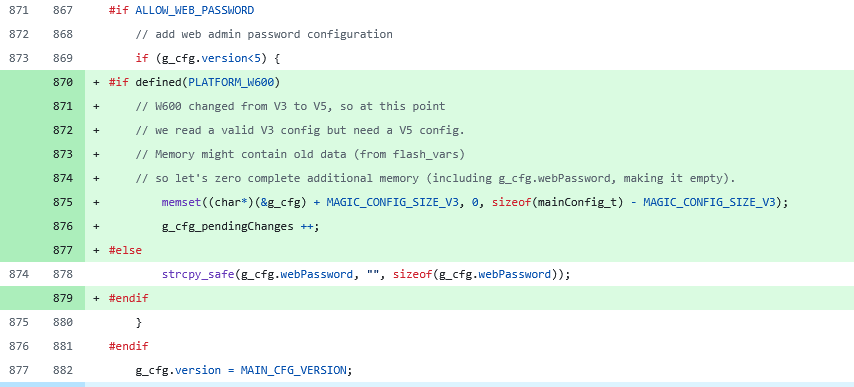

    Yes, PR#1936 is ready to merge. Thanks to @insmod introducing easyflash here, too, it's no more than enlarging the config (and zeroing the new area).
    Don't know if that case happens often, but we might clear memory in any case when updating from V3 to V4/V5 with it's larger are. Actually only WiFi password is set to "" in this case for all other platforms exept W600.
    Screenshot of a C code diff adding PLATFORM_W600 conditional block with memset and strcpy_safe calls.

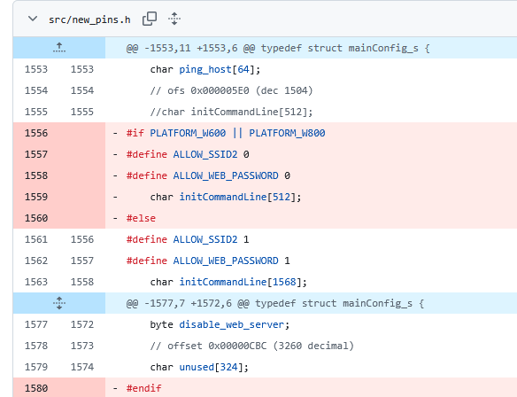

    And we might think of removing (or using) the two defines ALLOW_SSID2 and ALLOW_WEB_PASSWORD:
    If I'm correct, after this PR they are now unconditionally set
    Screenshot of a C code diff in src/new_pins.h highlighting changes to platform-related macros.
    If the webgui is right (I don't recall it in detail) and second SSID only works on Beken, we might also use the ALLOW_SSID2 to disable it (even in webif) for non Beken platforms...
