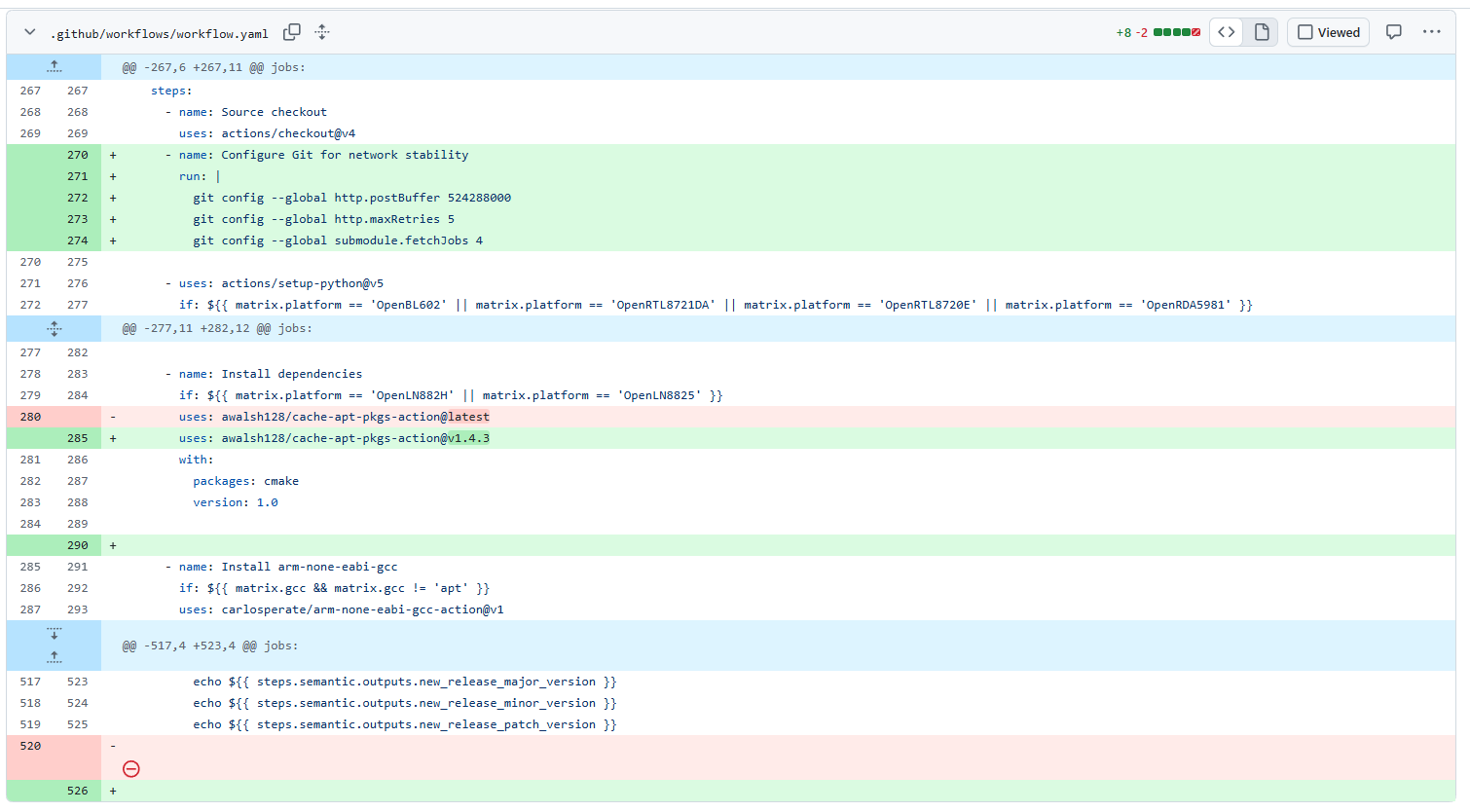

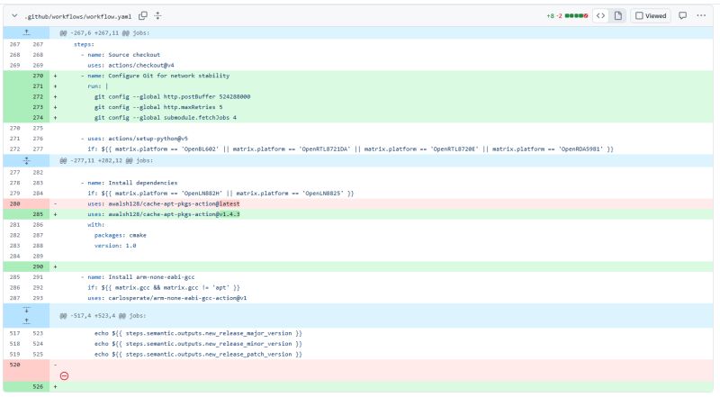

    What do we do about this? Does it help?
    Configure Git settings for network stability #2032
    https://github.com/openshwprojects/OpenBK7231T_App/pull/2032/changes

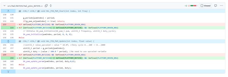

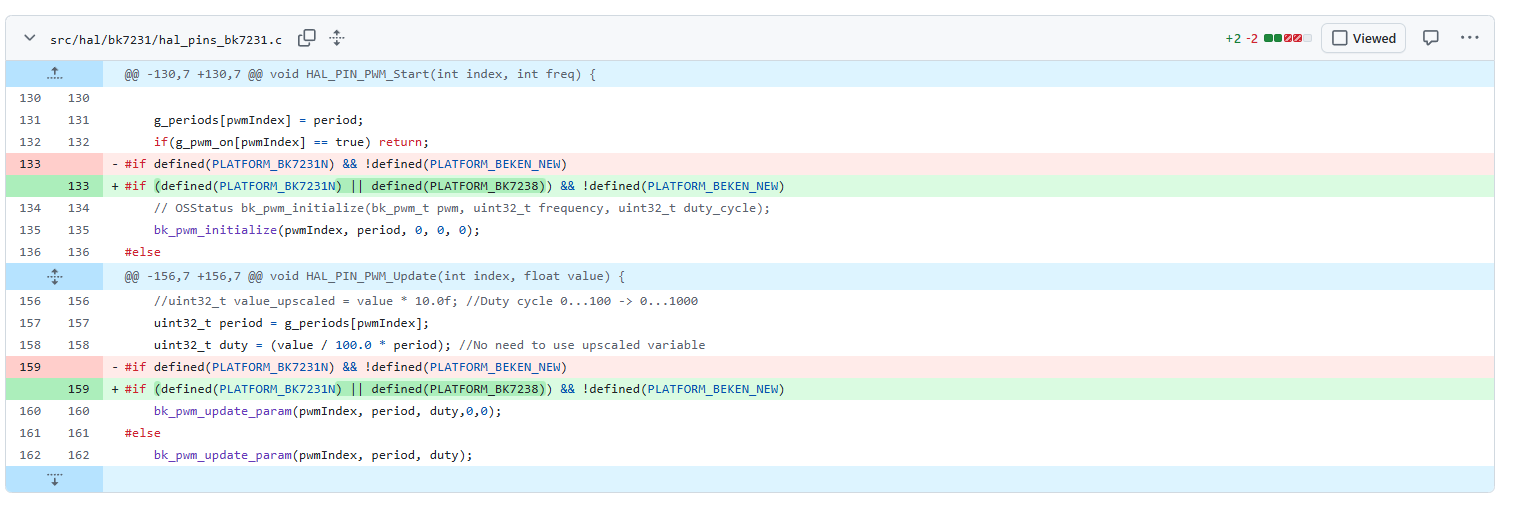

    Also, do we have a PWM issue on some Beken platforms?
    https://github.com/openshwprojects/OpenBK7231T_App/pull/2030/changes

    PWM is fine on 7238, and that pull request does nothing at all, since BK7238 has PLATFORM_BEKEN_NEW
    i put a question comment on the issue. no idea, but fixing awalsh128/cache-apt-pkgs-action to v1.4.3 kinda sounds a bit limiting. you'd miss out on all fixes/changes since that version without manual change to newer version

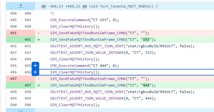

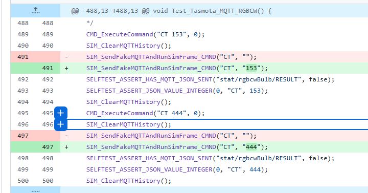

    So I changed these seftests, I hope this is what it's meant to be:
    --- a/src/selftest/selftest_tasmota.c
    +++ b/src/selftest/selftest_tasmota.c
    @@ -488,13 +488,13 @@ void Test_Tasmota_MQTT_RGBCW() {
            CMD_ExecuteCommand("CT 153", 0);
            SIM_ClearMQTTHistory();
    -       SIM_SendFakeMQTTAndRunSimFrame_CMND("CT", "");
    +       SIM_SendFakeMQTTAndRunSimFrame_CMND("CT", "153");
            SELFTEST_ASSERT_HAS_MQTT_JSON_SENT("stat/rgbcwBulb/RESULT", false);
            SELFTEST_ASSERT_JSON_VALUE_INTEGER(0, "CT", 153);
            CMD_ExecuteCommand("CT 444", 0);
    +       SIM_SendFakeMQTTAndRunSimFrame_CMND("CT", "444");
            SELFTEST_ASSERT_JSON_VALUE_INTEGER(0, "CT", 444);
    @@ -549,13 +549,13 @@ void Test_Tasmota_MQTT_RGBCW() {
            CMD_ExecuteCommand("Dimmer 20", 0);
    -       SIM_SendFakeMQTTAndRunSimFrame_CMND("Dimmer", "");
    +       SIM_SendFakeMQTTAndRunSimFrame_CMND("Dimmer", "20");
            SELFTEST_ASSERT_JSON_VALUE_INTEGER(0, "Dimmer", 20);
            CMD_ExecuteCommand("Dimmer 88", 0);
    +       SIM_SendFakeMQTTAndRunSimFrame_CMND("Dimmer", "88");
            SELFTEST_ASSERT_JSON_VALUE_INTEGER(0, "Dimmer", 88);
  • #50 21873452
    Posts: 14699
    Help: 656
    Rate: 12743
    Why those tests fail?
    Code diff view: SIM_SendFakeMQTTAndRunSimFrame_CMD calls changed from to 153 and 444
    They are supposed to test for Tasmota behaviour - if you send command without argument, it returns current value via RESULT. Your changes to them defeats their purpose.

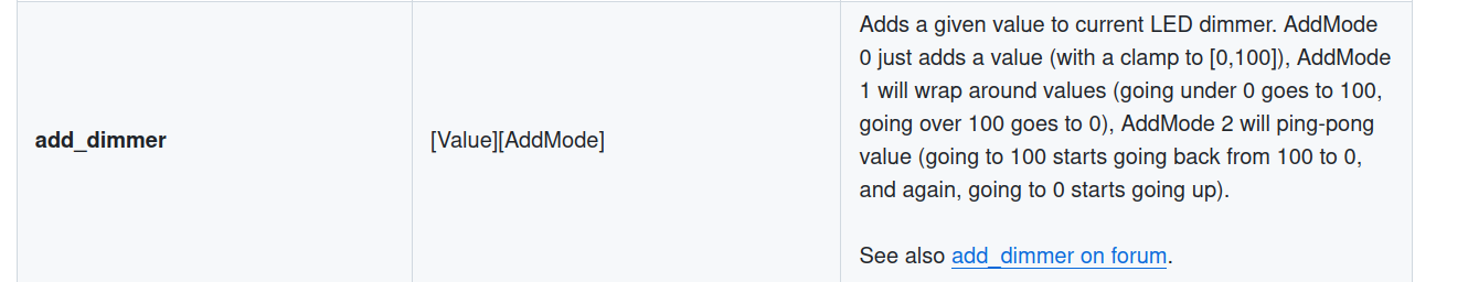

    O.k., I think I realized the problem. So I started to "safeguard" the functions inside src/cmnds/cmd_newLEDDriver.c.
    This shows quite a "mass" of other problems. Mainly: selftest_led.c will constantly call "add_dimmer" like this:
         CMD_ExecuteCommand("add_dimmer 1", 0);
    But add_dimmer needs two arguments:
    Documentation screenshot for “add_dimmer” showing [Value][AddMode] and AddMode 0–2 behavior.
       iVal = Tokenizer_GetArgInteger(0);
       addMode = Tokenizer_GetArgInteger(1);
    So I get litterally hundreds of failing tests:
    $ ./build/win_main -runUnittests 2 2>&1  | grep   -i asser | grep led_dimm
    ERROR: SelfTest assertion failed for Float_Equals(CMD_EvaluateExpression("$led_dimmer", 0), i + 1)
    ERROR: SelfTest assertion failed for Float_Equals(CMD_EvaluateExpression("$led_dimmer", 0), i)
    $ ./build/win_main -runUnittests 2 2>&1  | grep   -i asser | grep led_dimm | wc -l
    594
    Can I assume, addMode should be "0" by default? Then we could reduce safeguard to one argument and use
       addMode = Tokenizer_GetArgIntegerDefault(1,0);
    I implemented it like this in my PR and all failures are gone now :-).
