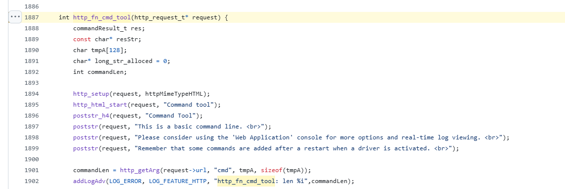

    It looks like a left over from long commands support debugging
    Code editor screenshot showing C function http_fn_cmd_tool with http_html_start and poststr calls
