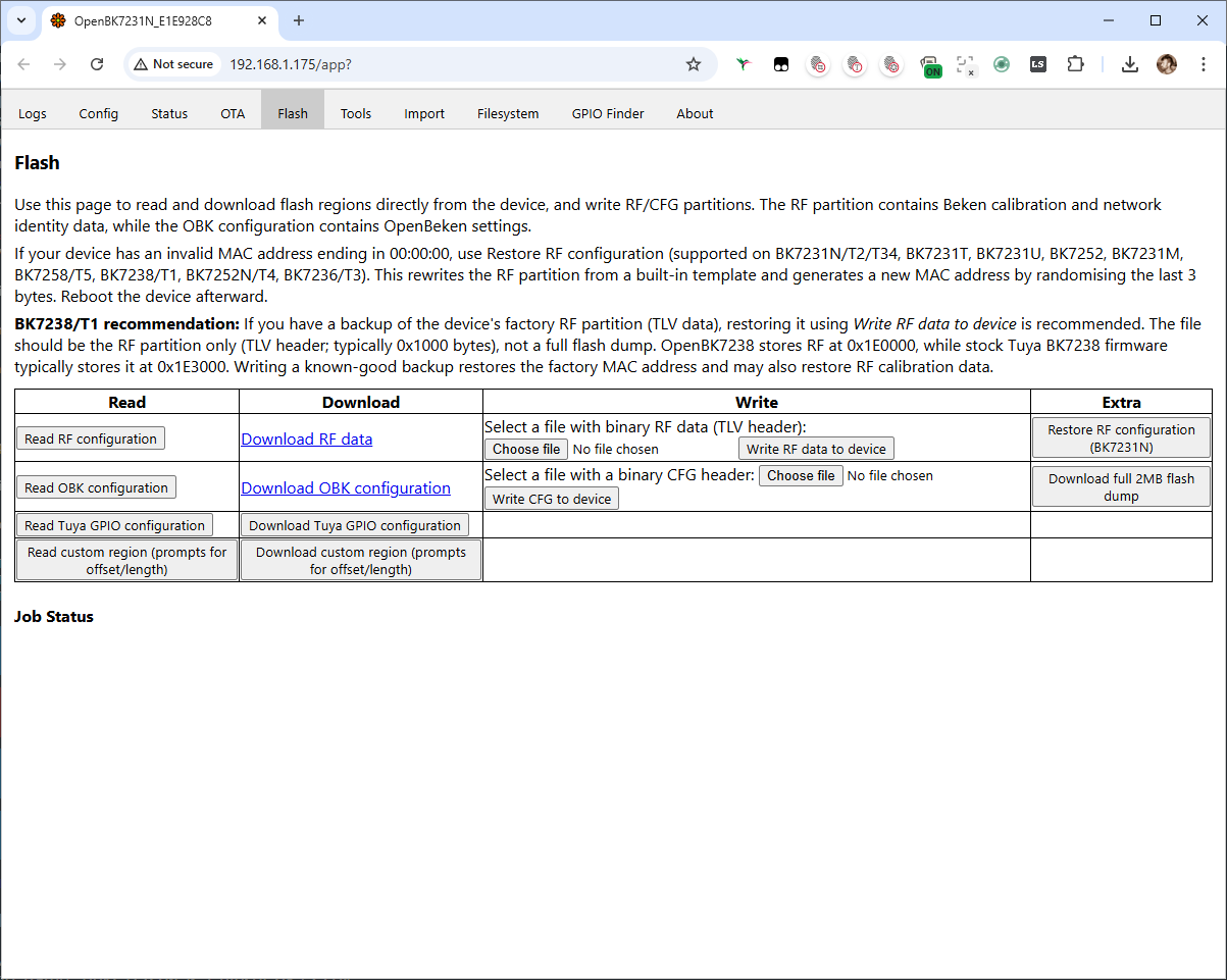

How can the web app flash tab be fixed so the Download Tuya GPIO Config and Download Custom buttons show the correct status messages and completion logs?
Make the flash tab use one shared dump-start function instead of duplicated button-specific code, so all dump buttons use consistent status handling and you can rename it to `startDumpJob` for clarity [#21800819] For the full dump path, call the shared helper with explicit parameters such as `startDumpJob("full 2MB dump", "FullDump", 0, 2097152, "QIO")` instead of repeating setup in multiple places [#21801475] The Tuya GPIO config button should also route through that shared helper with arguments like `"Tuya GPIO config"` and `"TuyaConfig"`, which fixes the inconsistent text and makes the UI easier to maintain [#21800819] The revised version was reported as “way better” and approved for merge [#21801475]

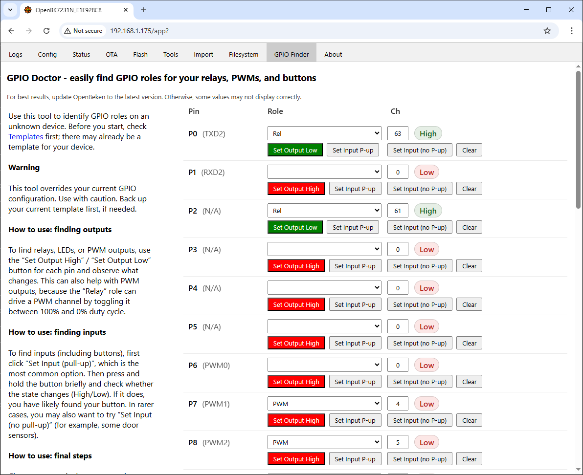

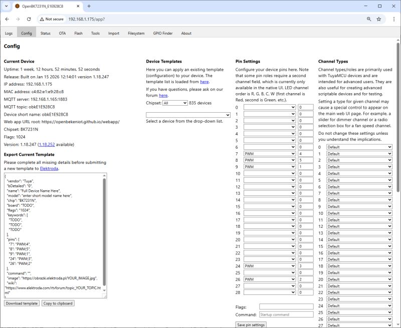

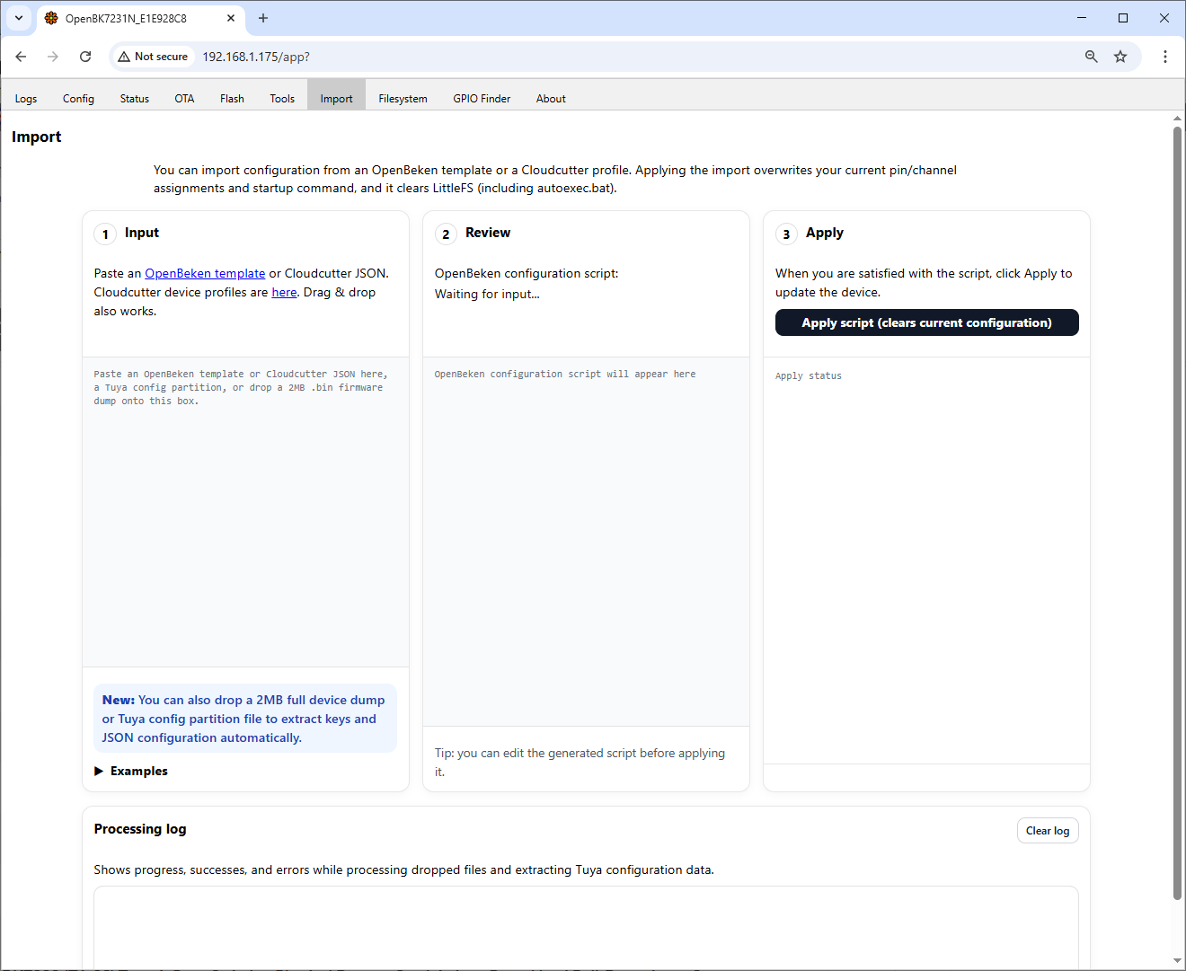

    OpenBK7231N config panel with pin setup and device template settings
    OpenBeken import page with three sections: Input, Review, and Apply
    OpenBeken interface screen with imported smart device configuration
    GPIO Doctor interface in OpenBeken with assigned pin roles and control buttons

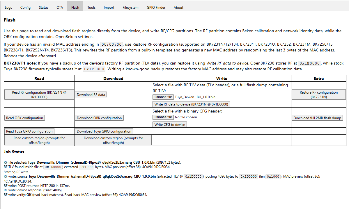

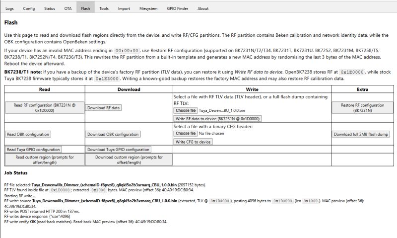

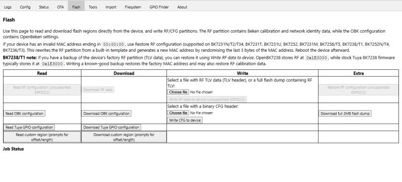

    revised wording in flash.vue a little. The RF write from backup requires the file selected starts with TLV\0 (0x54 0x4C 0x56 0x00), so not full backup. Maybe that should be next.

    did some more. but ..overkill?
    - Refactored RF offsets into a single chipset->RF base table and derived CFG as (RF + 0x1000).

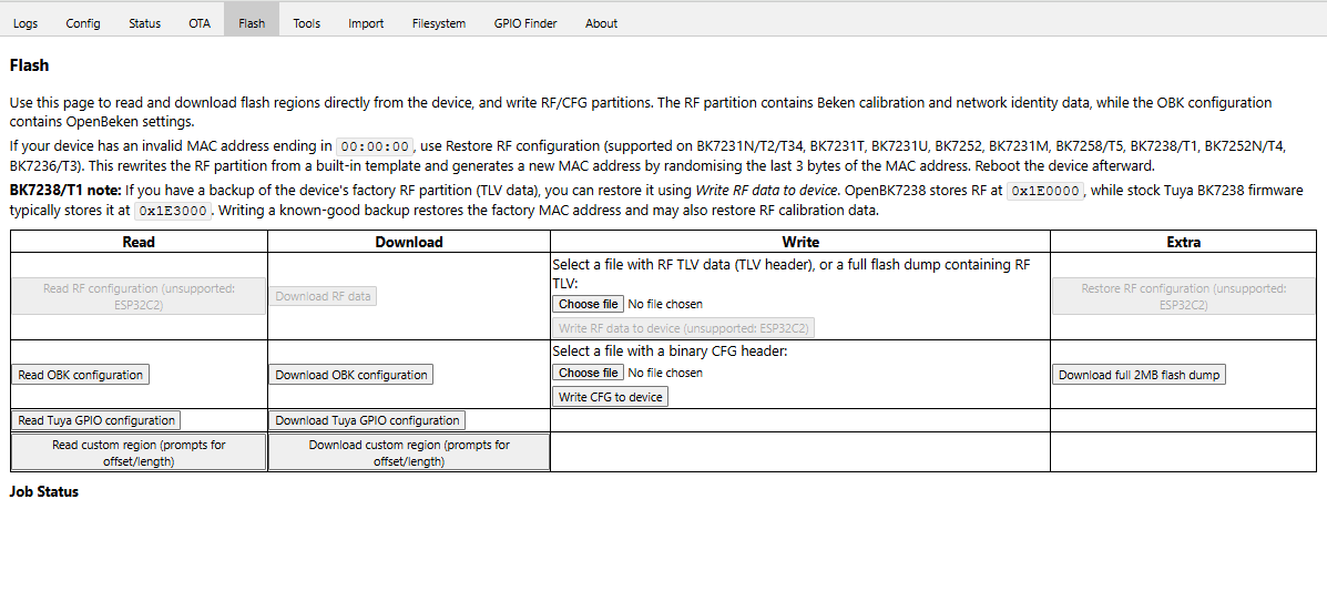

    - Added RF support guarding for non-Beken/unsupported chipsets (disabled buttons, tooltips, and runtime hard-stops).
    - Guarded “Read RF Configuration” to match the restore/write RF button behaviour (same enable/disable logic and messaging).
    - Converted “Download RF data” from link to guarded button and implemented it via fetch+Blob download.
    - Converted “Download OBK configuration” from link to button (left unguarded) and implemented it via fetch+Blob download.
    - Fixed RF download to save as rfdata.bin with application/octet-stream (prevents “text file” saves) and aligned config naming similarly.
    - Implemented BK7238 RF read/download auto-detect: try 0x1E3000 first, fall back to 0x1E0000 if the block doesn’t start with TLV\0.
    - Added ability to use a full flash dump for RF “TLV restore” by locating TLV\0 and extracting exactly 0x1000 bytes for flashing.
    - Added an 8MB max-size rejection for the RF file input to avoid accidental huge uploads.
    - Added RF source metadata and logging (filename, whether extracted vs direct TLV-at-0, and extracted offset).
    - Added MAC preview logging and read-back verification for RF write (compare written 0x1000 vs device read-back).
    - Standardised confirmation prompts via a single promptYes() helper (case-insensitive YES/y handling).
    - Improved custom length prompt parsing to accept decimal bytes or hex (0xNNNN / NNNNh) and translate to backend hex length.
    - Added a single RF-supported-chipset constant/list reused by enablement logic and tooltip text (reduces drift/duplication).
    - Added central fetch helpers (fetchOrThrow/fetchArrayBufferOrThrow/fetchTextOrThrow) and applied them to previously unchecked calls (ensures response.ok is enforced consistently).
    - Improved full dump chunk download to enforce response.ok before consuming the body.
    - Changed downloadArrayBuffer() to revoke object URLs after a short delay instead of immediately (browser reliability).
    - Removed an unused full-dump workflow field (fullDumpFileTag) while keeping dump naming based on chipset/style/shortName.
    - Minor copy/tooltip text adjustments (including the BK7238 note and restore-RF MAC wording).
    Screenshot of the “Flash” tab with buttons to read, download, and write RF/CFG data and configs.
    Screenshot of a “Flash” page with a table for reading, downloading, and writing RF/CFG/OBK configurations
    is OBK CFG download/read used? should it stay?
    Should I continue to confirm all OK in testing or...?
  • #34 21840816
    Posts: 14771
    Rate: 12914
    At first glance seems acceptable, but avoid low contrast graphical changes and excessive styling, we still hope to host it on OBK LFS itself when required, with GZIP of course. Any serious changes?
