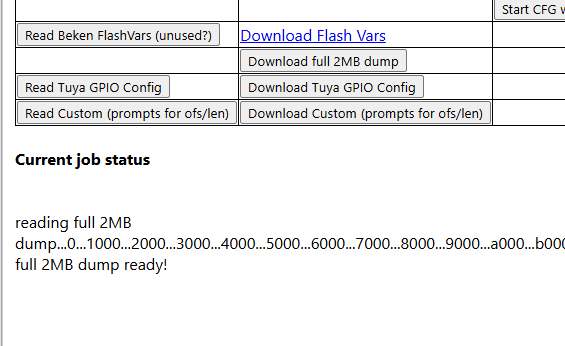

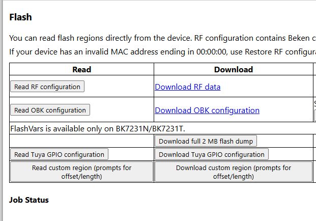

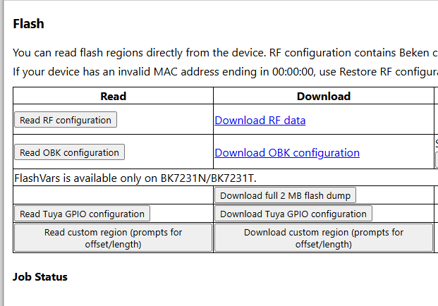

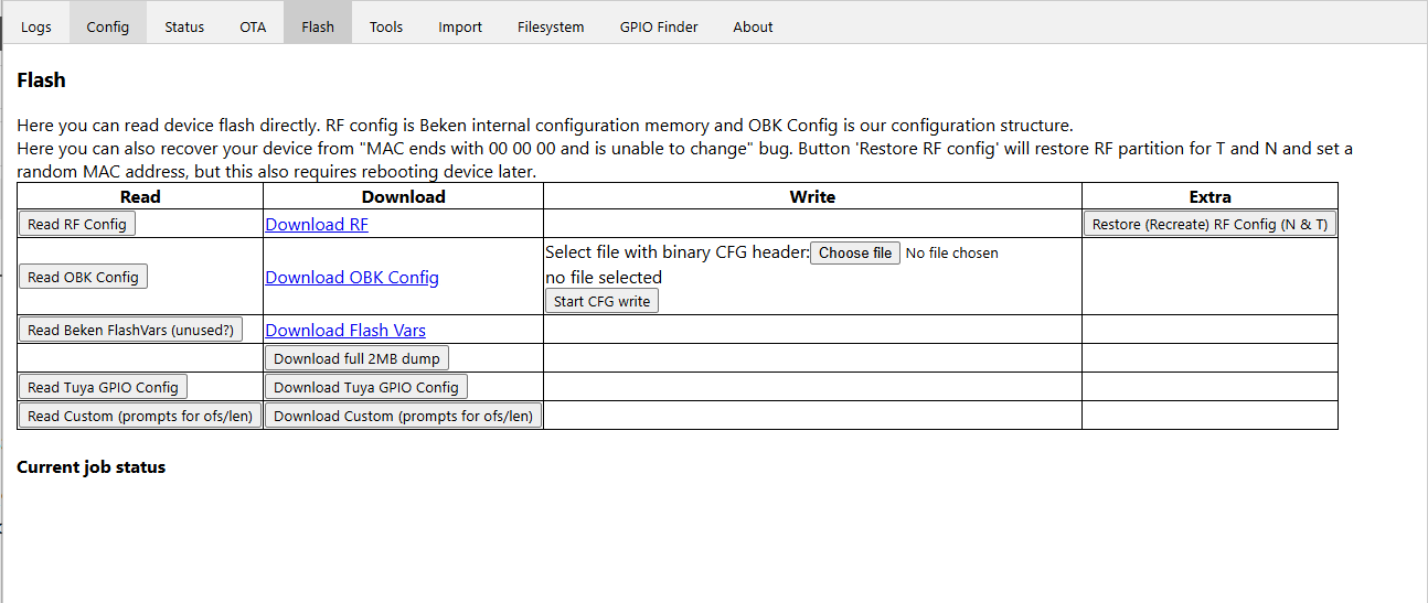

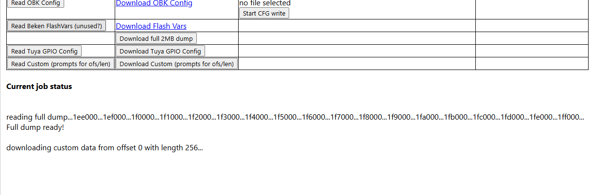

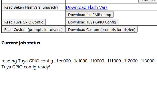

    Couldn't find an appropriate thread to hijack.

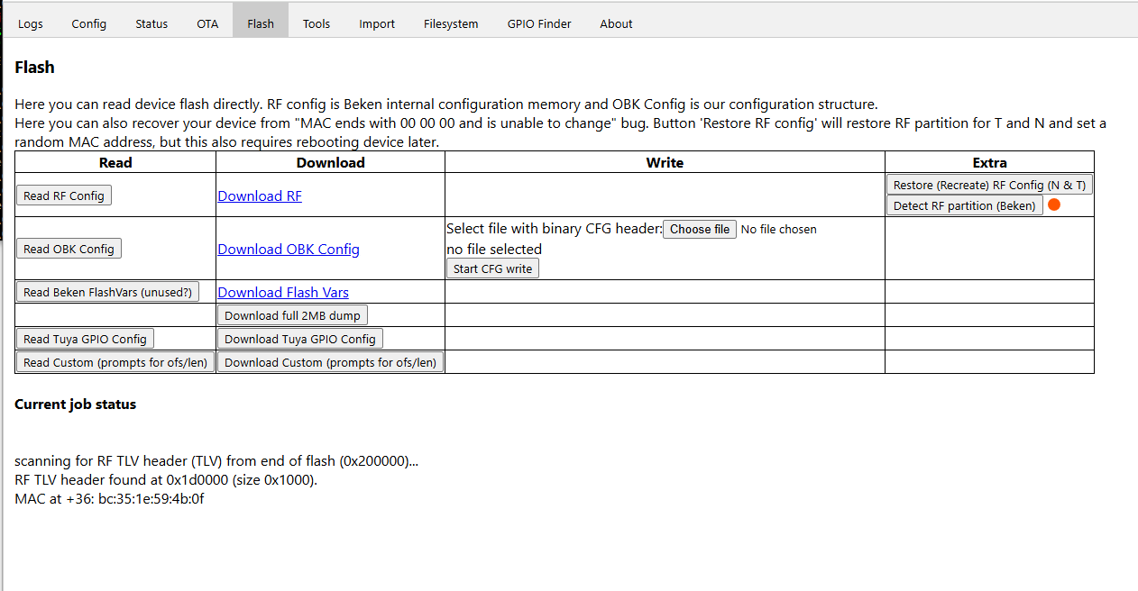

    flash tab in the web app currently says
    when choosing Download Tuya GPIO Config. Which is not correct.
    and Download Custom doesn't give a "..ready!" log like full and tuya buttons do when complete

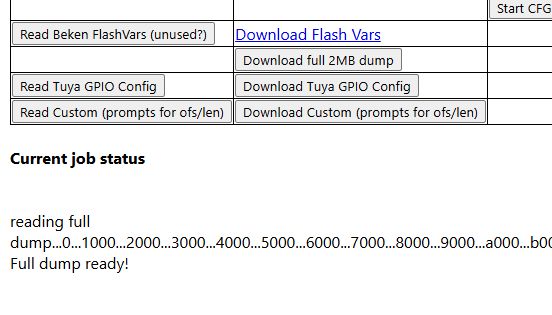

    Screenshot of a flash memory dump interface with progress output
    Full dump button is correct and says full is complete at the end
    Screenshot of flash memory reading interface with Full dump ready! message

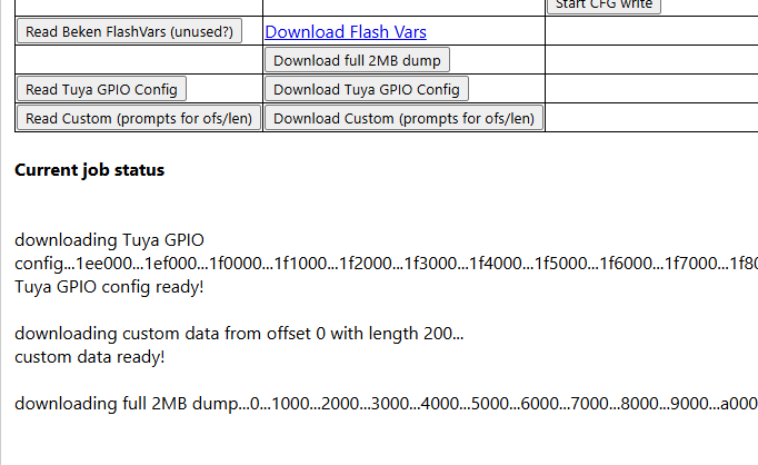

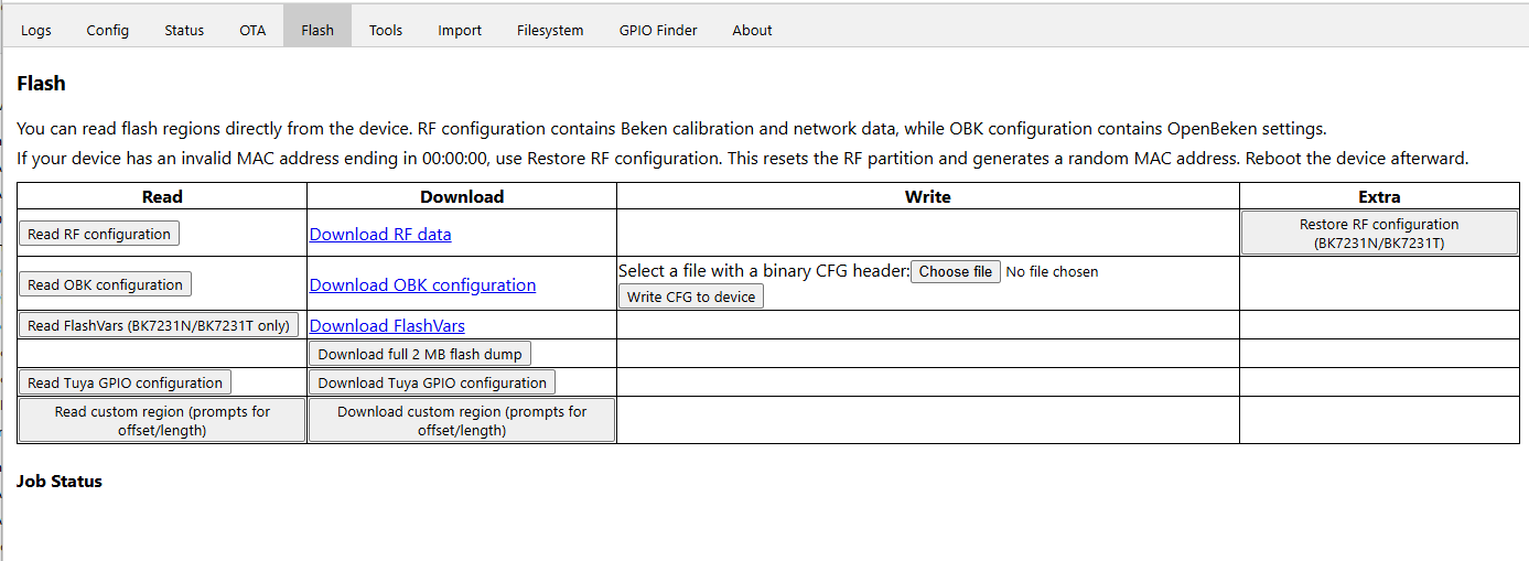

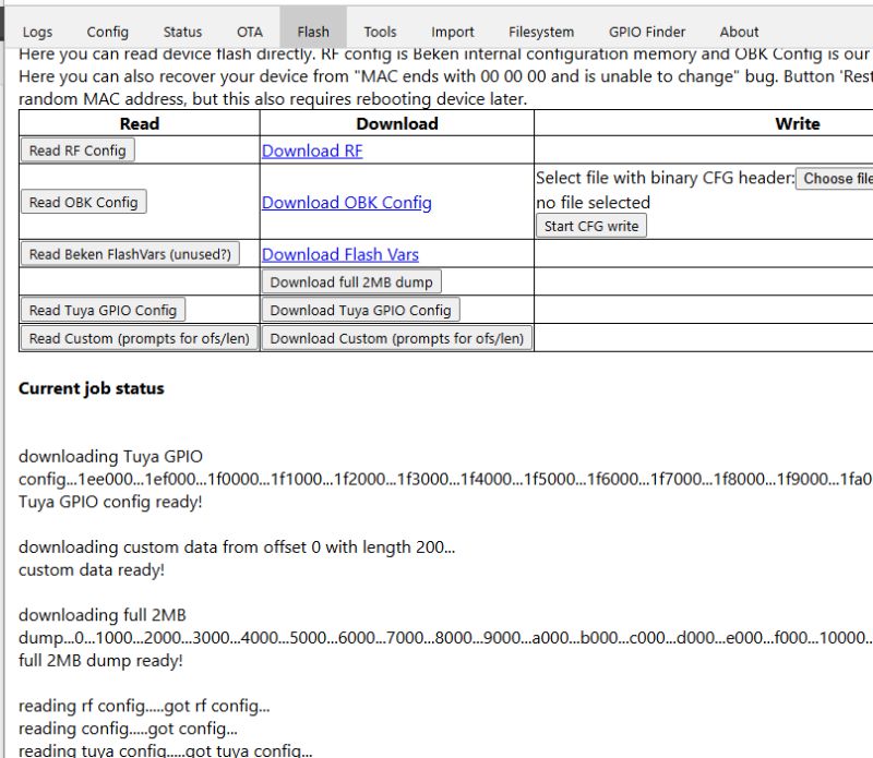

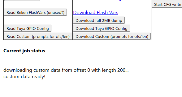

    I've played with flash.vue and I hope this is a small worthy improvement. It seems OK in testing
    Screenshot of interface with message indicating Tuya GPIO config read complete
    Custom data download status showing offset 0 and length 200
    Screenshot of a tool interface for reading and downloading 2MB flash memory
    https://github.com/OpenBekenIOT/webapp/pull/249
    Added after 8 [minutes]:
    tweaked again so download buttons give "downloading..." message instead of "reading.."
    Screenshot of a tool interface downloading data from Tuya and Beken chips.
    read buttons continue to say "reading.."
    Interface with options to read and download device configuration
  • Refactor duplicated flash dump code into shared function
    #2 21800819
    Posts: 14771
    Rate: 12914
    good for a start, but for perfection, I'd suggest getting this code (which appears twice in two versions)
                this.fullDumpFlashStart = 0;
                this.fullDumpFlashSize = 2097152;
                this.fullDumpStyle = "xyz";
                this.doFlashDumpInternal();
    and putting it inside the shared function (use function arguments), currently called:
                this.setDumpJob("Tuya GPIO config", "TuyaConfig");
    I would rename setDumpJob to startDumpJob and it would be perfect.
    To be clear - it's not your fault, as the duplication was already in code (probably I was lazy), but if you are improving with LLM, then it could be done very easily as well.
  • #3 21800824
    Posts: 5220
    Help: 449
    Rate: 918
    thank you. I will adjust asap!
  • #5 21801475
    Posts: 14771
    Rate: 12914
    Way better, I will merge it now, in future we may think about removing one string name, unless all 3 are used?
                this.startDumpJob("full 2MB dump", "FullDump", 0, 2097152, "QIO");

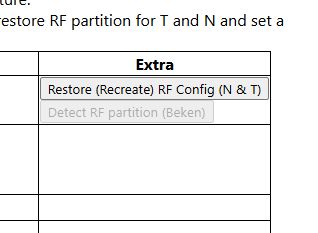

    I also have some extra bits relating to Beken TLV location detection and maybe BK7238 RF move, all based off https://github.com/openshwprojects/BK7231GUIF...b/main/BK7231Flasher/Utils/RFPartitionUtil.cs

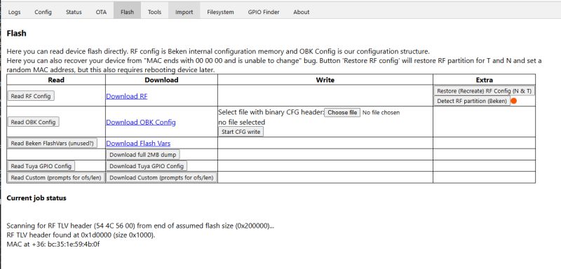

    Here's TLV test
    Web App Flash Tab: Inconsistent Status Messages for Tuya GPIO and Custom Dump Buttons
  • Chunk-boundary TLV headers can be missed
    #8 21802316
    Posts: 14771
    Rate: 12914
    Nice little tool, however, I think you might have a slight issue there.
    You are basically reading memory in 0x1000 bytes blocks, right? So you read 4096 bytes, check them, next 4096 bytes, check them , etc.
    And you look in each 4096 chunk for 4 bytes - TLV header.
    But now look....
    What if TLV header is on the boundary of chunks? Let's say there are two 4096 byte chunks but "TL" is the last two bytes of first chunk, and "V" is the first byte of second chunk?
    You won't find it that way.

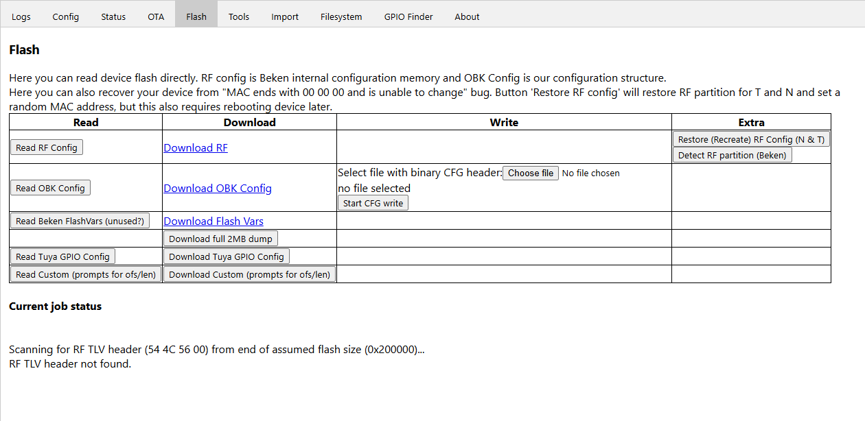

    I was just wondering how likely that is BUT there's a bigger issue, which makes addition pointless now.
    The main reason for this venture was that OBKs RF offset does not match Tuya's for BK7238 so this was to be a way to see what the untouched Tuya RF start address was, but actually, OBK seems to overwrite TLV anyway, making a scan of the factory dump while converting device the only option to restore original RF to OBK position.
    I attach an OBK-converted BK7238 image where TLV is clearly gone. And of course the scan for TLV fails
    Screenshot of device flash management tool interface, Flash tab active
    • AFTER_withOBK.bin (2 MB) You must be logged in to download this attachment.
    • BEFORE_factory.bin (2 MB) You must be logged in to download this attachment.

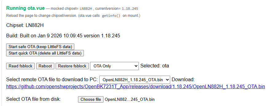

  • ota.vue variant handling for _gz and _ota files
    #15 21804459
    Posts: 5220
    Help: 449
    Rate: 918
    bum.

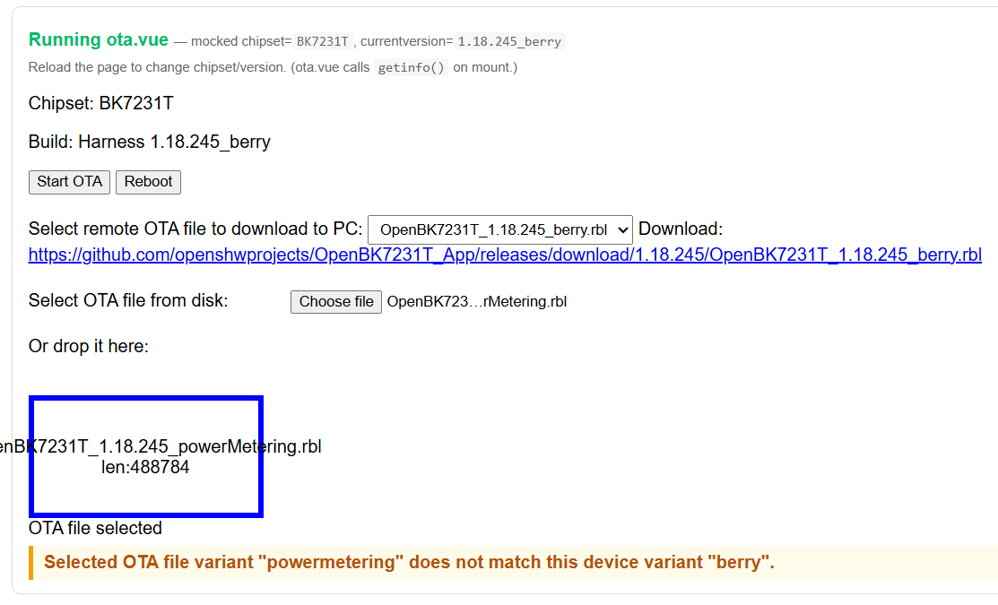

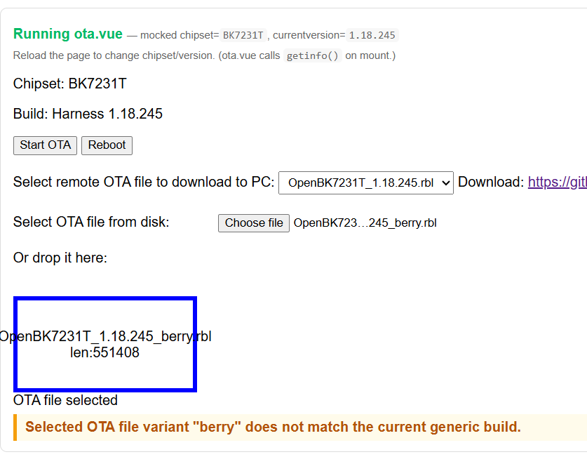

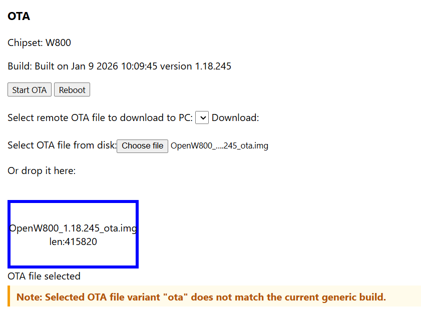

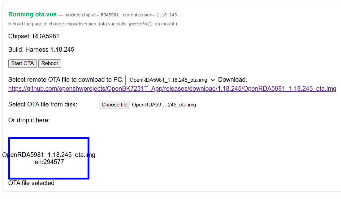

    ota.vue is treating _gz. and _ota. as variants
    eg
    OTA interface screenshot with warning about incompatible update file variant
    I'm away for the weekend so don't have everything with me, but here's what I think will sort the issue. This is real test on W800
    OTA update interface with selected file OpenW800 1.18.245 and chipset W800
    thoughts?
    https://github.com/OpenBekenIOT/webapp/commit/19d776eed832ca2c7f4d7208c05bfc458a7a0be9
    I can test all scenarios in a day or two if it can wait. Users can still ignore the warning and flash for now...
    #16 21804569
    Posts: 14771
    Rate: 12914

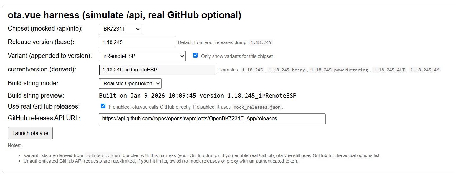

    I think you can do it more efficiently. I think you can ask LLM to fetch whole list of files, put it to JSON or anything, and then use "test driven development" to figure out correct regular expression.
    It's all within current LLM abilities, so it should be a fun thing to try.
    Futhermore, you can test it all without vue, just fully in html/js page on disk or in the editor/playground.

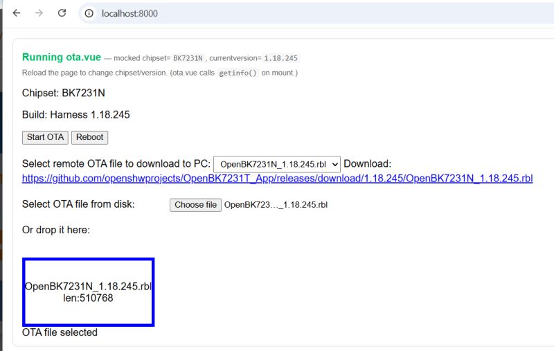

  • Simulating /api locally to test ota.vue
    #17 21804843

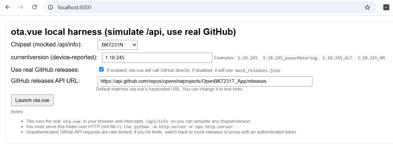

    Posts: 5220
    Help: 449
    Rate: 918

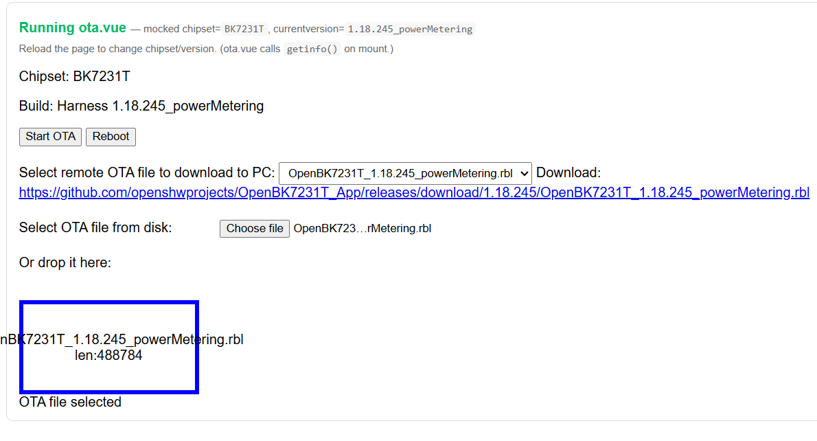

    yes. good point. I was already using node.js to override and use local ota.vue but it still relied on real device
    but could go further to simulate /api so I can choose platform before ota.vue. like this:
    ota.vue interface simulating API with selected chipset and firmware version
    OTA update interface for BK7231N chipset with firmware file loaded
    im not finding any incorrect warnings with code change in PR, but sounds like you think it can be better still (which I don't doubt)
    OTA interface with selected file OpenRDA5981_1.18.245_ota.img
    OTA interface for BK7231T chipset with powerMetering firmware file loaded.
    Screenshot of OTA interface for BK7231T showing firmware variant mismatch error.
    Screenshot of OTA interface for BK7231T chipset with 'berry' file variant mismatch error
    etc
    would be nicer if the variant case in warnings matched the file though
    Added after 7 [minutes]:
    code if curious
    Code: Python
    http://localhost:8000/
    • ota_harness_live_github.zip (8.89 KB) You must be logged in to download this attachment.

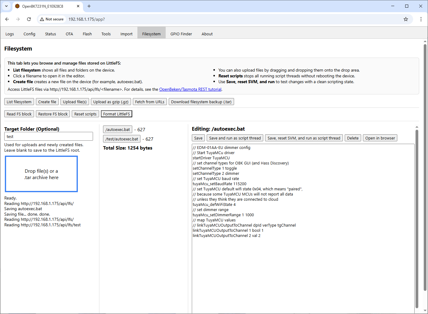

  • supportsLittleFS branch appears always disabled
    #21 21806037
    Posts: 5220
    Help: 449
    Rate: 918
    So, it's ready to merge?
    I reckon yes. I've tested loads with fake api thing that lets me choose platform and variant before using testing ota file behaviour with real ota.vue.
    Added after 35 [minutes]:
    on a refactor and just looking into supportsLittleFS in ota.vue
    OTA update interface for LN882H chipset with file options and action buttons.
    this is always disabled so can be cut completely?
    https://github.com/OpenBekenIOT/webapp/blob/0...32c03c696a004c563713/vue/ota.vue#L76C9-L76C25

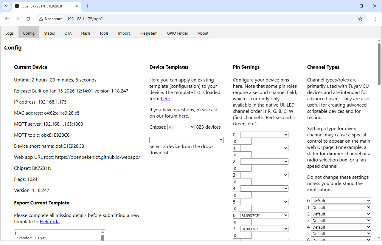

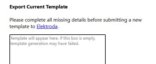

    reviewed info.vue
    -changed uptime in seconds to approximate years/months/days count (better than only seconds?)
    -standardised capitalisation, revised wording, grammar - more formal, neutral tone
    -added missing chipsets to template drop-down filter
    -made update check variant-aware so update available line now only shows if there really is an update (variants would always show latest before)
    -encourage template detail completion more obviously before Elektroda posting
    -placeholder text in export template box instead of 'qqq'
    Template export form with empty text box and link to Elektroda
    -update CHT8305 to CHT83XX in templates and pin list
    -add missing pinrolenames
    https://github.com/OpenBekenIOT/webapp/pull/257

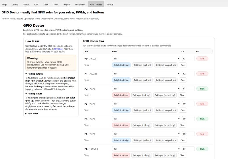

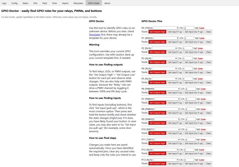

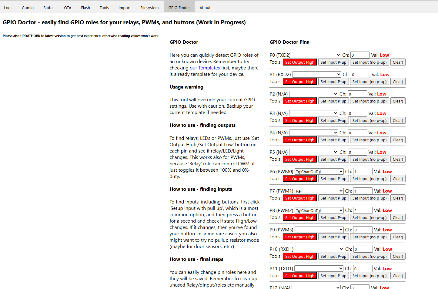

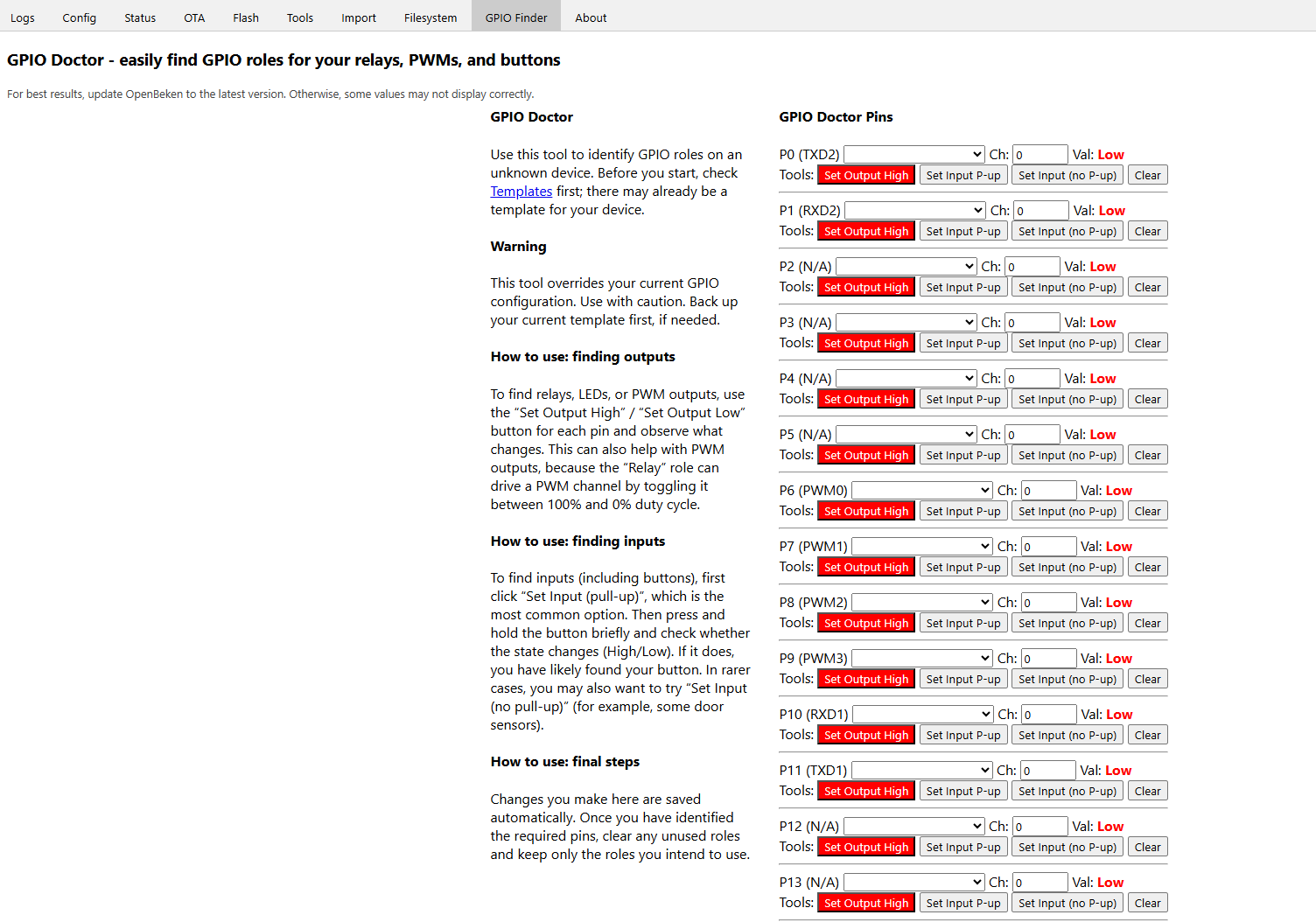

  • Questions on app wording and GPIO Finder naming

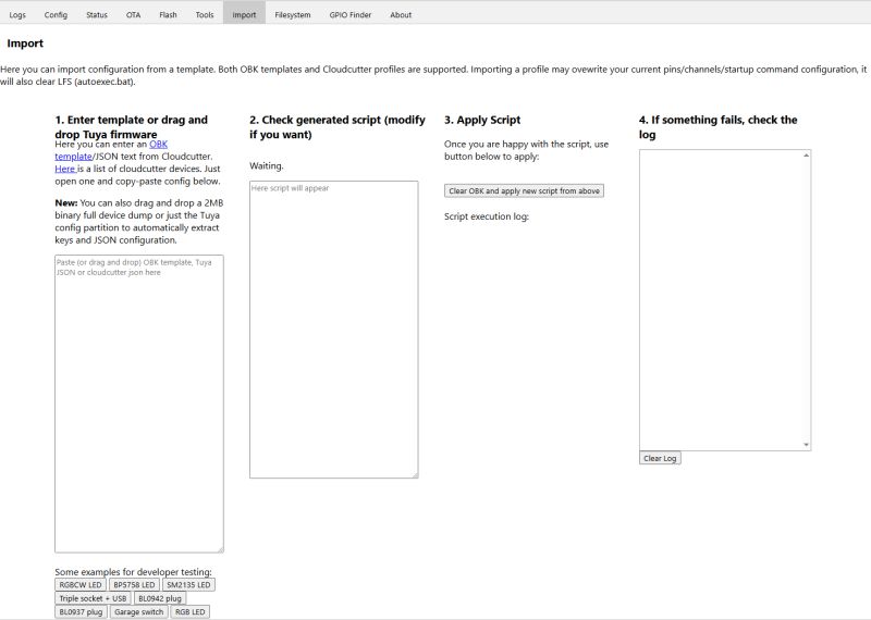

    #23 21813933
    Posts: 5220
    Help: 449
    Rate: 918

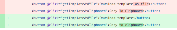

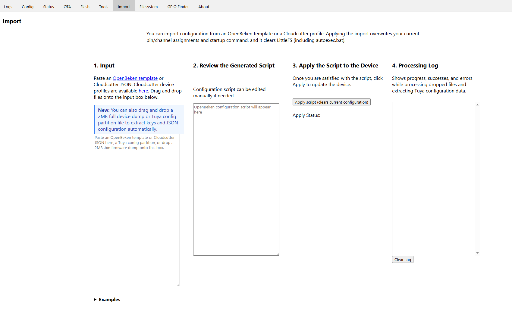

    I've extended the review to the rest of the web app. This is a WIP. It's mostly consistency, grammar, spelling, switching to a more formal tone.
    current state
    https://github.com/OpenBekenIOT/webapp/compar....divadiow:OpenBekenIOT-webapp:vueoverhaul_all
    questions:
    -US-English or British-English preferred, if at all (US-English seemed to be the preference)?
    -Title Casing for button text or sentence? (accepted PR for info.vue was sentence)
    eg
    Code diff showing HTML buttons for downloading and copying a template
    -Single 'quotes' or double "quotes", where used?
    -GPIO Doctor or GPIO Finder or both? GPIO Finder is more accurate I think, the 'Dr' doesn't actually diagnose or fix(?), but it's become known as the GPIO Dr.
  • UI text tweaks and flashvars disabled for non-BK7231T/N
    #24 21819813
    Posts: 5220
    Help: 449
    Rate: 918

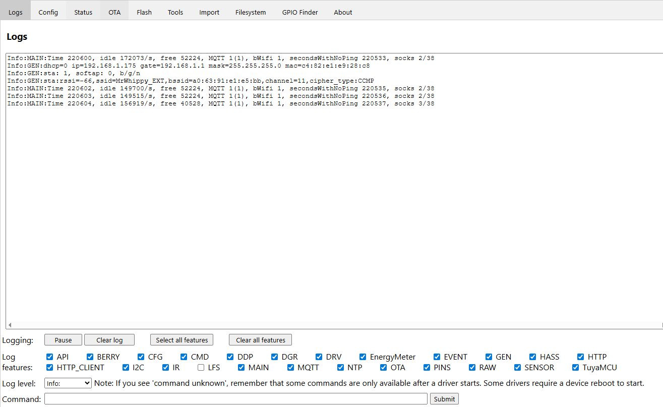

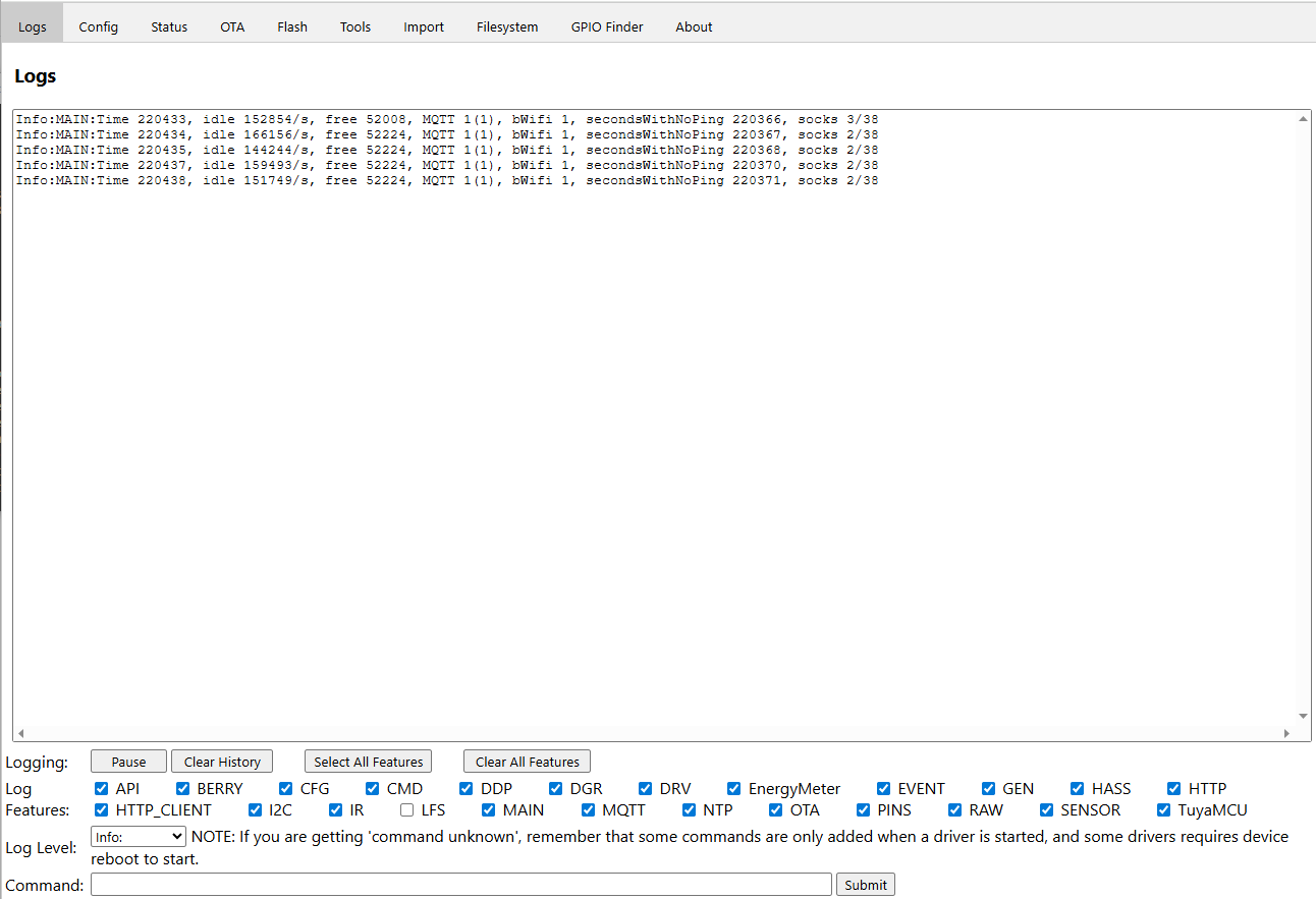

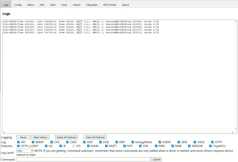

    OK.
    Logs
    Before
    OpenBK system log interface showing MAIN and MQTT entries
    After
    Screenshot of a web interface log panel with system status messages
    bit of text tweaking.

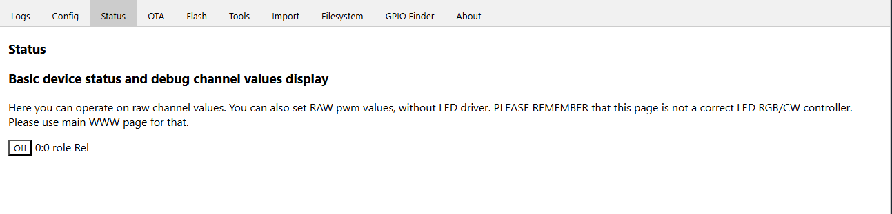

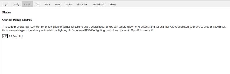

    Status
    Before
    Device status interface with “Off” button for channel 0:0 role relay
    After
    Channel debug interface in OpenBeken software showing relay role and toggle switch
    text tweaking

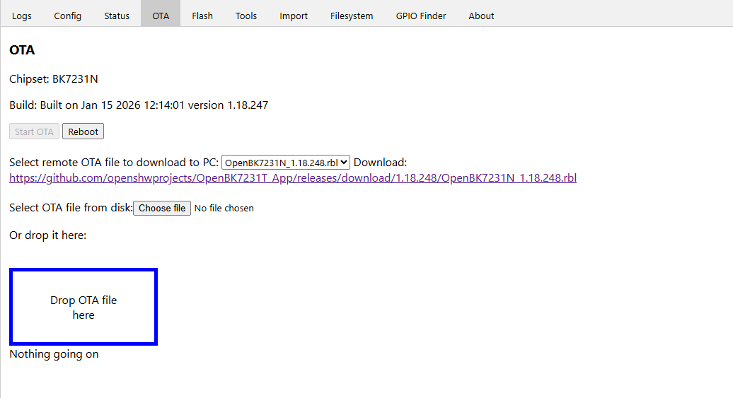

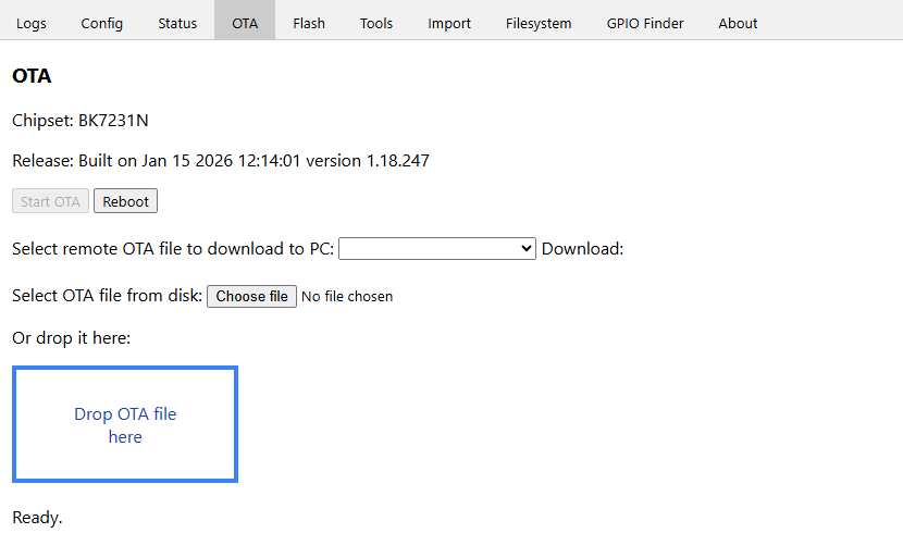

    OTA
    Before
    OTA interface with file selection, buttons, and firmware download link
    After
    OTA interface for BK7231N with file upload option and reboot button
    text tweaking, spacing, soften blue border

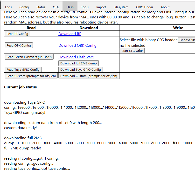

    Flash
    Before
    Screenshot of device flash management interface with config read/write options
    After
    Screenshot of the Flash tab in the OpenBeken interface
    text tweaking, remove duplicate "no file selected" type status, disable flashvars for non-BK7231T/N (maybe it should be removed or extended to support more platforms?
    Table with read and download options for flash configuration on BK7231N/BK7231T

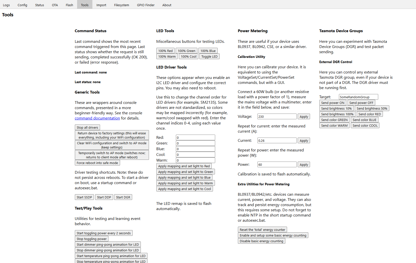

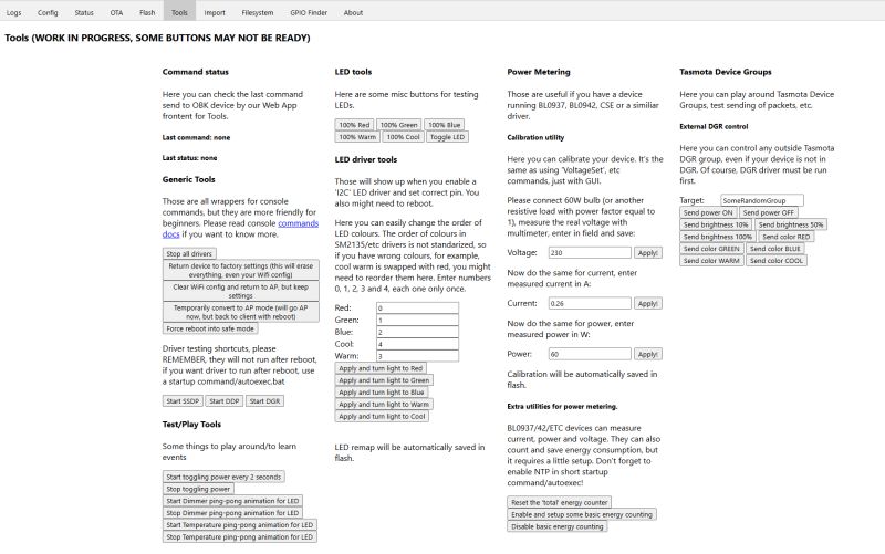

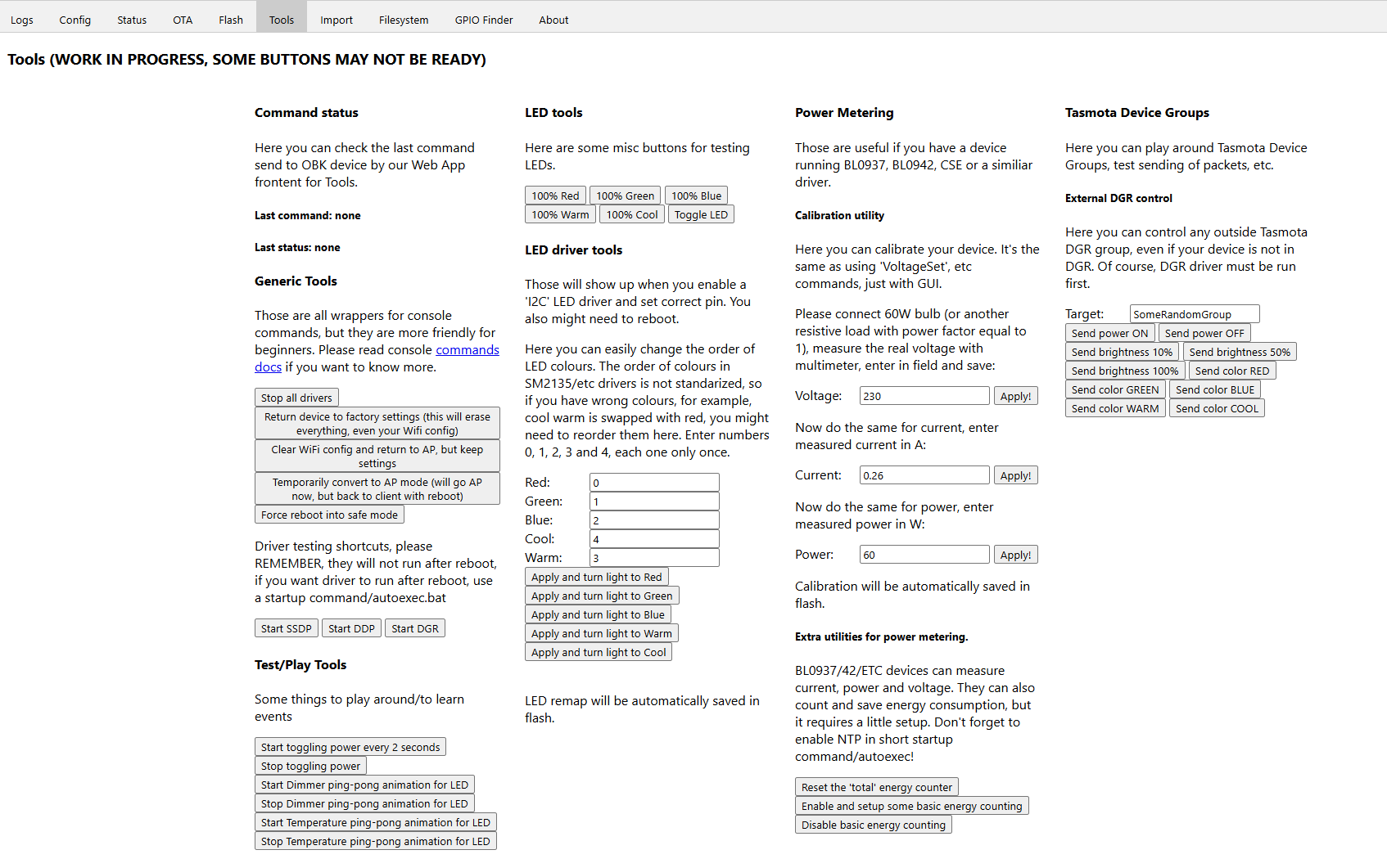

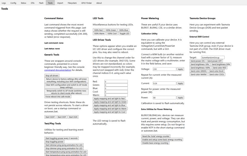

    Tools
    Before
    Tool panel UI with options for LED controls, power metering, and device group settings.
    After
    Screenshot of Tasmota's configuration tools tab with various test and utility sections.
    text tweaking

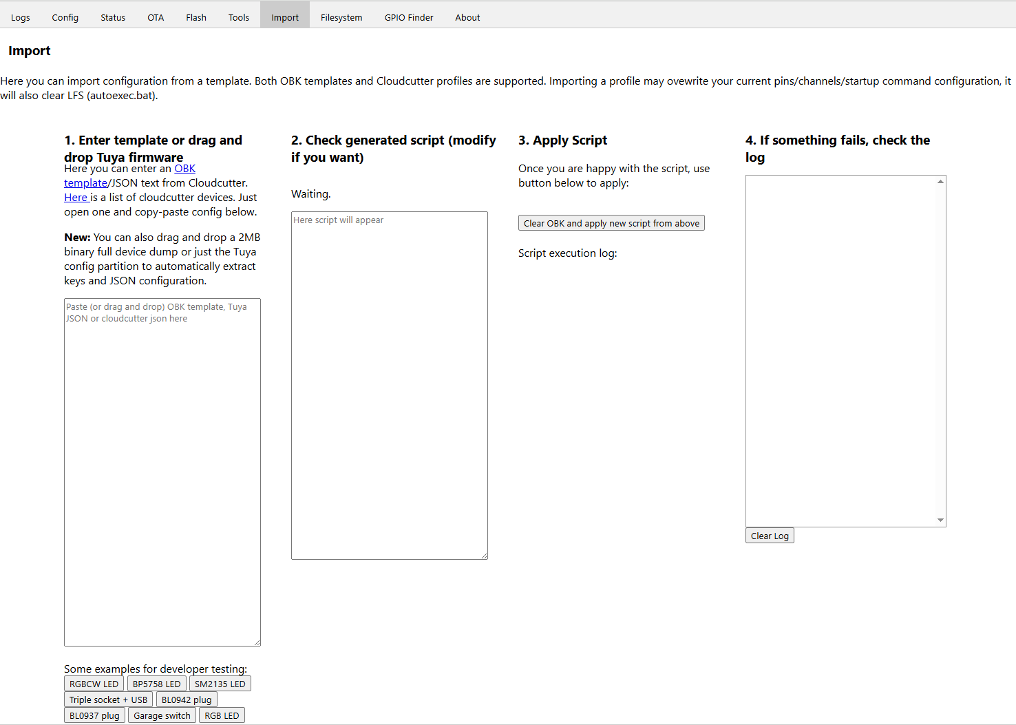

    Import
    Before
    OpenBeken import interface for templates or Tuya firmware
    After
    Configuration import screen in OpenBeken interface with four sections

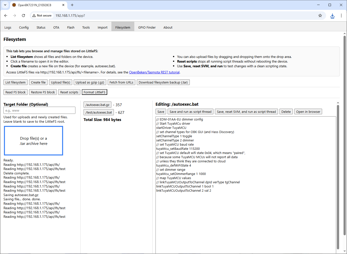

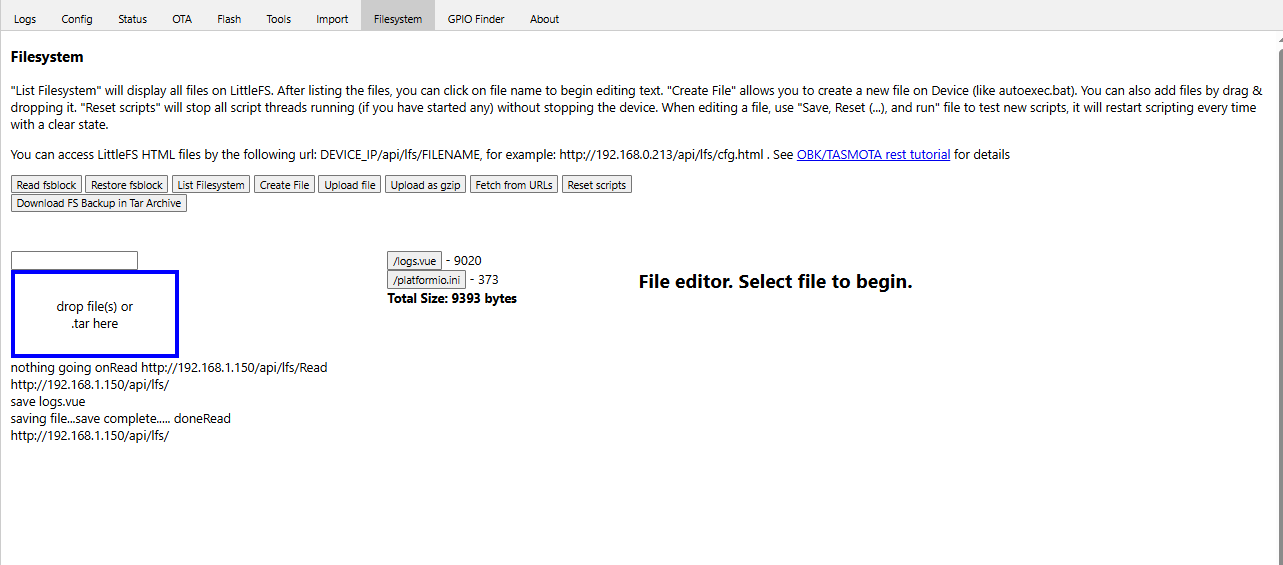

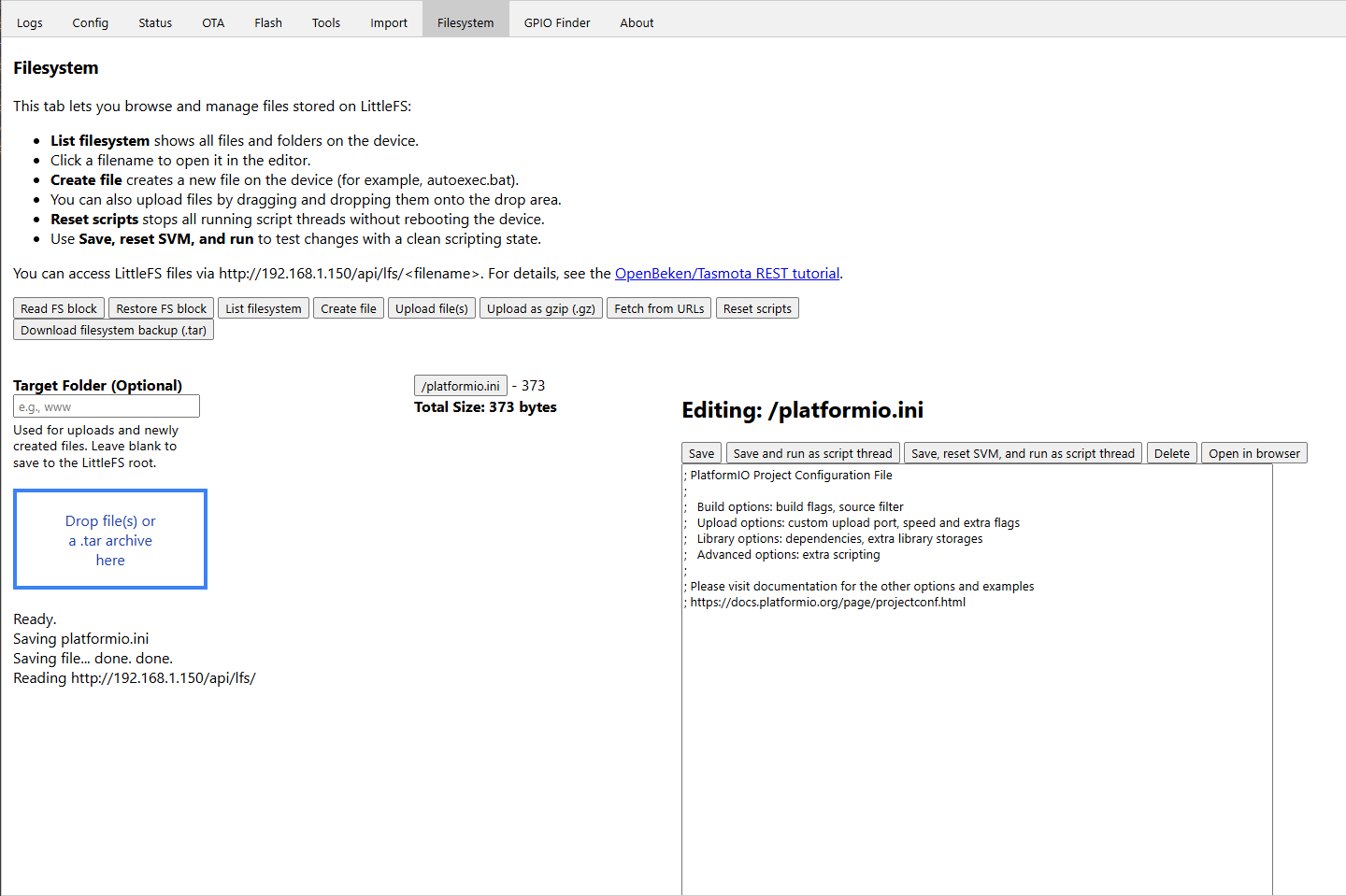

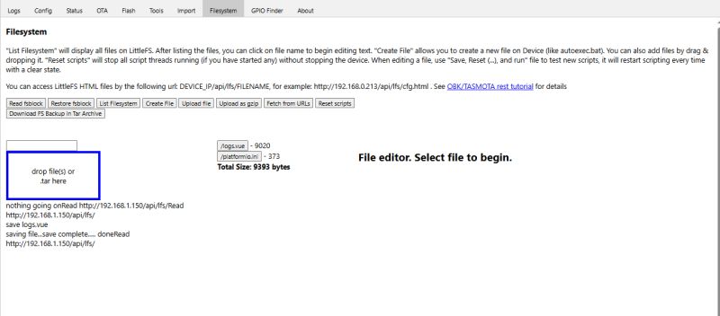

    Filesystem
    Before
    LittleFS filesystem interface with listed files and file operation options
    After
    Editing platformio.ini file in LittleFS filesystem web interface
    text tweaking, spacing, label and explain target folder, use real IP in LittleFS files line
    GPIO Doctor/Finder
    Before
    Screenshot of GPIO Doctor tool showing GPIO pin settings and functions
    After
    GPIO Doctor interface showing pin list with controls for input/output settings
    Text tweaking, remove ) from "Clear" buttons (would full "pull-up" and "no pull-up" be better?)

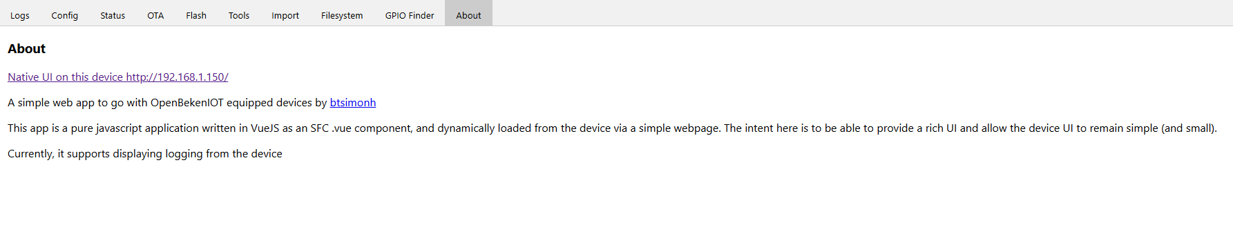

    About
    Before
    OpenBeken web interface with About tab and app description in view
    After
    About tab in OpenBekenIOT web interface with app description
    text tweaking
    https://github.com/OpenBekenIOT/webapp/pull/261

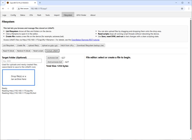

    redid spacing and order of filesystem buttons. added "Format LittleFS" - there doesn't seem to be a way to delete folders, only files.
    LittleFS file manager interface with format, upload, and editing options.
    https://github.com/OpenBekenIOT/webapp/pull/2...nges/90d6a1a0c61b5ca0d37a9637ee3a650c6d0dc663

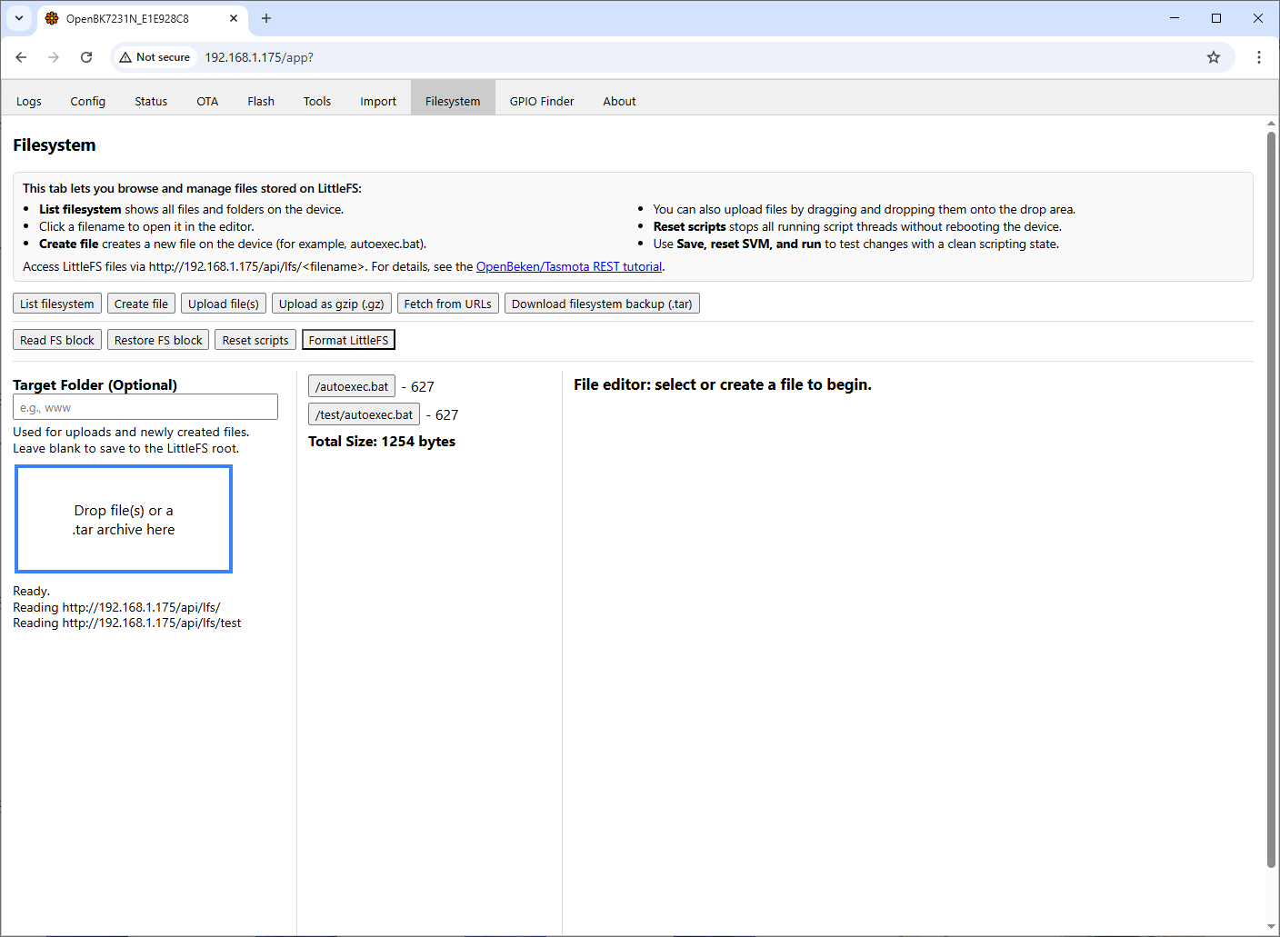

  • #25 21821723
    Posts: 5220
    Help: 449
    Rate: 918
    soliciting for feedback. love/hate/disagree etc
    #26 21822449
    insmod
    Posts: 1432
    Help: 168
    Rate: 455
    Looks fine overall, but please rewrite filesystem header to be more compact.
    General suggestions:
    Littlefs resize function in ui
    Align gpio doctor pins like in native ui
    Align import textareas (height)
    Align channel types (config page)
    Mention BK7238 in restore rf config
    #27 21822457
    Posts: 14771
    Rate: 12914
    New "Drop file(s)" font color has worse contrast than the old one, please revert that black one.
  • Fewer borders and add LittleFS resize
    #28 21822479
    Posts: 5220
    Help: 449
    Rate: 918
    Thanks for feedback! All good. Will make changes
    Added after 2 [hours] 54 [minutes]:
    OpenBeken filesystem interface with autoexec.bat script being edited
    LittleFS file management interface in browser with open test folder and .bat files
    View of autoexec.bat file editor in OpenBeken interface via web browser

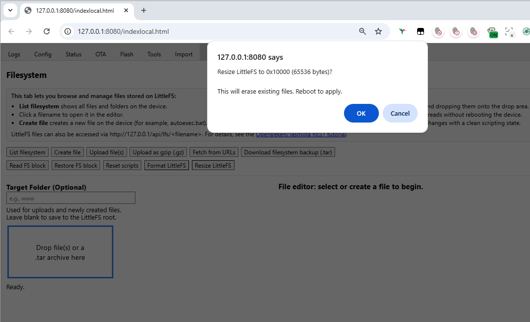

    no resize yet

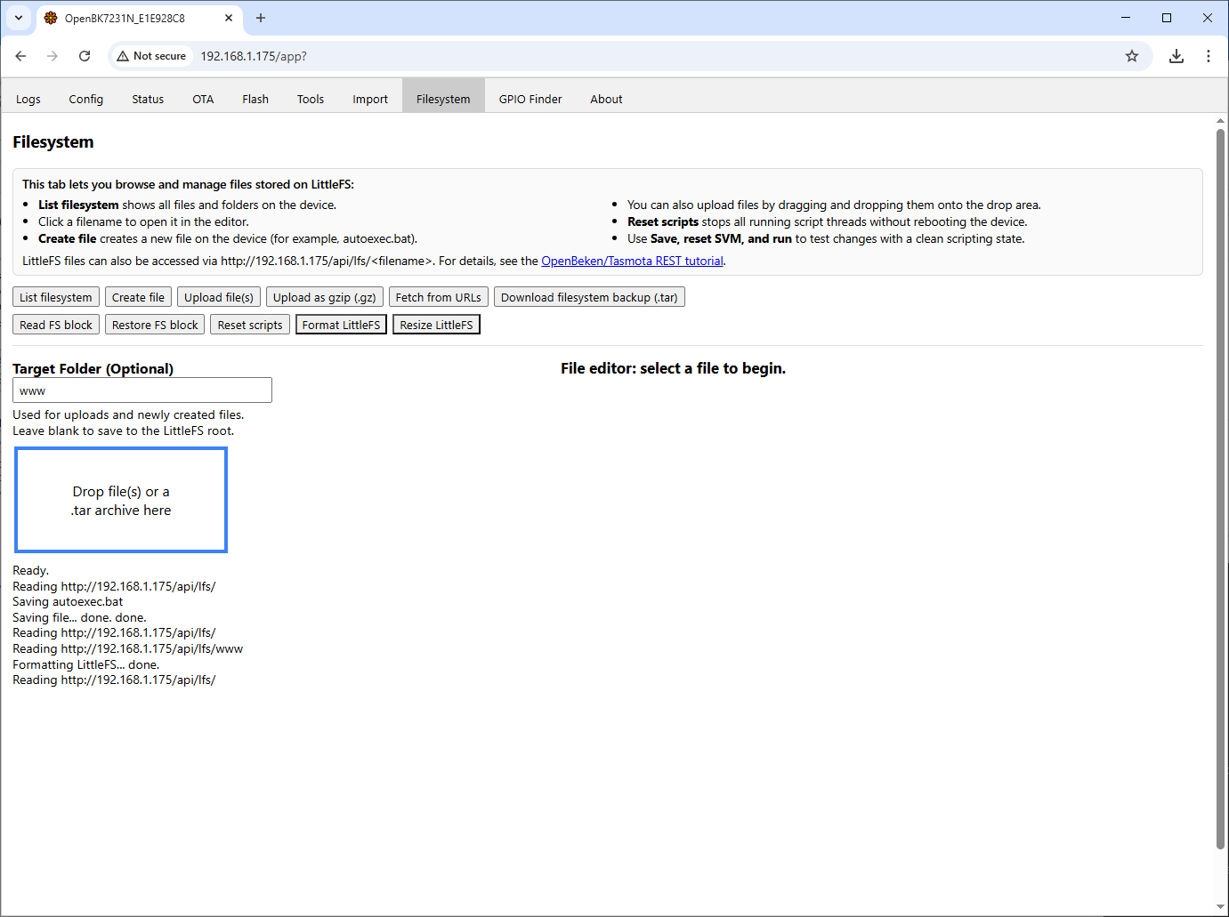

    Added after 1 [hours] 21 [minutes]:
    fewer borders. add Resize LittleFS
    OpenBK interface on Filesystem tab with file drop area and action buttons visible Screenshot of LittleFS file management interface in web browser
    Browser dialog box with input for LittleFS filesystem size in bytes Confirmation popup for resizing LittleFS in web browser interface
