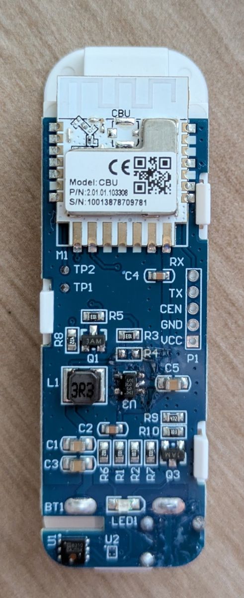

    A friend of mine bought a couple of these WiFi thermostats, and he realized later, that they (annoyingly) connect to the main server and you also need an app to monitor them,
    On the chip it says the following:
    CBU 2.01.01.103308
    Close-up of a thermostat PCB with a WiFi module labeled CBU and part number 2.01.01.103308.
    I searched around, and I found the tuya-cloudcutter github repo and the list of supported models, but I can't seem to find the exact model for this item.
    I searched the net and according to some images there are different versions (possibly older) of this thermostat, the differences being rather minor, like different icon on plastic or some of them have a barcode model name printed on one of the sides of the battery cover.
    Could the procedure presented in this thread work on this, or is it a different model?
    How could I find the model id/name and see if it is supported by cloudcutter?
    Do I need to dump the firmware?
    Also attaching additional images:

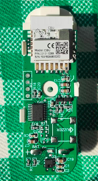

    I have a BK7321N CBU CHT8305 with a Green PCB Dated 2023.
    On the PCB there is written MCU WFWSD01 Ver01.
    I've managed to flash it properly but I've used all possible templates for the GPIO Assignments none of them worked Temperature is shown as 125Celsius and hum as 100%
    I've tried to extract the Tuya GPIO pins but I had no luck ( please see attached picture from the first post in the thread ).
    Manually I tried with:
    "20": "CHT83xx_SCK;0",
    "22": "CHT83xx_SDA;0;1",
    "22": "CHT83xx_SDA;1;0",
    Any ideas further on ?
  • #135 21612622
    Posts: 4859
    Help: 424
    Rate: 860
    Your device has a TuyaMCU so assigning CHT83XX driver to GPIOs is not how to set this one up. It'll be a case of creating an autoexec.bat and configuring dpID mappings. This device is similar https://www.elektroda.com/rtvforum/topic3968377.html
    Many TuyaMCU devices are in the devicelist from which the experience of others may help https://openbekeniot.github.io/webapp/devicesList.html
    https://www.elektroda.com/rtvforum/topic3970199.html
    https://www.youtube.com/watch?v=kXi8S12tmC8

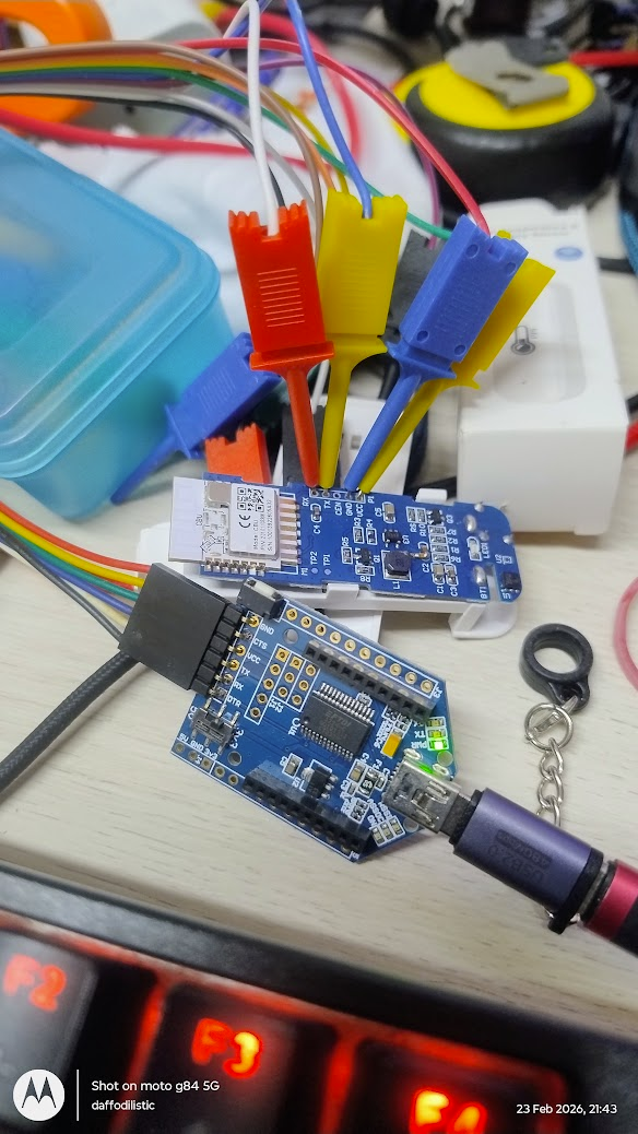

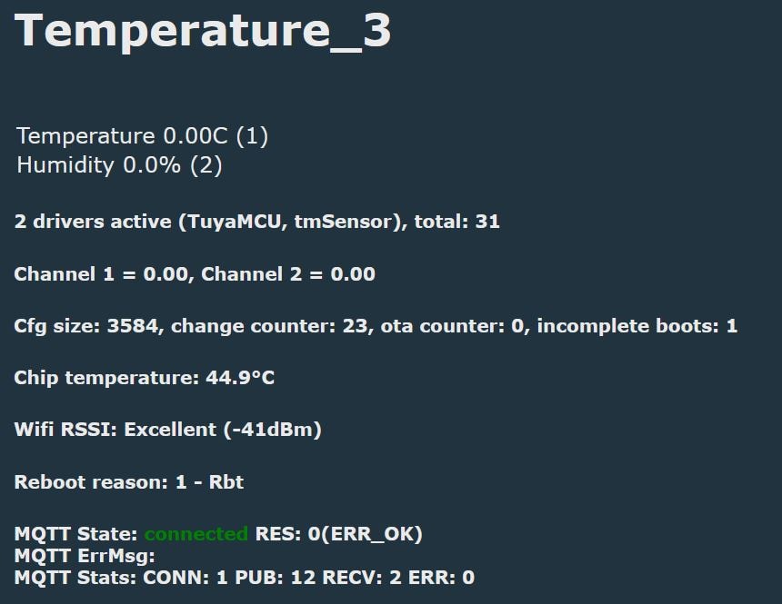

    >>21598960 I have same problem, temperature is 125 and hum as 100%. I tried few autoexecs from this thread but nothing works :( I'm always have temp 125. I have few identical looking devices but some of them have CHT8310 and others AHT20.
    I have problems only with that CHT8310. I have original firmware dump but I don't know how to extract pins from it. How I can discover proper pins?

    >>21697328 Tuya extractor says only "Sorry, no meaningful pins data found"
    I've changed drivers but nothing changed, also tried on batteries, now readings is always zero
    I'm only able to extract this:
       "abi":"0",
       "id":"null",
       "swv":"2.1.8",
       "bv":"40.00",
       "pv":"2.2",
       "lpv":"3.4",
       "pk":"x3o8epevyeo3z3oa",
       "firmk":"keycx5ftedppgup7",
       "cadv":"1.0.3",
       "cdv":"1.0.0",
       "dev_swv":"1.0.0",
       "s_id":"null",
       "dtp":"9",
       "sync":"0",
       "attr_num":"0",
       "mst_tp_0":"0",
       "mst_ver_0":"null",
       "mst_tp_1":"0",
       "mst_ver_1":"null",
       "mst_tp_2":"0",
       "mst_ver_2":"null",
       "mst_tp_3":"0",
       "mst_ver_3":"null "
    Changed startup commands to:
    startDriver TuyaMCU
    startDriver tmSensor
    setChannelType 1 temperature_div10
    setChannelType 2 Humidity

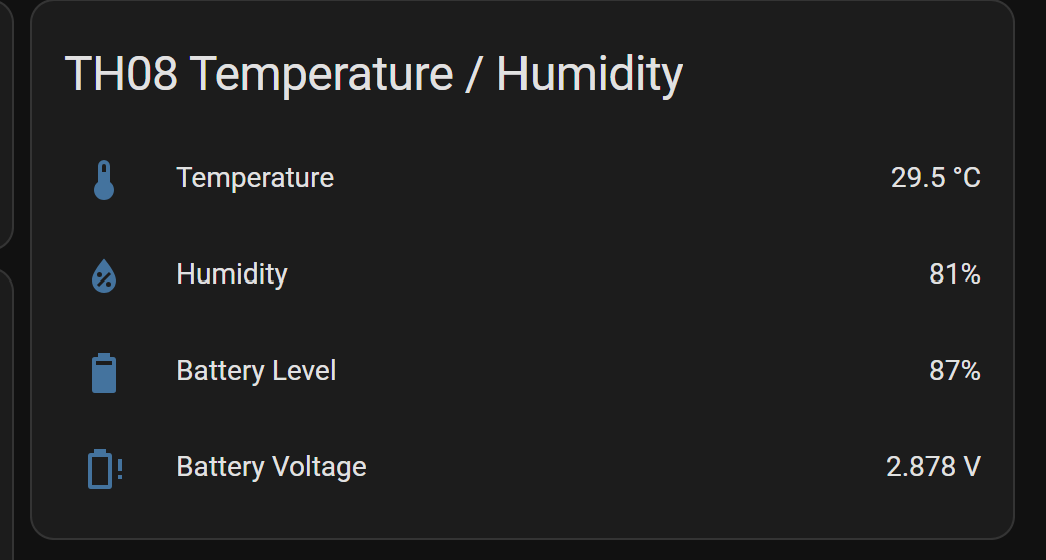

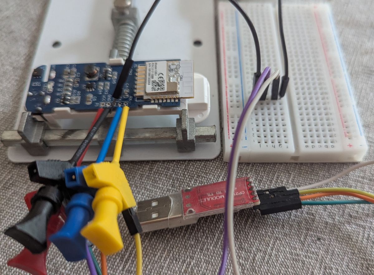

    I had alot of problems trying to get this to work, even flashing was an ordeal.
    With my sensor, the breakout pin pads on PCB where labelled weirdly. TX was connected to RX on module and RX was connected to TX. So with UART programmer I had to connect TX to TX on PCB pads and RX to RX. Check your PCB as maybe my one is different to others.
    I lifted the PCB in corner near MCU and used test hooks to connect the UART programmer so I didn't have to soldier anything.
    I tried several USB programmers and the only one I could get to work was a CP2102.
    To quickly connect CEN to ground I used a dupont jumper cables, GND from programmer went to breadboard, then I had test hook to GND on PCB and dupont jumper for CEN reset. I would quickly touch CEN on PCB with other end of dupont jumper cable. Takes 2 tries max to get sensor to go into programming mode. You could also use a button on breadboard to do the same thing.
    Close-up of an electronics setup with a circuit board, wires, breadboard, and a USB‑UART adapter

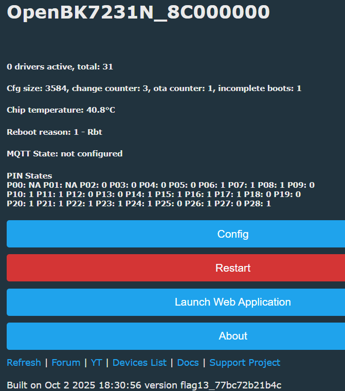

    The template from here didn't do what I wanted, as I wanted the autoexec,bat to no execute if button on sensor was pressed so sensor wouldn't go into deepsleep, and I would be able to change settings. The original template has button on pin 14 set to "14": "DoorSnsrWSleep;4",, not sure why as this is not a door sensor..
    Pin 14 is set to high (1) normally on my sensor so I could not get addEventHandler OnHold 14 to work.. My log was full of Info:GEN:14 Button_OnLongPressHold as if I was continuously pressing the button. On my one when button is pressed pin14 goes to 0, and when I release it pin14 goes back to 1.
    To check the value of your pin you can set flag 13.
    To do this remove settings for pin 14 ( "14": "dinput;4",) from template or in web app.. then from main gui -> config menu -> Configure General/Flags -> tick "Flag 13" -> Submit. This shows actual PIN logic level for unconfigured pins. Look for pin status on main gui.
    Screenshot of OpenBK7231N status page with system info and buttons: Config, Restart, Launch Web Application
    My config template:

    And this is what a my basic panel looks like in HA:
    TH08 panel readings: temperature 29.5°C, humidity 81%, battery 87%, battery voltage 2.878 V
    Not sure how long sensor will run with these settings, but hopefully a few months. Once I have completed testing I will set deepsleep to 600 (10 minutes) or longer depending on my needs.
    Hopefully this will help others and save time setting up sensor.

    Hi, I've just bought one of these devices from AliExpress, but I do not have a CH340-based USB-TTL adapter. However, I do have an old UartSBee_V4 that I got way back during my tinkering with Arduino Uno days, almost 12 years ago (I'm still quite new to the IoT/embedded world 😅). Would this old adapter be able to flash OpenBeken on the TH01 device? Thanks!
  • #147 21841771
    Posts: 14416
    Help: 650
    Rate: 12371
    Any USB to UART adapter should work. A good power supply is required, but I see yours have 3.3V LDO?
    DC current for 3.3v pin, up to 500mA provided for better support of XBee pro
  • #148 21846683
    daffodilistic
    Hi—yes, it does provide 3.3 V out via one of the output pins. I managed to get it to work with a mini-USB to USB-C adapter, but it seems like the device that I got is similar to @tahunasky version; RX and TX are flipped via PCB connection—whether this is for ease of flashing the device in the factory or a genuine mistake on the manufacturer's end, I am not sure.
    Two blue circuit boards connected with multicolored wires on a desk
    Flashing it was OK with the latest version of the flasher tool, but I had to flash it twice, as the first flash succeeded but failed to start—seems like an issue with the boot or with configuration somewhere.
    Finally, after playing with some device config files posted here in this thread (I had to remove the door sensor from the preset), it seems like I messed up the autoexec.bat settings and bricked the device, or it genuinely failed at that point in time—I'll investigate further another time.
    PS: If anyone knows how to set the button on the back of the sensor to function as a "factory reset" button, it would be greatly appreciated!
