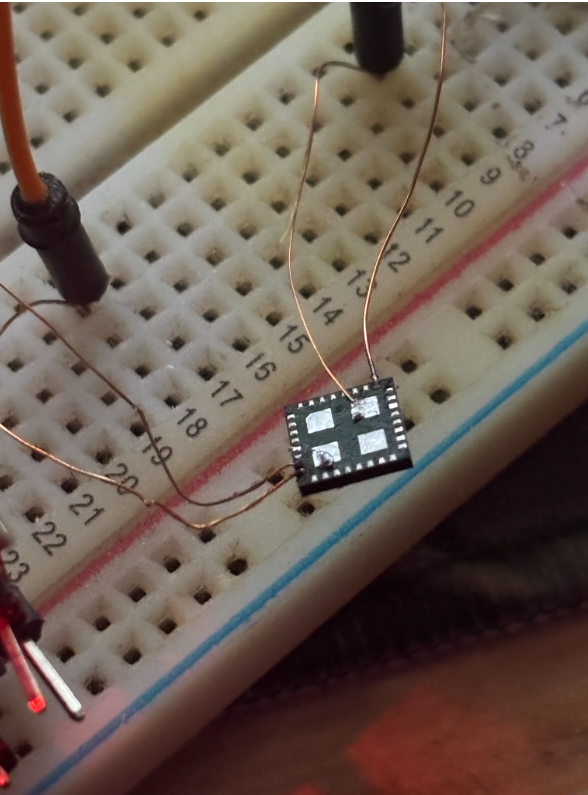

    it looks like I might have encountered a new variant of the T34 module?
    It is sort of an QFN package, similar to the other guide here I have seen. So I unsoldered it and flashed. Or rather tried to, as I am getting below error. Any quick ideas? I can send a pic of the PCB later. The marking of the IC is T34 and X50B3C.
    Breadboard with a small integrated circuit and thin wires inserted into the holes.
    Preparing to write data file to chip - resetting bus and baud...
    Getting bus success!
    Going to set baud rate setting (460800)!
    Flash MID loaded: 15701C
    Flash def found! For: 15701C
    Flash information: mid: 15701C, icName: EN25QH16B, manufacturer: ESMT, szMem: 200000, szSR: 1, cwUnp: 0, cwEnp: 7, cwMsk: 3C, sb: 2, lb: 4, cwdRd: 05-FF-FF-FF, cwdWr: 01-FF-FF-FF
    Flash size is 2MB
    sr: 40
    final sr: 40
    msk: 3c
    cw: 0, sb: 2, lb: 4
    bfd: 0
    Going to do erase, start 0x11000, sec count 281!
    Erasing sector 0x11000... ok! Erasing sector 0x12000... ok! Erasing sector 0x13000... ok! Erasing sector 0x14000... ok! Erasing sector 0x15000... ok! Erasing sector 0x16000... ok! Erasing sector 0x17000... ok! Erasing sector 0x18000... ok! Erasing sector 0x19000... ok! Erasing sector 0x1A000... ok! Erasing sector 0x1B000... ok! Erasing sector 0x1C000... ok! Erasing sector 0x1D000... ok! Erasing sector 0x1E000... ok! Erasing sector 0x1F000... ok! Erasing block 0x20000... ok! Erasing block 0x30000... ok! Erasing block 0x40000... ok! Erasing block 0x50000... ok! Erasing block 0x60000... ok! Erasing block 0x70000... ok! Erasing block 0x80000... ok! Erasing block 0x90000... ok! Erasing block 0xA0000... ok! Erasing block 0xB0000... ok! Erasing block 0xC0000... ok! Erasing block 0xD0000... ok! Erasing block 0xE0000... ok! Erasing block 0xF0000... ok! Erasing block 0x100000... ok! Erasing block 0x110000... ok! Erasing sector 0x120000... ok! Erasing sector 0x121000... ok! Erasing sector 0x122000... ok! Erasing sector 0x123000... ok! Erasing sector 0x124000... ok! Erasing sector 0x125000... ok! Erasing sector 0x126000... ok! Erasing sector 0x127000... ok! Erasing sector 0x128000... ok! Erasing sector 0x129000... ok!
    All selected sectors erased!
    Writing sector 0x11000... ok! Writing sector 0x12000... ok! Writing sector 0x13000... ok! Writing sector 0x14000... ok! Writing sector 0x15000... ok! Writing sector 0x16000... ok! Writing sector 0x17000... ok! Writing sector 0x18000... ok! Writing sector 0x19000... ok! Writing sector 0x1A000... ok! Writing sector 0x1B000... ok! Writing sector 0x1C000... ok! Writing sector 0x1D000... ok! Writing sector 0x1E000... ok! Writing sector 0x1F000... ok! Writing sector 0x20000... ok! Writing sector 0x21000... ok! Writing sector 0x22000... ok! Writing sector 0x23000... ok! Writing sector 0x24000... ok! Writing sector 0x25000... ok! Writing sector 0x26000... ok! Writing sector 0x27000... ok! Writing sector 0x28000... ok! Writing sector 0x29000... ok! Writing sector 0x2A000... ok! Writing sector 0x2B000... ok! Writing sector 0x2C000... ok! Writing sector 0x2D000... ok! Writing sector 0x2E000... ok! Writing sector 0x2F000... ok! Writing sector 0x30000... ok! Writing sector 0x31000... ok! Writing sector 0x32000... ok! Writing sector 0x33000... ok! Writing sector 0x34000... ok! Writing sector 0x35000... ok! Writing sector 0x36000... ok! Writing sector 0x37000... ok! Writing sector 0x38000... ok! Writing sector 0x39000... ok! Writing sector 0x3A000... ok! Writing sector 0x3B000... ok! Writing sector 0x3C000... ok! Writing sector 0x3D000... ok! Writing sector 0x3E000... ok! Writing sector 0x3F000... ok! Writing sector 0x40000... ok! Writing sector 0x41000... ok! Writing sector 0x42000... ok! Writing sector 0x43000... ok! Writing sector 0x44000... ok! Writing sector 0x45000... ok! Writing sector 0x46000... ok! Writing sector 0x47000... ok! Writing sector 0x48000... ok! Writing sector 0x49000... ok! Writing sector 0x4A000... ok! Writing sector 0x4B000... ok! Writing sector 0x4C000... ok! Writing sector 0x4D000... ok! Writing sector 0x4E000... ok! Writing sector 0x4F000... ok! Writing sector 0x50000... ok! Writing sector 0x51000... ok! Writing sector 0x52000... ok! Writing sector 0x53000... ok! Writing sector 0x54000... ok! Writing sector 0x55000... ok! Writing sector 0x56000... ok! Writing sector 0x57000... ok! Writing sector 0x58000... ok! Writing sector 0x59000... ok! Writing sector 0x5A000... ok! Writing sector 0x5B000... ok! Writing sector 0x5C000... ok! Writing sector 0x5D000... ok! Writing sector 0x5E000... ok! Writing sector 0x5F000... ok! Writing sector 0x60000... ok! Writing sector 0x61000... ok! Writing sector 0x62000... ok! Writing sector 0x63000... ok! Writing sector 0x64000... ok! Writing sector 0x65000... ok! Writing sector 0x66000... ok! Writing sector 0x67000... ok! Writing sector 0x68000... ok! Writing sector 0x69000... ok! Writing sector 0x6A000... ok! Writing sector 0x6B000... ok! Writing sector 0x6C000... ok! Writing sector 0x6D000... ok! Writing sector 0x6E000... ok! Writing sector 0x6F000... ok! Writing sector 0x70000... ok! Writing sector 0x71000... ok! Writing sector 0x72000... ok! Writing sector 0x73000... ok! Writing sector 0x74000... ok! Writing sector 0x75000... ok! Writing sector 0x76000... ok! Writing sector 0x77000... ok! Writing sector 0x78000... ok! Writing sector 0x79000... ok! Writing sector 0x7A000... ok! Writing sector 0x7B000... ok! Writing sector 0x7C000... ok! Writing sector 0x7D000... ok! Writing sector 0x7E000... ok! Writing sector 0x7F000... ok! Writing sector 0x80000... ok! Writing sector 0x81000... ok! Writing sector 0x82000... ok! Writing sector 0x83000... ok! Writing sector 0x84000... ok! Writing sector 0x85000... ok! Writing sector 0x86000... ok! Writing sector 0x87000... ok! Writing sector 0x88000... ok! Writing sector 0x89000... ok! Writing sector 0x8A000... ok! Writing sector 0x8B000... ok! Writing sector 0x8C000... ok! Writing sector 0x8D000... ok! Writing sector 0x8E000... ok! Writing sector 0x8F000... ok! Writing sector 0x90000... ok! Writing sector 0x91000... ok! Writing sector 0x92000... ok! Writing sector 0x93000... ok! Writing sector 0x94000... ok! Writing sector 0x95000... ok! Writing sector 0x96000... ok! Writing sector 0x97000... ok! Writing sector 0x98000... ok! Writing sector 0x99000... ok! Writing sector 0x9A000... ok! Writing sector 0x9B000... ok! Writing sector 0x9C000... ok! Writing sector 0x9D000... ok! Writing sector 0x9E000... ok! Writing sector 0x9F000... ok! Writing sector 0xA0000... ok! Writing sector 0xA1000... ok! Writing sector 0xA2000... ok! Writing sector 0xA3000... ok! Writing sector 0xA4000... ok! Writing sector 0xA5000... ok! Writing sector 0xA6000... ok! Writing sector 0xA7000... ok! Writing sector 0xA8000... ok! Writing sector 0xA9000... ok! Writing sector 0xAA000... ok! Writing sector 0xAB000... ok! Writing sector 0xAC000... ok! Writing sector 0xAD000... ok! Writing sector 0xAE000... ok! Writing sector 0xAF000... ok! Writing sector 0xB0000... ok! Writing sector 0xB1000... ok! Writing sector 0xB2000... ok! Writing sector 0xB3000... ok! Writing sector 0xB4000... ok! Writing sector 0xB5000... ok! Writing sector 0xB6000... ok! Writing sector 0xB7000... ok! Writing sector 0xB8000... ok! Writing sector 0xB9000... ok! Writing sector 0xBA000... ok! Writing sector 0xBB000... ok! Writing sector 0xBC000... ok! Writing sector 0xBD000... ok! Writing sector 0xBE000... ok! Writing sector 0xBF000... ok! Writing sector 0xC0000... ok! Writing sector 0xC1000... ok! Writing sector 0xC2000... ok! Writing sector 0xC3000... ok! Writing sector 0xC4000... ok! Writing sector 0xC5000... ok! Writing sector 0xC6000... ok! Writing sector 0xC7000... ok! Writing sector 0xC8000... ok! Writing sector 0xC9000... ok! Writing sector 0xCA000... ok! Writing sector 0xCB000... ok! Writing sector 0xCC000... ok! Writing sector 0xCD000... ok! Writing sector 0xCE000... ok! Writing sector 0xCF000... ok! Writing sector 0xD0000... ok! Writing sector 0xD1000... ok! Writing sector 0xD2000... ok! Writing sector 0xD3000... ok! Writing sector 0xD4000... ok! Writing sector 0xD5000... ok! Writing sector 0xD6000... ok! Writing sector 0xD7000... ok! Writing sector 0xD8000... ok! Writing sector 0xD9000... ok! Writing sector 0xDA000... ok! Writing sector 0xDB000... ok! Writing sector 0xDC000... ok! Writing sector 0xDD000... ok! Writing sector 0xDE000... ok! Writing sector 0xDF000... ok! Writing sector 0xE0000... ok! Writing sector 0xE1000... ok! Writing sector 0xE2000... ok! Writing sector 0xE3000... ok! Writing sector 0xE4000... ok! Writing sector 0xE5000... ok! Writing sector 0xE6000... ok! Writing sector 0xE7000... ok! Writing sector 0xE8000... ok! Writing sector 0xE9000... ok! Writing sector 0xEA000... ok! failed with serial.BytesToRead 0 (expected 15)
    The beginning of buffer in UART contains  data.
    Writing sector 0xEB000... Writing sector 0xEB000 failed!
    Writing file data to chip failed.

    How do you power it? What do you mean by "directly"? 3.3V from serial adapter may not be reliable, I am usually using external 3.3V LDO like AMS1117-3.3V. Have you tested various baud rates? How long are the cables?
    For me, it looks like flashing interference on classic T34. Reliable connection is necessary to get the flashing right.
    Can you show a photo of full setup?
  • Wiggling and resoldering fixed the flashing failure
    #3 21834398
    kolbethomas

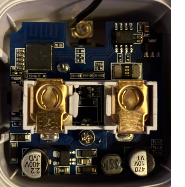

    Thanks for the quick response. As flashing was always failing at the same step, I had ruled out an issue with the power. But after your comment, I wiggled my wiring :) and things worked! Also resoldered it back, and the thing is online now.
    It is a pain to solder, and I have not found that the TX/RX pins are connected to anything, also not to the BL chip like in the below thread (where I also used the working template from).
    https://www.elektroda.com/rtvforum/topic4099021.html
    Actually I saw in this thread now around post #10 someone already had the same PCB. And also that they decided to Dremel into the IC to expose the pads - wow!
    Anyway - issue solved for now. Too bad we can not identify what PCB is inside when we order ...
