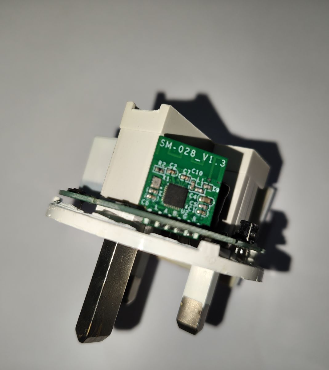

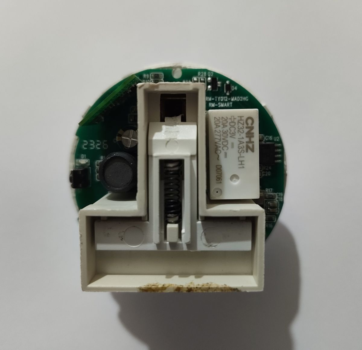

    Model Name: RMC003
    Original Firmware: CK-BL602-SWP1-01
    Wireless Module: SM-028_V1.3
    Chip Name: BL602L20
    Power Monitoring IC: BL0937

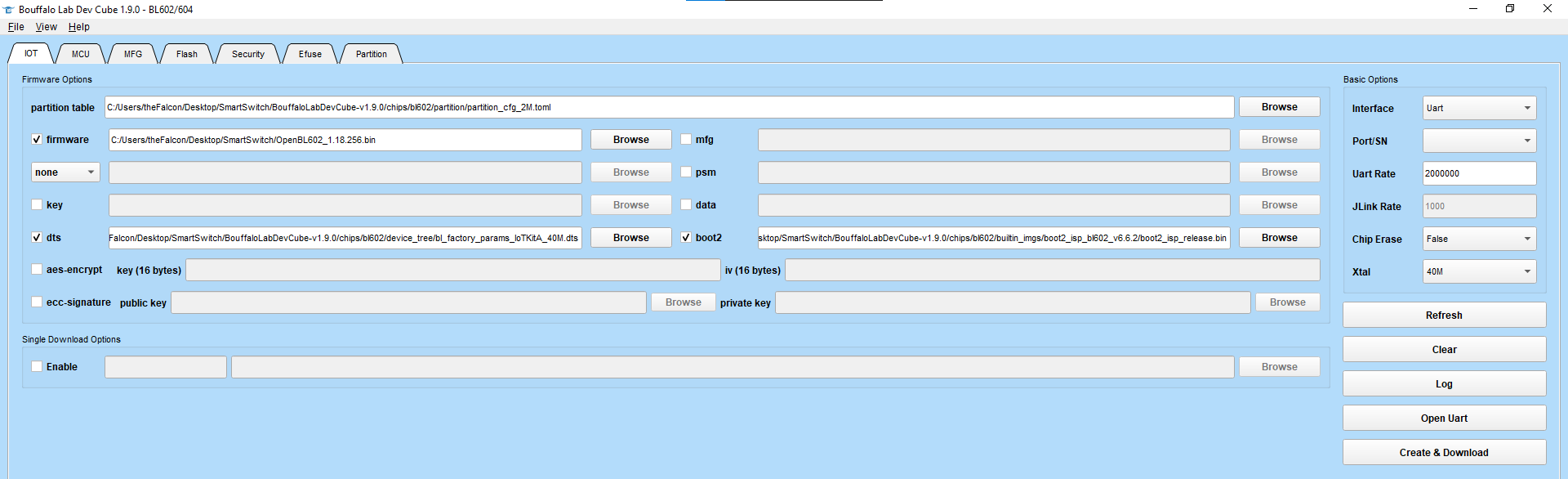

    Software Used: BouffaloLabDevCube-v1.9.0
    Open Belken Version: OpenBL602_1.18.256.bin
    Partition Table file: partition_cfg_2M.toml
    dts: bl_factory_params_IoTKitA_40M.dts
    boot2: boot2_isp_release.bin
    UART Rate: 2000000
