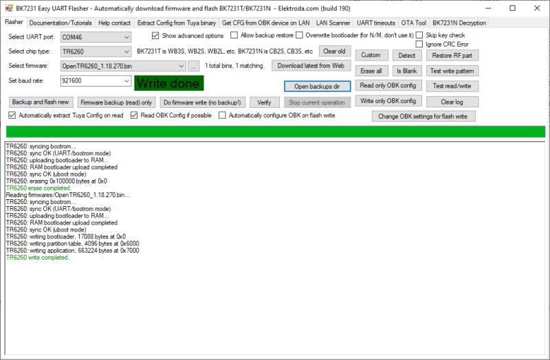

    got a working TR6260 waiting in the wings too
    Screenshot of BK7231 Easy UART Flasher showing “Write done” and a TR6260 flashing log

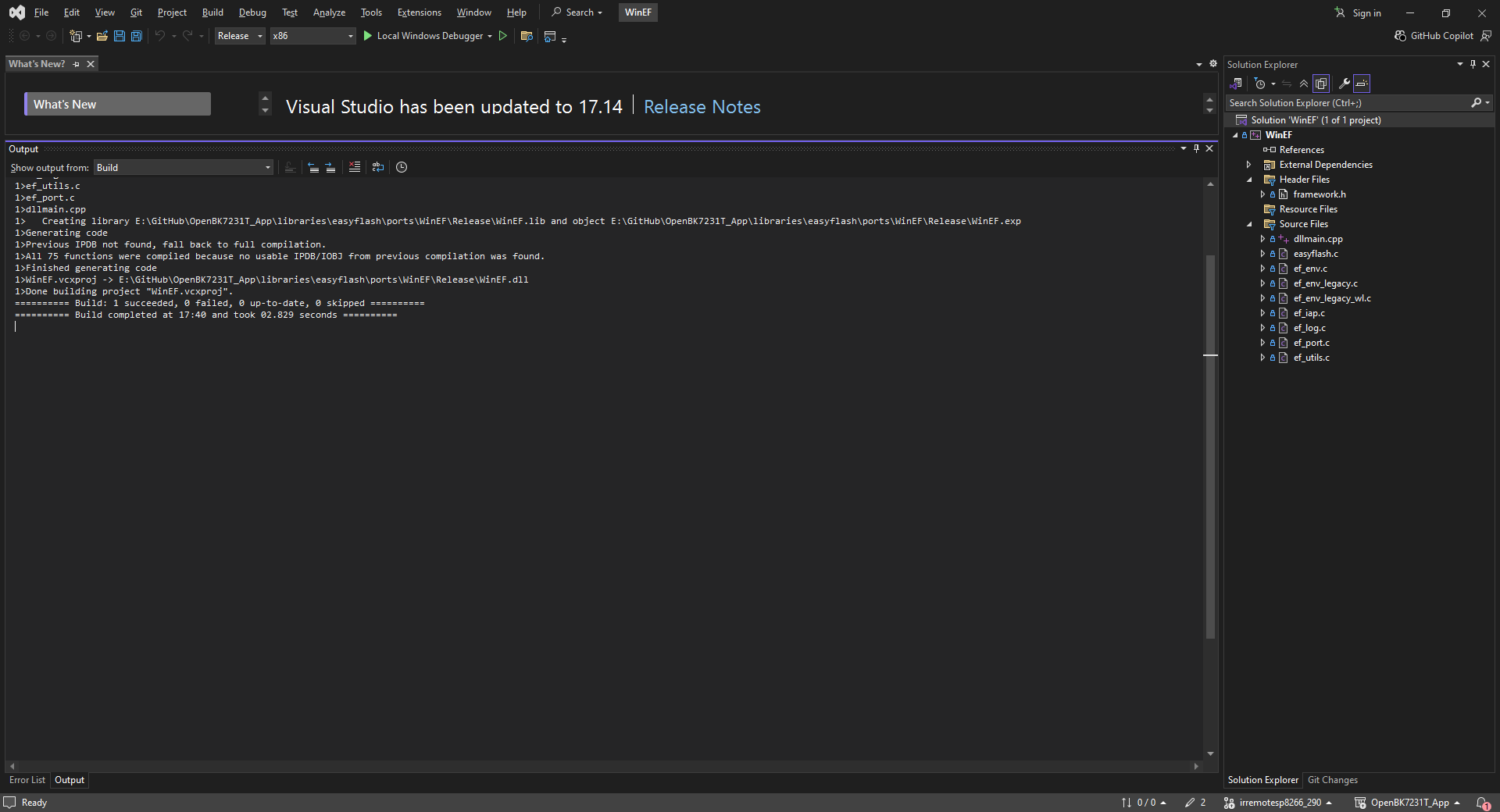

    I believe Easyflash for TR6260 requires GRAN=32 so have built WinEF_GRAN32_x64.dll and WinEF_GRAN32_x86.dll - that correct @insmod ?
    Screenshot of Visual Studio showing Output window after a successful build of WinEF project

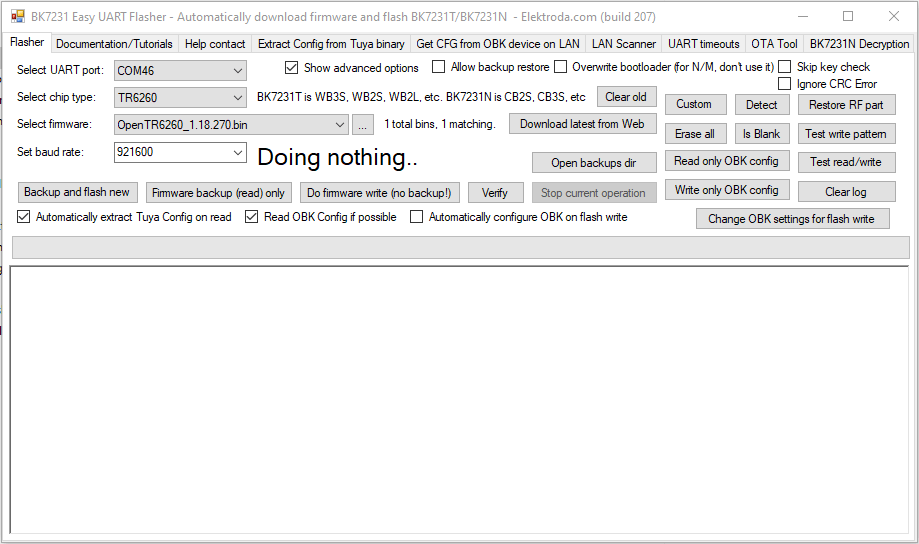

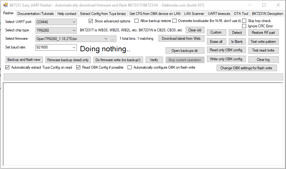

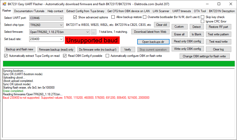

  • TR6260 flasher adds erase, backup and OBK config support
    #282 21858002
    Posts: 5246
    Help: 451
    Rate: 921
    could have a go. I think TR6260 for classic tool is almost good too, so will finish that today I think
    Added after 6 [hours] 24 [minutes]:
    TR6260 is done I believe.
    -read/erase assumes flash is 1mb
    -erase whole flash support. erases before write operations
    -read/write backups and OpenTR6260 release (including bootloader and partition file)
    -supports OBK config read/write - GRAN32 implemented without EF dlls
    animated
    Screenshot of BK7231 Easy UART Flasher with TR6260 and COM46 selected, status “Doing nothing..”
    Screenshot of BK7231 Easy UART Flasher set to COM46 and TR6260; status reads “Doing nothing..”
    bauds not seen in utpmain are blocked
    Screenshot of BK7231 Easy UART Flasher showing “Unsupported baud” at 230400
    https://github.com/openshwprojects/BK7231GUIFlashTool/pull/112

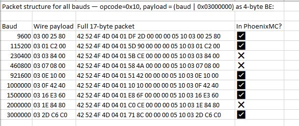

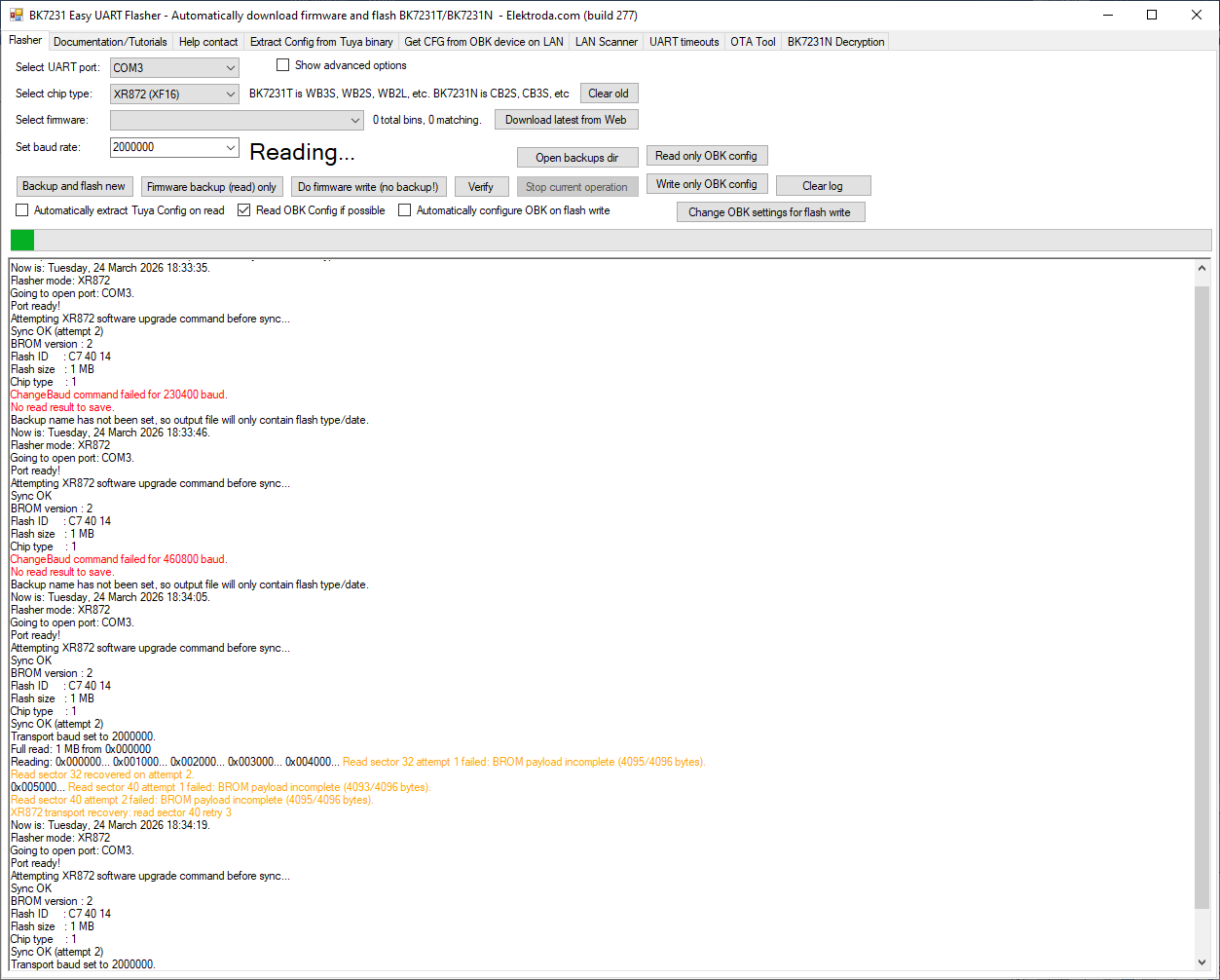

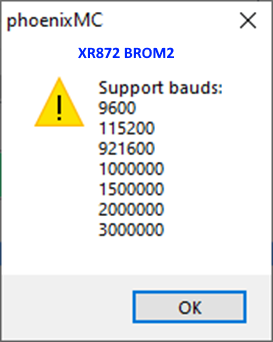

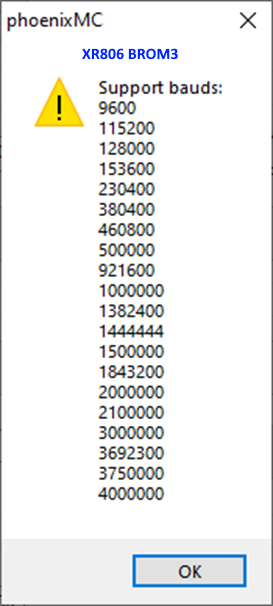

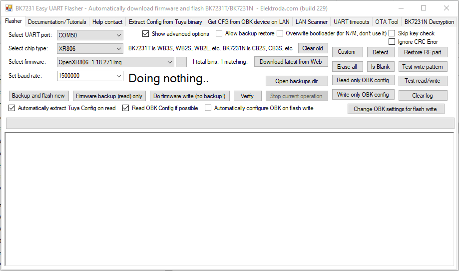

  • XR806 supported baud rates and read speed test
    #285 21864040
    Posts: 5246
    Help: 451
    Rate: 921

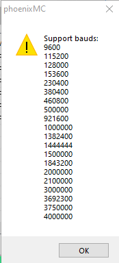

    What are the speeds?
    the supported XR806 speeds? I think in total it's 110, 300, 600, 1200, 2400, 4800, 9600, 19200, 38400, 57600, 115200, 230400, 460800, 921600
    fixed merged conflict and a couple of other bits. I think it's good to go. Revisions, fixes, PRs to anything 'I' create always welcome.

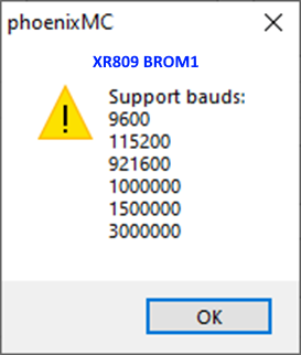

    divadiow wrote:
    the supported XR806 speeds? 115200, 230400, 460800, 921600
    this is despite the bauds available in PhoenixMC. BROM <= 1 (XR809) has a stub
    Added after 12 [minutes]:
    that's the analysis from the Linux PhoenixMC anyway. Maybe it can do higher. Windows GUI shows higher
    Dropdown menu with numeric options, highlighting “921600”
    Added after 1 [hours] 38 [minutes]:
    XR806 can be faster/better and I am looking at what next, but current PR works.
    Added after 10 [hours] 1 [minutes]:

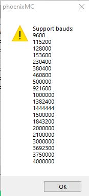

    PhoenixMC.exe response.
    PhoenixMC dialog showing “Support bauds” list of baud rates and an OK button
    but timings, sector size, chunks etc don't change so not much to be gained.
    got latest EF XR806 2mb whole-flash read speed to ~47s @921600

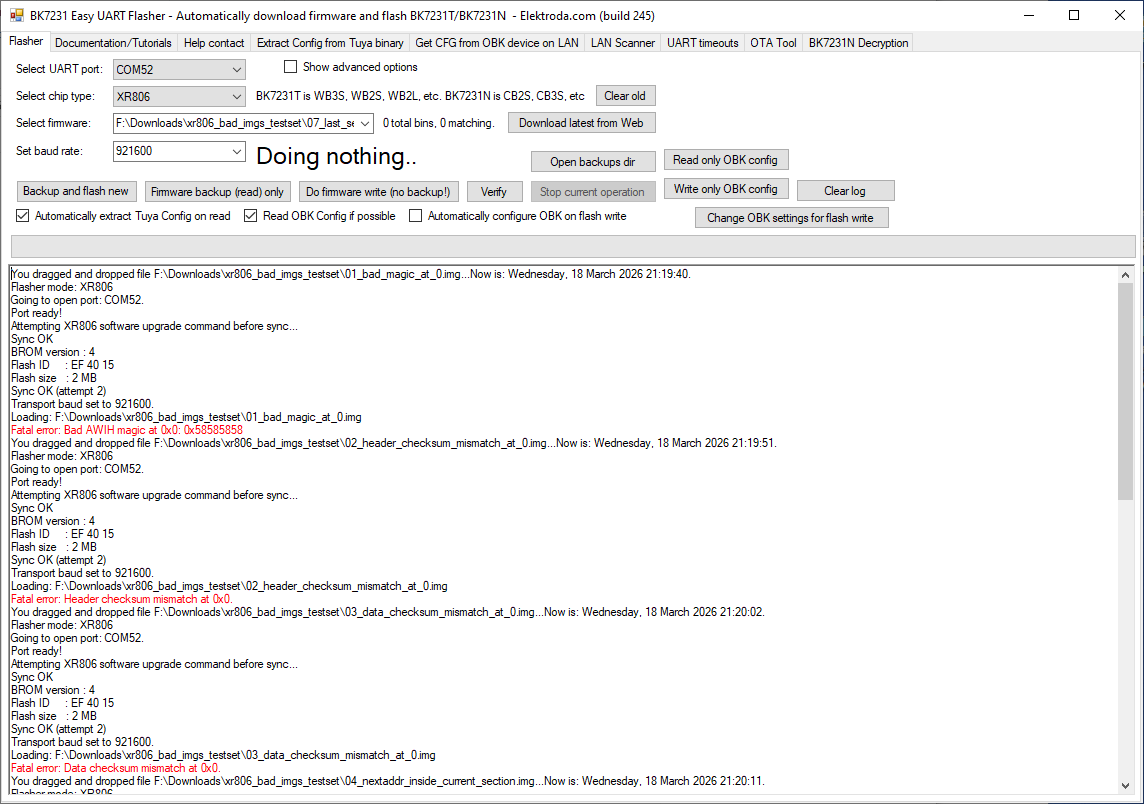

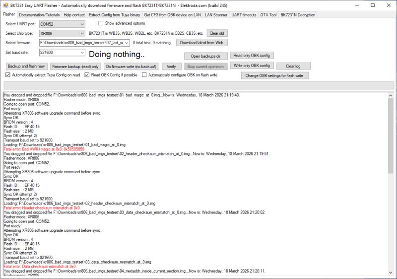

  • XR806 Pt2 adds safer flash read/write support
    #286 21865624
    Posts: 5246
    Help: 451
    Rate: 921
    XR806 Pt2 is better.
    - Support 'upgrade' command for firmware with Console code enabled (seen in OpenXR872)
    - Reads BROM version (no longer complains about non-BROM 3 detection - WXU is BROM 4 and devboard is BROM 3)
    - Reads flash ID
    - Logs flash size
    - Full flash read (2mb 41s @921600, 37s @3000000)
    - Custom-offset read
    - Chunked read transfer with retry / recovery handling
    - Full-chip erase
    - Explicitly full-chip-only behaviour for XR806
    - Main firmware write from .img file
    - Main full-flash restore from raw .bin file
    - Custom-offset raw write from .bin file
    - Backup-then-flash workflow
    - Chunked write transfer with retry / recovery handling
    .img on main write path:
    - Parsed as XR image layout
    - Validated before programming
    - Written from base flash offset 0x000000
    .bin on main write path:
    - Treated as raw flash data
    - Not truncated to image partition/layout size
    .bin on custom write path:
    - Treated as raw bytes only
    - Written to the user-selected offset
    - No image-layout parsing
    XR image validation:
    - AWIH header validation
    - Header checksum validation
    - Section data checksum validation
    - Section-chain walking
    - Effective image size calculation
    - Image layout logging
    XR image safety checks:
    - Rejects invalid AWIH magic
    - Rejects bad header checksum
    - Rejects bad data checksum
    - Rejects next-section pointers that fall inside the current section
    - Rejects next-section pointers outside file range
    - Rejects non-header targets in the section chain
    - Rejects section data that overruns the file
    - Rejects overlapping, looping, or non-advancing section chains
    Safety and resilience:
    - Initial sync retries before failure
    - Session recovery and reconnect logic on read/write failures
    - Flash-range bounds checking before write
    - BROM response payload sanity checking
    - Progress and policy logging for key operations
    operational behaviour:

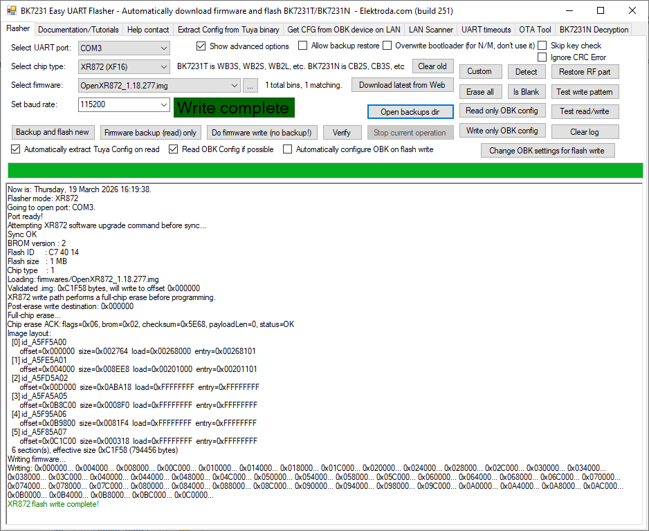

    - Main write path performs full-chip erase before programming
    - Custom raw write path does not erase first
    - Backup-and-flash in one session
    - Firmware is not run/device not rebooted after flash write
    Screenshot of BK7231 Easy UART Flasher showing checksum error logs and the status “Doing nothing..”
    https://github.com/openshwprojects/BK7231GUIFlashTool/pull/114

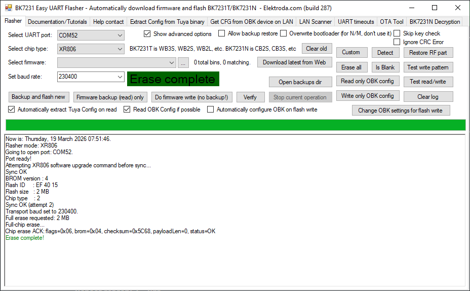

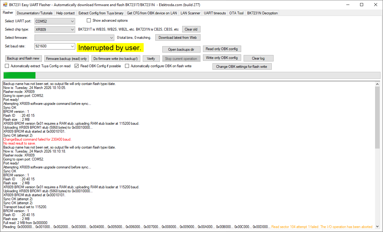

    Added after 5 [minutes]:
    appears to work fine for XR872 too, because it's BROM2+, so XR872 should be easy adaptation next

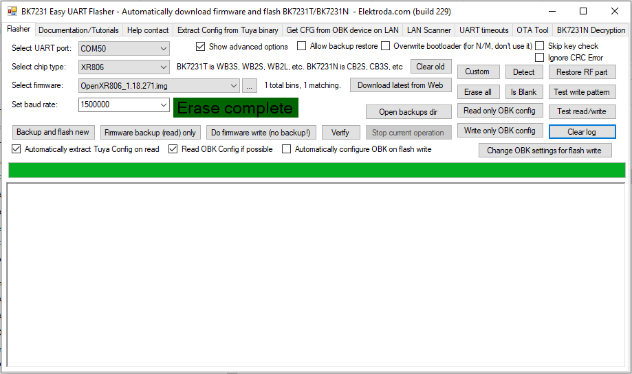

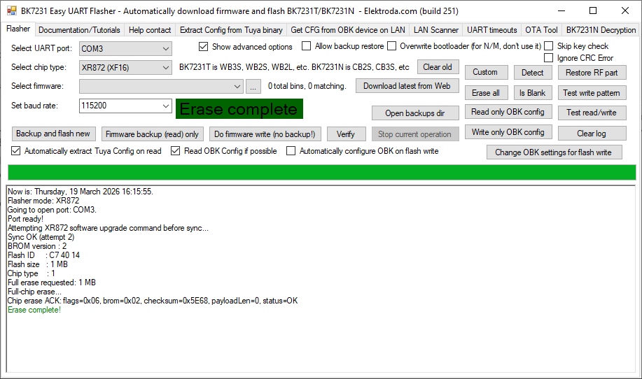

    Added after 8 [hours] 52 [minutes]:
    a couple of tweaks. flush after erase, added chip type response.
    example with erase operation:
    Screenshot of BK7231 Easy UART Flasher showing “Erase complete” and an XR806 log on COM52

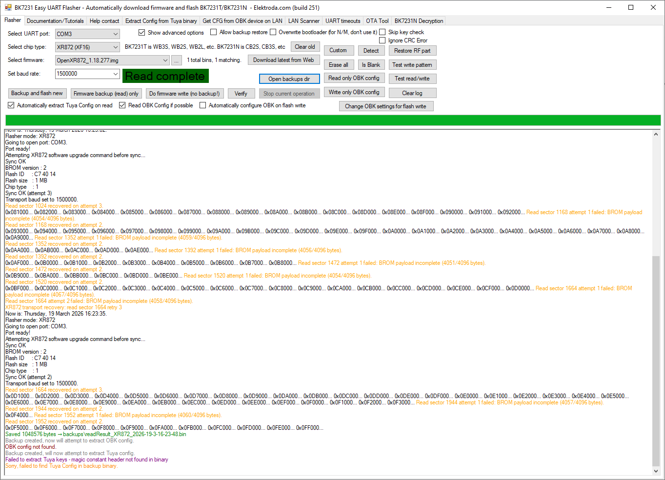

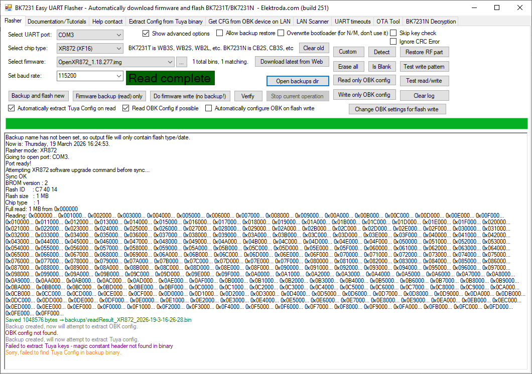

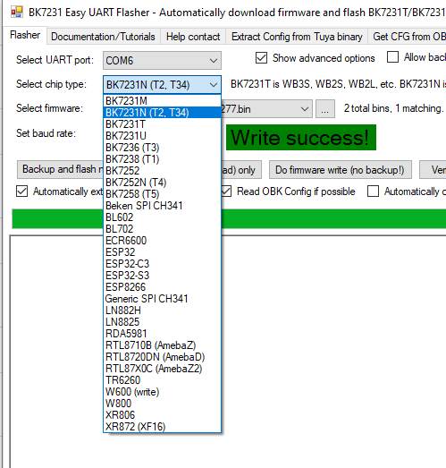

    Added after 8 [hours] 46 [minutes]:
    -add XR872, same abilities as XR806
    -sort chip list alphabetically
    -make log box auto-scroll instead of only catching-up on newline
    -update readme
    -set BK7231N as default chip (was BK7231T, alphabet sort made index 0 default to BK7231M)
    -set 115200 as default baud (was 230400)
    erase
    Screenshot of BK7231 Easy UART Flasher showing “Erase complete” for XR872 on COM3
    flash OpenXR872 (to 1mb XF16)
    Screenshot of BK7231 Easy UART Flasher showing “Write complete” and a flashing operation log.
    read at 1.5m baud (resync/retries are expected - PhoenixMC drops to 115200 for this XF16)
    Screenshot of BK7231 Easy UART Flasher showing XR872 flash read log and “Read complete”
    read at 115200
    Screenshot of BK7231 Easy UART Flasher showing “Read complete” and a flash read log for XR872.
    EF/PhoenixMC dumps are identical

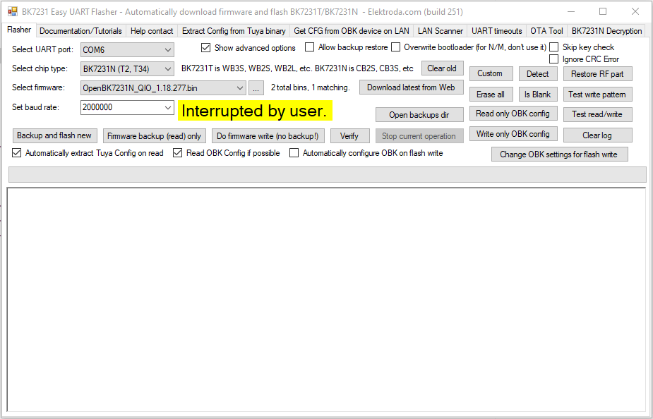

    auto-scroll behaviour (animated):
    Screenshot of BK7231 Easy UART Flasher showing “Interrupted by user.”
    https://github.com/openshwprojects/BK7231GUIFlashTool/pull/115
    Added after 7 [minutes]:
    sorted chip list
    Screenshot of BK7231 Easy UART Flasher with chip-type dropdown open and “Write success!” message

    Almost perfect, however, I would think twice about changing enumeration order. Are we really sure it's not saved anywhere as index? But maybe not...
  • Display order uses BKType, not numeric index
    #288 21867012
    Posts: 5246
    Help: 451
    Rate: 921
    ah, I did check. it's purely display order. nothing seems to index them numerically. References are to BKType rather than a positional index.

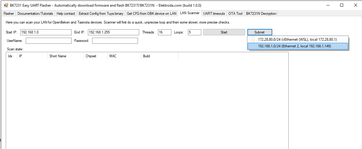

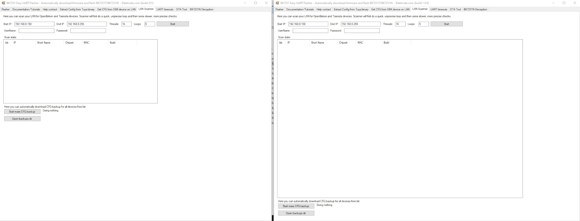

    @p.kaczmarek2 also make scan status box resize proportional to main window (@dedamraz request) + add subnet picker from local machine network interfaces
    https://github.com/openshwprojects/BK7231GUIFlashTool/pull/116
    Two BK7231 Easy UART Flasher windows with empty LAN scan list and Start IP/End IP fields
    Screenshot of BK7231 Easy UART Flasher showing subnet dropdown, IP range fields, and Start button

    yay, thanks for merging!
    Are XR flashing protocols much different?
    mostly the same. but with BROM < 2 (eg XR809) although it supports the same basic BROM-direct commands like
    GetFlashID 0x18
    , it requires stub loader for erase/write/read operations.
    BROM >= 3 (BROM 4 seen on real WXU and BROM 3 seen on AllWinner XR806 dev board) support an alternate set of opcodes, I have not used these. Legacy family used for all our XRs. Not sure of the purpose/advantage of the newer family.
    legacy:
    GetFlashID 0x18
    ReadSector 0x1A
    EraseFlash 0x19
    WriteSector 0x1B
    alternate:
    GetFlashID 0x1C
    ReadSector 0x1E
    EraseFlash 0x1D
    WriteSector 0x1F
    Not entirely sure when and why alternate family gets used.

    Added after 6 [hours] 50 [minutes]:
    insmod wrote:
    XR809 can erase by blocks. Do others support it too?
    there isn't custom erase function in EF so didn't look to implement. earlier XR806 builds erased whole chip in 64k sectors
    Added after 11 [hours] 34 [minutes]:
    I recall now. the restrictions in XR806 won't get hit anyway because the supported list includes all the EF baud options.
    XR809 fails the baud change command for 230400, 460800 and 2m
    Screenshot of BK7231 Easy UART Flasher showing “Interrupted by user” and a baud rate error log
    XR872 fails the baud change for 230400, 460800 but does have a go at 2m
    Screenshot of BK7231 Easy UART Flasher showing read log and baud rate change errors
    re XR809 the command sent for those unsupported bauds is sound.
    Table of baud-rate packets with hex payloads and PhoenixMC support marks
    PhoenixMC response for each:
    phoenixMC dialog “XR806 BROM3” showing supported baud rates list and an OK button. phoenixMC dialog “XR872 BROM2” listing supported baud rates, with an OK button phoenixMC warning dialog: “XR809 BROM1” with a list of supported baud rates
    restrictions removed test build: https://github.com/divadiow/BK7231GUIFlashTool/actions/runs/23495167292
  • #298 21876109
    Posts: 14813
    Rate: 12984
    Are there any regressions? Dumps that used to be decoded correctly but now fail?
  • Classic JSON now matches previous dumps exactly
