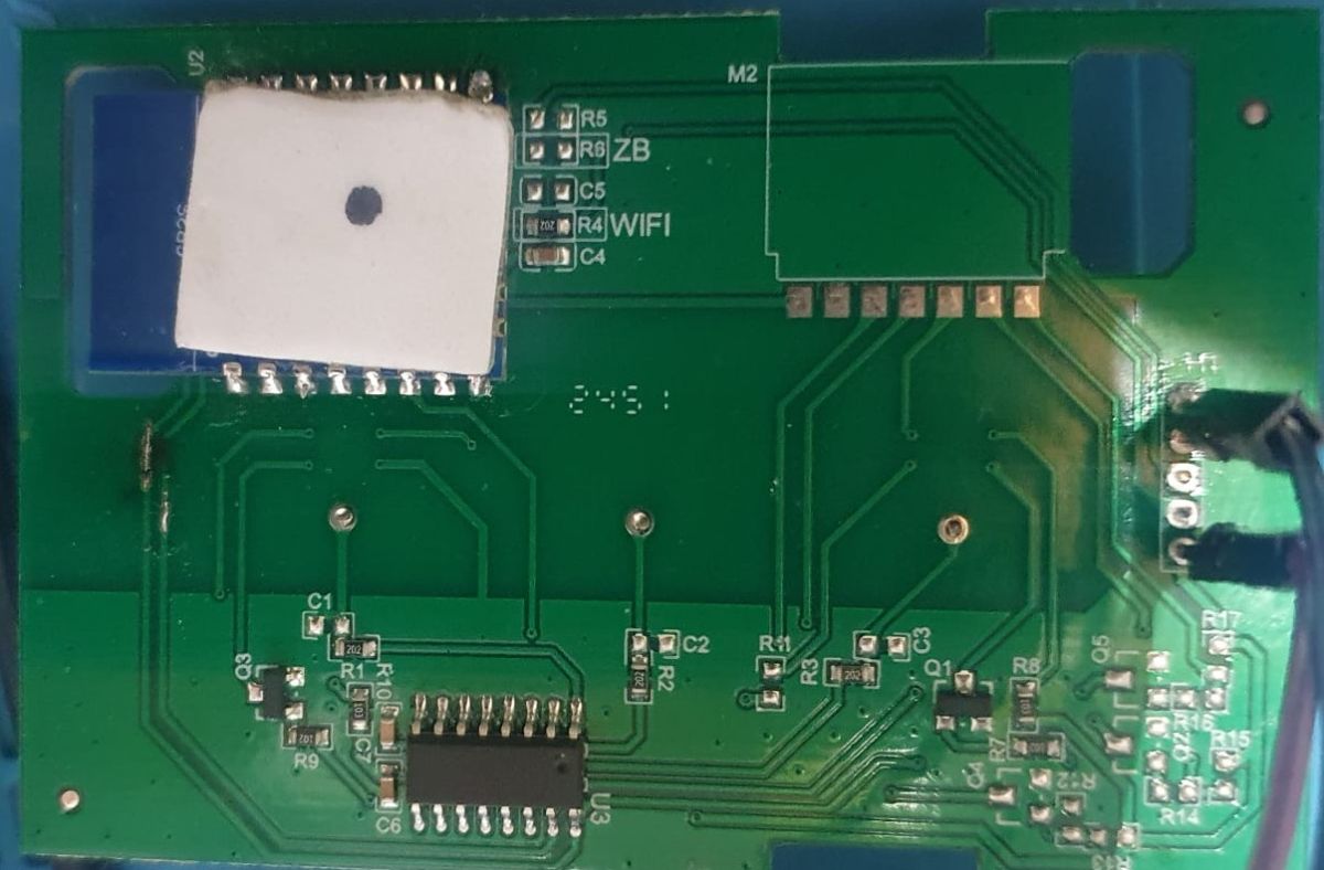

    I have two WIFI modules for curtain, the modules come with TUYAMCU and CB3S BK chip.
    One of the modules does not work at all (it arrived defective) and I managed to burn it in the second one.
    I can't get the TUYA driver to work. No matter what I tried, I don't get a HEARTBEAT in log.

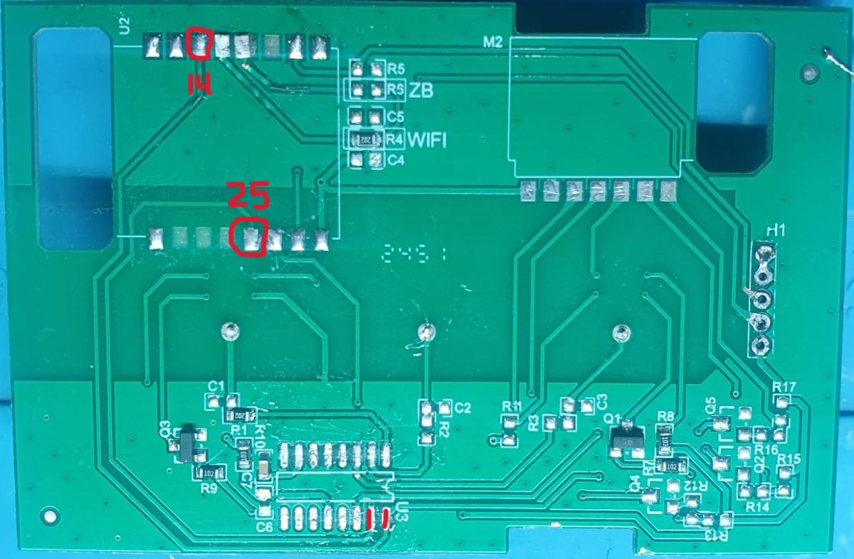

    I disassembled the defective module to understand where all the GPIOS go and I see that RX and TX in the BK chip are not connected to anything, while PAD 14 and PAD25 go to TUYAMCU.
    And in CONFIG I didn't find anywhere how to configure the RX and TX of the TUYAMCU.
    I suspect that I don't have any communication with the TUYA chip because of this.
    I would appreciate help on how to use this module.

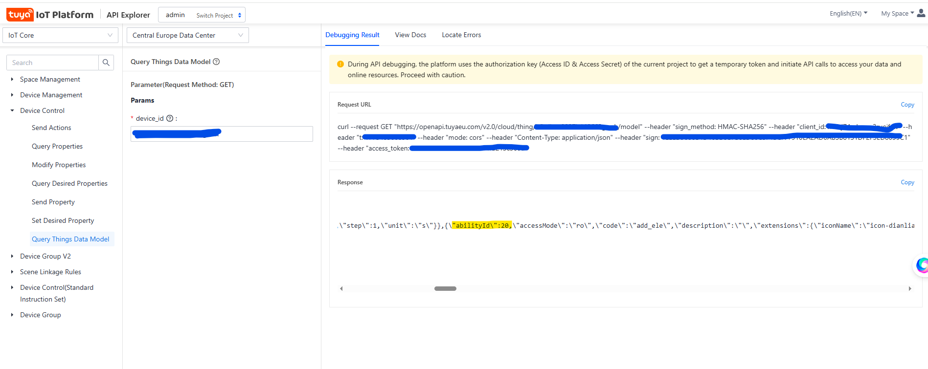

    By the way, before I burned I backed up the firmware and connected the module to the TUYA app at first, where I saw that the module was indeed working. I also managed to export the DP IDS from the TUYA cloud.

    the tuya config I add it to post. It looks like is not connect to the correct mcu

    are you sure it's TuyaMCU? Is it a touch-button device? It could just be some touch chip.
    No traces anywhere from RX1/TX1 ?

    But in Tuya cloud I extract the IDs and you can see that it is Tuya IDs, otherwise how can you explain that?

    >>21878494 No trace at all, only from other GPIOs

    We need more information. What is U3? How are buttons connected? How are relays connected? Would toggling P14 and P25 in GPIO Doctor toggle relays?

    >>21878510 But I see ID with enum (open, close, stop) also timer and motor direction with values that define by tuyamcu.
    >>21878513 there nothing wrote on U3. I have 2 relays and the 3 touch button connect to the U3. that so strange, if I set the 14 and 25 as relay they work

    As @divadiow said, enums are also created for non-tuyamcu devices.
    Wait... they work? You mean toggling P14 / P25 toggles relays

    >>21878522 yes... that so strange. maybe you are right and the u3 isn't tuya mcu.
    so how can i config the stop (middle) button to stop? if i have 2 relays.
    let me try to set it and check and update you

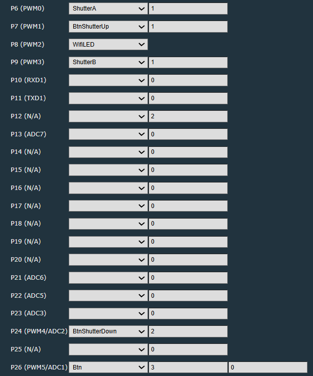

    First, I set all the recognized GPIO as relay and btn and it works. It’s not a TuyaMCU... Sorry, my mistake..
    About the shutter driver, I would like to get a link to learn about that.

    We don't have a tutorial yet, but you basically set Shutter* pin roles, set single channel, do "startDriver shutters" in console or autoexec.bat, and calibrate on main UI.

    OK, here is my gpio config
    Screenshot of P6–P26 pin configuration with dropdowns and numeric values, including ShutterA and WiFiLED
    Now I try to make that the BTN3 (STOP SHUTTER) will stop the shutter.
    Can you help me with that?
  • #18 21878824
    Posts: 14770
    Rate: 12913
    You can use command:
    ShutterMove 1 stop
    Change btn to Btn_ScriptOnly and then in autoexec.bat add click handler to run it on click.
