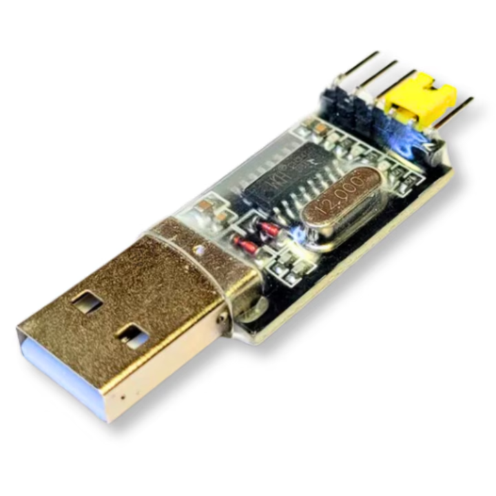

    I will have an adapter to plug it into laptop USB (Convertor USB CH340G RS232 TTL UART 3.3/5V, Programator pentru Citire TX/RX, Cip CH340G, Pini RX, TX, 3.3V, 5V, GND)
    Photo? Probably 3.3V from CH340G can't supply enough current, you may need extra LDO.

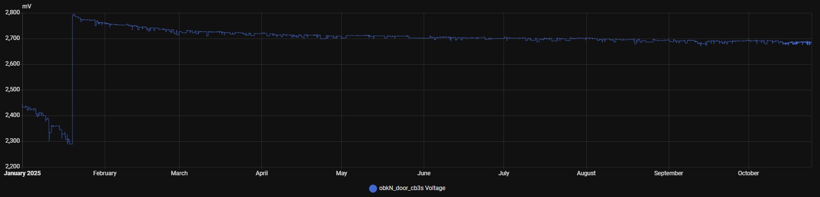

    Remember to make and keep backups for battery-powered devices.
    If you use common alkaline batteries or nickel batteries, and if they are almost fully discharged - device can enter a loop, where it tries to enable wifi, and since batteries are almost discharged, voltage drops too low and device reboots. In some cases it can brick a device, and full backup restore is needed.
    I didn't observe this behaviour with lithium AAA batteries.
    My door sensor with ni-mh batteries is still good after almost a year (with flags for fast connect enabled). It triggers about 10-15 times a day.
    Spoiler:
    Door sensor battery voltage chart from January to October 2025

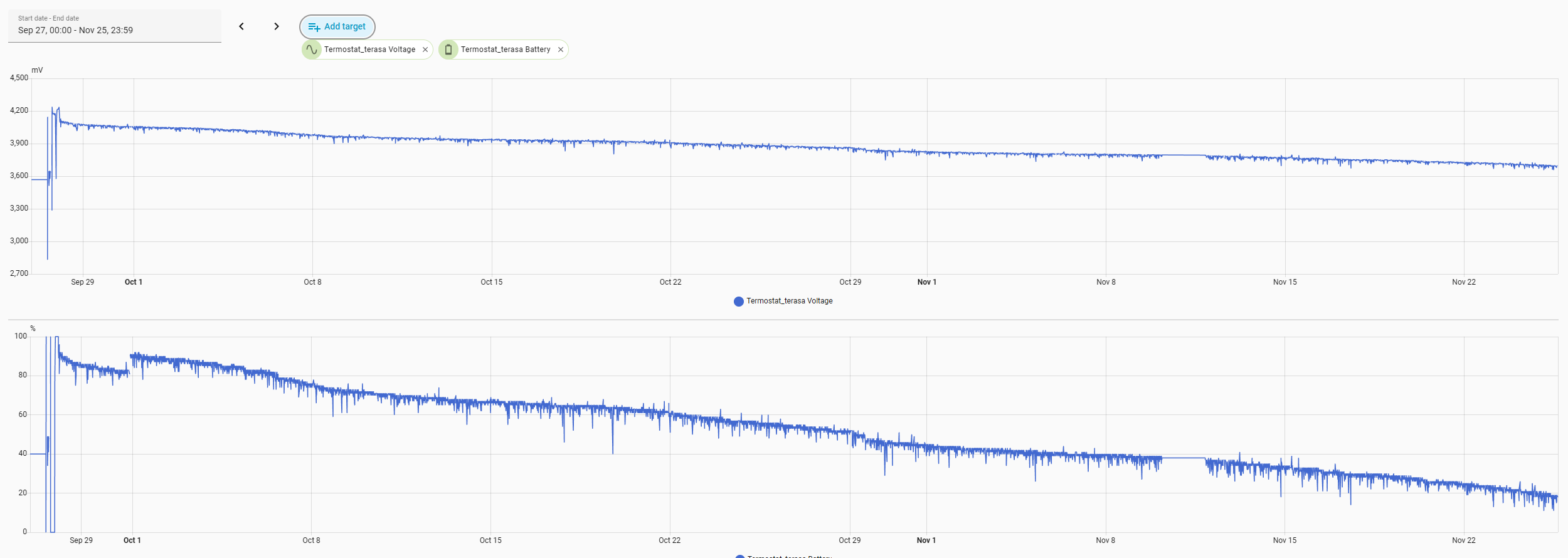

  • Long-term battery life on Wi-Fi temperature sensor
    #6 21762108
    DeDaMrAz
    Posts: 621
    Help: 34
    Rate: 130
    This graph may be useful as it represents a Wi-Fi converted temperature sensor that's been on the long term testing for quick connect feature. In my setup it reports data every 15 minutes and is powered by a single second-hand Li-Ion 18650 cell.
    Graphs showing thermostat battery voltage and percentage decline from September to November.
    Almost 2 months now on a single incomplete charge, outdoors and now even with close to freezing temperatures.
    EDIT: ignore the flatline part of the graph, that's me switching and changing my wifi setup.

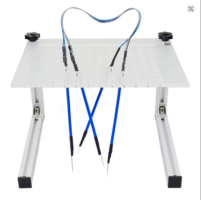

  • BK7231N curtain controller not entering UART flash mode
    #8 21765892
    eltigre4jc
    Posts: 8

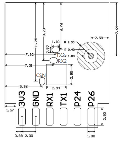

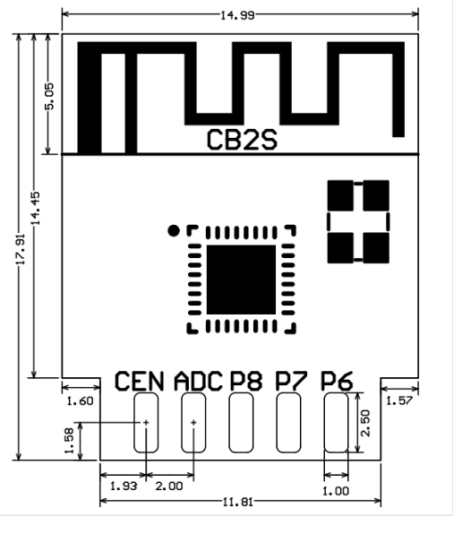

    So, I tried today to flash a curtain switch controller, but without success.
    The controller has BK7231N chip on a CB2S board.
    I tried using pogo pins linked to UART CH340, and an external power source to power with 3.3 V and 500 mA
    I tried power on/power off, but the bus was not recognized
    I tried pressing the pai button on the device; bus still not recognized
    I tried making a short between CEN and GND; bus still not recognized.
    And after some hours, and many tries, I gave up. Maybe the curtain controller is special as stated above.
    I will try with something else, maybe a plug or a battery-powered device.
    Thank you

    I tried with TX => RX2 and RX => TX1, and also TX => TX1 and RX => RX2.
    All kinds of combinations and also tried asking ChatGPT and Gemini.
  • #11 21765951
    DeDaMrAz
    Posts: 621
    Help: 34
    Rate: 130
    eltigre4jc wrote:
    All kind of combinations and also tried asking chatGPT and Gemini
    Bad idea 😉
    Schematic diagram of a module with 3V3, GND, RX1, TX1, P24, P26 pins and dimensions
    CB2S module diagram with labeled pins and dimensions in millimeters
    Connect CH340 RX to TX1 and CH340 TX to RX1, check ground and 3v3, measure they are present on the module and after connecting it all short CEN pin to GND or module shield.
  • #12 21765972
    eltigre4jc
    Posts: 8
    I tried the combination you said, but it did not work. Either my connections were weak or imperfect, or something else which I could not discover
    The power source showed that the module was consuming 6 mA. I had 2 LEDs lit up on the UART converter (power and data transfer), but still the bus could not be read.
    Maybe I will try again when I try to flash some other type of device.
    Thank you again.

    Or maybe you have this strange WiFi module version with badly labeled pads, can you show a photo?

How do I wire CB2S/BK7231N for UART flashing?
Cross the signals: CH340 RX to module TX1, CH340 TX to module RX1. Confirm GND and 3.3 V reach the module. After wiring, briefly short CEN to GND (or the module shield) to start the bootloader. Reseat weak pogo connections if the bus isn’t seen. [Elektroda, DeDaMrAz, post #21765951]
Why won’t my CH340G power the module reliably?
The CH340G’s 3.3 V rail often can’t supply enough current for Wi‑Fi startup. Use an external 3.3 V LDO and ensure nothing else occupies RX/TX lines during flashing. Only GND, 3.3 V, RX, and TX are required. [Elektroda, p.kaczmarek2, post #21730316]

  1. Cross‑wire CH340 RX→TX1 and TX→RX1, verify 3.3 V and GND at the module.
  2. Re‑seat pogo pins; check for other circuitry on RX/TX.
  3. Short CEN to GND, then retry detection with your flashing tool. [Elektroda, DeDaMrAz, post #21765951]
Do I need to use the CEN pin to flash?
Often you can flash with only GND, 3.3 V, RX, and TX, provided RX/TX aren’t held by an MCU. CEN isn’t always required, but it can help when entering the bootloader on stubborn boards. [Elektroda, p.kaczmarek2, post #21730316]
What batteries work well in OBK sensors?
NiMH can work; one door sensor with NiMH saw 10–15 triggers daily and stayed fine after almost a year with quick connect. Lithium AAA avoided the reboot loop seen on depleted alkaline/NiMH cells. [Elektroda, insmod, post #21730407]
