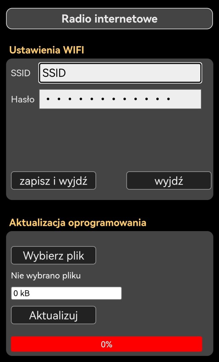

    First and foremost, convenient (no 'playing' with flash and reset buttons) . And in principle there is nothing revealing here. Webupdate already worked on the older brother ESP8266.
    On the radio, the button only switches to AP mode after the first boot to enter WiFi credentials. After restart, this page is displayed on the local IP of the network the radio is running on. Any changes to the firmware can be uploaded this way. Once uploaded, the ESP reboots itself.
    Screenshot of an “Internet radio” web panel with SSID/password fields and a firmware update section.

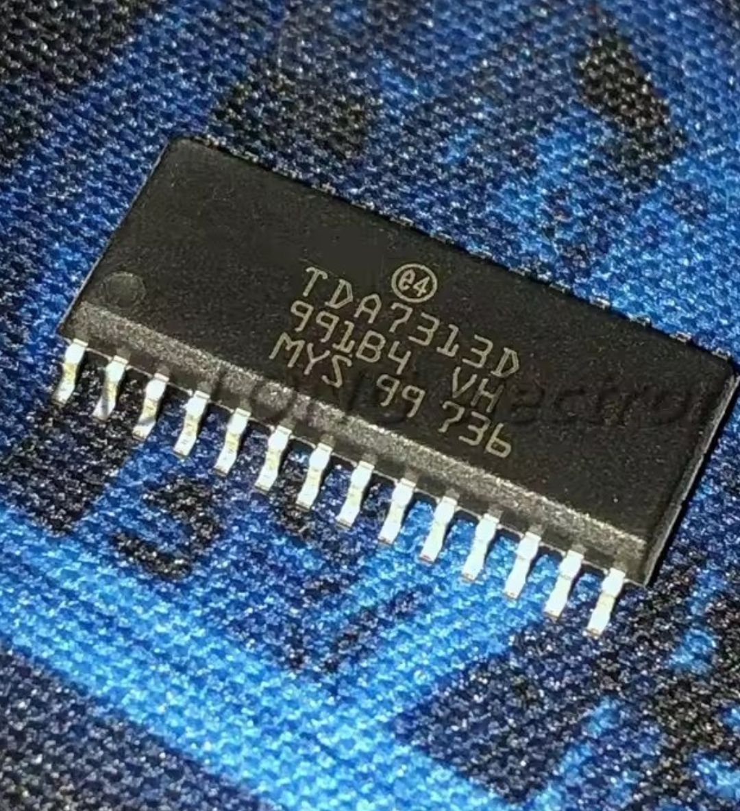

    @marweg1967
    I ordered one of these:
    The most interesting thing is that I gave the numbers from the AI chip and she replied that it was an STMicroelectronics product with a 1999 chip :D
    DIY micro tower (desktop version)

    Consider that AI often lies.
    Besides the numbers they could have given such Chinese do whatever they want, they fake everything.

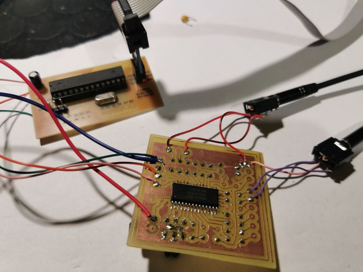

    @marweg1967 and others concerned....
    TDA7313 has arrived. I tested quickly with single commands from the Atmega88. Selector, tone and volume. Everything works.
    Two PCBs with an IC and multiple wires connected, placed on a white tabletop.

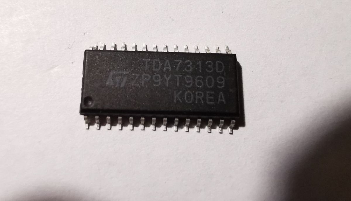

    Admittedly, there is a circuit of a different manufacture in the vendor's photo.
    I received one of these:
    Close-up of a black TDA7313D IC marked “KOREA” on a white surface
  • #174 21918415

    efi222 wrote:
    The TDA7313 has arrived. I tested quickly with single commands from the Atmega88. Selector, tone and volume. Everything works.
    Cool that you managed to come across the original or a good clone. Thanks for the info.

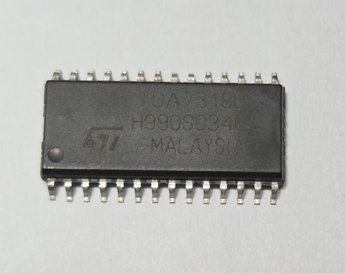

  • #175 21918493
    tytka
    Posts: 763
    Help: 8
    Rate: 1840
    Most importantly, the systems purchased work.
    Although they are rather fake (at least they look that way to me).
    The ST stamp seems a bit lopsided, too "short" horizontally.
    Below is a photo of the TDA7318D, the original 'recumbent' from my drawer.

15. Czym jest układ audio TDA7313 i jak wypada na tle TDA7318 oraz TDA8425 do wyboru wejść, głośności, balansu i regulacji barwy w wzmacniaczu DIY?
TDA7313 to procesor audio sterowany przez I2C, który łączy selektor wejść, głośność, balans i regulację barwy w jednym układzie. W wątku podano, że ma 3 wejścia, regulację barwy w 15 krokach po 2 dB i głośność w 63 krokach. TDA7318 jest z tej samej rodziny i ma 4 wejścia. TDA8425 według jednego z uczestników gra nieco lepiej, ale tylko trochę; nadal nie jest to układ wybitny jakościowo. Do małego wzmacniacza DIY wygrywa funkcjonalnością i prostszą integracją. [#21913240]
