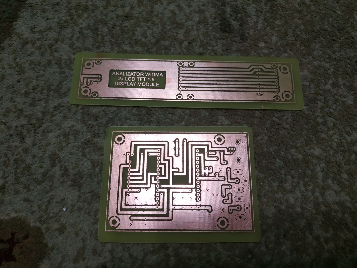

  • Need to specify hardware for a universal PCB
    #63 21901755
    DJCheester
    Level 28  
    Posts: 2082
    Help: 75
    Rate: 956
    Efi222 so it would be good to specify the hardware (as it was for the radio (Robgold's colleague) to make a universal PCB - you can design IR but not necessarily use it in software (for the time being).
    Greetings....

    There are quite a few free pins in the ESP32, in the spectrum circuit. I will test some free one to be sure and add it to the schematic.
  • #65 21901765
    DJCheester
    Level 28  
    Posts: 2082
    Help: 75
    Rate: 956
    O this would then be everything + a UART connector for using this as an attachment for mate ejcon's radio mods in the internet radio topic.
    Regards...

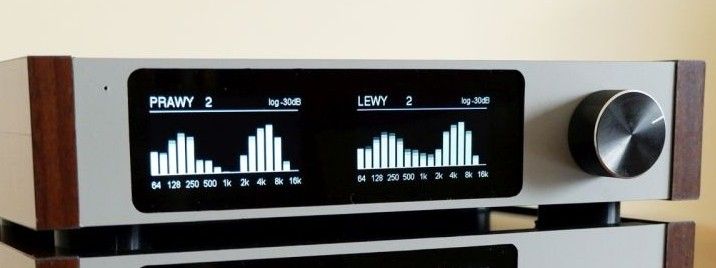

  • Left and right side panels need swapping
    #70 21901886
    tytka
    Posts: 763
    Help: 8
    Rate: 1840
    efi222 wrote:
    A pity because the printer makes the job easier. (...)
    Of course, plastic prints are not suitable for all structures and will not replace more durable steel or aluminium components and housings. Well, but something for something.
    For those who don't print. Photos of the raw housing for the radio with sides. Now you have to turn on manual beautification mode
    Well that's what makes it easier, but of the above mentioned I don't really like printing and still don't own a 3D printer.
    I prefer to tinker in aluminium or other metal, or possibly wood or plastic.
    By the way, as I've only just now paid attention.
    It would probably be more appropriate for the left to be on the left and the right to be on the right.

    tytka wrote:
    And by the way, as I've only just now paid attention.
    Of course :D . Already reported by someone commenting. I need to swap the CS wires of the displays. I'm not going to take a new photo anymore. It's poor at photographing glass panels, LEDs and luminescent elements and it takes some time.

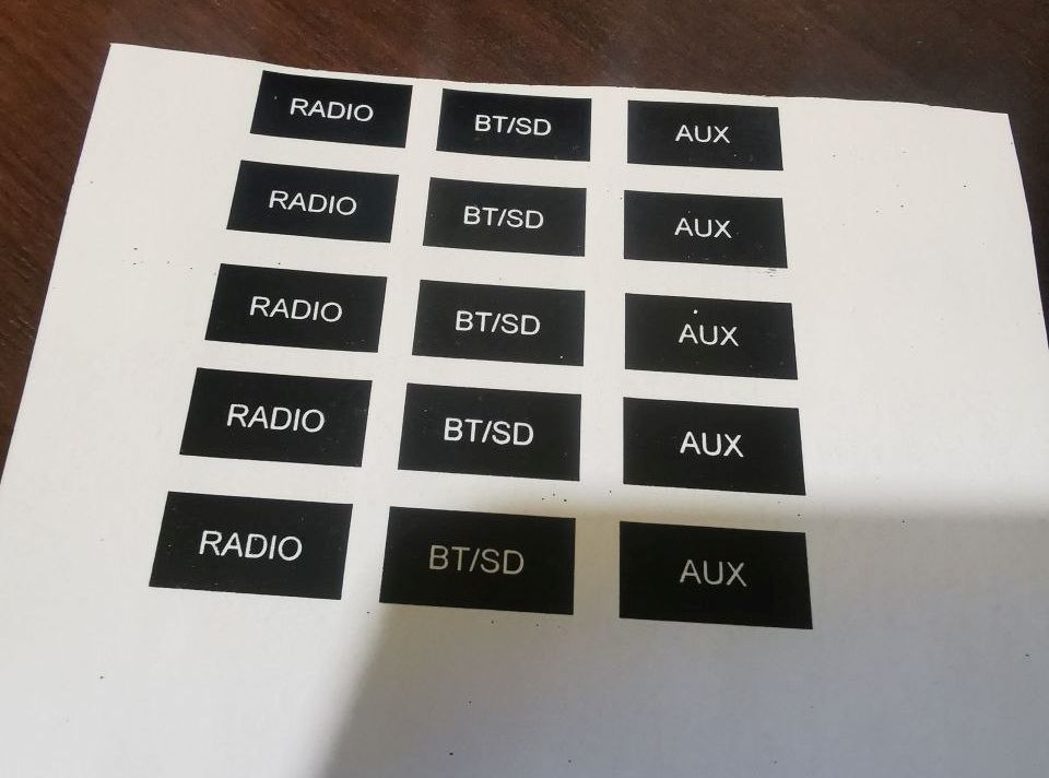

    >>21899218 Hi, great work. I wanted to ask in turn how exactly those buttons with the white AUX/RADIO/BT lettering were created. Is this a two-colour print or did you somehow fill or tape the PLA board? I'm looking for a method to make illuminated lettering that is resistant to abrasion, like the buttons on car radios.

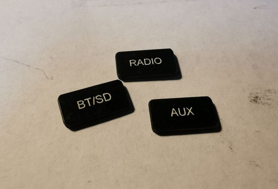

  • Laser-printed button labels on adhesive paper
    #73 21902080
    efi222
    Level 22  
    Posts: 773
    Help: 12
    Rate: 1212
    >>21901997
    The buttons are a printout. I print the button lettering on a laser printer, on glossy adhesive paper (matte can probably work too).
    Before gluing, I heat the printout with hot air until the toner starts to shine. I wonder if this is necessary. I use the heating procedure for information stickers, e.g. socket descriptions on the back of the case. The toner is then more resistant to abrasion.
    DIY micro tower (desktop version)
    I apply the sticker to the button. It is a little larger. I trim off the excess with scissors. Then I sand the edge with a flat fine needlepoint. After this procedure, the white paper of the sticker will appear on the edge because the toner will come off by the way. I retouch this with a black marker. Finally, a matt clear varnish.
    In the photo a considerable enlargement. Inscription height 2mm.
    I thought about illuminated buttons, but nothing sensible came to mind :)

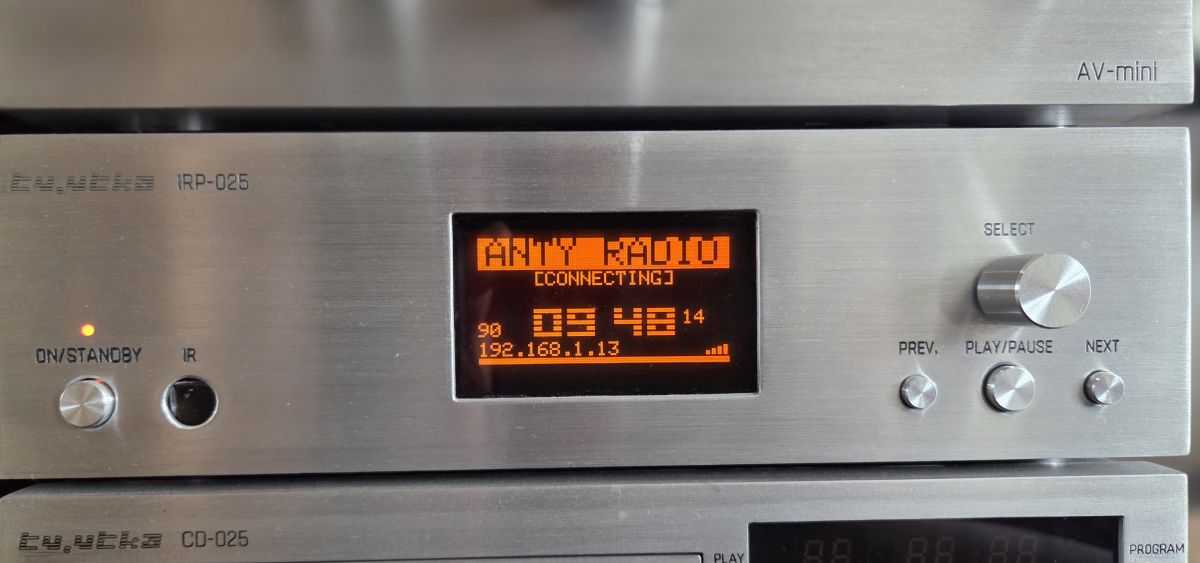

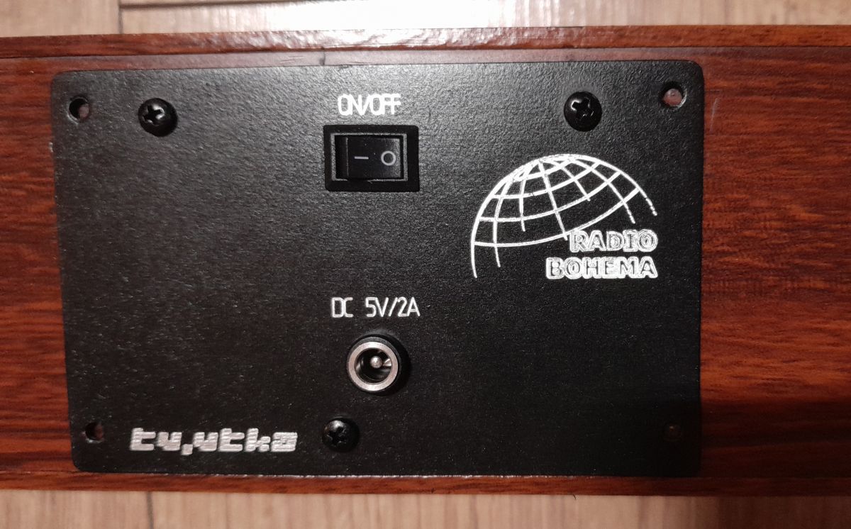

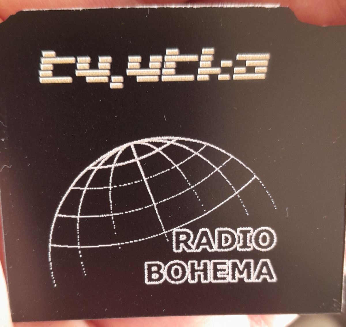

  • Front lettering can be engraved by cutter or laser
    #89 21904027
    tytka
    Posts: 763
    Help: 8
    Rate: 1840
    efi222 wrote:
    because the lettering on the front is also a bad dream...
    The lettering on the front can be engraved with either a cutter or a laser.
    Here the cutter in aluminium completed with paint:
    Here, milling cutter on aluminium painted black:
    And here an attempt at laser engraving on engraving laminate:

  • Dotyk przez szkło działa na polach o wymiarach 17 × 9 mm z przerwą 2 mm, ale wymaga zwiększonej czułości i dobrego dociśnięcia elektrod do szyby. [#21899490]
  • Widmo odświeża oba wyświetlacze z szybkością około 37–41 Hz, używając obu rdzeni ESP32 do próbkowania ADC i FFT. [#21899218]

12. Jak zrobić trwałe napisy na panelu czołowym i oznaczenia przycisków z użyciem drukarki laserowej, papieru samoprzylepnego, podgrzewania tonera i matowego lakieru?
Najtrwalsza metoda z wątku to wydruk laserowy na błyszczącym papierze samoprzylepnym, podgrzanie tonera i wykończenie lakierem matowym. Autor drukuje napisy, ogrzewa wydruk gorącym powietrzem aż toner zacznie się błyszczeć, nakleja etykietę, przycina nadmiar, szlifuje krawędź drobnym pilnikiem, retuszuje czarnym markerem białe brzegi papieru i na końcu daje matowy lakier bezbarwny. Na zdjęciu pokazał litery o wysokości około 2 mm. [#21902080]
