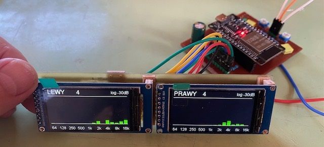

  • A DIY micro tower combines a radio, spectrum visualizer, and amplifier in two compact desktop enclosures.
  • The radio uses ESP32S3, a 2.8-inch IPS display, MPR121 touch sensing behind 4 mm tinted glass, and encoder-based station browsing.
  • The units measure 200x61x130 mm for the radio and 200x40x130 mm for the spectrum and amplifier sections.
  • The spectrum runs on an ESP32 using both cores, refreshing two 1.9-inch IPS displays at 37 to 41 FPS.
  • The amplifier is not hi-fi, uses a TPA3110 module and AVT kit 2132 tone control, and the station list is stored rigidly in firmware.

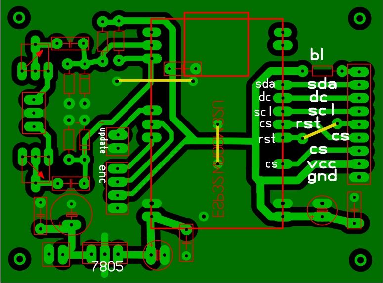

  • Encoder pin mismatch in variables.h and schematic
    #135 21907099
    pepepe1
    Posts: 77
    Rate: 128
    If you don't mind: at my place the combo went. Esp32D in 30 pin module, memory settings standard, Arduino version as recommended, Esp32 Espressif 2.0.17 board definitions and in addition in preferences
    h t t p s ://raw.githubusercontent.com/espressif/arduino-esp32/gh-pages/package_esp32_index.json.
    "From the package" there is still an encoder mismatch: in variables.h gpio 25 and 26, in the schematic 25 and 27. The board a little improved compared to my first version - this encoder + stabilizer, you can assemble or not.
    A revelation, thanks and greetings to the Author.

    Rate: 1212
    erni750906 wrote:
    and I understand that the esp connection and the displays are to be connected according to the file that I am replacing
    Or with the diagram. Only there is an encoder connection error on the schematic. It should be on IO25 and IO26

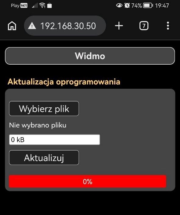

  • Wireless firmware update via ESP AP mode
    #150 21908843
    efi222
    Level 22  
    Posts: 773
    Help: 12
    Rate: 1212
    Another previously undescribed feature regarding spectrum:
    Wireless software update (*.bin).
    After holding down the "update" button for about 3 seconds, the display will show that the ESP has "entered" AP mode.
    You need to log in to the specified Wi-Fi access point " micro_widmo " - password: 12345678
    After logging in (ignore the message about no internet if it appears), you need to enter the IP 192.168.30.50 in your web browser
    The web page should launch.
    If AP mode has been running for a long time, I recommend refreshing the page before updating.
    This option is a little test version (working).
    Phone screen showing “Widmo” firmware update page at 192.168.30.50 with file upload and 0% progress bar
