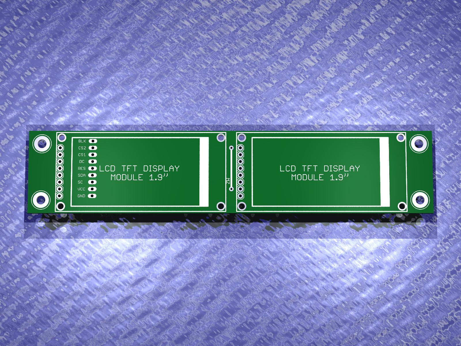

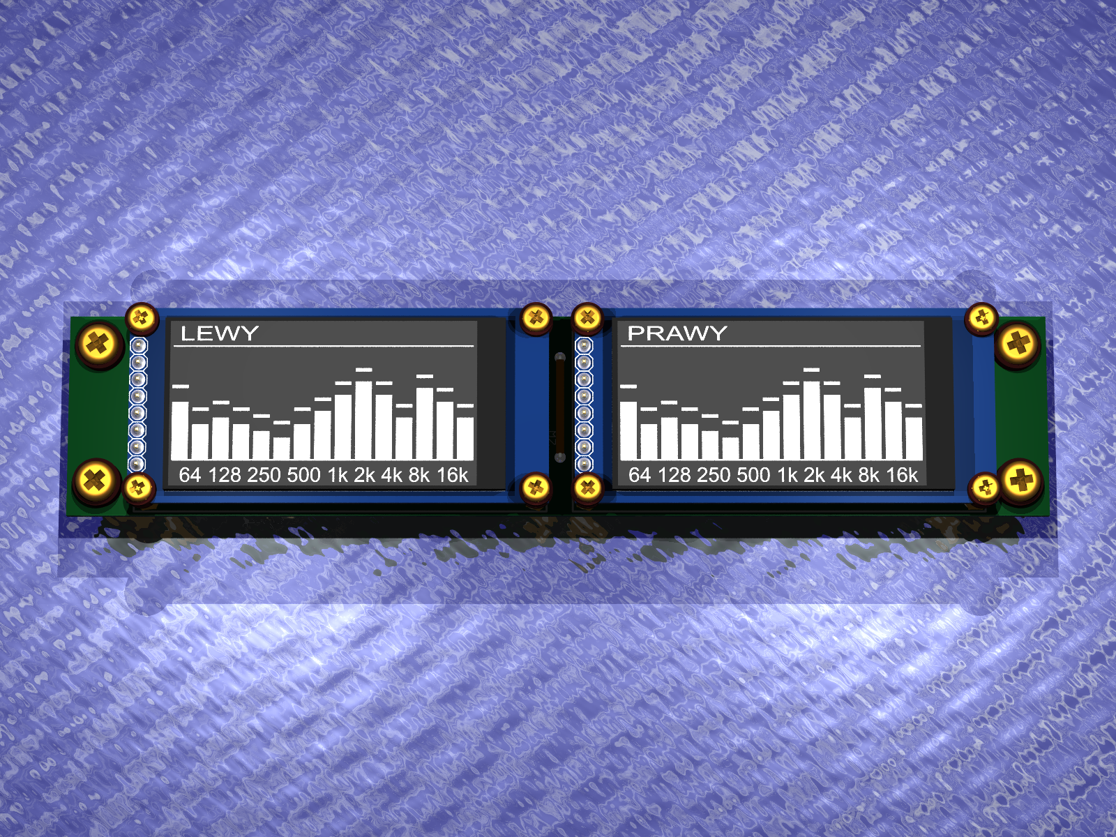

  • The spectrum runs on an ESP32 using both cores, refreshing two 1.9-inch IPS displays at 37 to 41 FPS.

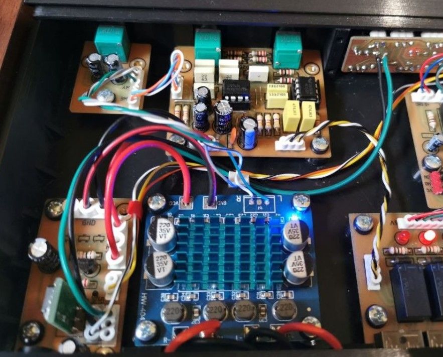

  • Incorrect TPA3110 speaker polarity wiring
    #38 21900697
    tytka
    Posts: 763
    Help: 8
    Rate: 1840

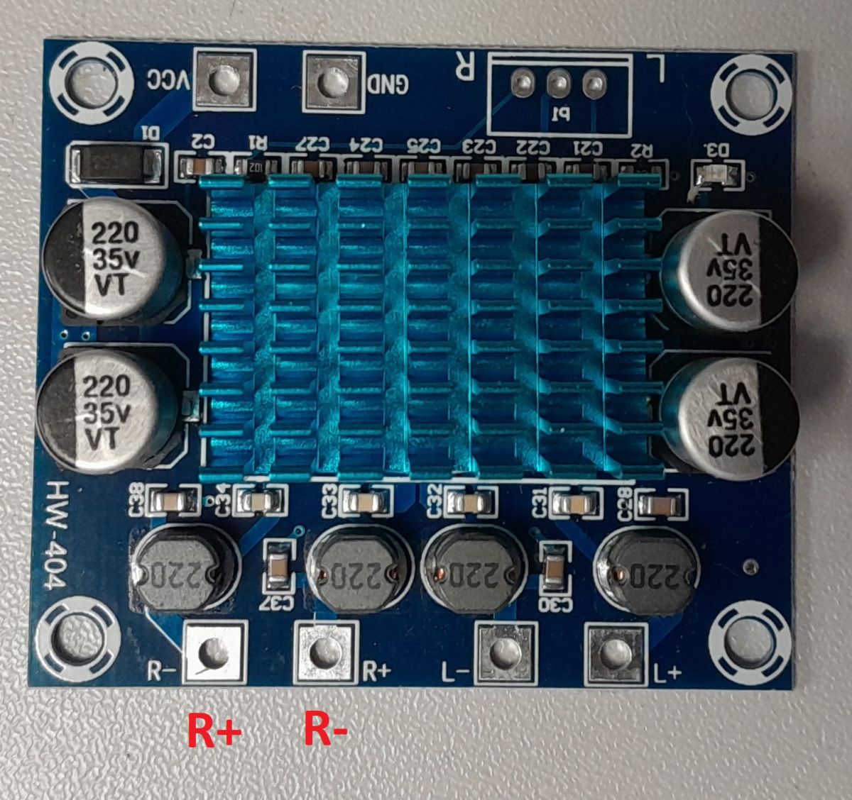

    efi222 wrote:
    It worked so well. But maybe it's the fault of the speakers - not the highest quality in my opinion. As a power amplifier I inserted a ready-made TPA3110 module.
    The speakers are also an important issue, but the truth is that it plays weaker because you believed the Chinese and incorrectly connected the speakers to the module with the TPA3110. You can see that in this photo:
    Inside an audio device showing a TPA3110 amplifier module, wiring, and multiple circuit boards in a case
    This module has the wrong output polarity marked for the right channel. The correct one is as I have described in red in the photo below:
    Amplifier PCB with blue heatsink; red labels show correct R+ and R- for the right channel.
    Connect it as I've marked and you'll definitely hear the difference.
    And if you don't believe me, I invite you to read the catalogue note of the aforementioned TPA circuit.

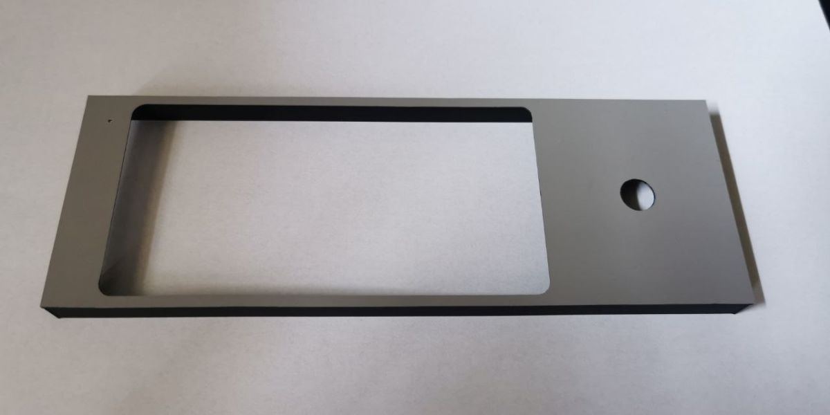

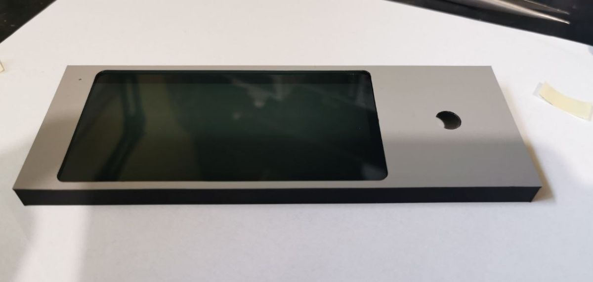

  • Tinted glass display panels with removable masking foil
    #43 21900849
    efi222
    Level 22  
    Posts: 773
    Help: 12
    Rate: 1212
    austin007 wrote:
    from what and how do you make the transparent panels for the displays? Is it cnc, printing?
    Not sure I understand the question correctly.
    The picture shows the front of the radio without the masking panel. The display is behind the tinted glass. So-called anisol black 4mm. I often use this glass. The plexi unfortunately scratches over time and here there is always a glass shine :D
    DIY micro tower (desktop version)
    And here is the masking panel itself. It's a printout taped to the front side with self-adhesive foil in grey. It is attached with contact adhesive. It can be removed quite easily and replaced with, for example, a black panel :) or any other colour.

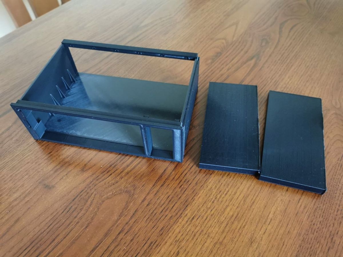

  • #46 21901030
    Damian_Max
    Level 21  
    Posts: 397
    Help: 40
    Rate: 96
    Congratulations on the project, it looks great! I'm also getting together to design this internet radio, but something is dragging xD.
    I really like the printed chassis, if I understand that blue projection correctly, the components on it; are printed in different directions (if I may say so), making it just fold over after printing (without having to cut the filament supporting the 'hanging' components). It may be nothing revelatory in 3D printing, but it impresses me :-) .
  • Modular 3D-printed enclosure with interchangeable covers
    #47 21901067
    efi222
    Level 22  
    Posts: 773
    Help: 12
    Rate: 1212
    tytka wrote:
    in this your project a lot of professionalism and great attention to detail and finishing of the project
    Thank you very much...
    All of you thank you for your positive reviews , feedback and advice :)

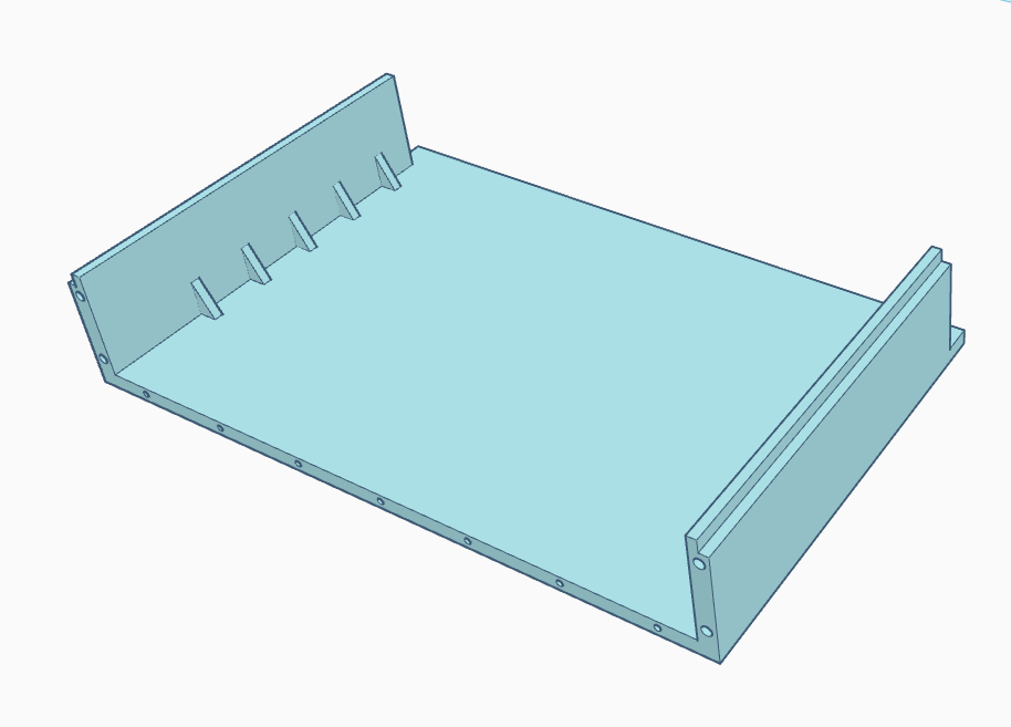

    @Damian_Max
    The picture shows the structural arrangement of the spectrum housing components.
    The components are printed in various positions on the table. They do not have supports or bridges. Of course, you have to scrape something in there - if only the "overfill" of the first layer or the remnants of the island. But something for something. Some have to be glued together (a few recessed pegs to make it easier to fit). You could probably simplify the prints by using bridges or sub-bases, but such a base, for example, is universal.
    3D model of an enclosure base with two side walls and screw holes along the edges
    The same is for the spectrum and amplifier and probably for the BT audio module. The final of the enclosure depends on the "arming" of the front bezels final glued in (something I may come up with to make them screwed in). The rear panel is fixed with screws.
    The top cover of the enclosure is universal and interchangeable with all enclosures. The one from the amplifier has additional ventilation holes.
    In any case, such an enclosure can be made in several ways.

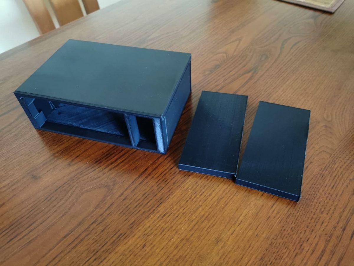

    For those who don't print. Photos of the raw casing for the radio with sides. Now you have to turn on manual beautification mode :)

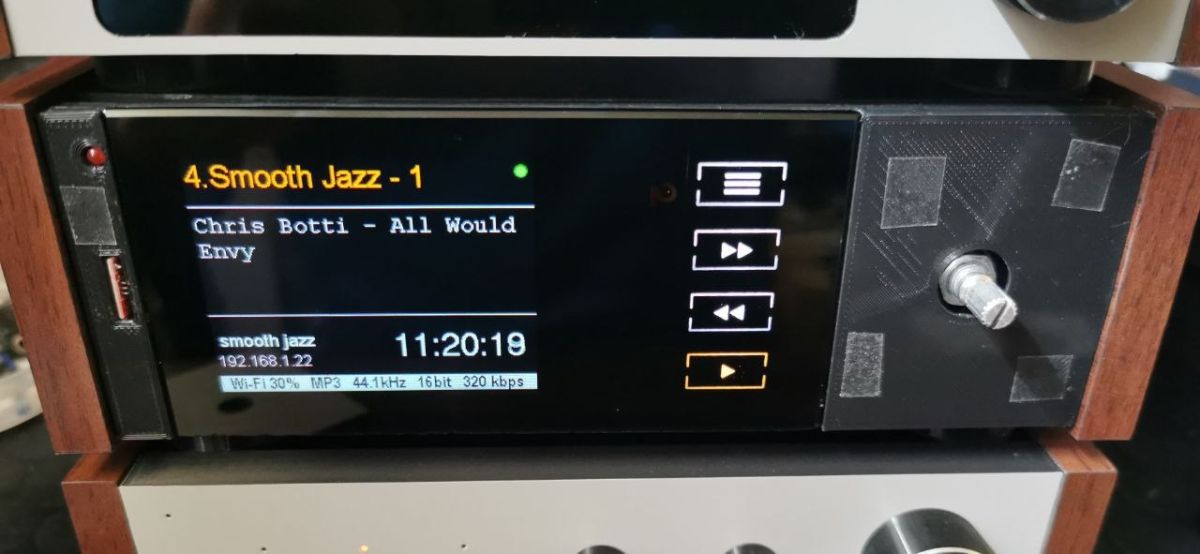

  • #54 21901588
    ArturAVS
    Moderator
    Posts: 26330
    Help: 2300
    Rate: 7814

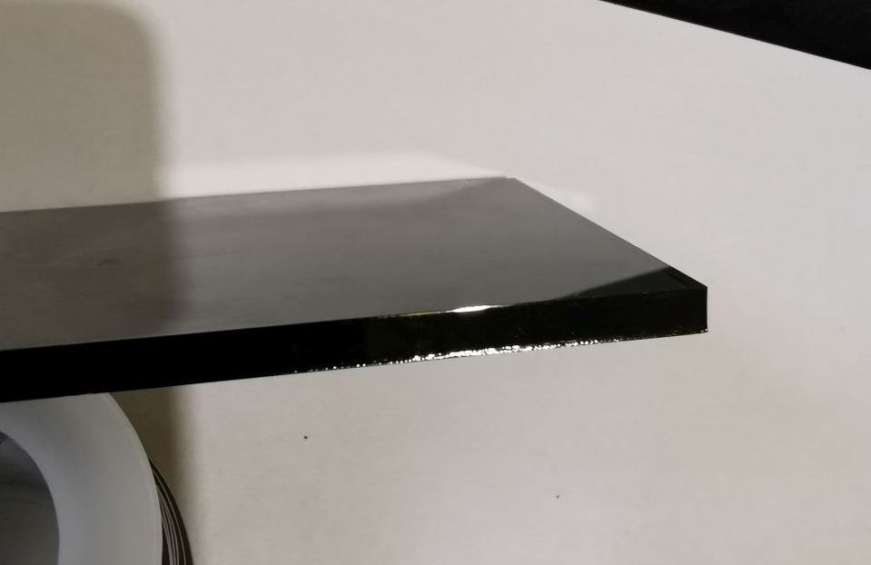

    @efi222 I have a question from a different angle, you write that the front panel is smoked glass. How did you chamfer the edges?
    Close-up of a display showing yellow text “4. Smooth Jazz” next to a red button

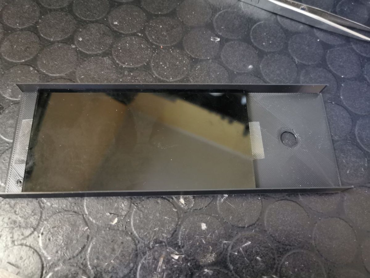

  • Smoked glass edges were only dulled by hand
    #55 21901609
    efi222
    Level 22  
    Posts: 773
    Help: 12
    Rate: 1212
    >>21900849
    In this photo the ground edge is done by a glassblower (machine cut). I cut this glass from a larger piece. This is very difficult to do at home without the right tools. I then ordered the glass cut to size from a glassblower. The problem is that not every glazier can do this with such small formats (edge grinding). You need a machine to grind small formats. So I ordered only cut ones. And I just dulled the edges myself with sandpaper so they wouldn't cut. The edge grinding is not really necessary in this construction, as it is concealed.
    It is not even worth cutting the glass by yourself. The cost of such a glass is a few zlotys. (ground glass is three or four times more expensive).
    Small glass pane in a black plastic frame on a textured rubber work mat
    Gray panel with a large rectangular dark window and a small round hole on the right

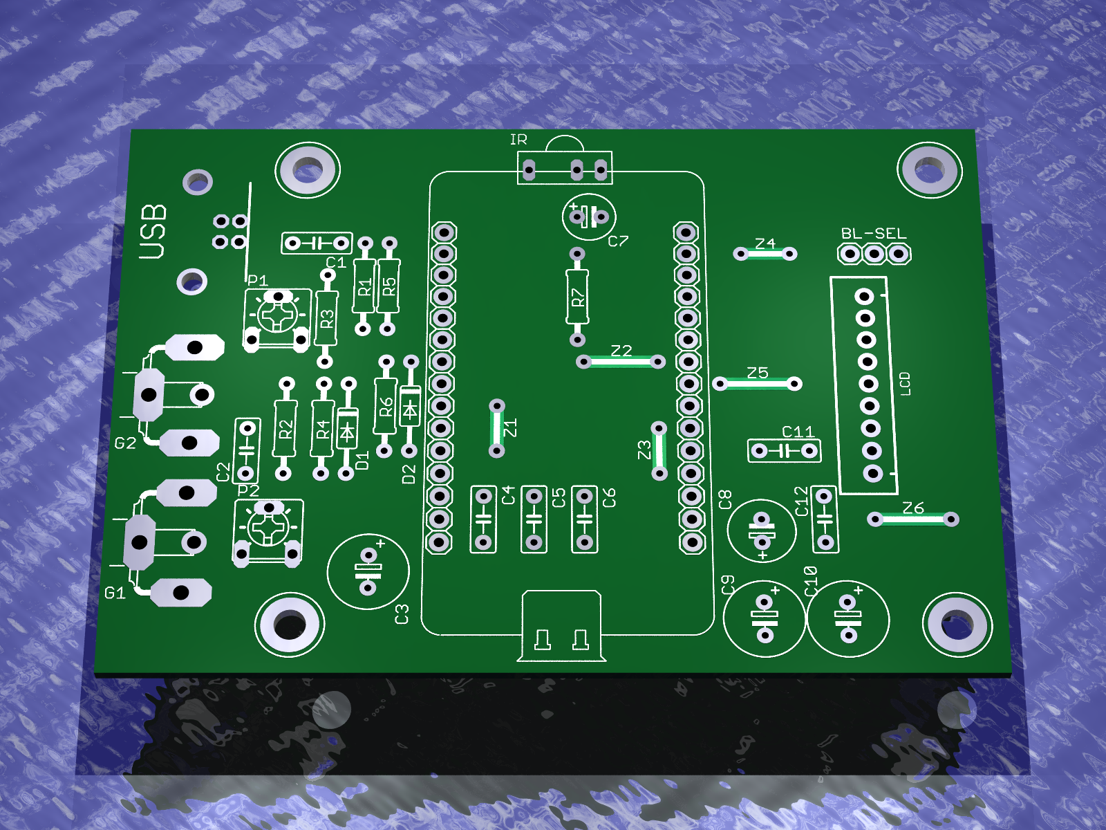

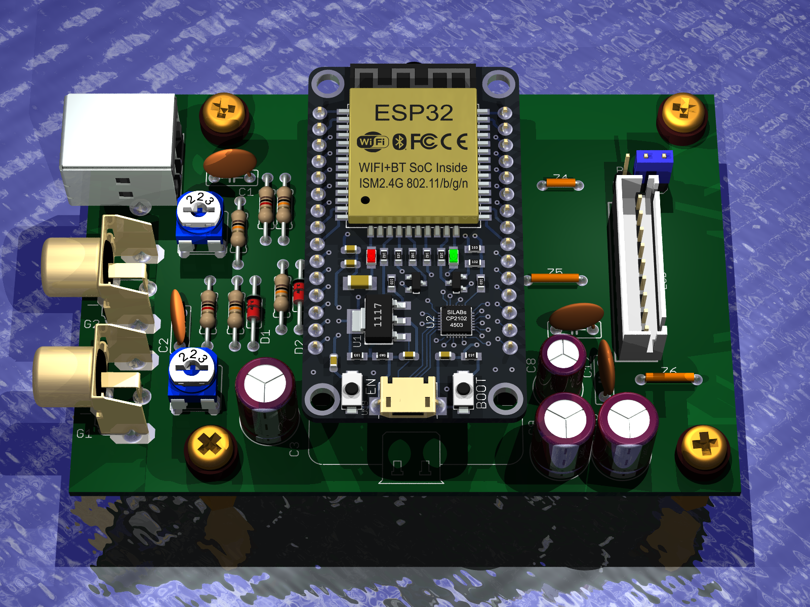

    Fellow Efi, I would make myself such a spectrum, but.... i don't really know which ESP board to use? N16R8 44 pin will be OK? Thank you in advance and best regards.
  • #58 21901726
    efi222
    Level 22  
    Posts: 773
    Help: 12
    Rate: 1212
    >>21901705
    For the ESP32 Wroom 32 or later ESP32 Wroom 32D spectrum
    Conditions for correct compilation are given at the beginning of the source code.

    I did (courtesy of colleague efi222 - thanks for the soft)
    I also made the PCB under this spectrum.
    Greetings....

1. Jak wykonano przydymiony front szklany dla radia ESP32 i dlaczego wybrano szkło „anisol black” 4 mm zamiast pleksi?
Front wykonano z przyciemnianego szkła „anisol black” 4 mm, a panel maskujący to wydruk przyklejony samoprzylepną folią do gładkiej powierzchni szkła. Autor wybrał szkło zamiast pleksi, bo pleksi z czasem się rysuje, a szkło zachowuje „połysk szkła” i lepiej wygląda na froncie urządzenia. Krawędzie nie muszą być idealnie szlifowane, bo w tej konstrukcji są ukryte; autor często tylko je tępi papierem ściernym. [#21900849]

11. TPA3110 klasy D kontra LM1876 lub LM3886 — co lepiej pasuje do małej biurkowej mikro wieży DIY i dlaczego?
Do małej, lekkiej mikro wieży lepiej pasuje gotowy TPA3110, jeśli priorytetem są rozmiar i prostota, a nie audiofilski tor. Autor użył modułu TPA3110 świadomie i zaznaczył, że to „nie jest Hi‑Fi”. W dyskusji pojawiły się głosy za LM1876/LM3886 dla lepszej jakości, ale też kontrargument, że dobra aplikacja TPA3116 z tej rodziny potrafi wypaść bardzo dobrze. W praktyce w tym projekcie ważniejsze były małe gabaryty obudowy i szybka integracja niż maksymalna jakość wzmacniacza. [#21899855]
