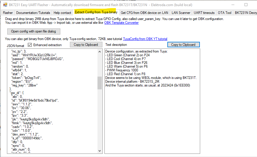

  • #4 21899381
    Posts: 5195
    Help: 446
    Rate: 913
    oh I see, Cloudcutter. Not to worry. I assumed you'd flashed with wires/uart.
    Added after 8 [hours] 24 [minutes]:
    I'm still curious, did you manually find the pin assignments or did you run the tuya config download through Easy Flasher extraction? does EF show anything if you drop the config file in there?

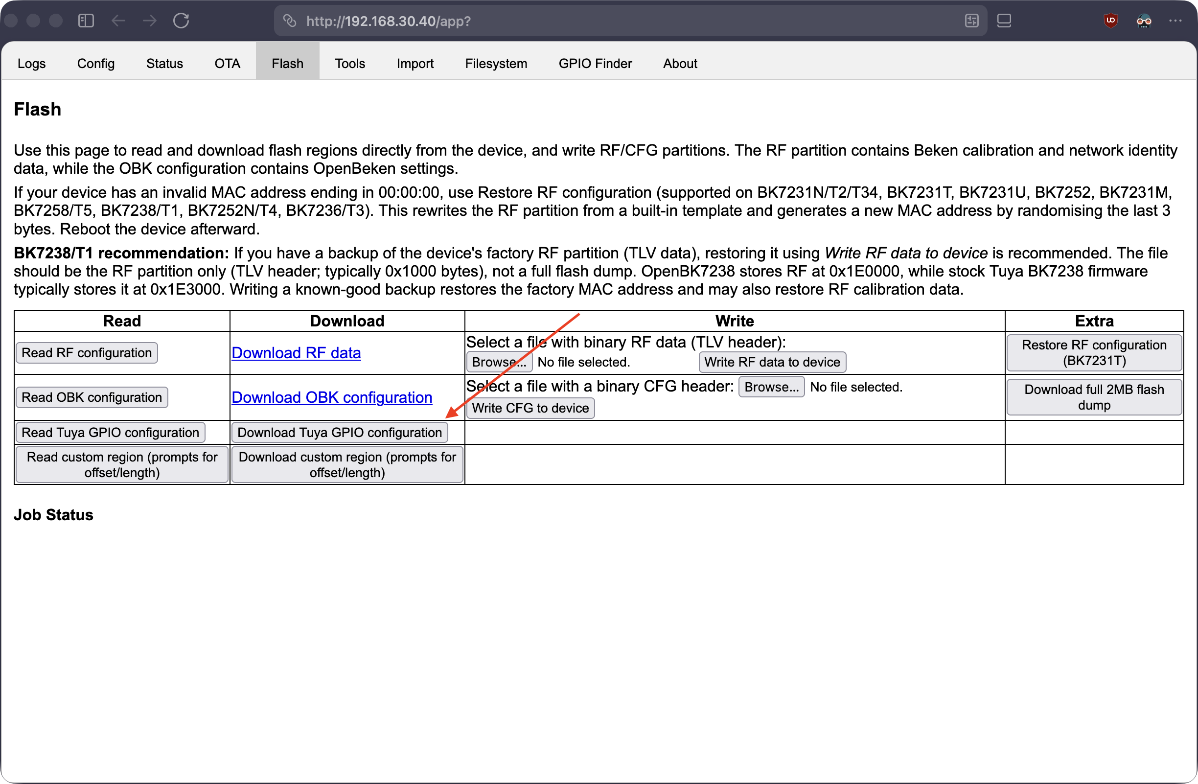

    heikomat
    >>21899381
    in the beken webapp in the "flash" tab i clicked "Download Tuya GPIO configuration"
    Screenshot of the device web UI “Flash” tab with RF/CFG read, download, and write options.

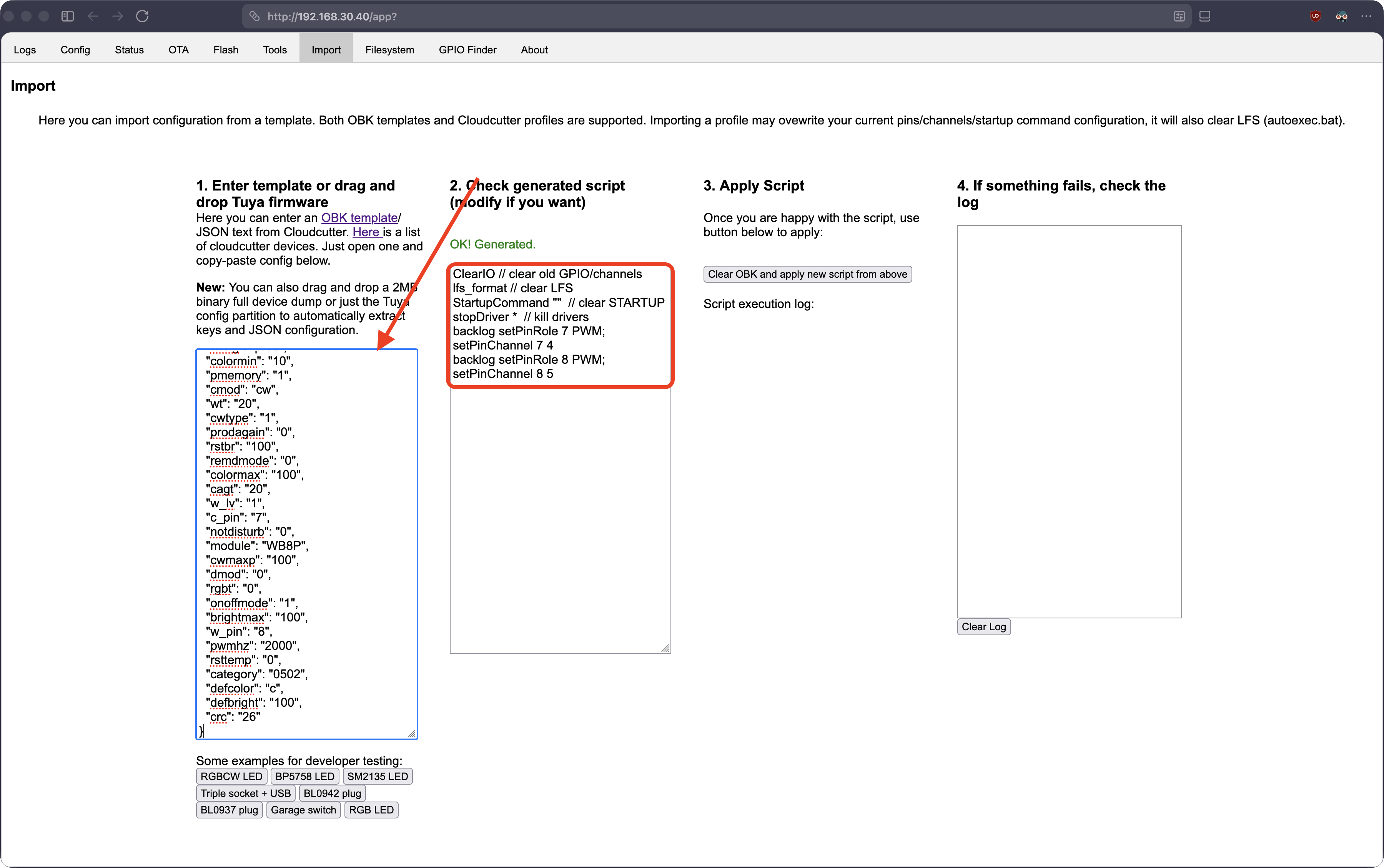

    and pasted the bin into https://openbekeniot.github.io/webapp/templateImporter.html
    That gave me the following json:
    I pasted that in the webapp under import, which gave me a pin config
    Screenshot of an “Import” page with a JSON text box, generated GPIO script, and an empty log panel
    After that i observed what the sliders in the "status" tab did, observed what the sliders on the index page did, read through the flags and after a lot of testing i figured i should
    1. switch pin 8 from PWM -> PWN_n, so cool and warm aren't switched
    2. turn on Flag 8 (alternate CW light mode) so that the Sliders on the index page don't try to blend values from both pins
    3. switch the channels for the pins because Flag 8 expects the first found channel to be the color-temparature slider
    And that worked.
