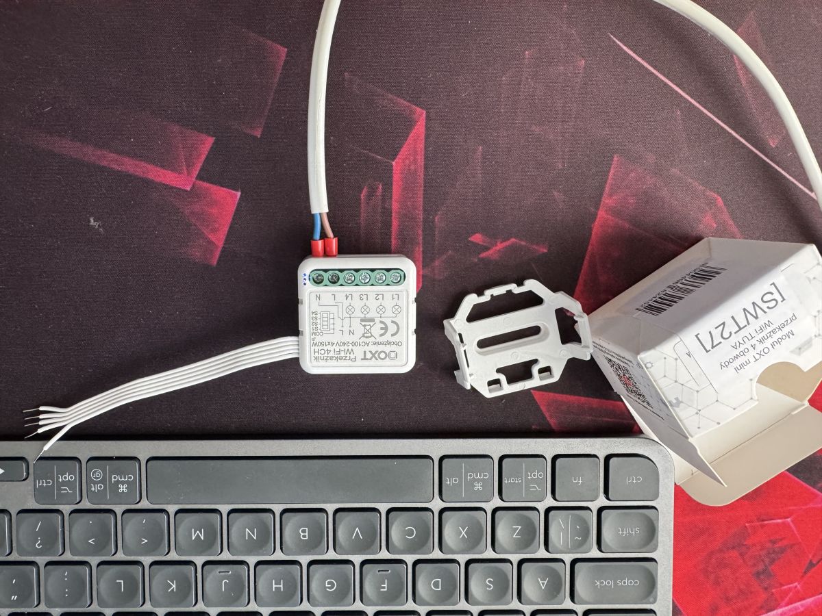

    I am after successfully re-flashing the software in the OXT SWT27 module.
    It is a mini 4 channel relay that fits in a fi 60 installation box.

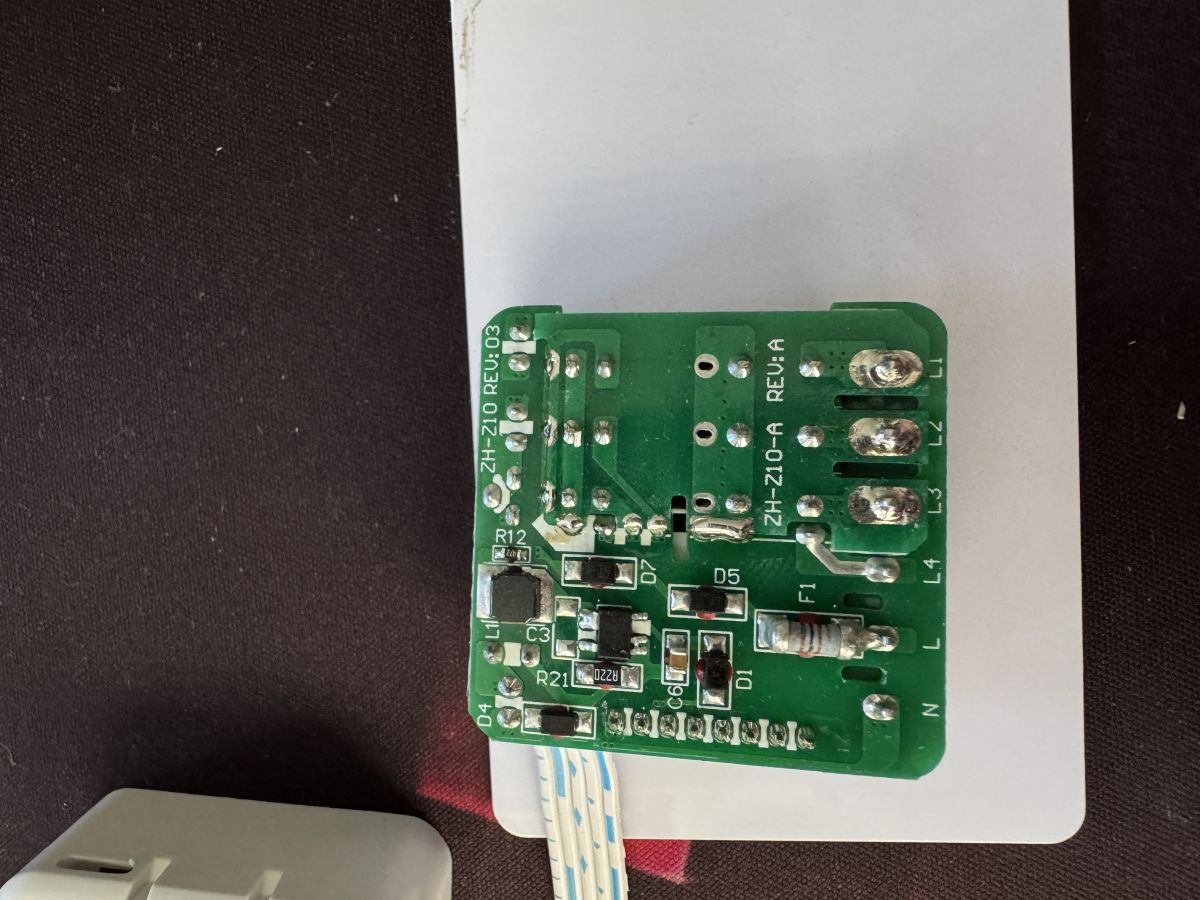

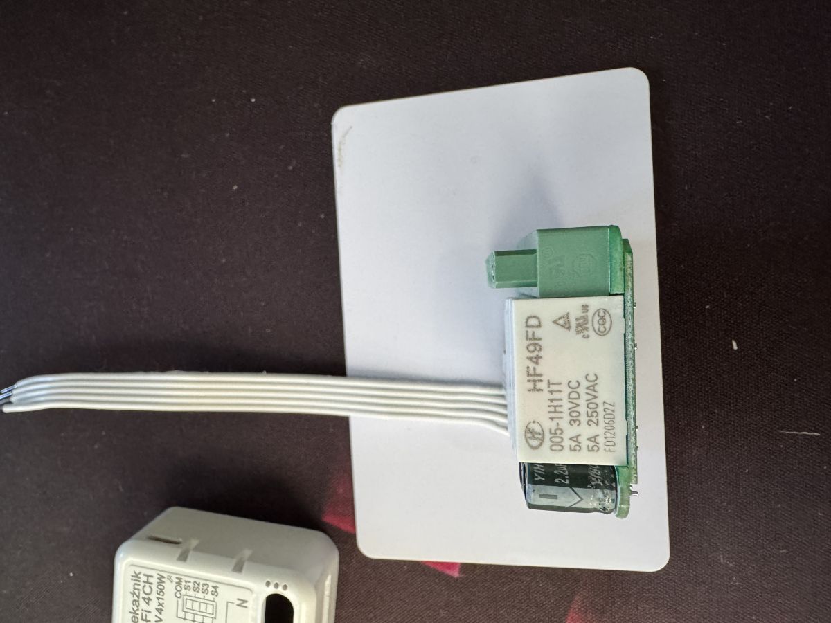

    The packing of the components is impressive. One of the relays was mounted lying down, with the CBU wifi module mounted on it. The other 3 relays were mounted on a separate pcb to save 2-3mm in height.
    The load capacity is 4x150W
    The cost on a well-known auction site 77PLN gross.
    It was possible to make a copy of the original firmware and upload OpenBenken.

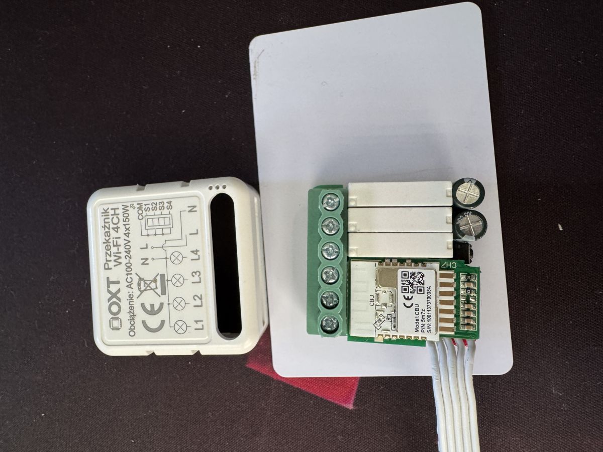

    Circuit based on Tuya CBU:
    OpenBK7231N OXT SWT27 module - CBU pin re-flash and configuration .
    OpenBK7231N OXT SWT27 module - CBU pin re-flash and configuration OpenBK7231N OXT SWT27 module - CBU pin re-flash and configuration OpenBK7231N OXT SWT27 module - CBU pin re-flash and configuration .
    Power supply based on transformerless power supply BP2525
    Pin assignment:
    Input:
    S1 - PIN P26 CBU
    S2 - PIN P6 CBU
    S3 - PIN P7 CBU
    S4 - PIN P8 CBU
    Reset - pin P24 CBU
    Output:
    L1 - P20 CBU
    L2 - P28 CBU
    L3 - P17 CBU
    L4 - P16 CBU
    LED - P9 CBU

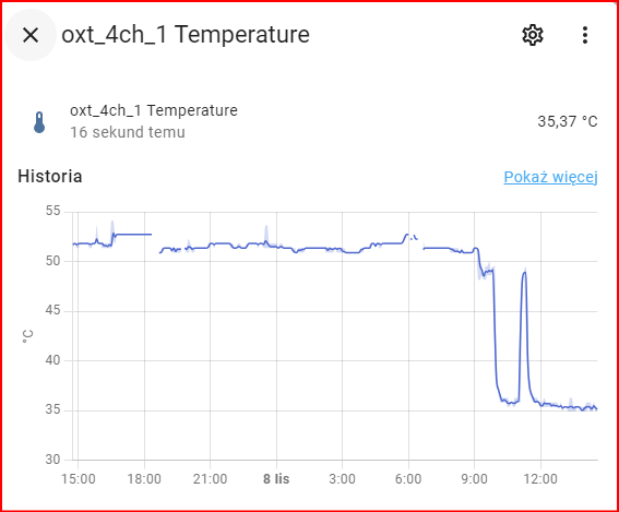

    Thank you for your reply. By the way, I throw in an interesting fact related to the PowerSave 1 command. This is the temperature waveform before and after applying this parameter. These are the temperatures reached by the system with 2 relays on:
  • #6 21294381
    Posts: 14791
    Rate: 12937
    PowerSave is quite important and we will probably soon decide to turn it on by default, but it may at the same time spoil IR reception and measurements from BL0937 and therefore no final decision has been made yet. Additionally, it is difficult to test all possible devices to know how they will react with this option....
