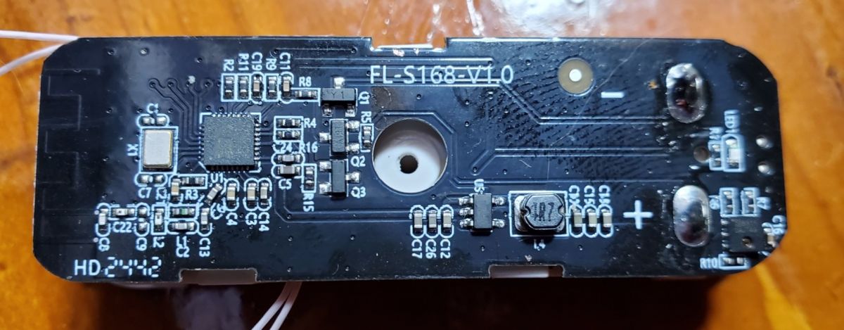

    #93 21387341
    sns1
    Posts: 12
    Hi,

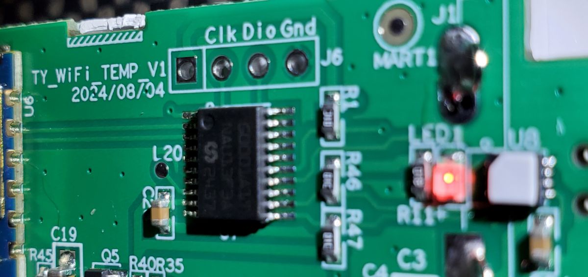

    Can I ask, probably, noob questions even though I've read this thread?
    I have a similar tuya wifi sensor, but it has a different pcb. It has BK7321N for sure and I've flashed it with OpenBekken, configured according to config found here (channel 1, channel 2) and it does connect to wifi/HA/mqtt but posts no data. Web App Log does not show any TuyaMCU lines whatsoever... I have to note, that this particular device has never been paired or used - flashed straight out of the box - not sure if it matters...
    Where should I look for a solution? I have another one unopened for testing, but not sure where to proceed. Pair it, hook up to rx/tx and look for possible communications? I doubt that similar device would use dpI, for example, number 7 or 12 instead of 1 and 2... But there might be some error in my config/actions as I do not fully understand all the scheme of how it works...
  • #94 21387351
    Posts: 14750
    Rate: 12866
    Please post photos of your device. Maybe you have a version without TuyaMCU? Or maybe you have wrong baud setting?
  • #95 21387365
    sns1
    Posts: 12
    >>21387351
    Circuit board with electronic components on a wooden surface.
    Hem... I thought BK*** is a TuyaMCU....
  • Non-TuyaMCU sensor needs PinDeepSleep or DeepSleep

    #98 21387895
    sns1
    Posts: 12
    >>21387372
    >>21387372
    Thank you for the suggestions.
    It turns out that it is a BK7231N with CHT8315 sensor version. I've found threads with like variants (BLE version though).
    Now trying to make it work and got as far as wrong temp/hum returns. Will try to check traces for i2c and understand if current cht83xx driver should work with i2c or not or what possible variant will.
    Added after 1 [hours] 54 [minutes]:
    Found that mine board has different pins connected to a sensor, which are 23 and 24 (sda & scl(sck)) and getting wrong, but different measurements (-40 and 0 for temp/hum).
    Can't yet understand pin<->channel(s) relations, yet those a bit differently configured in native web and app web interfaces...

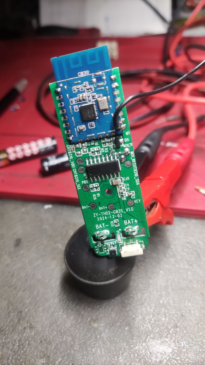

    #99 21398650
    vinibali
    Posts: 19
    Hi there!
    I also have a somewhat newer version of this board with a shield less CB3S, TuyaMCU and CHT8310. I need to somehow remove the TuyaMCU's connection for now, so this board is not recommended to buy!
    Let me share my experiences
    * flashing was unsuccessful if the MCU TX and RX pins were connected (removing only one connection was enough)
    * had to set the flashing speed to 460800 otherwise it failed around 75% of the process with hid_download's uartprogram on Linux
    * pulling up CEN is needed otherwise the chip resets itself around every 10-11 seconds I powered up only the CB3S board this time!
    ** disconnect TuyaMCU's pin 3 also solved the problem
    * wakeup from deep sleep doesn't work
    Close-up of a circuit board with a blue module and wiring on graph paper background.

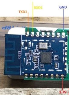

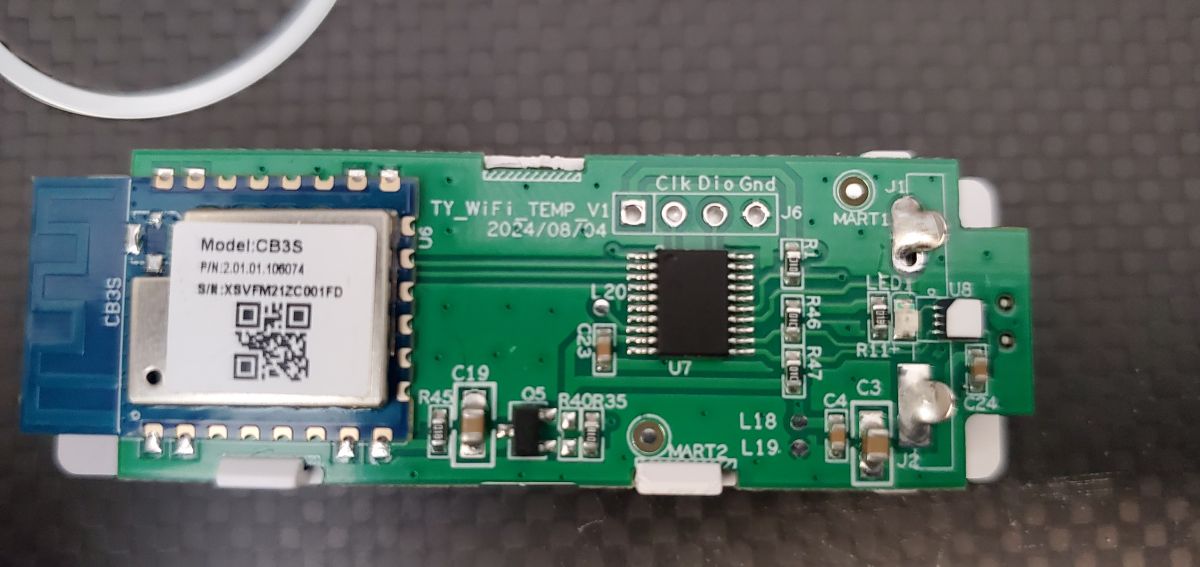

    #103 21401774
    BobUrban
    I was able to flash my device successfully with the MCU TX and RX connected.
    When it's powered now, it doesn't properly connect to Wifi, sometimes when I press the button it connects, but the openbk UI only is available for a few seconds.
    Is there anything I could try?
    Is there any recommended similar device to buy instead of this one?
    This is my device:
    PCB with CB3S module and various electronic components.
    This is the connections I used for flashing
    CB3S module with TXD1, RXD1, GND, and 3.3V pins connected.
  • TuyaMCU power control causes Wi-Fi dropouts
    #104 21402357
    Posts: 14750
    Rate: 12866
    This is TuyaMCU battery powered device. The SOIC chip on board controls the power connection of WiFi module and it turns on and off the module. That's why it goes offline.
    You can either:
    - configure it properly with tmSensor driver and required dpIDs, maybe autoexec.bat from post 6 in this thread can work, or you can check somewhere else on forum https://www.elektroda.com/rtvforum/find.php?q=tmSensor
    You will need to connect external 3.3V to WiFi module VDD for that...
    - remove the MCU and configure this device manually with CHT driver (if present - which sensor is there?) and use manual deep sleep on OBK directly https://www.elektroda.com/rtvforum/find.php?q=deepsleep
    In any case, don't give up and ask if you have any questions. Battery powered devices are very tricky to work with.

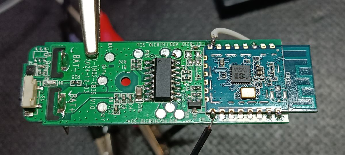

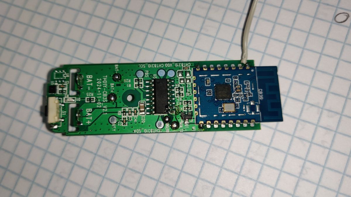

    #105 21420822
    maxim2002
    Posts: 46
    Rate: 12
    They are getting more and more annoying with these temperature sensors.
    I've now been hit with one identical to the one BobUrban has.
    Circuit board with desoldered MCU module and connected wires. .
    Flash uploaded after soldering out the Tuya MCU with no problems.
    Config basic:
    In the logs only:
    Is there anything I can do to help? I don't have much experience with Tuya protocols, but soldering and connecting the UART I know how to ;)

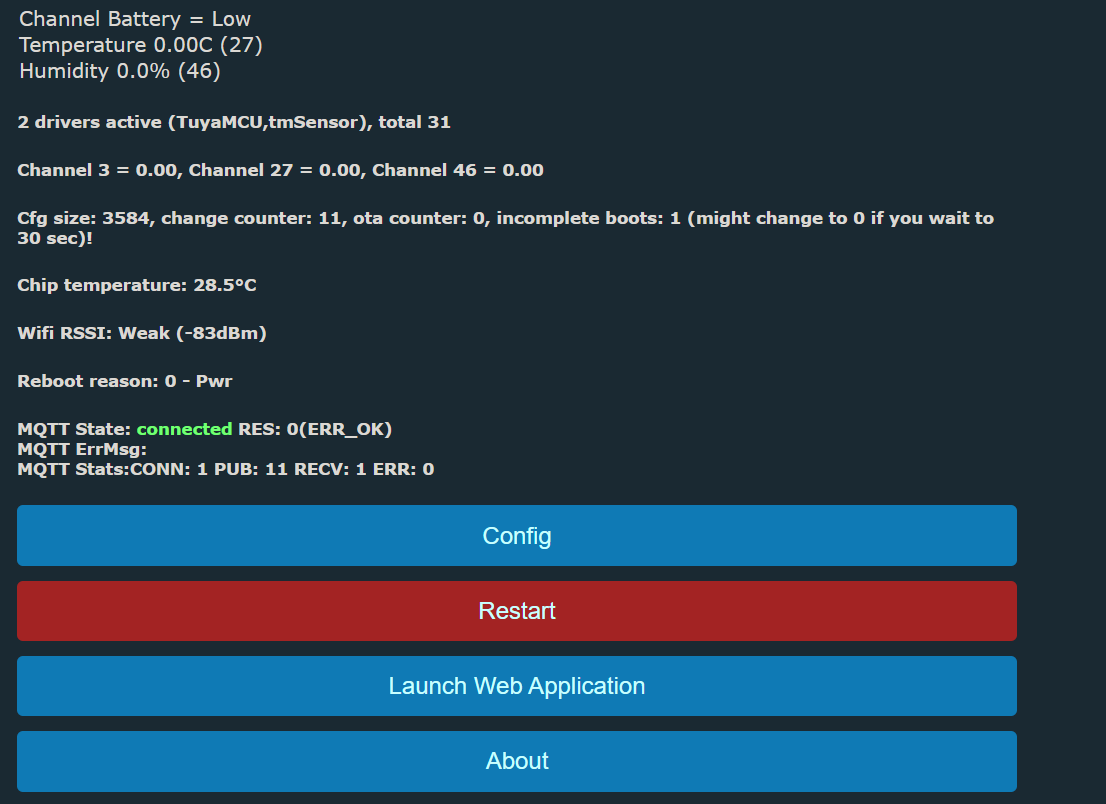

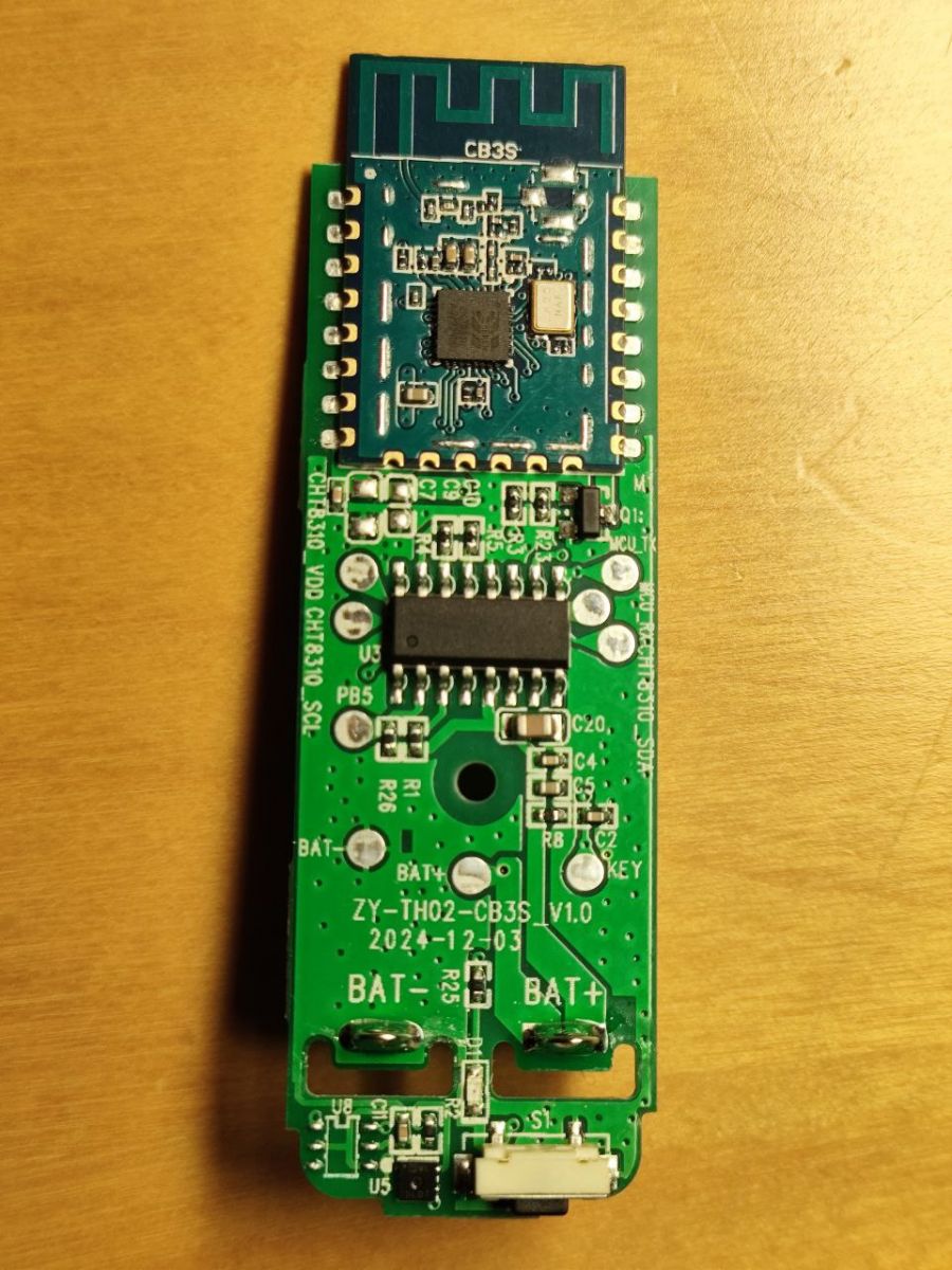

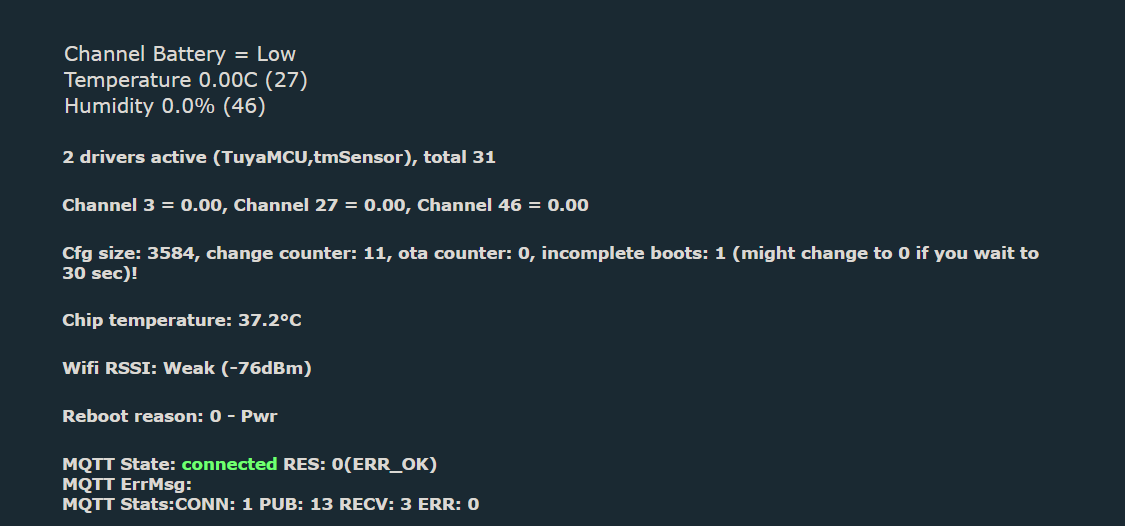

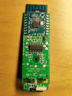

    #109 21442664
    angzero
    Level 4  
    Posts: 13
    so it seems that i'm in the same boat as many people here where each iteration of this device yields different behavior and needs a slightly different approach, so here is mine:
    also, @p.kaczmarek2 i can only imagine the headache you must have from this alone as i went through the whole thread reading the back and forth (hopefully i didn't miss anything)
    so this is my Tuya Temperature and humidity sensor with a CB3S, which i managed to flash the latest 1.18.42 without disordering or cutting off any traces
    Close-up of a Tuya temperature and humidity sensor circuit board with highlighted components.
    Circuit board of a Tuya temperature and humidity sensor with CB3S module.
    - MQTT connected, configured and showing in HA but values are 0 since its powered externally
    - when powering through the battery, no data or ability to see the device neither directly or on HA:
    as one of the posts mentioned, i activated Flag 37 and lowered the uptime from 5 to 3 seconds + static IP but no changes to this behavior
    here's my autoexe.bat:
    startDriver TuyaMCU
    startDriver tmSensor
    tuyaMCU_setBaudRate 115200
    //tuyaMcu_defWiFiState 4 (notsureifneeded)
    // dpID 27 is temperature div 10
    setChannelType 27 temperature_div10
    linkTuyaMCUOutputToChannel 27 val 27
    // dpID 46 is % humidity
    setChannelType 46 Humidity
    linkTuyaMCUOutputToChannel 46 val 46
    // dpID 3 is battery state - low(0), mid(1) and high(2)
    setChannelType 3 ReadOnlyLowMidHigh
    linkTuyaMCUOutputToChannel 3 enum 3
    setChannelLabel 3 Battery
    //tuyaMcu_sendProductInformation
    This is the first time I flash a device like this, usually i manage to get some configs from the original firmware during backup but not here, the configure module page in the web app has nothing configured and left as is
    My main issue right now is that i can't get anything out of the device when running on battery, not sure i'm missing anything or if i skipped a step i need, like cutting off the Tx and Rx from the TuyaMCU
    This is the main page when connected EXTERNALLY
    Screenshot of Tuya temperature and humidity sensor configuration
    hopefully that paints a full picture of the situation, if not, feel free to ask me anything and i'll do my best to respond and provide all the details i can. thanks everyone

  • #113 21450156
    angzero
    Level 4  
    Posts: 13
    Anyone have any ideas on how to help with this please? -> >>21442664
  • #114 21450164
    DeDaMrAz
    Posts: 620
    Help: 34
    Rate: 130
    @angzero
    Just out of the blue as I was not reading anything else.
    Have you tried with tuyaMCU_setBaudRate 9600
  • Baud rate lowered, but sensor readings still missing
    #115 21450238
    angzero
    Level 4  
    Posts: 13
    >>21450164 Lowering the BaudeRate seemed to have helped with getting slightly more time with the wifi module being on and seeing the menu, but not sensor readings is being reported so far, neither in the webpage or in HA, interestingly i saw this message pop out newly:
    "Cfg size: 3584, change counter: 11, ota counter: 0, incomplete boots: 1 (might change to 0 if you wait to 30 sec)!"
    User interface with diagnostic information and configuration buttons.
    i'll try to see if i can get any log readings:
    Info:CFG:####### Boot Count 40 #######
    Warn:CFG:CFG_InitAndLoad: Correct config has been loaded with 11 changes count.
    Info:MAIN:Main_Init_Delay
    Info:MAIN:Registered for wifi changes
    Info:MQTT:MQTT_RegisterCallback called for bT obk2DE0035D/ subT obk2DE0035D/+/set
    Info:MQTT:MQTT_RegisterCallback called for bT bekens_n/ subT bekens_n/+/set
    Info:MQTT:MQTT_RegisterCallback called for bT cmnd/obk2DE0035D/ subT cmnd/obk2DE0035D/+
    Info:MQTT:MQTT_RegisterCallback called for bT cmnd/bekens_n/ subT cmnd/bekens_n/+
    Info:MQTT:MQTT_RegisterCallback called for bT obk2DE0035D/ subT obk2DE0035D/+/get
    Info:CMD:CMD_StartScript: started @startup at the beginning
    Info:MAIN:Started TuyaMCU.
    Info:MAIN:Started tmSensor.
    Info:GEN:Channel 27 type changed to temperature_div10
    Info:GEN:Channel 46 type changed to Humidity
    Info:GEN:Channel 3 type changed to ReadOnlyLowMidHigh
    Info:MAIN:Time 1, idle 266405/s, free 73480, MQTT 0(0), bWifi 0, secondsWithNoPing -1, socks 2/38
    Info:MAIN:Time 2, idle 195363/s, free 72984, MQTT 0(0), bWifi 0, secondsWithNoPing -1, socks 2/38
    Info:MAIN:Time 3, idle 75067/s, free 73312, MQTT 0(0), bWifi 0, secondsWithNoPing -1, socks 2/38
    Info:MAIN:Time 4, idle 0/s, free 73312, MQTT 0(0), bWifi 0, secondsWithNoPing -1, socks 2/38
    Info:MAIN:Boot complete time reached (3 seconds)
    Info:MAIN:Time 5, idle 0/s, free 73312, MQTT 0(0), bWifi 0, secondsWithNoPing -1, socks 2/38
    Info:MQTT:mqtt_userName DriveT1
    Info:MAIN:Time 6, idle 102081/s, free 73136, MQTT 0(1), bWifi 1, secondsWithNoPing -1, socks 2/38
    Info:MQTT:mqtt_subscribed to obk2DE0035D/+/set
    Info:MQTT:mqtt_subscribed to bekens_n/+/set
    Info:MQTT:mqtt_subscribed to cmnd/obk2DE0035D/+
    Info:MQTT:mqtt_subscribed to cmnd/bekens_n/+
    Info:MQTT:mqtt_subscribed to obk2DE0035D/+/get
    Info:MQTT:Publishing val TemhumbB1 to obk2DE0035D/host retain=0
    Info:MAIN:Time 7, idle 184012/s, free 73384, MQTT 1(1), bWifi 1, secondsWithNoPing -1, socks 2/38
    Info:MQTT:Publishing val OpenBK7231N 1.18.42 Feb 15 2025 19:44:25 to obk2DE0035D/build retain=0
    Info:MAIN:Time 8, idle 200118/s, free 73112, MQTT 1(1), bWifi 1, secondsWithNoPing -1, socks 2/38
    Info:MQTT:Publishing val f8:17:2d:e0:03:5d to obk2DE0035D/mac retain=0
    Info:MAIN:Time 9, idle 187807/s, free 64536, MQTT 1(1), bWifi 1, secondsWithNoPing -1, socks 3/38
    Info:MQTT:Publishing val 28.52 to obk2DE0035D/temp retain=0
    Info:MAIN:Time 10, idle 194920/s, free 73384, MQTT 1(1), bWifi 1, secondsWithNoPing -1, socks 2/38
    Info:GEN:dhcp=0 ip=192.168.2.42 gate=192.168.2.1 mask=255.255.255.0 mac=f8:17:2d:e0:03:5d
    Info:MAIN:Time 11, idle 187175/s, free 73144, MQTT 1(1), bWifi 1, secondsWithNoPing -1, socks 2/38
    Info:MQTT:Publishing val 2 to obk2DE0035D/sockets retain=0
    Info:MAIN:Time 12, idle 185905/s, free 73384, MQTT 1(1), bWifi 1, secondsWithNoPing -1, socks 2/38
    Info:MQTT:Publishing val -81 to obk2DE0035D/rssi retain=0
    Info:MAIN:Time 13, idle 191601/s, free 73384, MQTT 1(1), bWifi 1, secondsWithNoPing -1, socks 2/38
    Info:MQTT:Publishing val 13 to obk2DE0035D/uptime retain=0
    Info:MAIN:Time 14, idle 189461/s, free 73152, MQTT 1(1), bWifi 1, secondsWithNoPing -1, socks 2/38
    Info:MQTT:Publishing val 73384 to obk2DE0035D/freeheap retain=0
    Info:MAIN:Time 15, idle 194553/s, free 73144, MQTT 1(1), bWifi 1, secondsWithNoPing -1, socks 2/38
    Info:MQTT:Publishing val 192.168.2.42 to obk2DE0035D/ip retain=0
    Info:MAIN:Time 16, idle 190704/s, free 73384, MQTT 1(1), bWifi 1, secondsWithNoPing -1, socks 2/38
    Info:MQTT:Channel has changed! Publishing 0 to channel 3
    Info:MQTT:Publishing val 0 to obk2DE0035D/3/get retain=0
    Info:MAIN:Time 17, idle 188579/s, free 73152, MQTT 1(1), bWifi 1, secondsWithNoPing -1, socks 2/38
    Info:MQTT:MQTT client in mqtt_incoming_publish_cb topic obk2DE0035D/3/get
    Info:MQTT:Channel has changed! Publishing 0 to channel 27
    Info:MQTT:Publishing val 0 to obk2DE0035D/27/get retain=0
    Info:MAIN:Time 18, idle 185000/s, free 73384, MQTT 1(1), bWifi 1, secondsWithNoPing -1, socks 2/38
    Info:MQTT:MQTT client in mqtt_incoming_publish_cb topic obk2DE0035D/27/get
  • Temporary -Bat to GND jumper enables readings
    #116 21462840
    BobUrban
    doudouni100 wrote:
    Hi
    Put a temporary jumper wire from -Bat of the sensor board to GND on the Wi-Fi module and use this autoexec:
    Hi @doudouni100
    Thanks for your input, this worked for me after trying around many times, I am seeing values finally.
    Is there a way to configure how often this happens?
    Did someone manage to put the PCB back in to the case?
