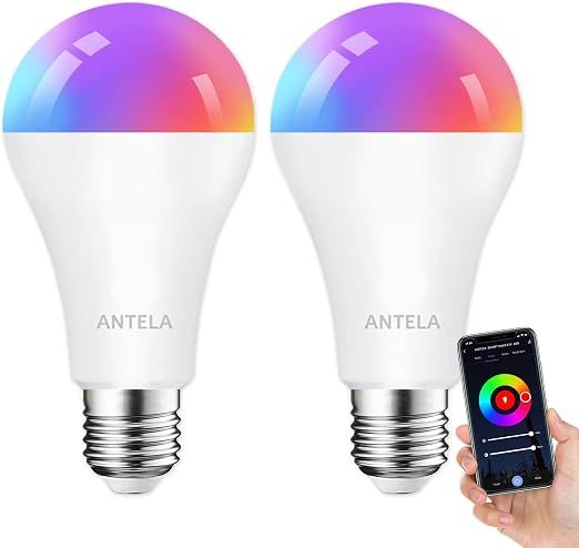

    Hi everyone,
    I successfully flashed an Antela E27 12 W RGB+CCT with OpenBeken and wanted to share the working configuration.
    Antela E27 12W RGB+CCT - BK7231N / KP18058 - OpenBeken configuration
    Device: Antela E27 12 W RGB+CCT
    MCU: BK7231N
    LED driver: KP18058
    GPIO configuration:
    P7 = KP18058_CLK
    P8 = KP18058_DAT
    LED type:
    RGB + Warm White + Cool White (RGBCW)
    Working LED mapping:
    2 0 1 4 3
    Command:
    KP18058_Map 2 0 1 4 3
    Everything has been tested, and the five channels are working correctly.
    Hopefully this helps other Antela E27 12 W owners.
