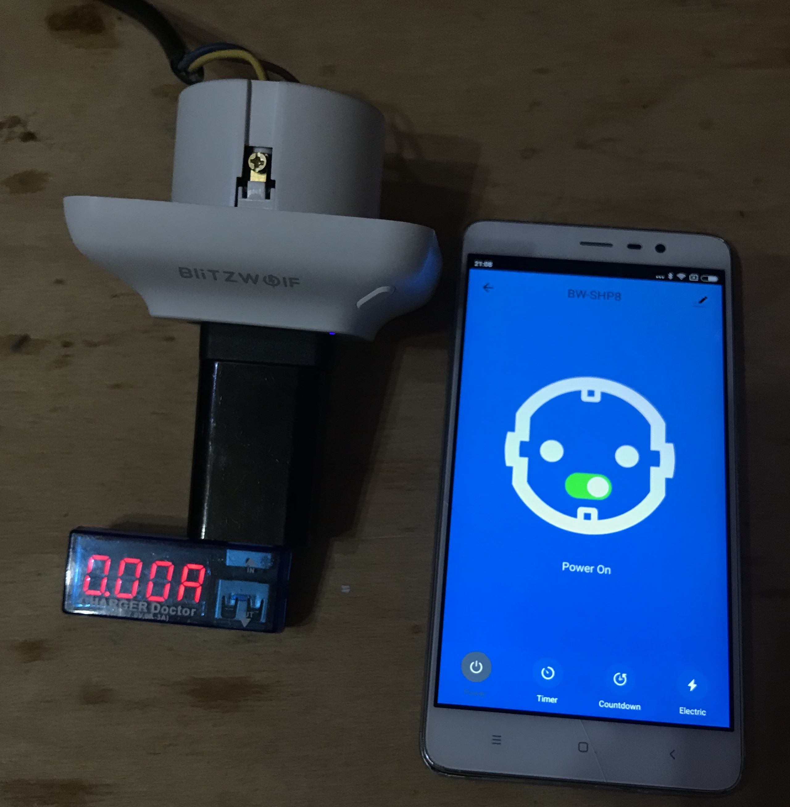

Connecting the socket and running the Android application
For the duration of the tests, I connected the socket to the power cord, of course respecting the colors and L/N/E (Live, Neutral, Earth) connections, which are described on the housing.
I checked that the socket was working - it was working, and the button on the housing allowed it to be turned on and off. Its status is indicated by the LED diode and the relay operation can be heard at the moment of switching:

After pairing the application with the socket, you can control it with one tap on the screen:
At the moment of switching, you can hear the operation of the relay, which is located in the housing of the socket.

(In the photo, my artificial load-resistor is connected to the socket)
After setting the time, we get a Toast message with the content " Device will be off in 1 Minute " (or whatever time we set) and the countdown begins.
After a while, the socket turns off (and the status LED on it goes out) as expected:

Connection test - Internet access (worldwide)
To be sure, I also checked whether I am able to control the socket from anywhere on the Internet.
Your phone with the application BlitzWolf I connected to the mobile internet (via an access point on another phone with a card SIM , but that's not relevant now) and I left the socket on WiFi from the fixed-line internet (the one on which it was configured).
I checked the connection and it turned out that I can easily control the socket and read its energy consumption.
Application: The mobile application and the BlitzWolfa[ system allow you to control the socket from anywhere on the Internet. No need to be on the same LAN. It is only important that both the socket and the application have access to the Internet. This is probably done so that the packets go through the server BlitzWolf from the network, he is the intermediary between the telephone and the socket.
Connection test - access from the local network (without internet connection)
I also checked the operation of the application BlitzWolf on a WiFi network without internet access.
I just pulled the main cable from the router.
A phone with an application BlitzWolf and socket BW-SHP8 Of course I left it connected to the network.
The app was unresponsive for a while, but then it started working responsive again and allowing you to control the socket.
I also checked restarting the Android phone to determine if I can log into BlitzWolf without Internet at home and the application launched without problems (there was no login form, my list of sockets turned on right away).
Application: The mobile application and the [b]BlitzWolf system works even when there is no internet at home (neither in the router nor mobile), provided that the phone and the socket are in the same network LAN .[/b]
