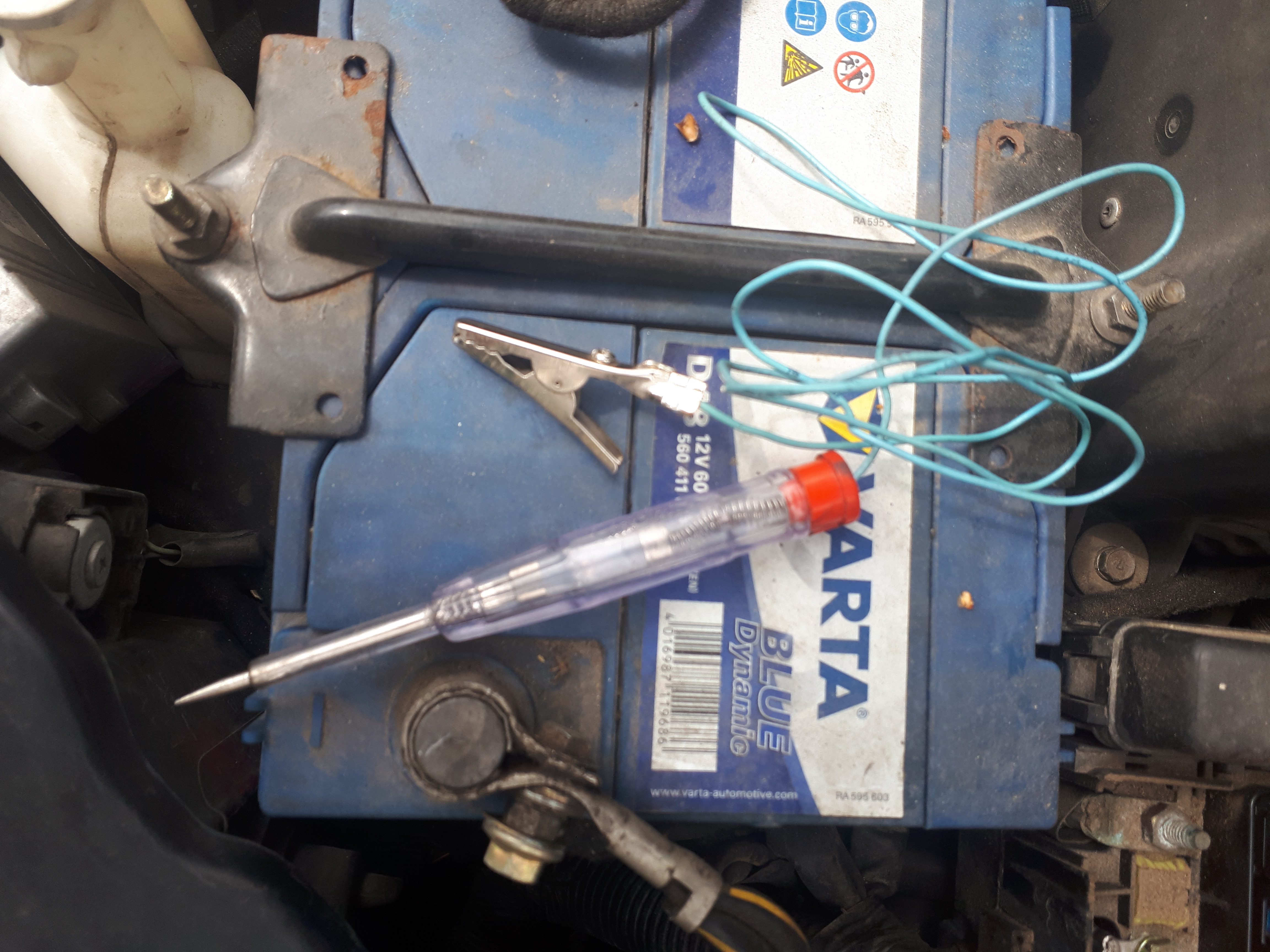

  • A simple way to check a car fuse with a test lamp and the fuse box in place.
  • Connect the crocodile clip to ground, touch the probe to each side of the fuse, and switch on the related circuit to test under load.
  • A simple sampler from the market costs PLN 5-10.
  • If the lamp lights on both sides, the fuse is working; if it lights on one side only, the fuse is blown.
  • Never replace a fuse with a larger one, because it can burn the protected wiring or other components.
Practically the best device for checking a fuse is the sight and the tester designed for this. We check the fuse under load. The meter can, in short, turn us into a balloon.
A simple sampler from the market for PLN 5-10.
This one was slightly modified for my needs.
We start checking with checking the instrument. Crocodile clip to ground, and the tip to the plus: shines = working.

And all you need is an ordinary working light bulb, anything you want from this car, and a piece of wire. [Read more]

ociz 31 Jul 2020 16:45
It is dimly lit, the bulb is probably changed to 24V. I recommend this type: https://obrazki.elektroda.pl/7668136900_1596206706_thumb.jpg Relatively robust, affordable and bulbs can be changed without... [Read more]
