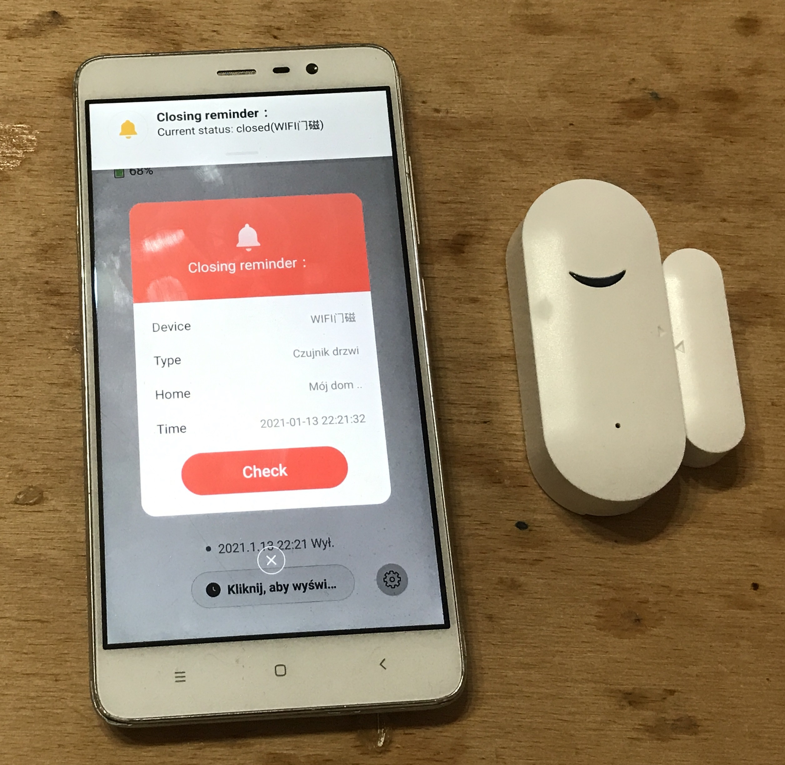

Hello my dears
Here I will present in detail how to configure and inside the battery-powered WiFi door/window sensor compatible with the SmartLife smart home control application. I will also show here how you can configure its work scenarios, e.g. automatically turn on the light bulb when the door is opened. Finally, I will also measure the power consumption of the sensor.
Purchase of WiFi Smartlife door/window opening sensor
I found the sensor on the Internet under the slogan "Smart Wifi Door Window Sensor Burglar Security Alarm For Alexa Google Tuya" for less than $ 10, i.e. PLN 40:
The graphics prepared by the seller well illustrate its operation:
An Android phone will allow us to keep track of the status of the door and receive notifications about their opening or closing, no matter where we are. You only need to register the sensor in our WiFi network (traffic goes through the manufacturer's servers).
