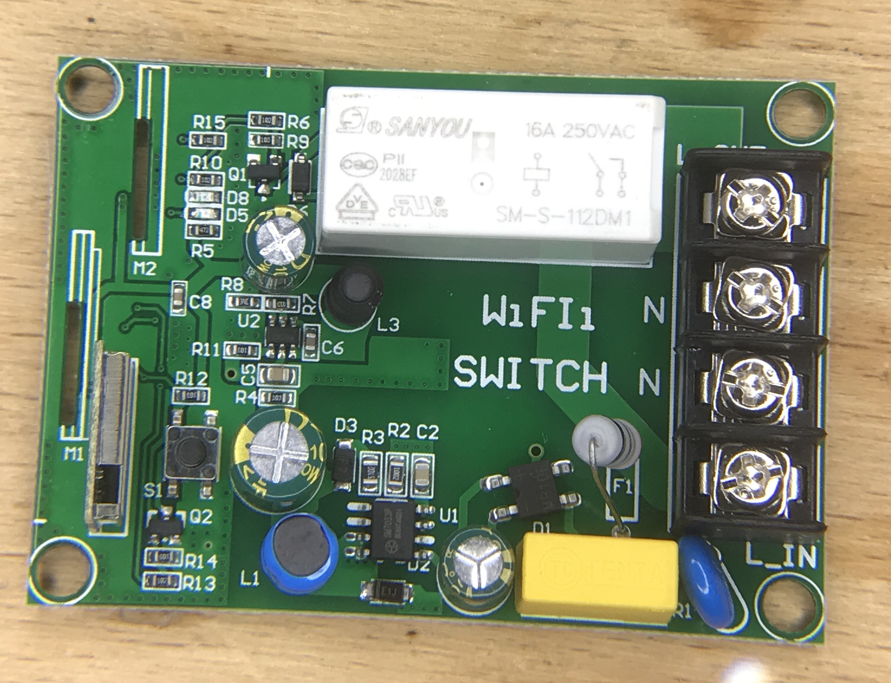

Interior WL-SW01_16
Now the most interesting, that is, remove the casing. You need to unscrew four screws (one is under the sticker):
Then you can remove the plate:
PCB:
It is interesting that there are places for 3 WiFi modules on the board (of course only one of them is mounted, not all 3 at once) and they are even signed M1, M2, M3. As you can see, the manufacturer was cautious and probably this board is also compatible with WB2S and maybe even with TYWE2S or similar?
Let's analyze the layout in turn. First there is a varistor (overvoltage protection) and a fuse resistor:
A bit further the X2 class MKP 0.1uF capacitor (anti-interference protection, still on the AC line):
Then we have the MB10F rectifier bridge:
Then there is the SM7033P:
This chip acts as a power supply. It provides 12V for the rest of the chip. First of all, it is noticeable that there is no transformer. It is not a flyback and there is no galvanic separation. The chip datasheet explains how it works:
There is 5V in the diagram, but in the layout from the topic, the system provides 12V. It is a buck converter that lowers the mains voltage. The characteristic elements (choke, rectifying diode) can be found on the diagram and on the board. Below I give a general schematic of a buck converter:
( image from wikipedia under CC license )
Then we have another agreement signed WBCKC (possibly WBOKC):
I did not find its catalog note, but the whole circuit (including the choke and capacitor) shows that it is another step down converter. It converts 12V to 3.3V for the heart of the chip (WiFi module).
The WiFi module is nothing for ESP. This is WB2S:
(It is worth mentioning that I have already met WB3S in the topic WiFi SmartLife single-color LED strip dimmer - test, interior, diagram )
The module from Tuya implemented on the 32-bit BK7231D.
Dimensions:
Pinout:
Next to it is a transistor and a button:
J3Y as usual S8050.
To control the relay there is also a transistor (also S8050) and of course a protection diode parallel to the relay winding:
The relay is actually at 16A:
This is SM-S-112DM1 16A 250VAC from SANYOU.
The relay cuts off only the phase:
(or actually: cuts the phase when we connect the wires correctly ... but that's known)

A few more measurements to confirm what I wrote. Behind Greatz's Bridge:
12V with SM7033P:
3.3V for the step down converter:
12V on the transistor from the relay control (the relay requires 12V):
So basically the 12V is there for the relay. It is the relay that dictates the use of 12V, which in turn necessitates the use of a separate step down circuit to obtain 3.3V. Probably if there was another relay, the SM7033P could be 5V, and 3.3V would be taken from the usual (cheaper?) LDO.
Summary
This product is not so bad, but it is also not something that we want to buy if we want to upload our own batch and become independent from the manufacturer's servers. There is no ESP8266 / ESP8285 in the measures, only WB2S. So at most we can use it from Home Assistant via Smartlife / Tuya plugin, but then we will not skip the manufacturer's servers.
As far as the construction of the product is concerned, it is quite good, inside there is even a step down converter to get 3.3V from 12V (instead of the common regular linear regulator, which would have greater losses and would emit more heat).
Yeahand you have to remember that this circuit only cuts off the phase (as long as we connect the wires correctly), zero is always connected.
