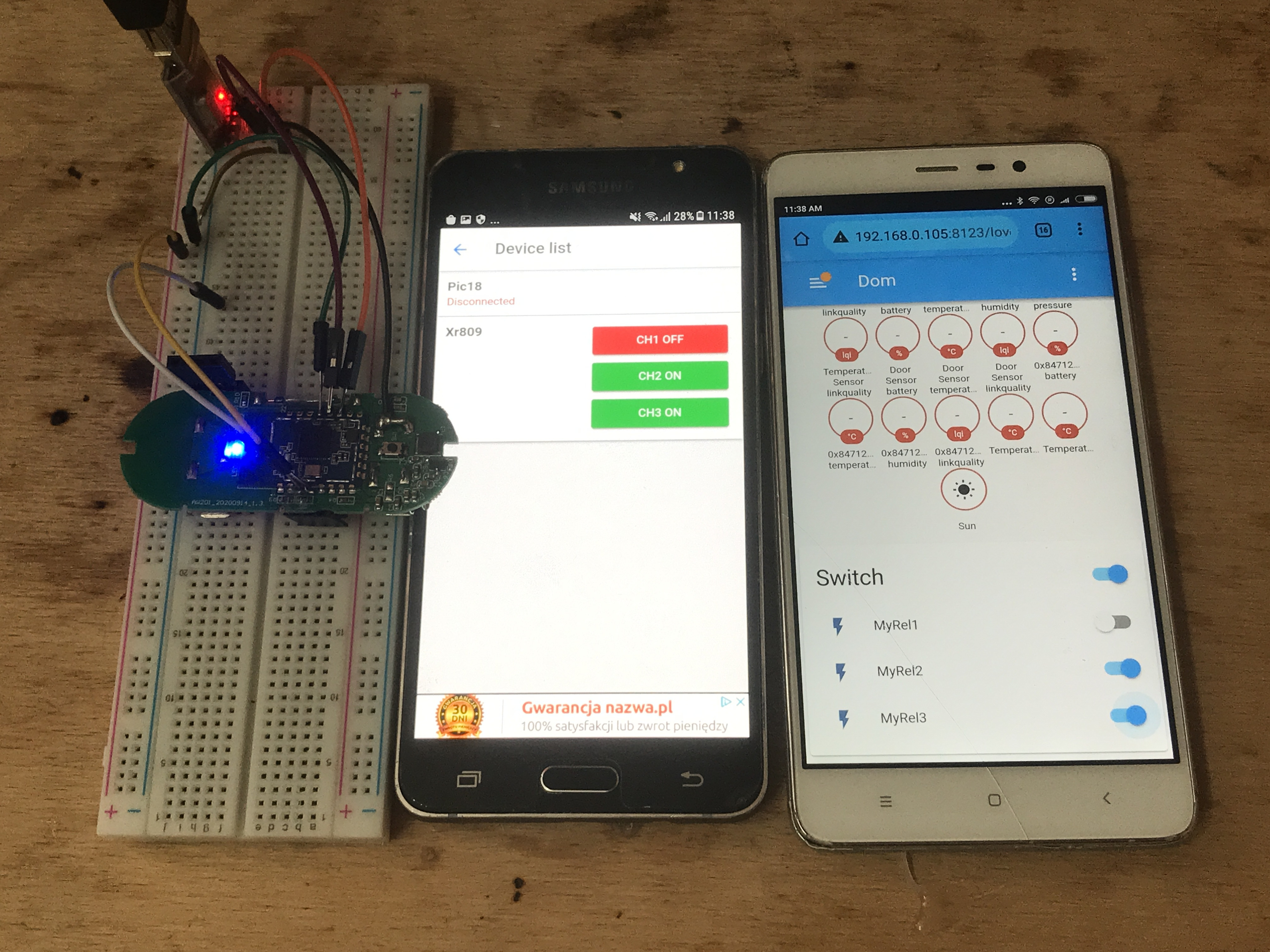

Open source firmware was built for the XR809/XR3 WiFi module, turning a door sensor into a Tasmota HTTP and Home Assistant compatible device.
The firmware uses the XR809 SDK in C on ARM Cortex-M4F, reuses the built-in shttpd web server, and adds GET handling for status, pairing, reset, and LED control.
XR809 runs at 160MHz and provides 384KB SRAM plus 2MB Flash ROM.
Tasmota Control and Home Assistant could read the door and button states, and Home Assistant could also switch the onboard LED.
The implementation is still early and messy, with buffer-overflow concerns and WiFi resets when batteries were too discharged.

And now the best part - it is now already compatible with Tasmota Control from Google Play.
https://play.google.com/store/apps/details?id...s_software.TasmotaControl&hl=pl&gl=US After adding device by IP, the result in Tasmota Control:
Of course, all these data are placeholders, i.e. everything is hardcoded.

The first signs of functionality I cleaned up the code a bit and also connected the button from the board as the second input. Below is the code for generating the response to the Tasmota HTTP query (code specially written quite clearly, it could be done better and shorter, but less readable for beginners):
Code: C / C++
Result in Tasmota Control:
With active sensor ("closed door"):
With the button pressed:
So everything works.

Final test with Home Assistant Finally, I tested the module from Home Assistant using the Tasmota HTTP support Python scripts described here:
https://www.elektroda.pl/rtvforum/topic3789324.html that is the updated version of this plugin, HTTAS by JiriKursky:
https://github.com/JiriKursky/httas ATTENTION - for the moment httas version from Github will not work with newer Home Assistant versions . This is due to a change in the way coroutines are handled. You will get an error: " ValueError: Coroutine not allowed to be passed to HassJob . "
Therefore, I recommend downloading my corrected version:
httas-fixe...210306.zip (6.91 kB)You must be logged in to download this attachment.
In /config/configuration.yaml I set up the device location:
Code: YAML
Then you need to reboot Home Assistant. In my case, it immediately detected XR809 after booting up:
"MyRel1" here is the door open state, "MyRel2" is the button state, "MyRel3" is the LED state.
The status of the LED can be changed from the Home Assistant. The other fields are read-only.
Short demonstration:
