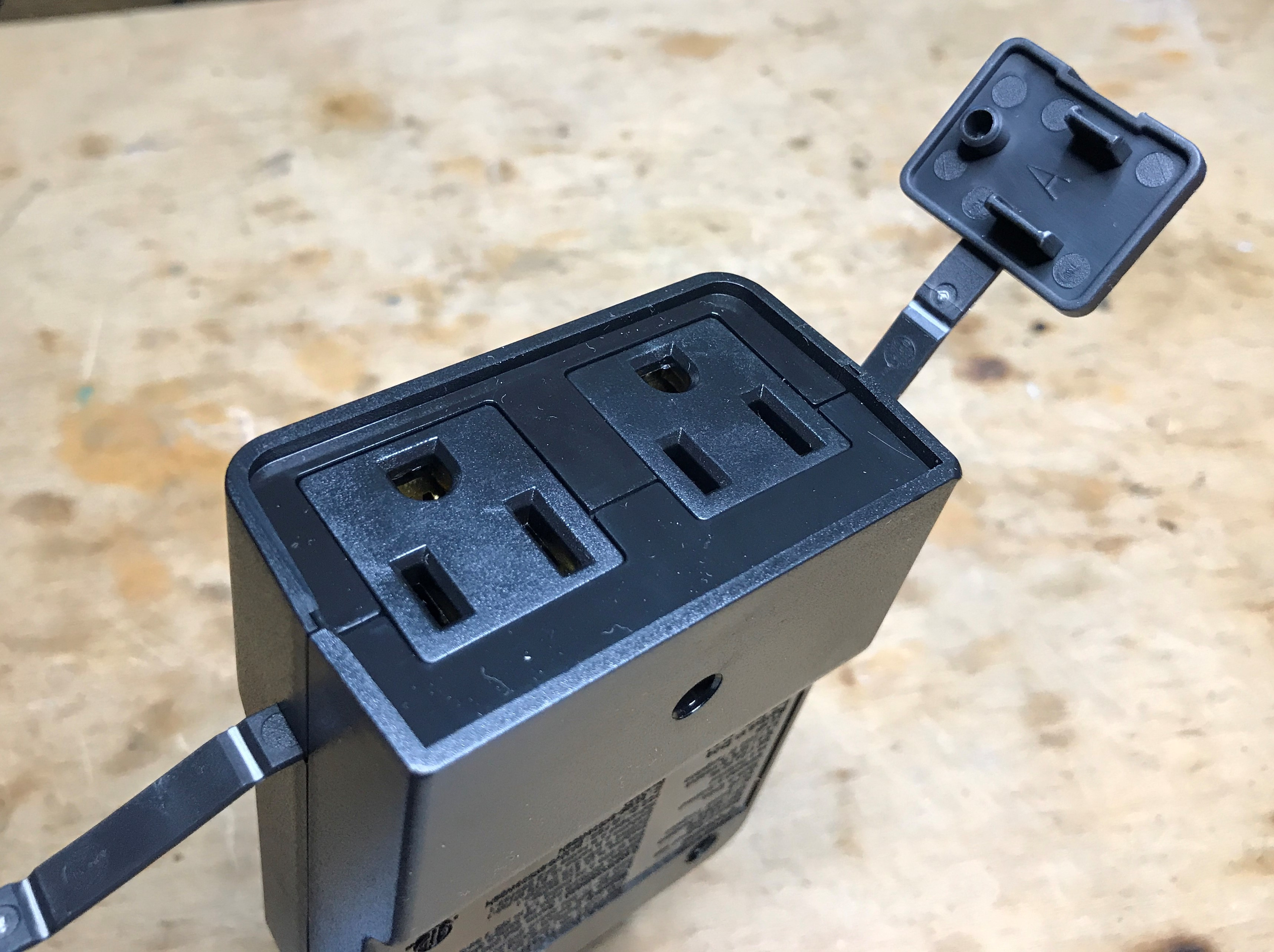

He bought the @Strigon kit at a Costco store. In his opinion, earlier versions were based on ESP8266 and Tasmota could be used with them, but Tuya is switching to Beken chips ...
The parcel came to me after quite a long time:
The Polish Post Office could not let it pass - even though it was marked as "Gift" - and counted the postage to some 8.5 PLN, which I paid upon receipt (the lady from the post office brought a package to the door at least):
Kit Contents:
Well, in Canada they have a different standard of sockets than ours. The device is on 120V. I think that 230V would also work, but you need to check it after opening (check the parameters of all elements and their catalog notes, from the inverter controller as there is, through capacitors to relays).
The housing is screwed together with screws.
Inside we have two relays, one button and a 32-bit microcontroller with WiFI BK7231T, but simply placed on the main PCB of the device, not in the form of a module such as WB2S or WB3S:
