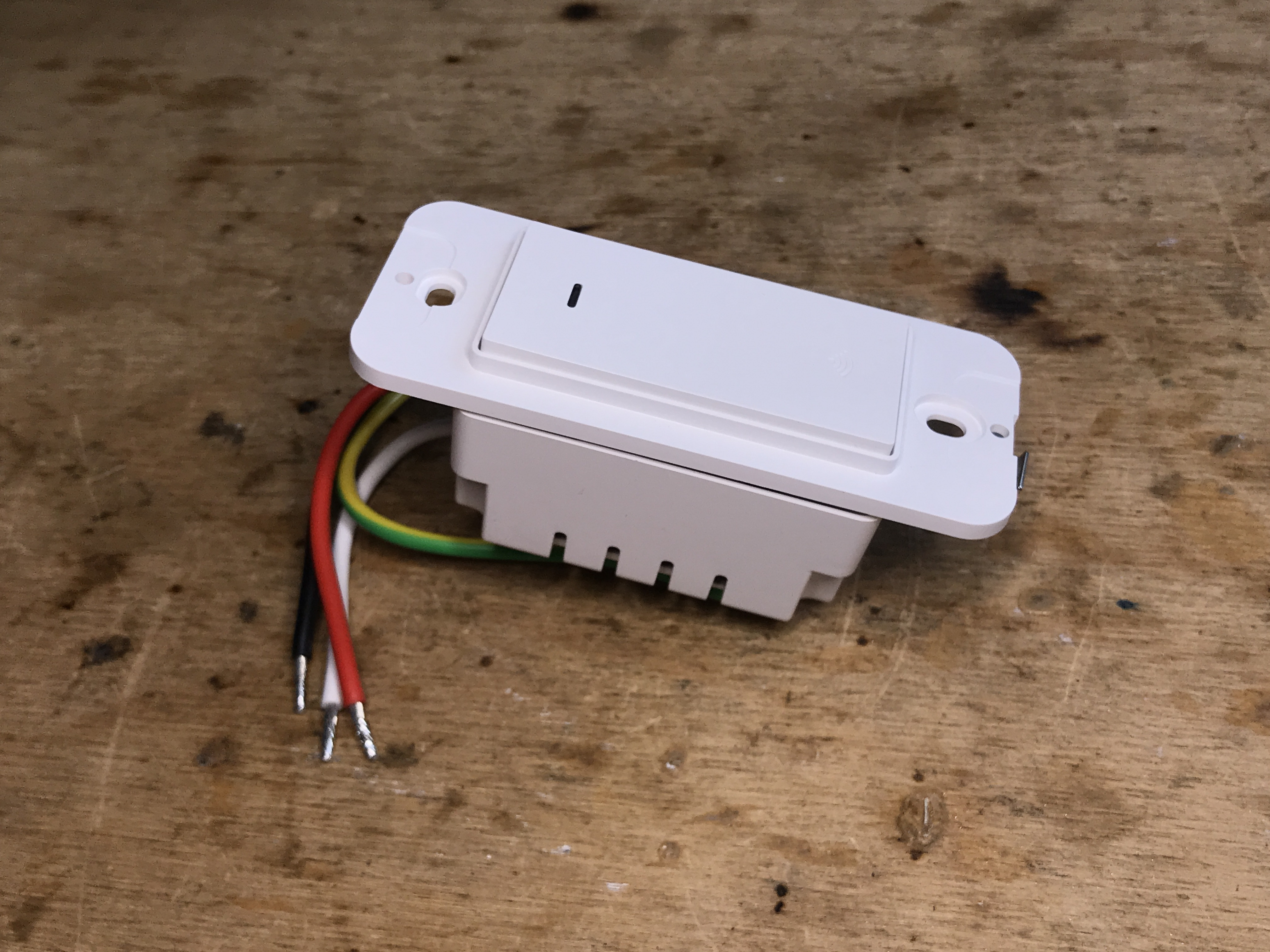

Hello, here I will present the short teardown and OpenBeken programming guide for Gosund Smart Switch SW5-A-V2.1 with an unusual BK7231T module inside, which I am going to desolder with hot air in order to make high res photo of pad. The switch was donated to me by Jennifer from USA - thank you!
Package from Jennifer
The package was sent to me from the US on March 22 via the USPS (US Postal Service). It was marked as "Gifts", declared value 0.5 $.
The postman brought it to me on May 4, I had to pay PLN 8.5 of the postage:

Without delay, I started disassembling it.
The interior of Gosund Smart Switch SW5-A-V2.1
The housing is held by four screws. After that, you can remove the back plate.
Here you can see something unusual, an external 2.4GHz WiFi antenna. It's not usually used, modules like ESP12F (TYWE3S), TYWE2S, WB2S or WB3S (regular) don't have it.
Fusible resistor, a filter from two 400V 3.3uF capacitors (by the way - 400V in a switch for 120V? 120V mains is used in USA, and in Poland I have 230V mains) and a choke (the green one), a large choke (black) from a transformerless power supply ...
Interesting fact - this 16A fuse, more precisely 16A250V, protects the entire system and the lamp connected via the relay. This fuse is directly connected to the L-in. I don't see such things in other smart switches, there is usually only a fusible resistor that protects the power supply only, not the relay light bulb.
Here you can see the MB10F rectifier bridge, followed by the already mentioned Pi filter, and a bit further the transformerless converter controller powered by some SMD chip with IADGN label:
IADGN is an SMD code, I don't know the full part name, but I can see you can buy replacement easily:
Next you see the LDO regulator AMS 1117 3.3V (it provides 3.3V for the WiFi module) and you can also see the decicated programming and debugging pads. They will be useful for us:
On the other side, there is also a transistor marked 1AM (probably MMBT3904) that activates the relay together with a "free-wheeling diode" SMD 7A diode connected in parallel to the relay coil, removing sudden voltage spikes when switching.
There is room here for an alternative WiFi module. Does anyone know which module fits here?
