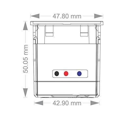

  • HomeMate Wi-Fi + Bluetooth Smart 4 Gang Touch Switch for Roma fitting uses a CB3S module with BK7231N and TuyaMCU control.
  • The switch stacks three soldered boards: touch/controller, relay board, and power board, with long header pins linking them together.
  • It exposes 12 dpIds and uses 4× 5A 230V relays, a ULN2003A Darlington array, and an HLK-PM01L power module.

Tuya 4 CH touch switch for Roma fitting for Indian homes, it has CB3S chip (BK7231N)
https://amzn.eu/d/3K8uk6I
Technical Specs
TuyaMCU: T1616-N TH 2720E (ATTINY1616)
Darlington transistor array ULN2003A
Relay: 5A 230V x 4
Power Module: HLK-PM01L
This switch consists of 3 board, soldered with long header pins,
Top board is the controller board, top side is with the touch buttons, and on the other side it has CB3S and TuyaMCU, after that, is the relay board and then the power board.
Total dpId 12
