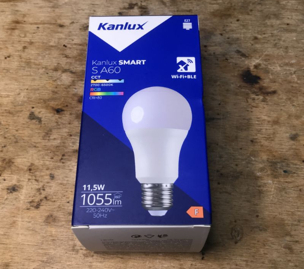

Here I will show the interior, the programming procedure and the configuration of the LED lamp leads Kanlux S A60 11.5W E27 RGBCW based on the CB3L module, i.e. the BK7231N chip. This is another lamp that came to me from one of the users in order to download the firmware from it for the tuya-cloudcutter project to allow the programming of other such products (from the same series) remotely and recognizing the roles of its WiFi module pins.
From what I can see, such an LED (colloquially called "bulb", although it is incorrect) costs less than PLN 30:
Product packaging, with model information and QR codes for the application:
