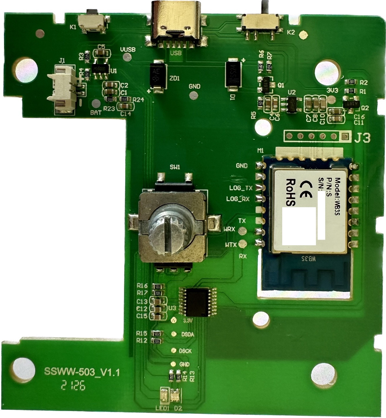

Hi,
I bought a "LSC Smart Dimmer Switch" from Action in France for around 10€.
It is a wall switch, working on a battery consisting of:
- A WB3S module (WiFi with a BK7231T)
- A Tuya MCU with no reference written
- A rotary switch with an integrated push button
- 2 LEDs:
- One that seems RGB (seems connecter to the TuyaMCU)
- One green (seems to be related to the charge function)
- A power switch
- A reset button
- A 3.7V battery
- A USB C connector use to charge the battery
Here is the circuit:
Work is in progress to make it work with OpenBekenIOT :)
https://github.com/openshwprojects/OpenBK7231T_App/issues/291#
Best,
Adrien

p.kaczmarek2 17 Oct 2022 08:36
As said on Github, full packet capture would be nice, both queries and replies. A full Action item model or index also would be helpful. Anyway, thanks for teardown, it will be added to our online database... [Read more]
Bacto 17 Oct 2022 09:43
I'm not sure 100% but it seems that the RGB LED and power/reset button are connected to the TuyaMCU while the green LED is connected to the charging circuit. [Read more]
HumbleDeer 22 Dec 2022 06:37
I can confirm your guess or look-see about the green LED is correct. Green LED with LED1 as designator is connected to the five pin chip labeled "B5UD" of which I can find NO info at all but suspect it... [Read more]
p.kaczmarek2 07 Jan 2023 13:05
I am adding missing information to devices list, do anyone know an Action Store article number or any other ID for this device? [Read more]
HumbleDeer 07 Jan 2023 13:51
ean 8712879149514 art no 3006033 unknown number 970806 (no designation on box) [Read more]
