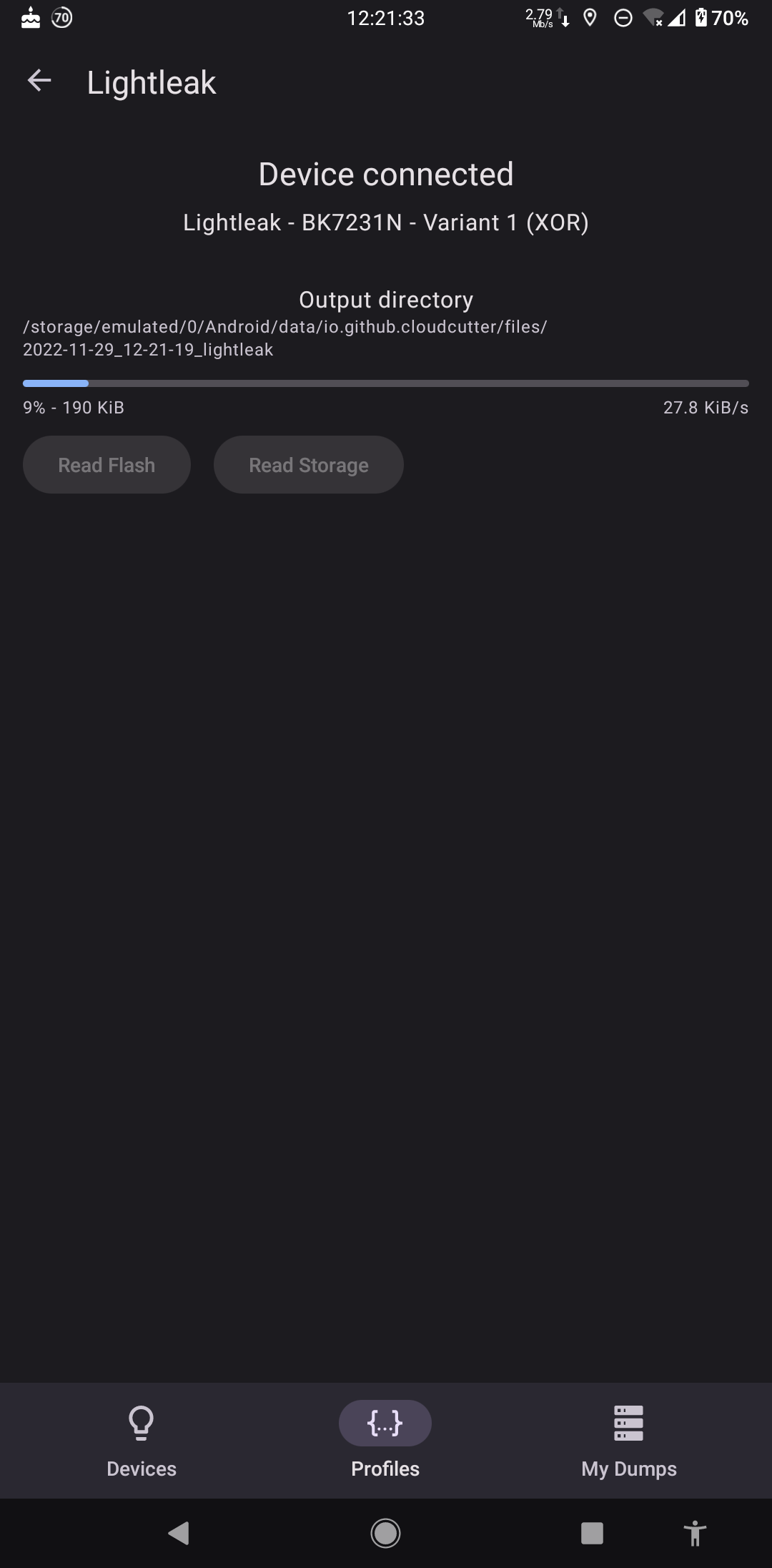

  • Flash OpenBK onto Tuya/Smart Life devices over OTA with tuya-cloudcutter instead of serial reflashing.
  • Download the correct custom firmware, select the matching profile in run_flash.sh, reset the device into AP mode, then reset it again for OTA flashing.
  • Match the Tuya-firmware profile for chip T or N; after the second reset, a correct profile shows an A-xx prefix.
  • Unsupported devices need a firmware dump from bk7231tools or Lightleak so you can request or generate a profile.

For no (3), if your device is not supported, then you would need to make dump of your device firmware using bk7231tools and submit a github request for profile creation.
There's also Lightleak app that can obtain firmware dump wirelessly. I've had some success with T device but not N yet
